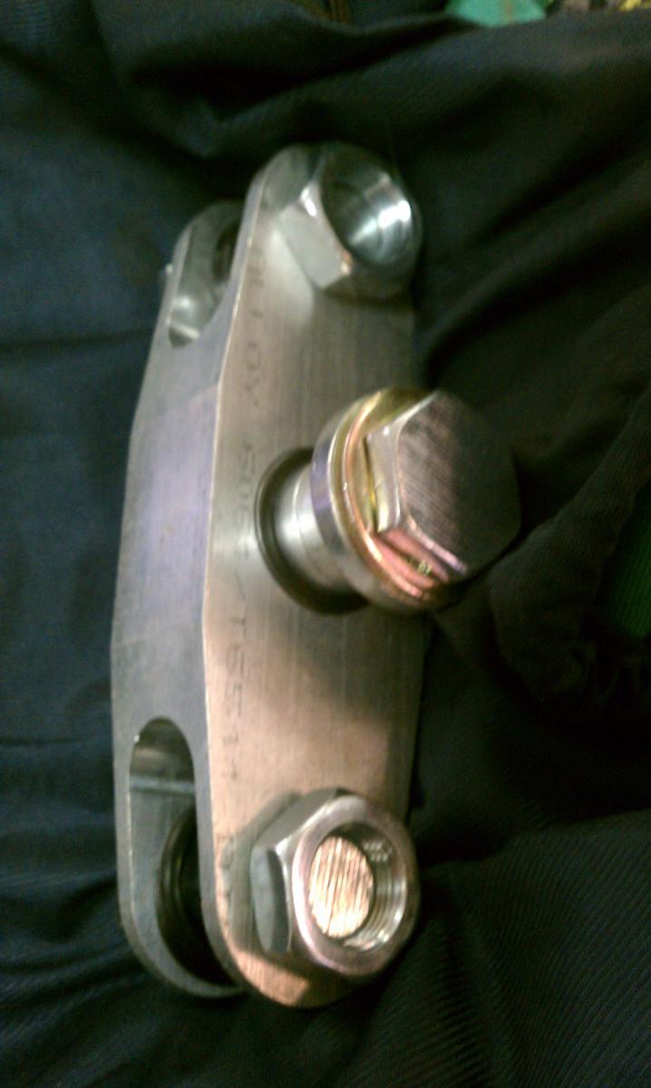

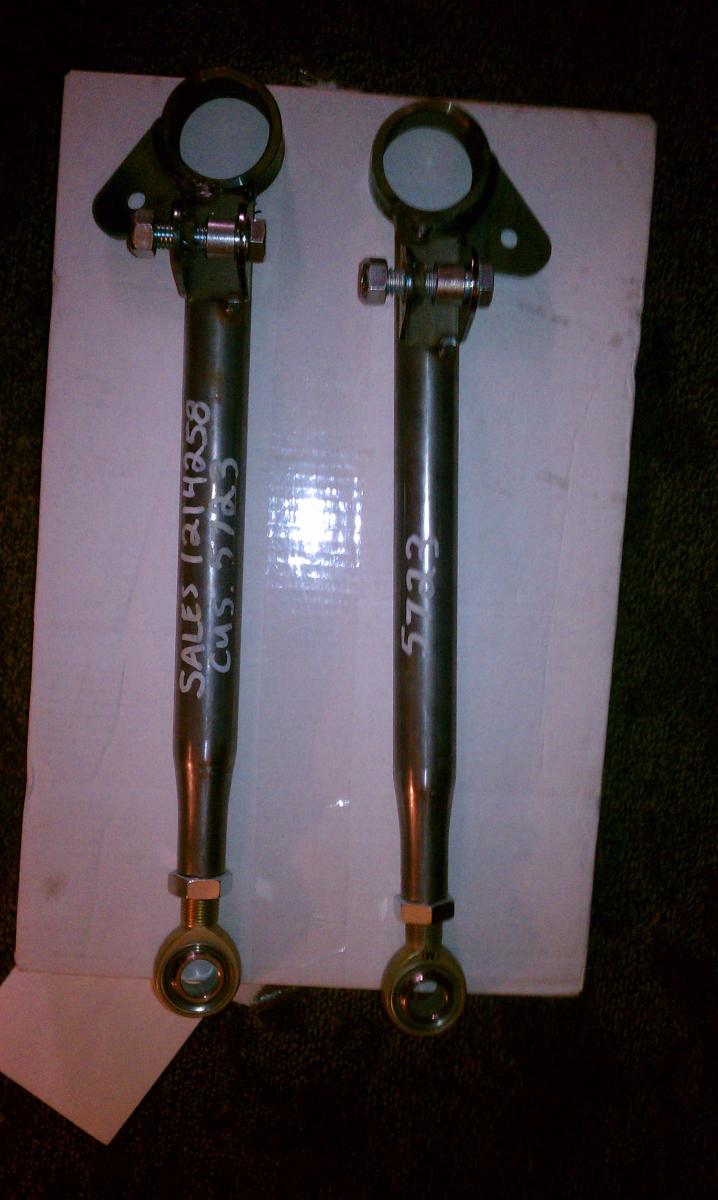

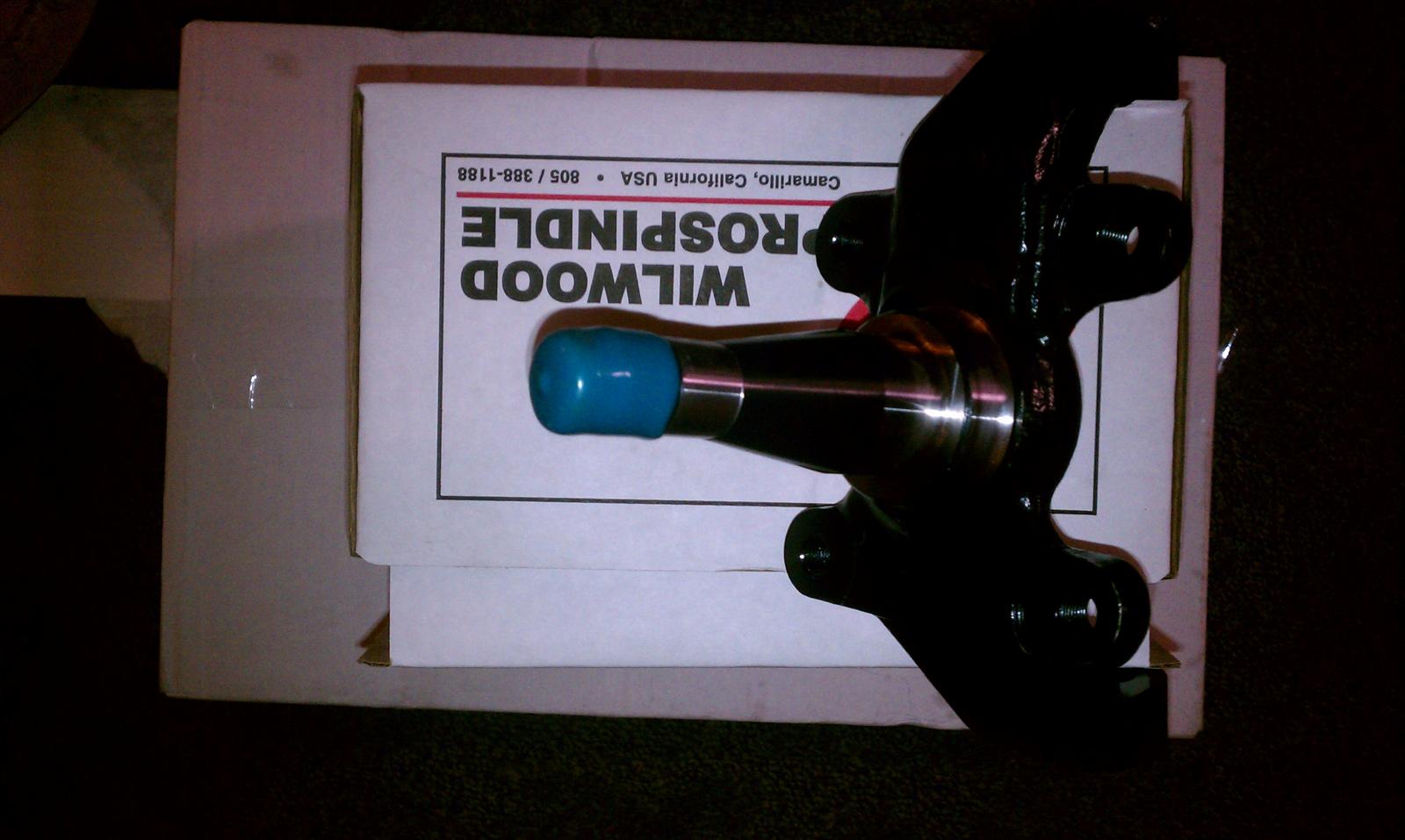

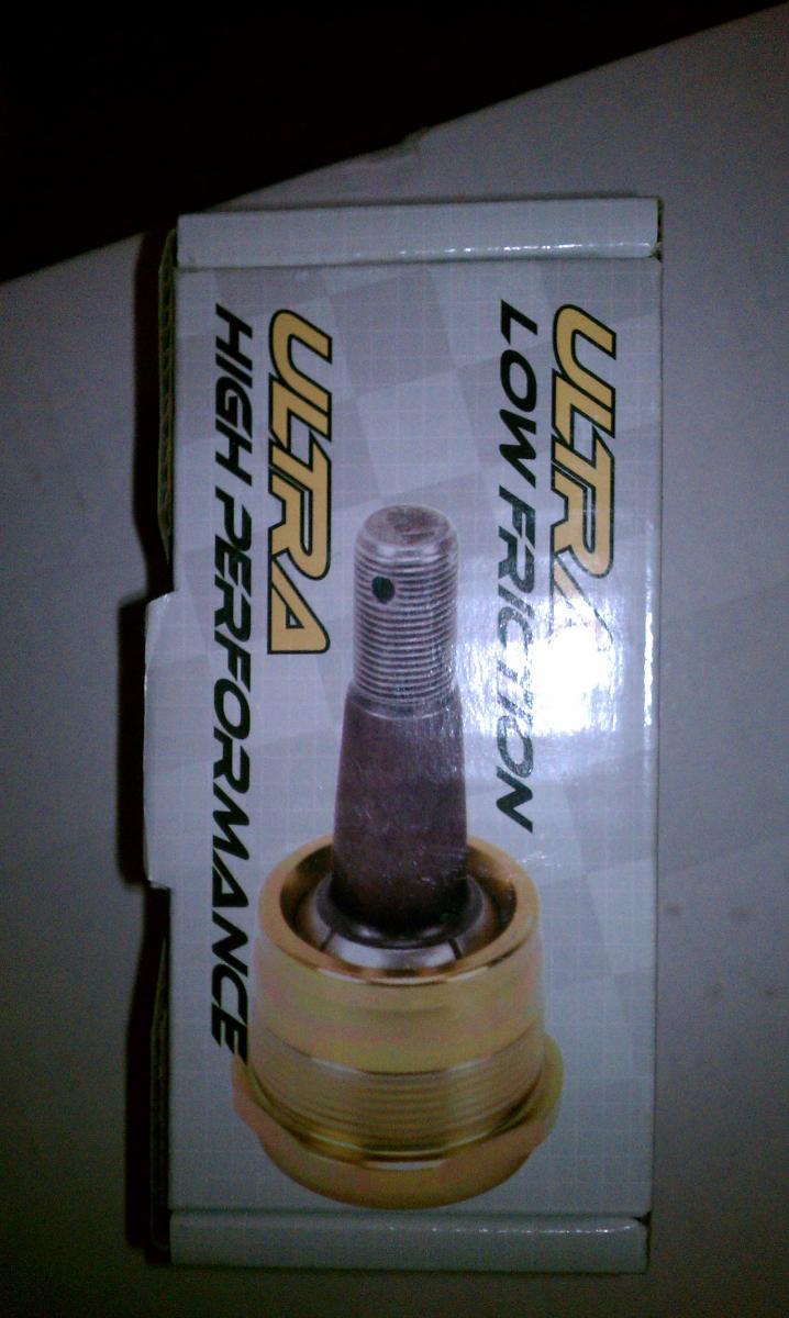

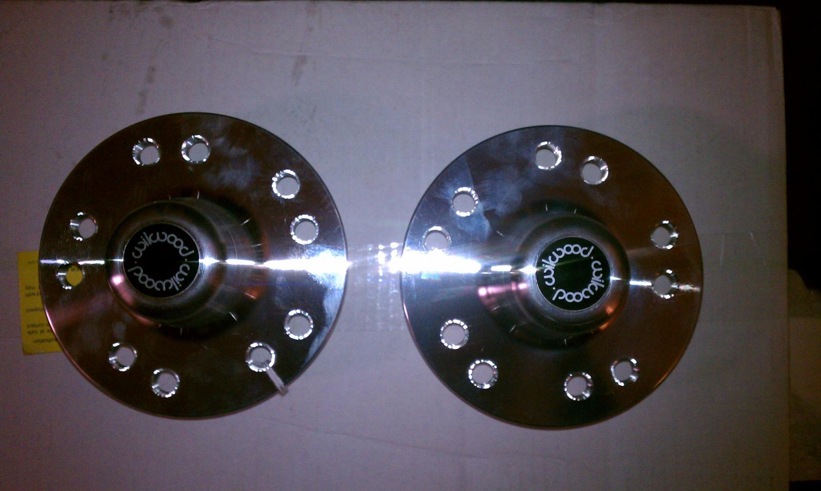

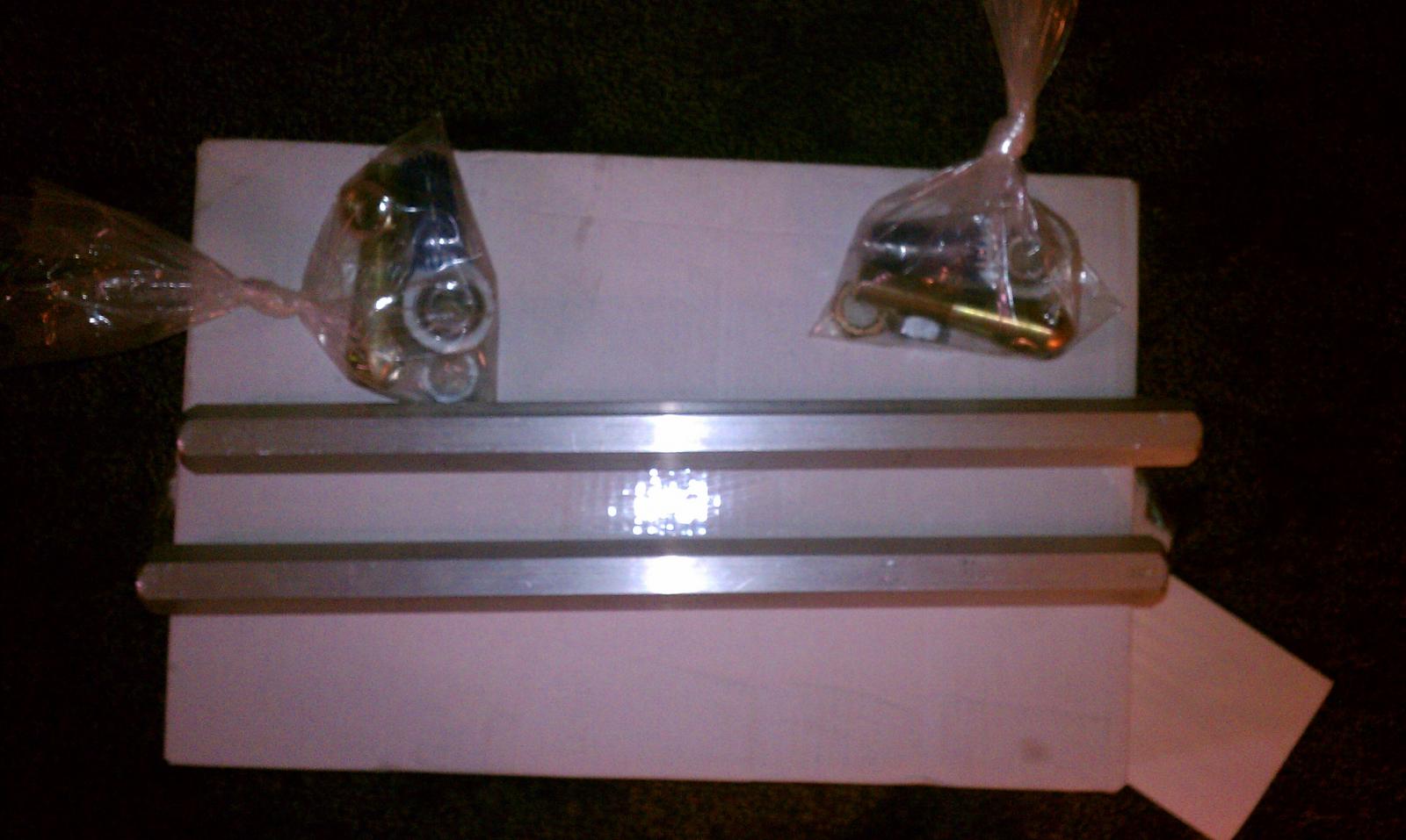

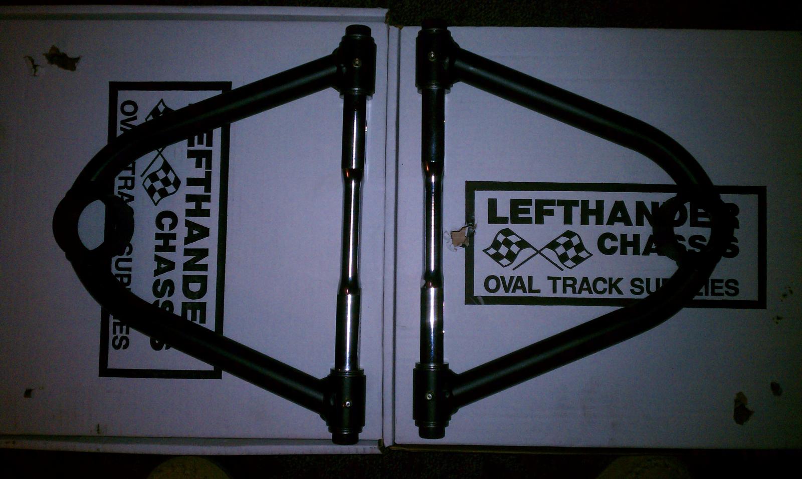

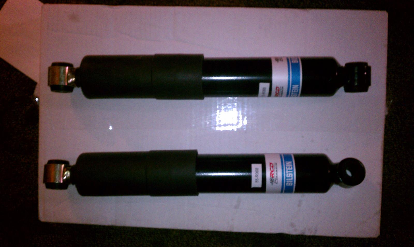

      I got my new parts yesterday. Rear gas charged bilstein shocks, wilwood pro spindles, wilwood hubs, Lefthander chassis roller bearing upper control arms, Lefthander chassis lower control arms and 3/4 aluminum strut tubes with screw in ball joints for upper and lowers also got the joes racing aluminum shims. Will add pics of front stub tomorrow along with pics of rear suspension components and the center propeller of the watts link that ill be building for the car too. Hope you all enjoy. Name:  IMAG0026.jpg

      I'm Using Joe's upper arms too!
      Keep an eye on the balljoints when you mount spindles ( if you are using stock ford spindles). Most of the circle track screw in BJs are Chrysler taper and ford spindles will need to be reamed slightly. the correct allstar reamer is a little pricey ( i think 88 bucks) .

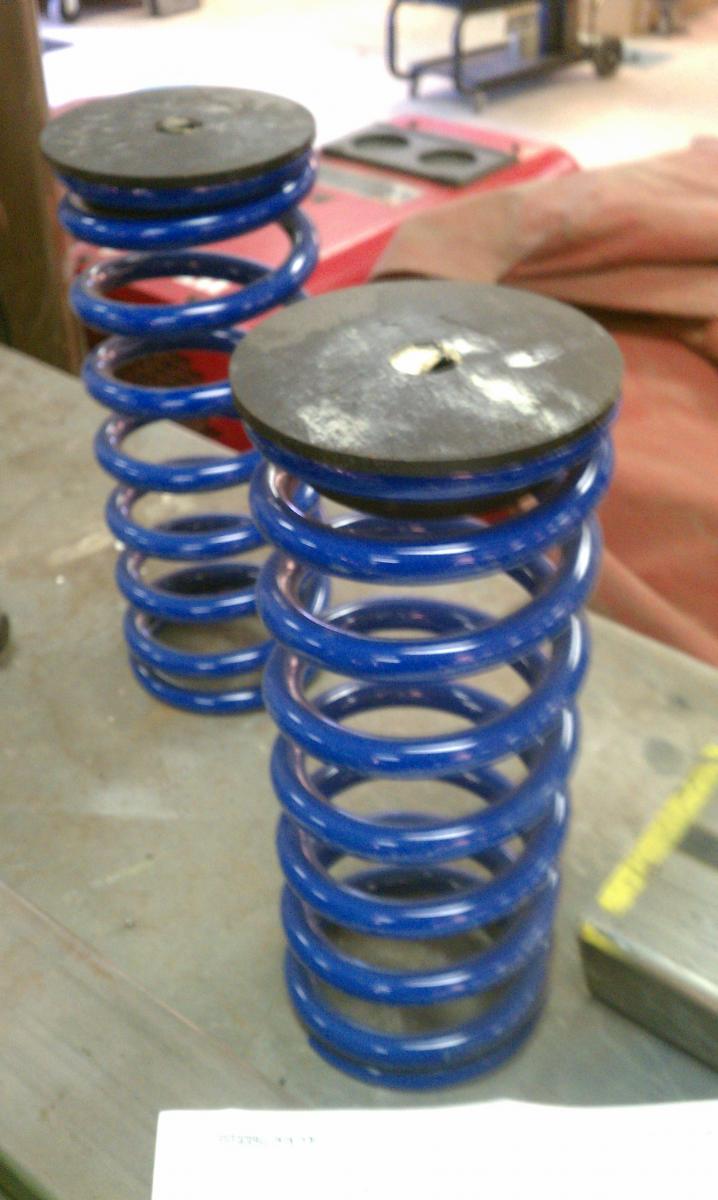

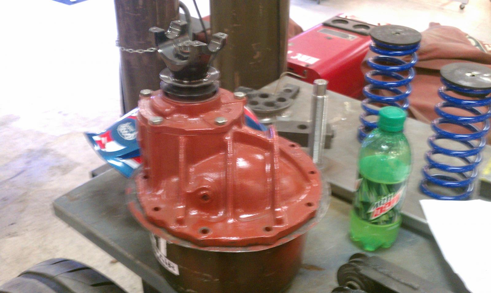

      Here are the pictures of alot of my rear suspension.
      Hot rods to hell trailing arms, nascar sprint cup super speedway ford 9 inch gears, 250# springs, and fays 2 propeller kit.

      Nice, you dont see Rancheros that much, if ever.
      Where did you get the fays 2 propeller kit?
      Aug 2011
      Minnesota
      88
      i called up the owner of fays 2 and he will sell just the propellar kit.
