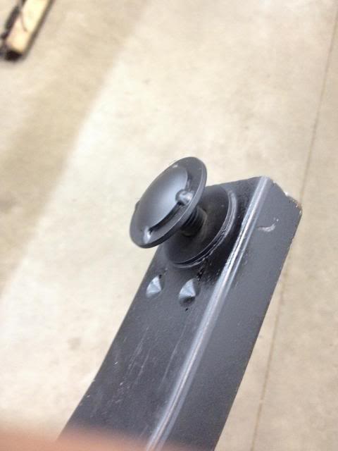

Hacked off the stock rubber adjusters, going to try frost plugs tacked on as a race-only alternative. The domed shape will slide easy on the control arm and provide a single point of contact during suspension travel.
Worked pretty slick, nothing fancy but it should get the job done. I slathered some grease on the control arm for now, but will swap these with delrin later depending on how much wear I see on the arm over time.
