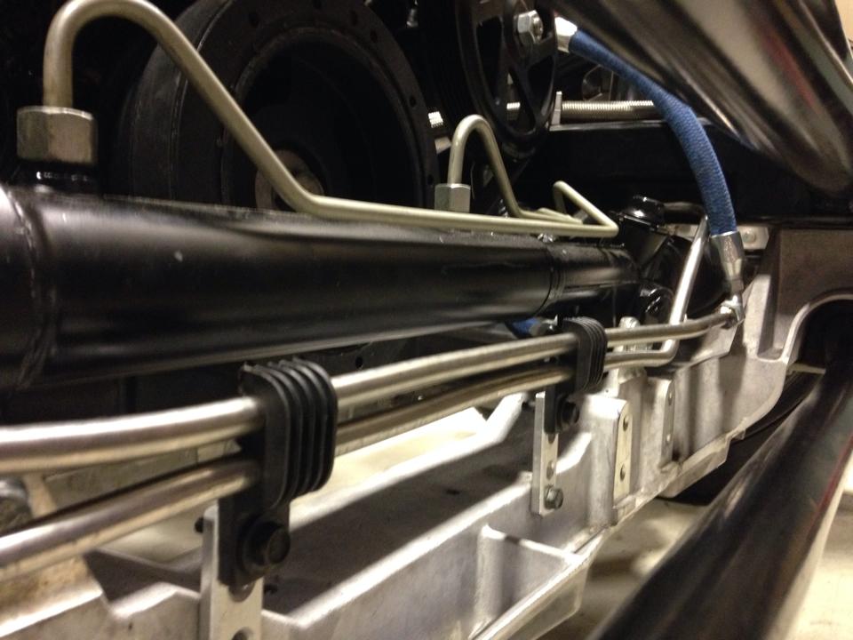

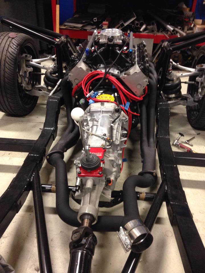

      got my exhaust on, cut a large amount off the flange of the bell housing to make it fit. crazy how much engine gaskets can move things around.

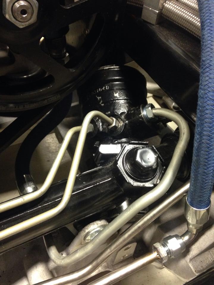

      made the power steering loop line on the return out of 304ss tube. I needed It to bend 90* out of the rack and pinion. so I had to weld a flange onto the new line.

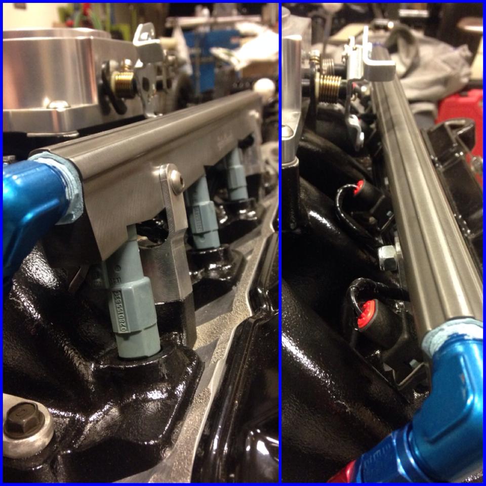

      Finished up my fuel rails and injectors, wired them up and hid the wires
      Finished my power steering feed line

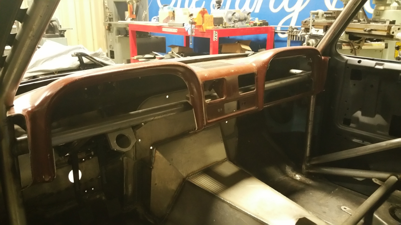

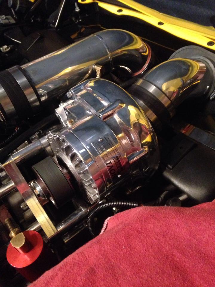

      A little work done, 3 more weeks of classes, then finals, then an extreme work crunch for spring.
      Paxton Novi 2000 and my dash is coming along slowly!

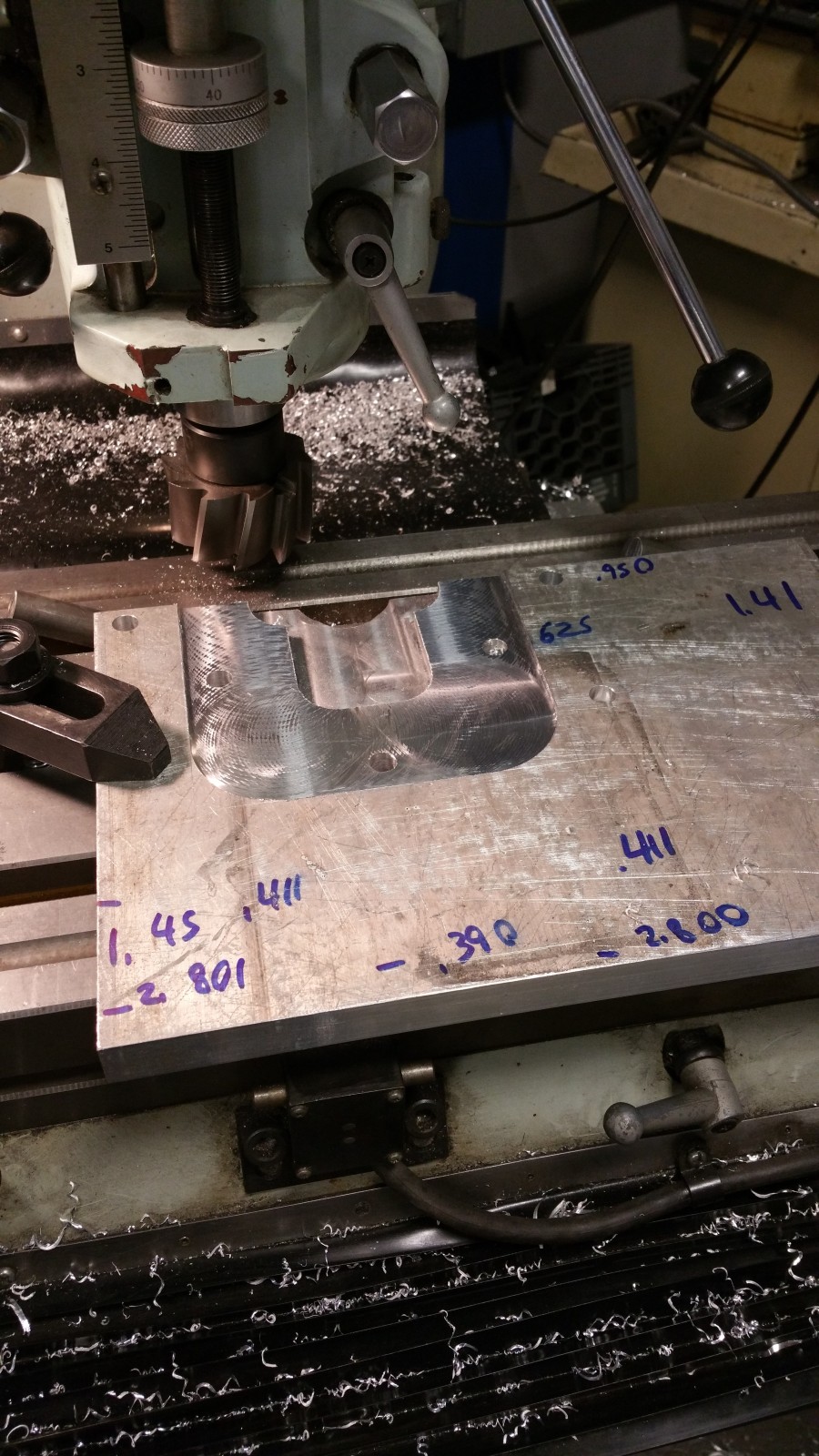

      So since Paxton wouldn't email me back with dimensions OR blower pulley/boost configuration, I had to venture on my own with my Vertical Mill, I machined a gauge pin and did it the old fashioned "go no go" routine with the DRO and blueprinted my dimensions

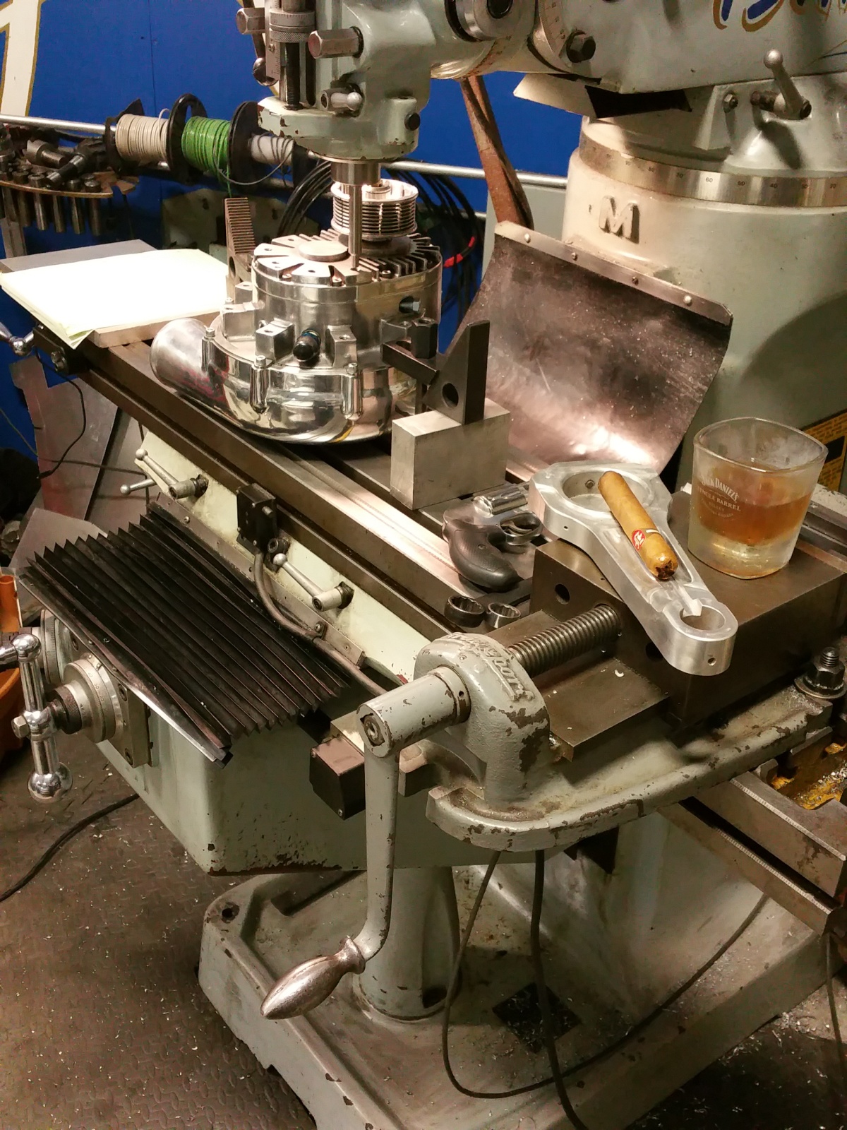

      here is the back side that mounts to the supercharger, im configuring my pulley set up and then making a mechanical tensioner on two pulleys for complete wrap of the blower pulley. as well as somehow fitting a spring tensioner on there for the slack build up under acceleration. I hear 48 ft/lbs is ideal. we will see

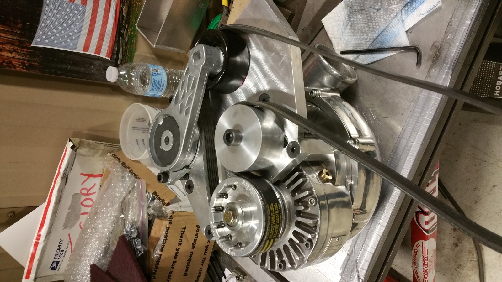

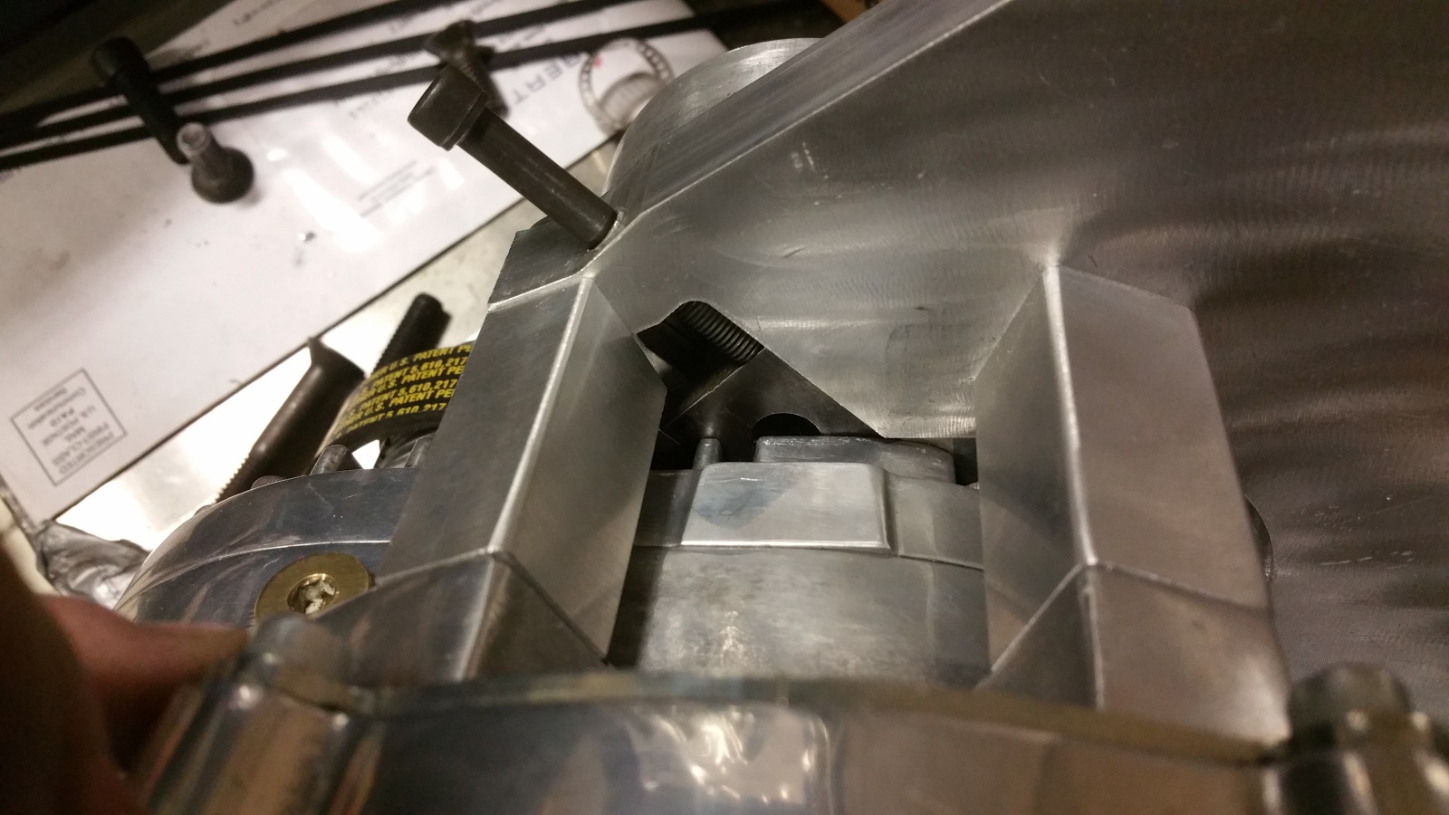

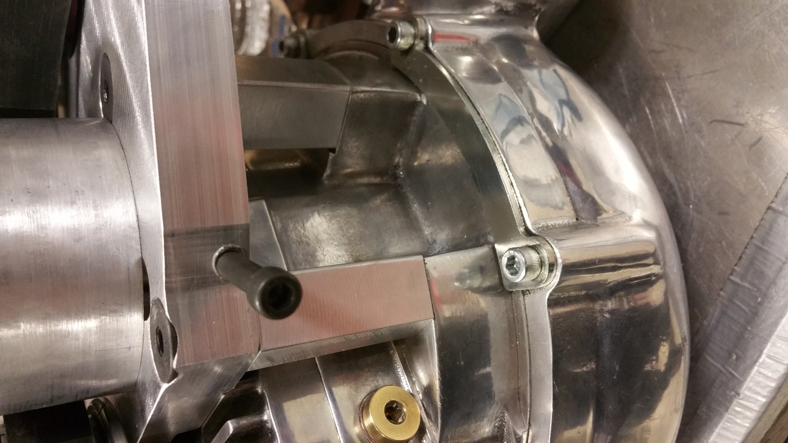

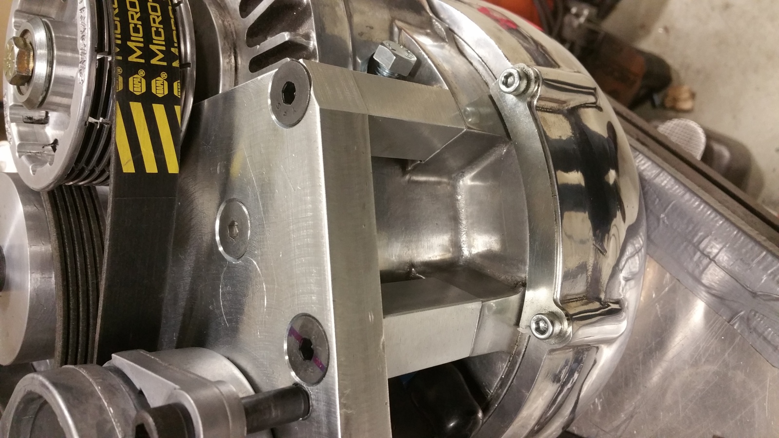

      so i have the base to my supercharger bracket done. as well as all the tensioners, i used a Dayco spring tensioner for the automatic, as well as a T-nut slide style for my mechanical tensioner, as seen i put a set screw to tighten it up. All of the spacers for the mounts are machined individually to fit each boss. now to design the uprights that reverse mount it to the heads.

      Quote Originally Posted by LUV2XLR8 View Post
      Cigar and scotch?
      Cigar - Fonseca 5-50
      Whiskey - JD Single Barrel Select
      i think its the only way to indicate manually is with a cigar and frosty beverage

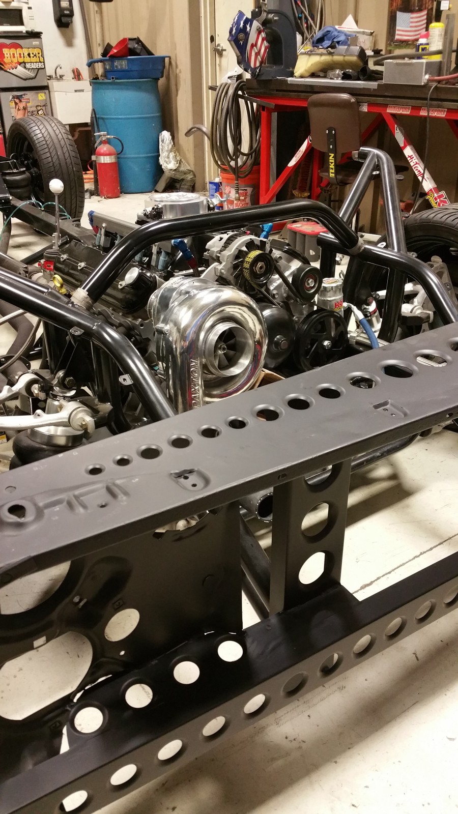

    19. #279
      sweden
      10
      what kind of metal machine did you use to do those holes in the metal?
    20. #280
      Dec 2010
      Charlestown NH
      352
      Quote Originally Posted by 68_sweden View Post
      punch, drill or cut some sort of hole, then these dies:
      http://www.mittlerbros.com/mittler-b...mple-dies.html
      they give the metal rigidity, and weight reduction
      https://www.pro-touring.com/showthre...-Touring-Truck
