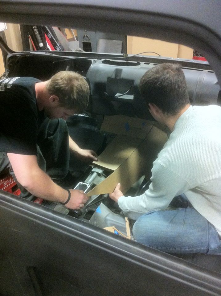

      got my transmission tunnel mocked up with cardboard (i ended up cutting it all out of 18g on friday)

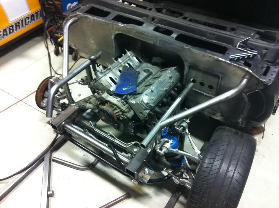

      started the front part of the cage and into the cab
      and mock up of some of the bends

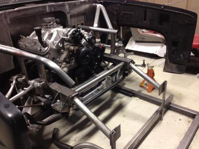

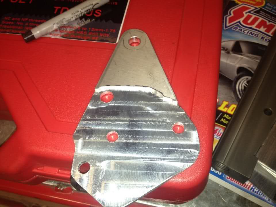

      Been a while since last update, got the whole front engine cage and upper control arm tacked together, started making the power steering brackets since I've been Waiting and trying new pullys for the past month, gonna see if I can snag a pair of z06 wheels to mock up in the front for steering purposes since right now I either need to raise my wheel well or roll my front fenders wide body style 3+ inches on each side..., mostly because the corvette weeks have such a large offset

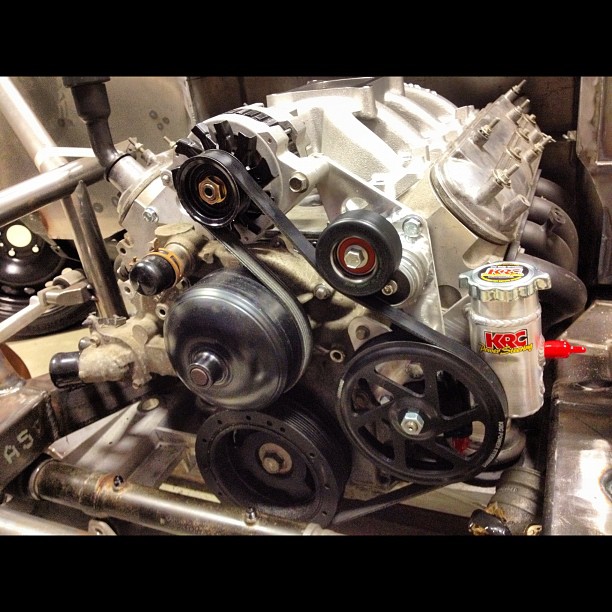

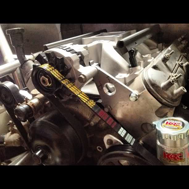

      i ended up having to reroute the belt again because the crank only had 1/4 belt on the pully, so i machined a mount using the C5 ac tensioner and stock idler pully (wider) so i could run the tensioner on a straight section of belt

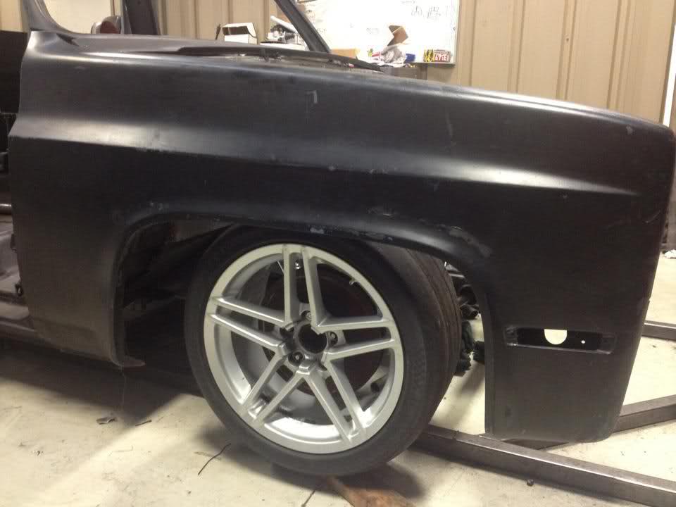

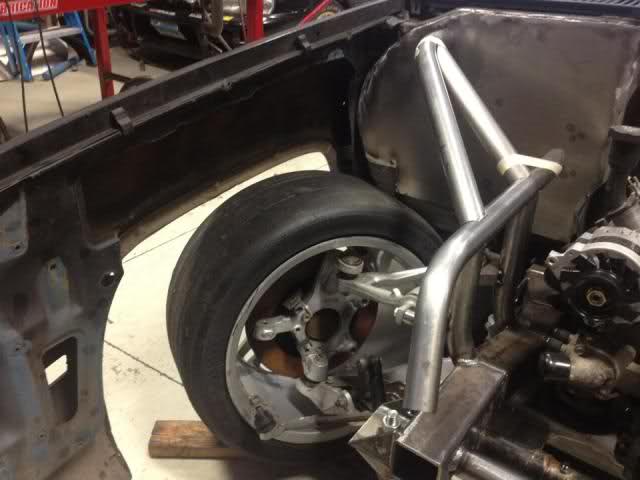

      I also want to thank Randy Probell again for lettiing a kid he barely met once, borrow a set of z06 wheels and hoosier slicks, guy would give the shirt off his back if someone needed it and is a great guy, very intellegent in the sport as well
      he may have a line on Z06 front breaks for me too,

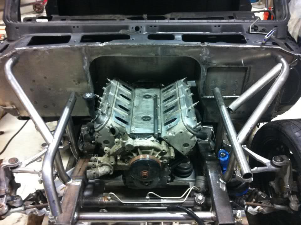

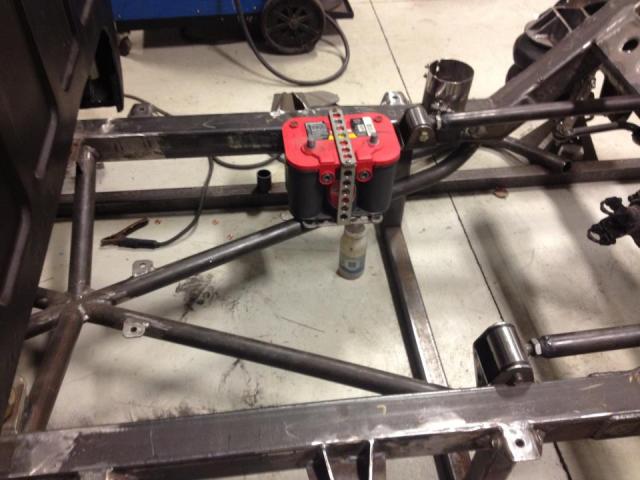

      batter tray is done, not that i needed to do it now but i couldnt get in my brothers way with making the A pillars
      bumper mounts as well as where the rollcage will end

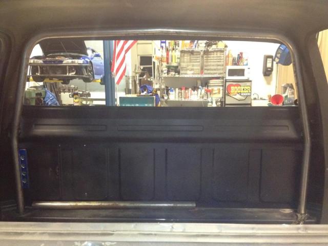

      rear main hoop, tightest cage ive withnessed
      there wasnt enough crank-belt contact so i rerouted the belt and used a C5 AC tensioner and regular LS pully to make it work

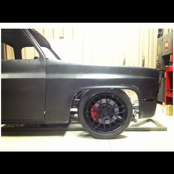

      This is a rough photoshop of the ZR1 wheels that i may end up running, the steelies arnt allowing me to steer at all and flaring the fenders isnt an easy task to make it look good.
