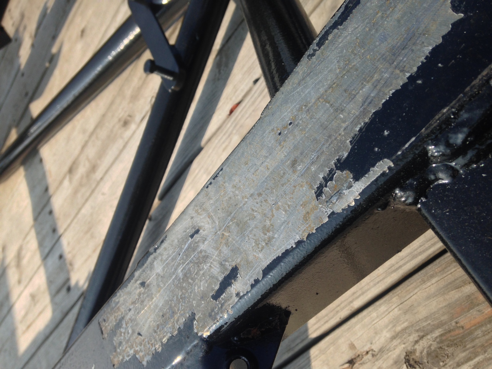

      I wish I had, I purchased rust billets chassis paint kit, it comes with a phosphoric acid to etch the scale on the metal, worst idea ever. I followed all directions and you're supposed to wipe it off with warm water. Well when we did it it came back and kept etching it, we usedLacquer and scotch brute but it still ****ed with the paint. Black coat on top now. I just finished painting so I'll snag pics tomorrow

      so rust bullet sucks, more so the etch meathod i believe, paint didnt adhere to the metal

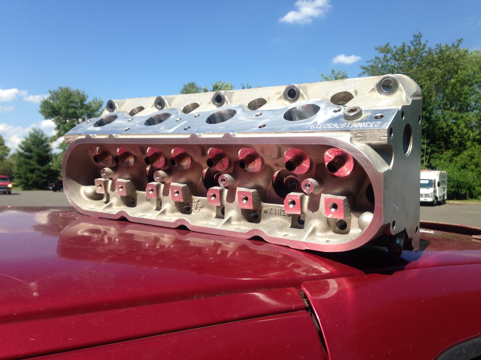

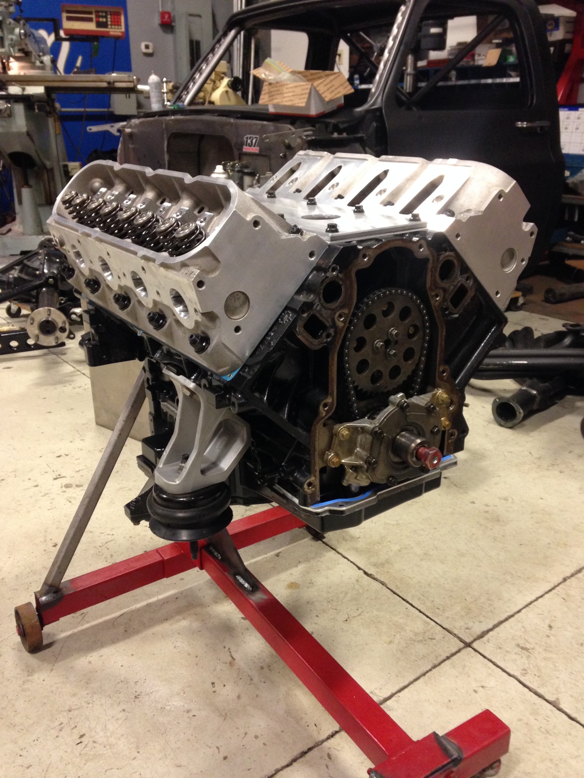

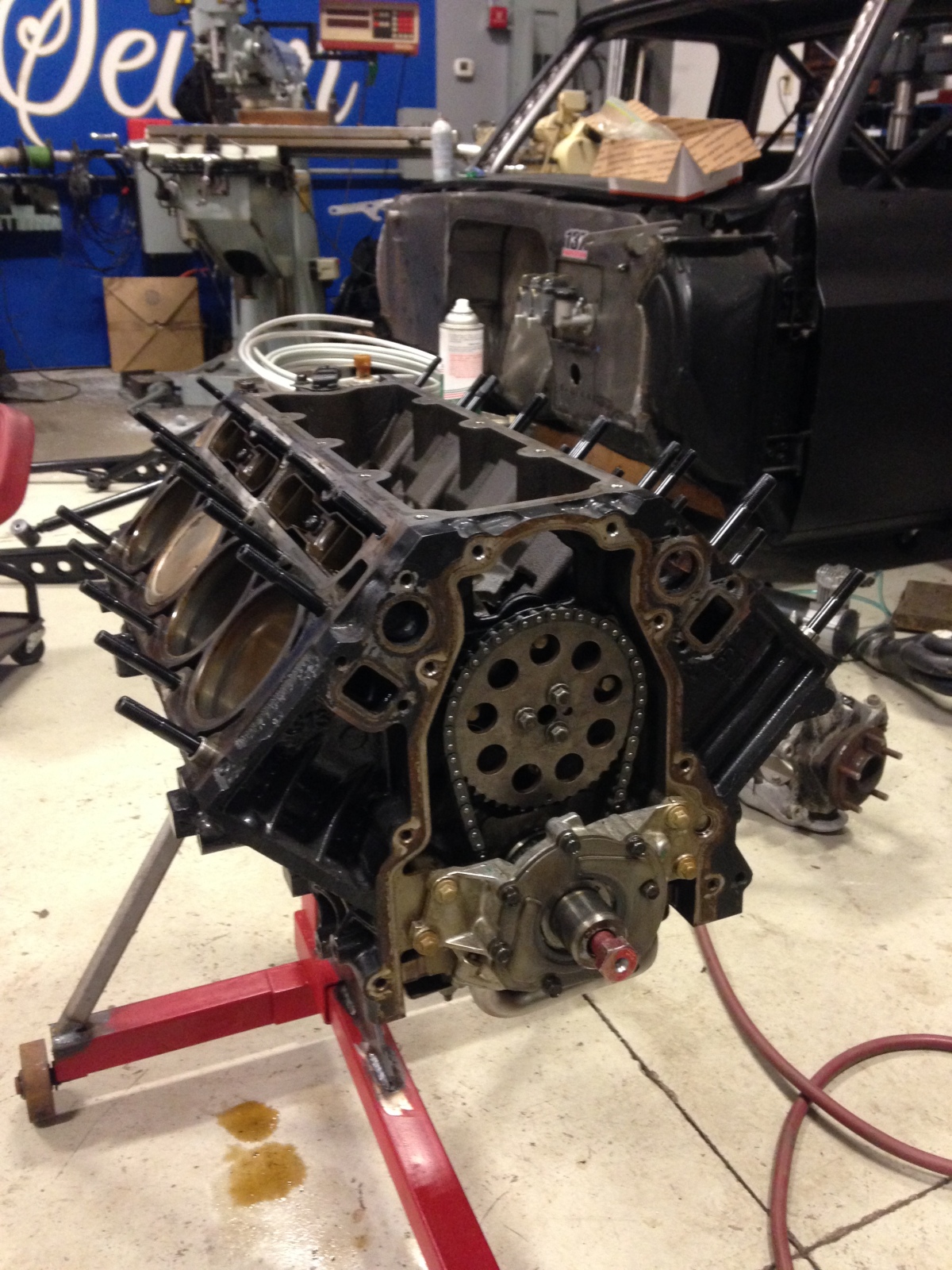

      cleaned the heads up, matched, valve seals, and a little casting clean, along with new springs

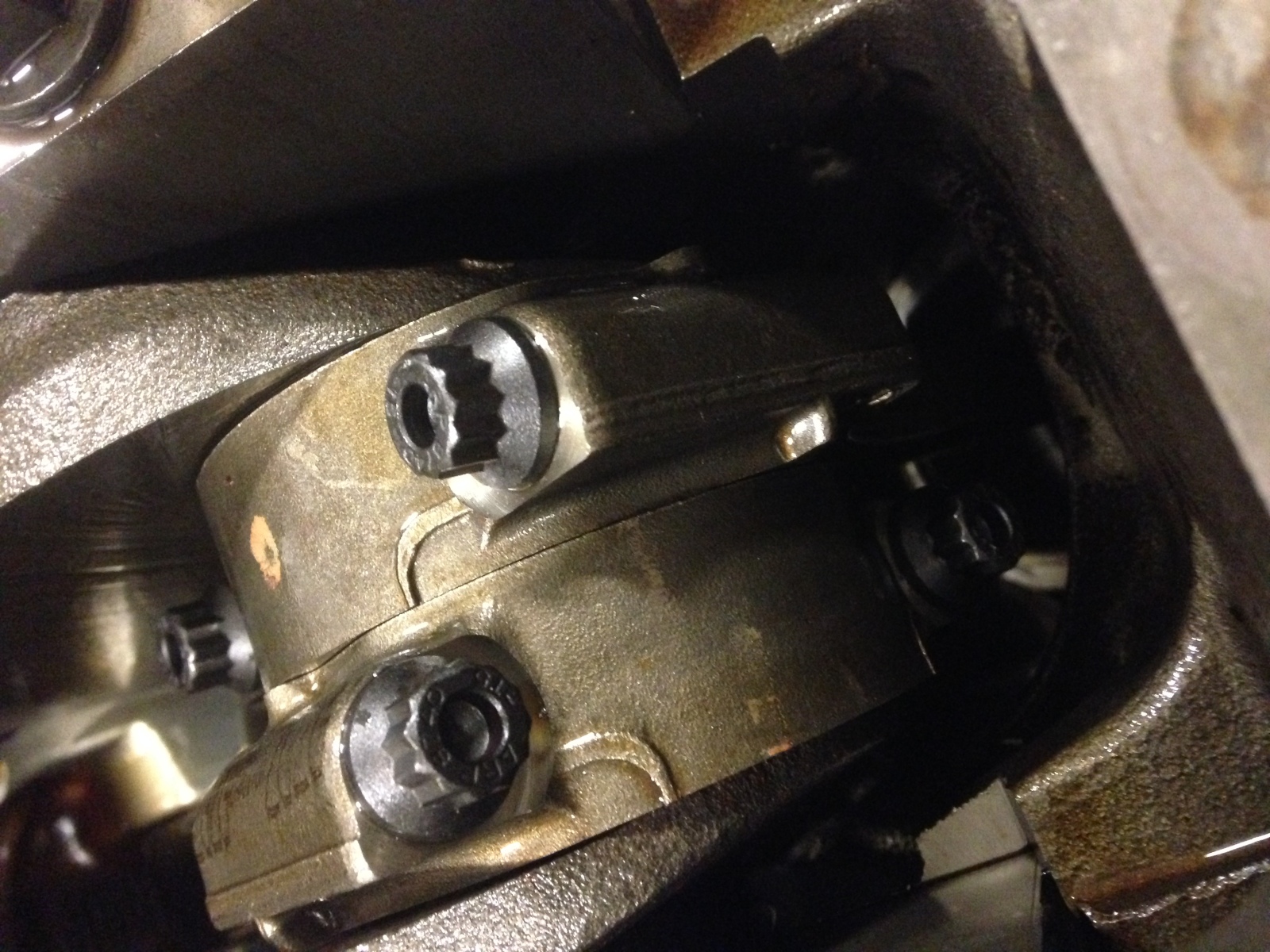

      ARP'd out the 6.0l

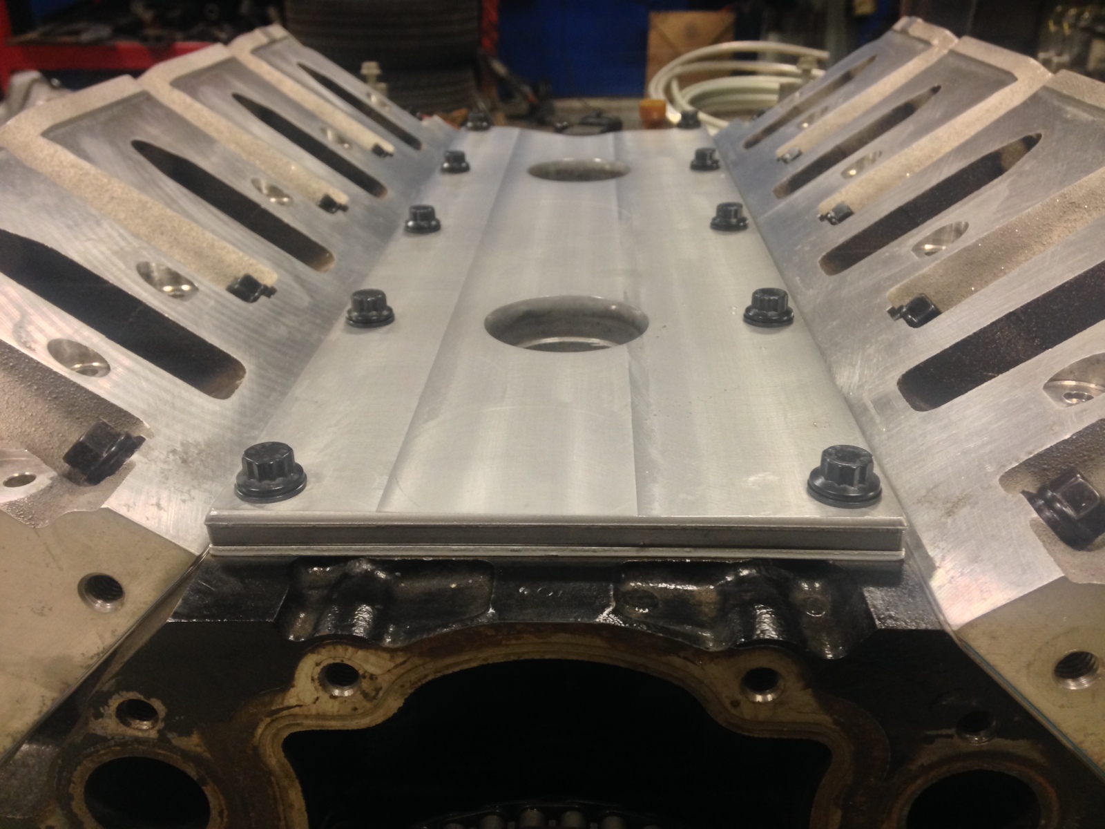

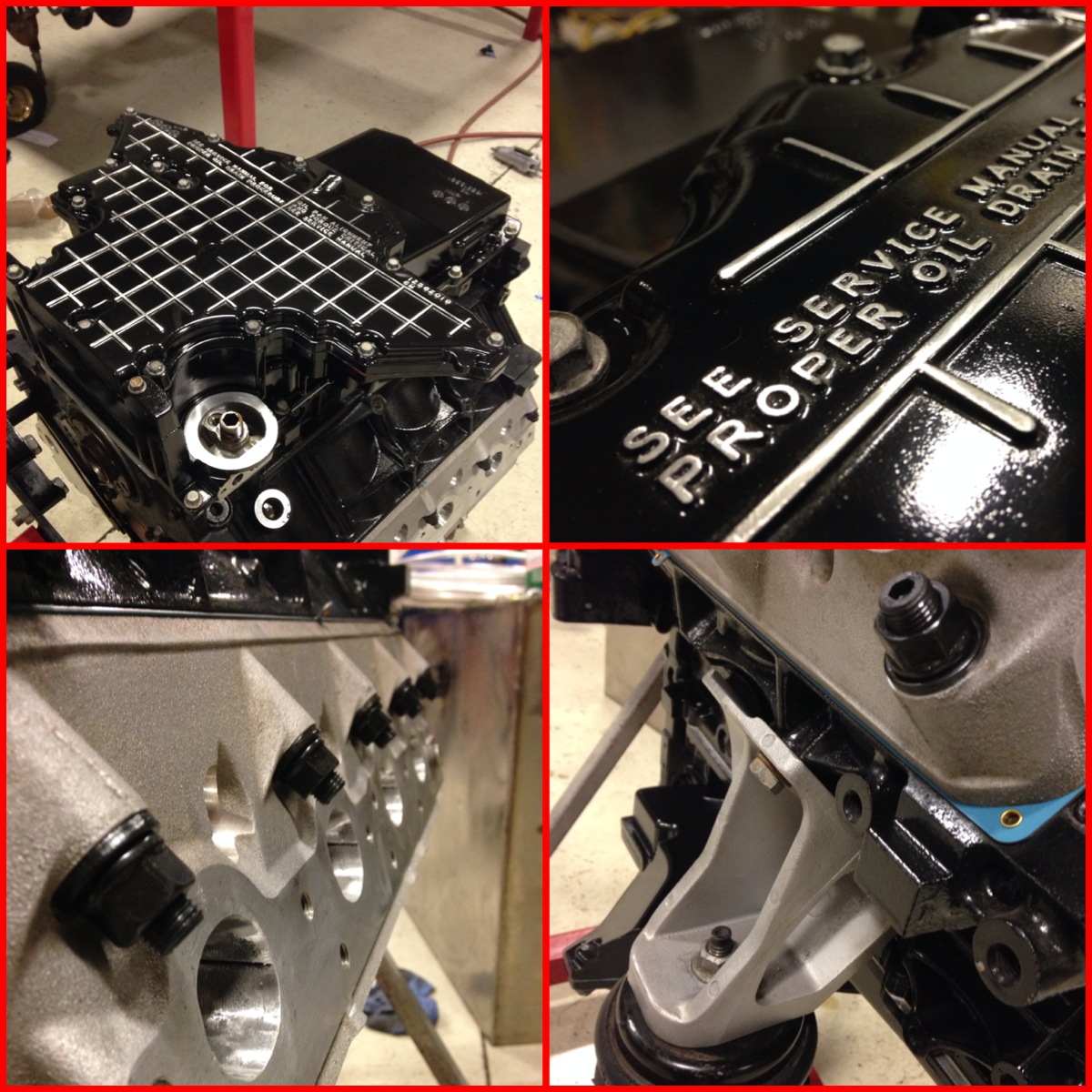

      milled the lifter valley cover flat so it didnt look so crappy
      cleaned and painted the oil pan, glass bead the motor mounts

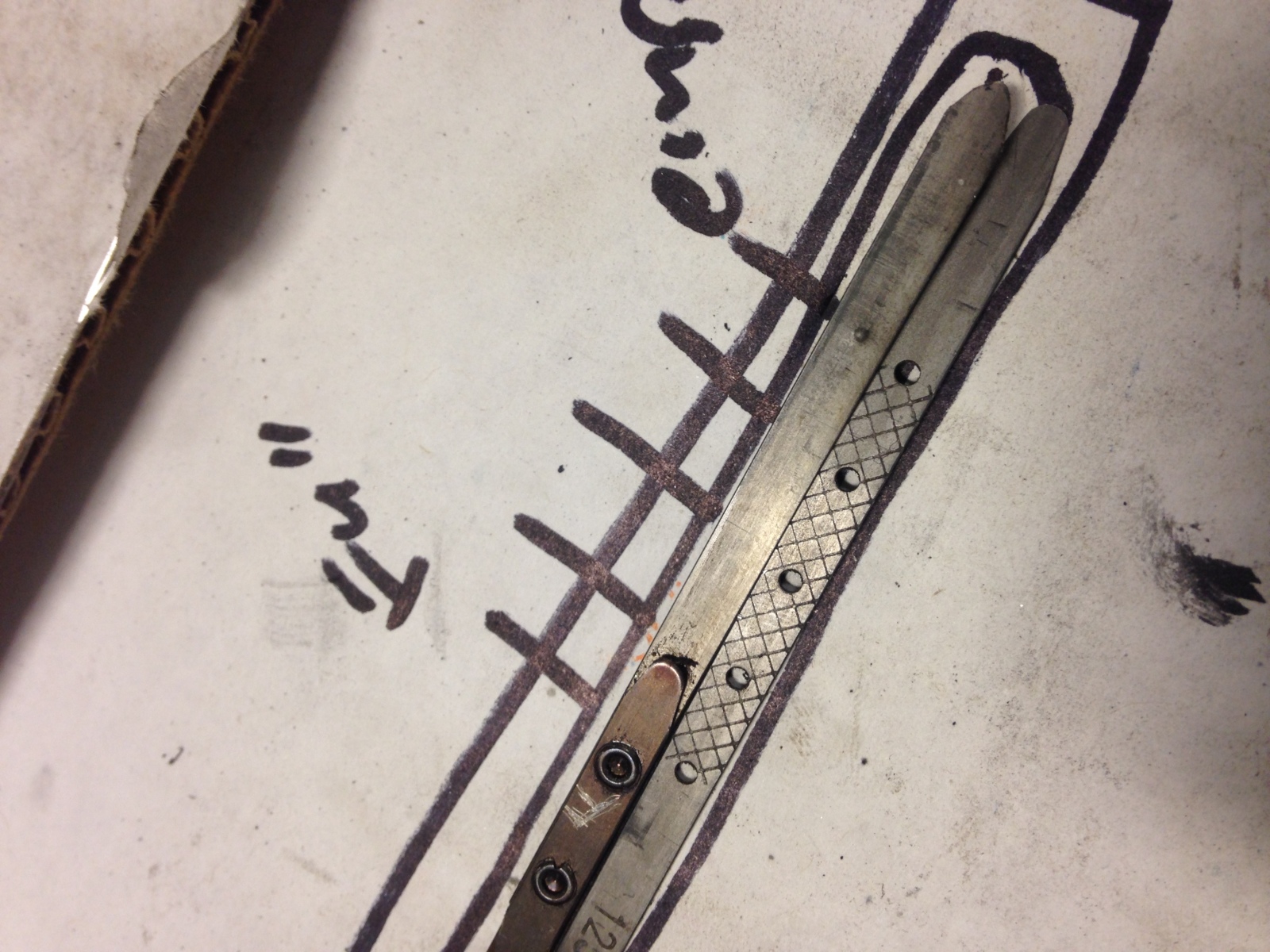

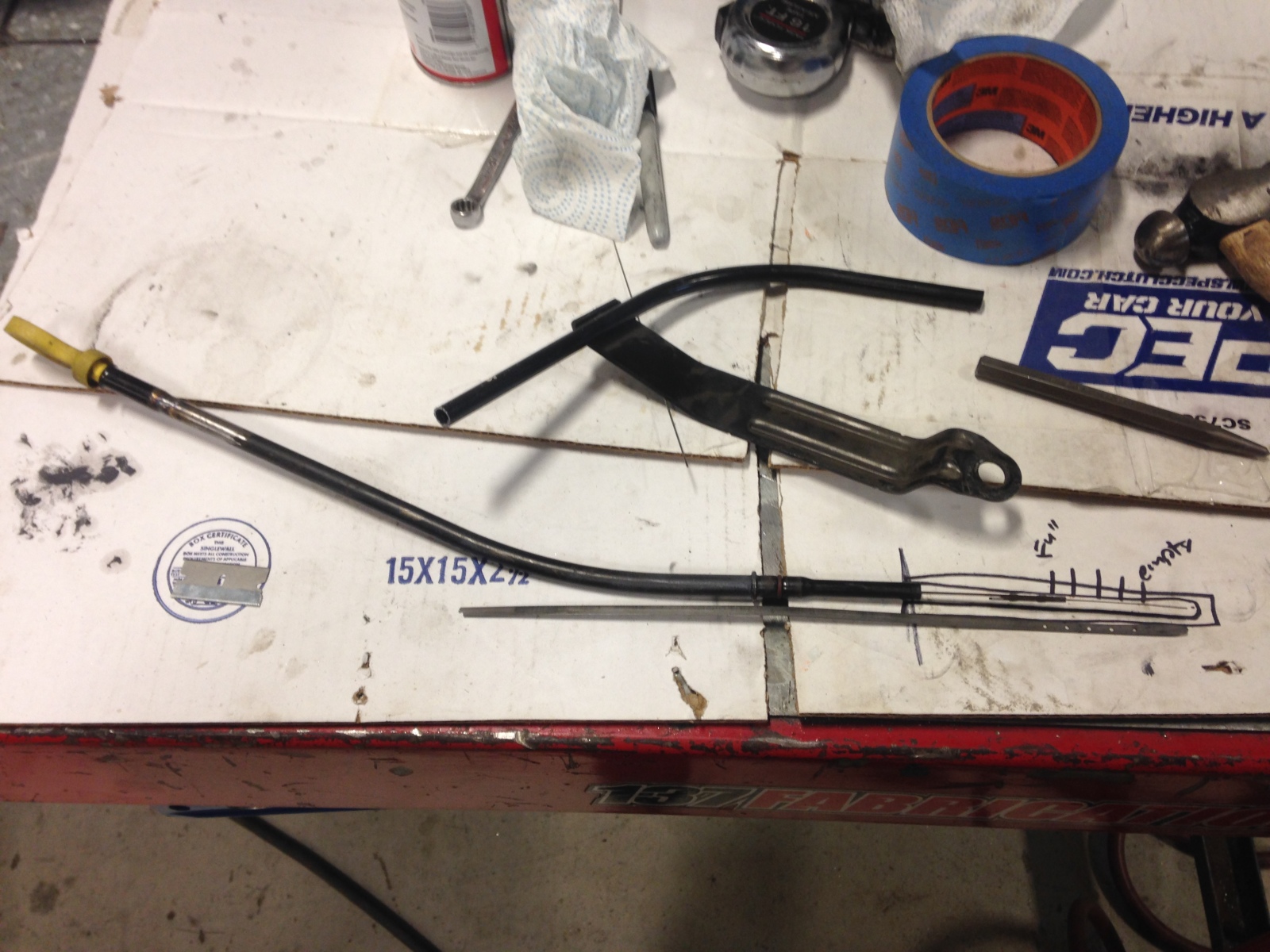

      Shortened up the dip stick

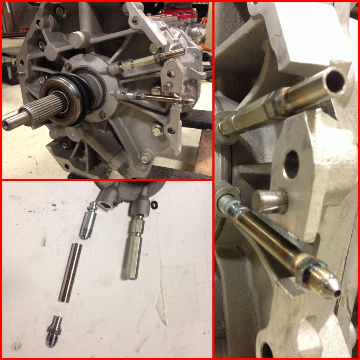

      made my throwout bearing -3an and extended the bleeder

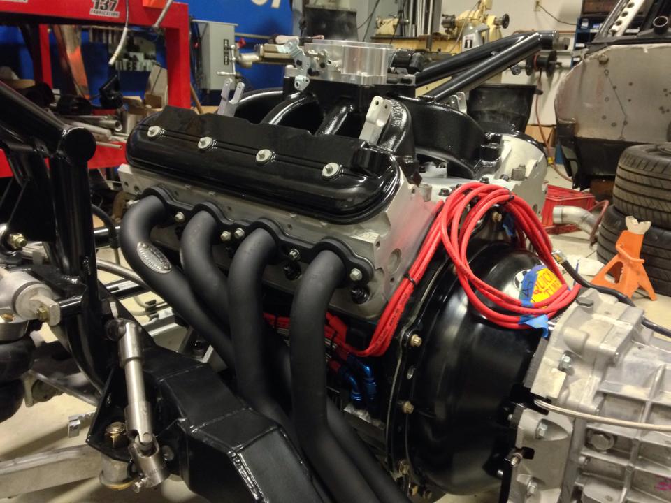

      as she sits
      other than the paint lifting i did all of that yesterday/last night. i used my strike of motivation

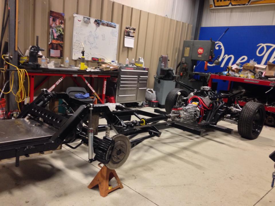

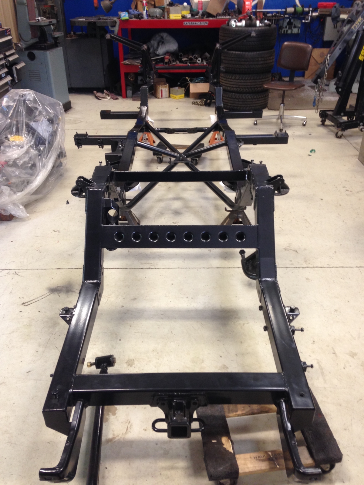

      i installed the rear end, fuel cell, shocks and rear breaks tonight:
      waiting on the new rack and pinion for a c5 corvette before i can touch the front

      But a trailer hitch? haha

      Heck yeah. I have a boat, and some friends with drag cars and trailers that I have no problem towing to the track. It's a truck it needsto be worked

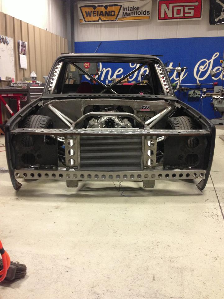

      So I didn't have enough space for duals and I picked up some stainless 4" magnaflow race pipes at a swap meet so I modified one to be 3.5"in 3.5" out.
      on the chassis alone I have 103 dimples, the cab has 40, and I'm not sure about the front fenders or the clip because they're in storage. But thanks for Making me count them I never even thought about it!

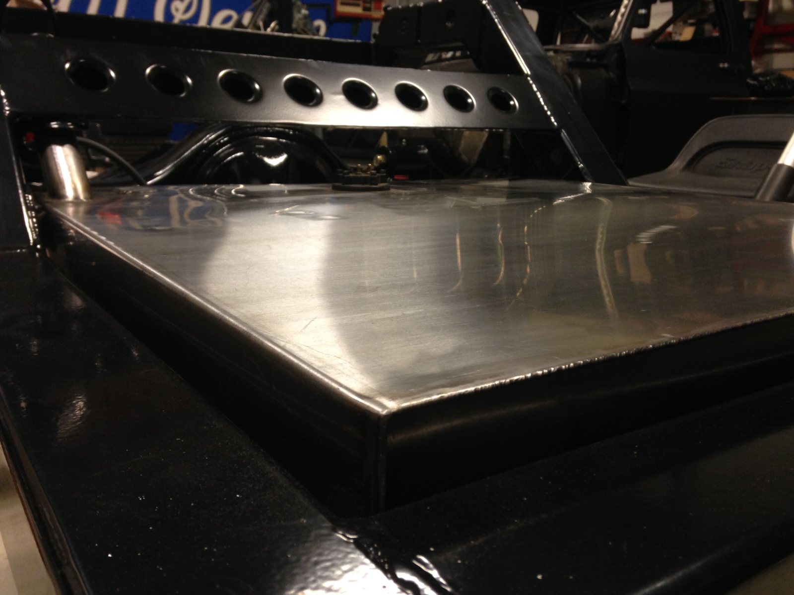

      Polished the tank
      got some work done tonight let me tell you...

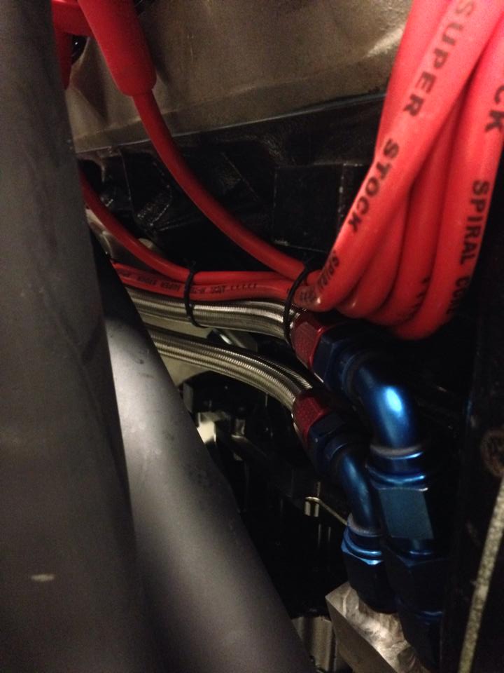

      tucked the wires

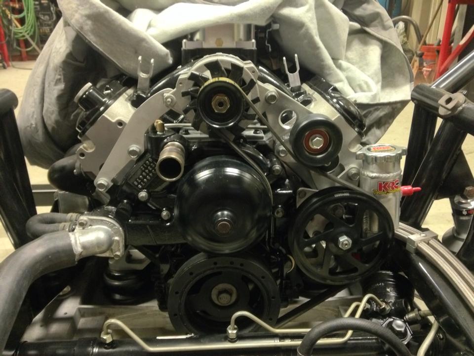

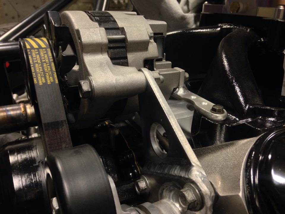

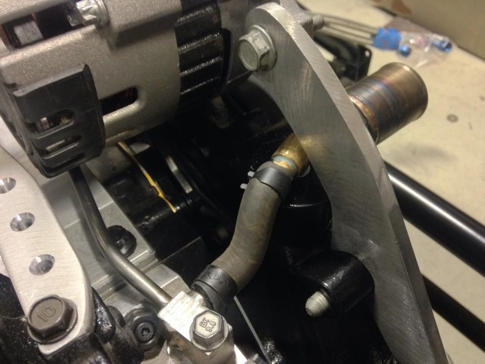

      finished assembling my accessories, also made my steam port cross over for the heads and fit it to the waterpump
