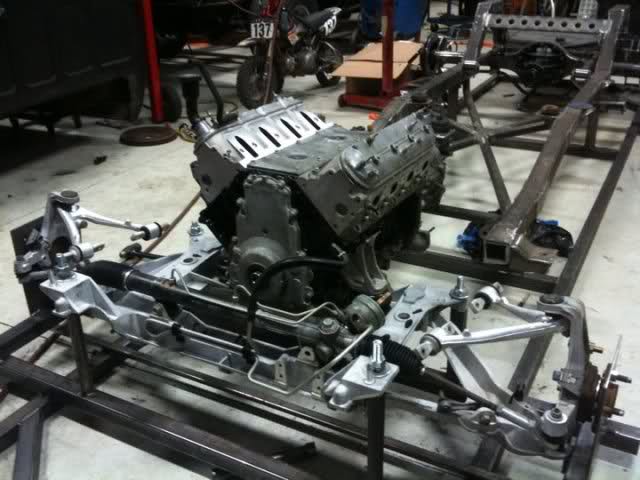

      C5 suspension, LQ4, Tic T56, Ford 9 air ride Technologies fron Air over shock

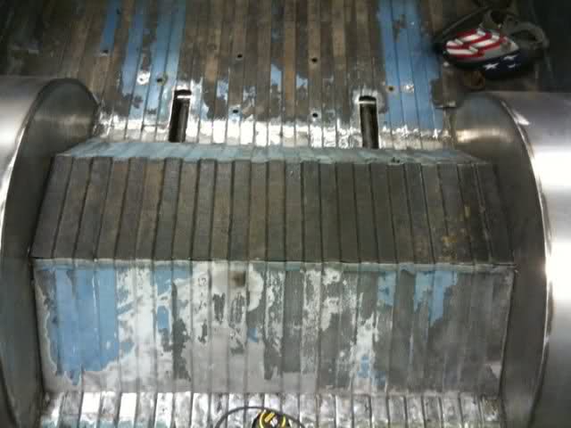

      custom 316 ss gas tank 22 gallons

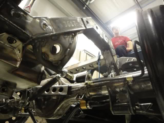

      heres my rear

      the frame was upside down in the fuelcell picture (hence the sump on the top)

      this is my favorite part about the whole truck i think, is this stupid little SS 3/8 16 bolt that i drilled out and made into a breather for the axle. granted i still the design from ford, its kinda the ATD im going with
      oh and using weld nuts everwhere. i mean who wants to hole Two wrenches when you need things done fast?

      Been working my ass off, and schools been killing me, butttttttt i purchased these babies
      ridetech 4.1" 32 way adjustable compressing and rebound
      The passanger side has gone smooth. When i talked to ridetech they said no one there has made C5 front suspension work on airbags... well i have. i made plates for the Control Arm that integrated the shock mounts with the plate as well as clamping the L channel of the arm (since it it forged aluminum). I didnt want to drill it because forged aluminum is prone for cracking at a hole without a boss, and you cannot weld it without losing its structure.
      Then the driverside frame got in the way.... so i cut the frame back apart and am sleeving the tubing for the rack and pinnion steering shaft (didnt have the shocks when i made it)
