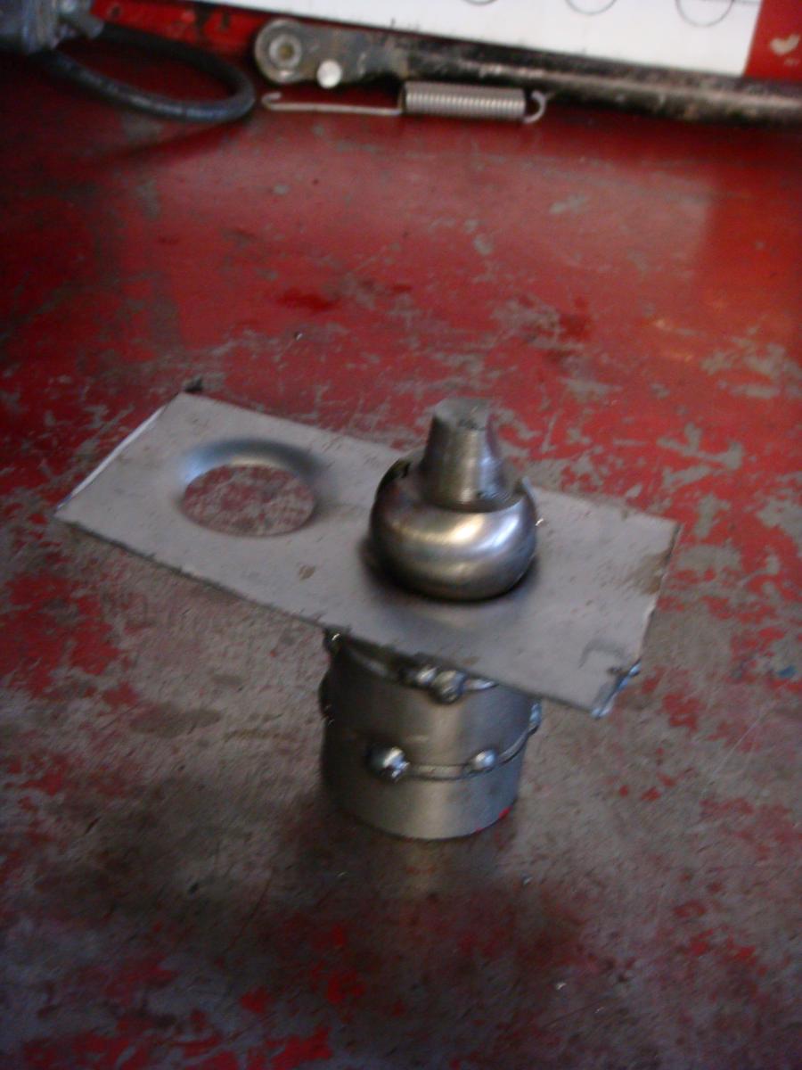

      Tools are expensive. especially dimple dies. I only needed to stamp a handfull of 1" holes, So i decided to make my own. I t may not be as good of a dimple as the real tool would make, but it's good enough for me.
      I had a peice of a broken shifter lying around that has actually been one of the more useful tools in my garage. I've used it to remove dents in dirt bike headers, and now it seems to be the right shape an size fo my home made dimple die. The back side of the die is just left over DOM tube from my roll cage with a couple of washers welded to it to keep the shifter piece stright while I am pressing everything together.
      Zach

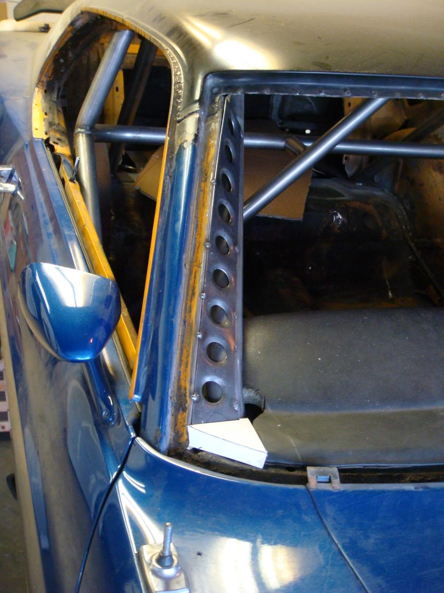

      Heres the finished product using my homemade tool.
      Zach

      Quote Originally Posted by AusMarty View Post
      Aww, nifty.
      Mind if I copy that?
      couldn't stop you if i tried at this point. Just a heads up this tool worked great up to 16 ga, but that was just using a vice. I suspect with a press I could relly test its limits, but I doubt it would do vey many 1/8 thick dimples before it ruined the tool.

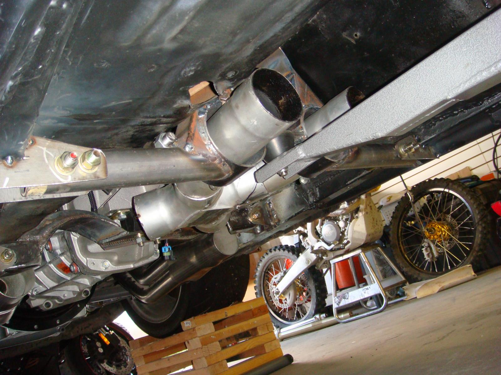

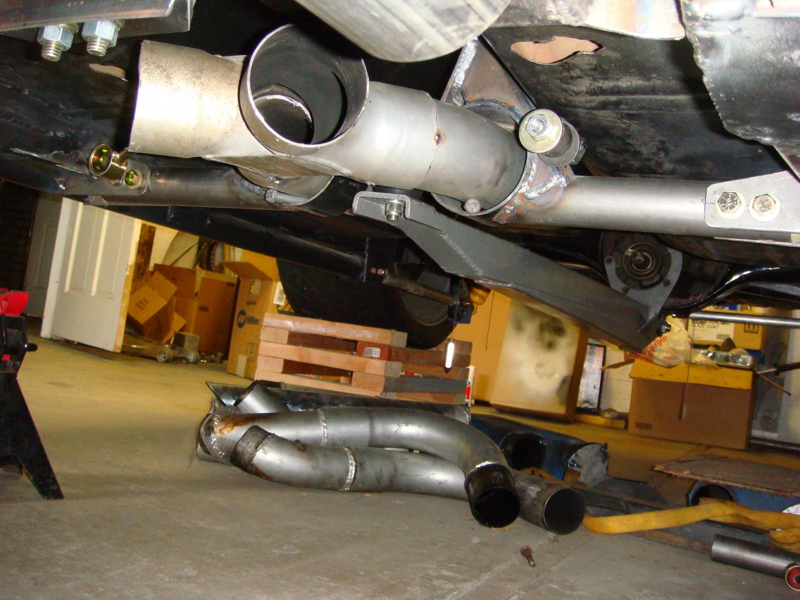

      It's a bit counter productive to re-do completed parts of the car, but I couldn't find a good way to route the exhuast past the torque arm mount without some major refabrication. I should get some better pictures of this, but here is what I have at the moment. the new torque arm mount includes a drive shaft loop, clearance for the exhaust and mounts for the exhuast.
      Zach

      Looking good, as mentioned above your sig is great.
      I imagine it's mentioned earlier but what torque are are you using? I like the simplicity of the mount.
    20. #180
      Oct 2010
      SLC
      660
      Quote Originally Posted by linkstar69 View Post
      The torque arm was supplied by griggs racing. I also like the simplicity, but it does hang below the diff a good distance. I hope I don't have ground clearance issues with it.
