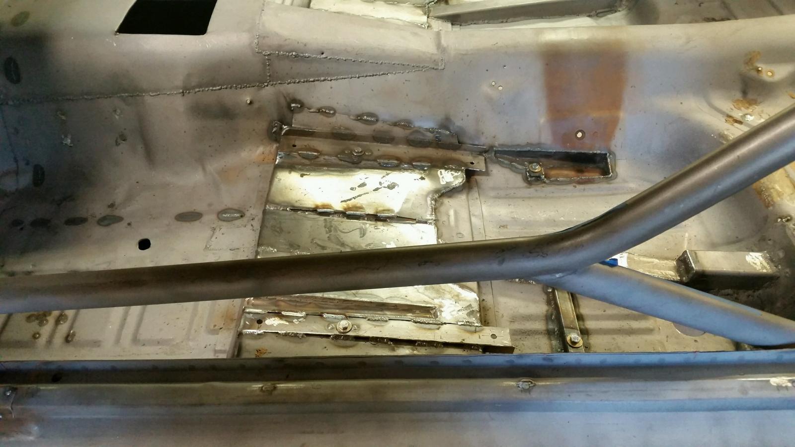

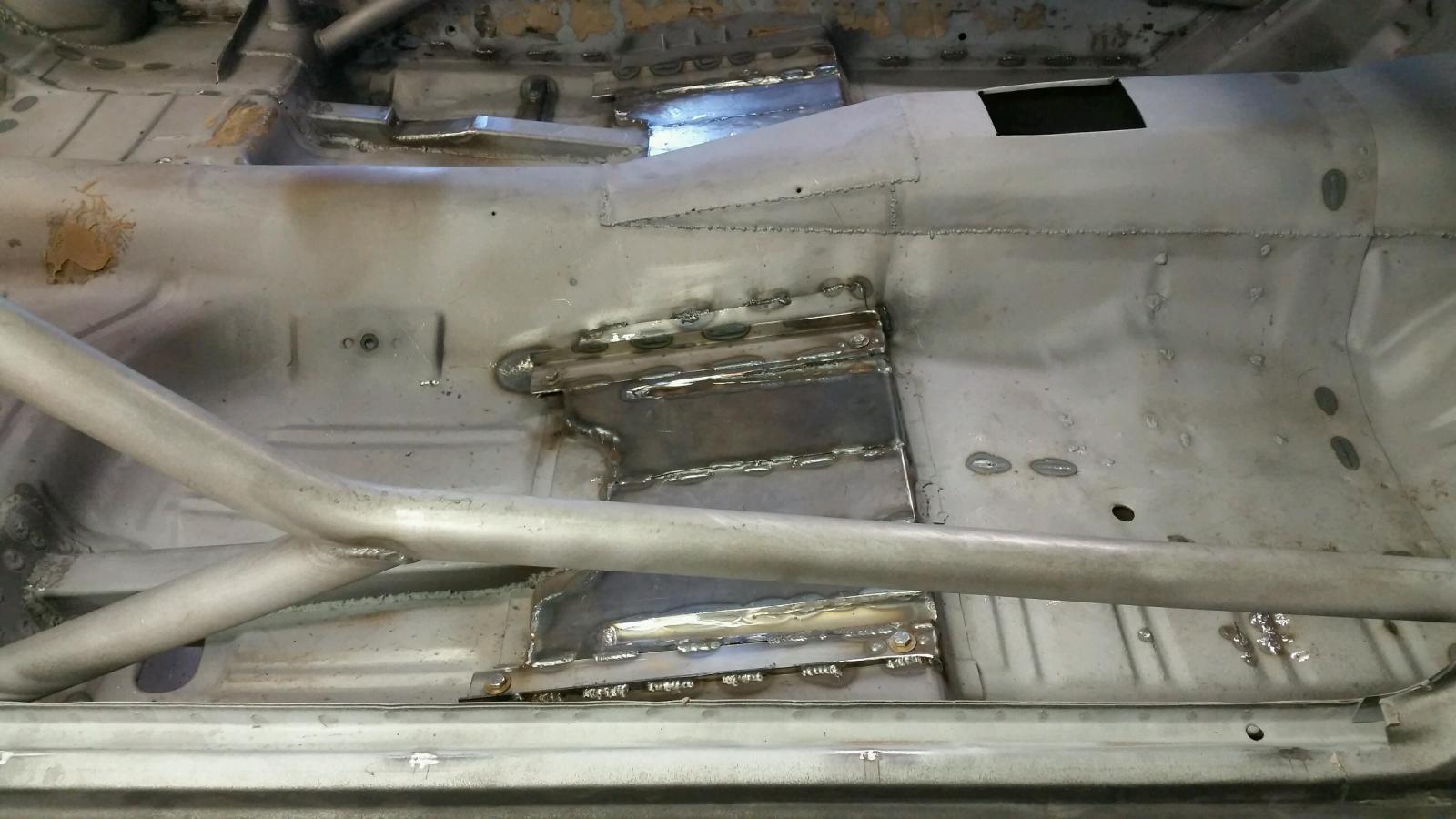

      I also decided to lower the seat pans about 3/4" to give me some more head room.

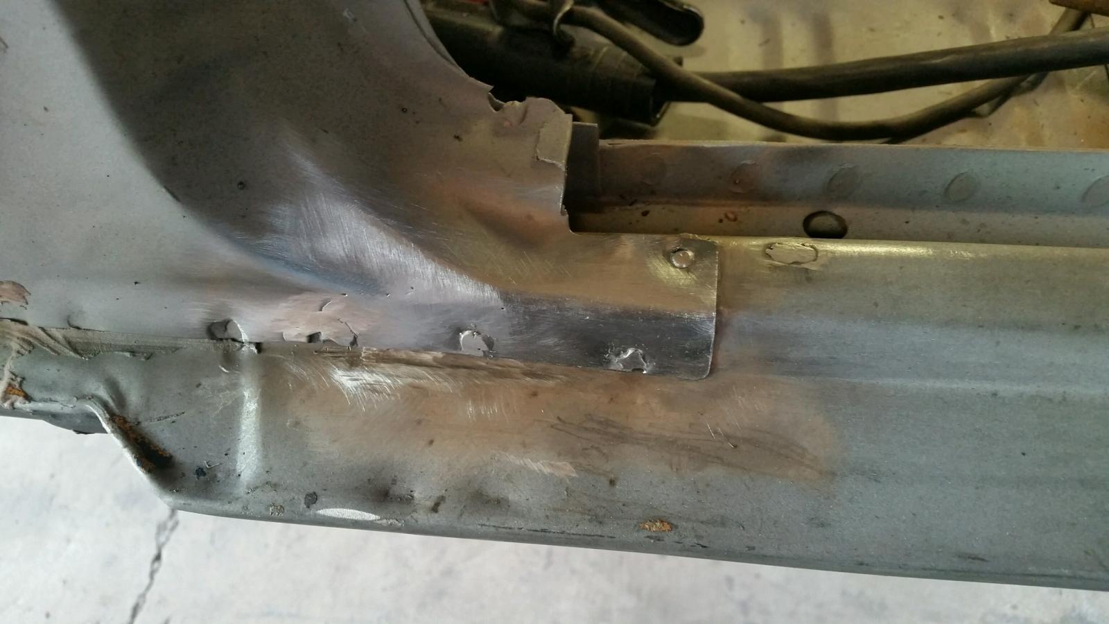

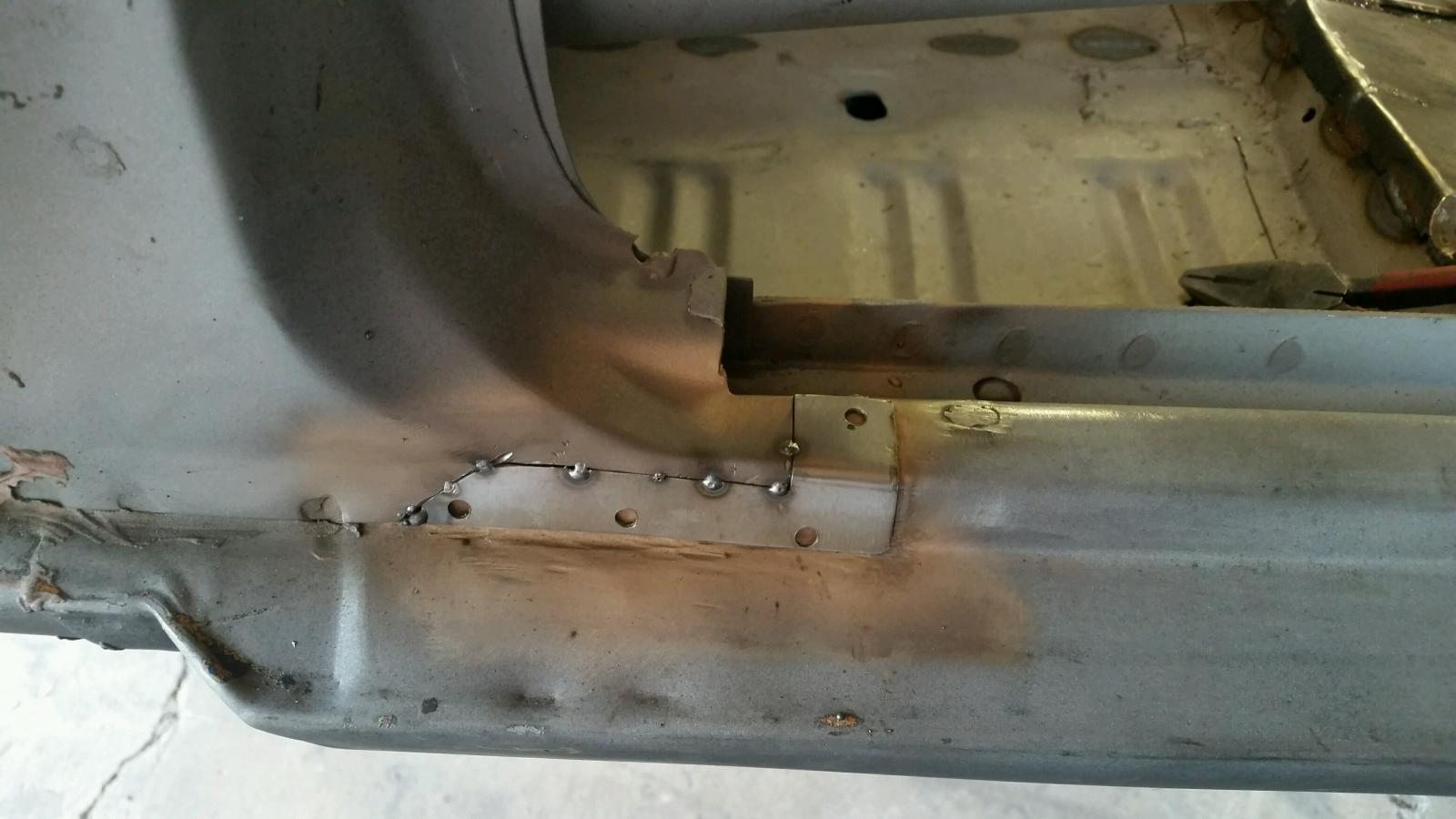

      here's a quick example of the types of random repairs I've been dealing with. this area had been previously damaged and brazed back together. I tried to give it a more factory look.

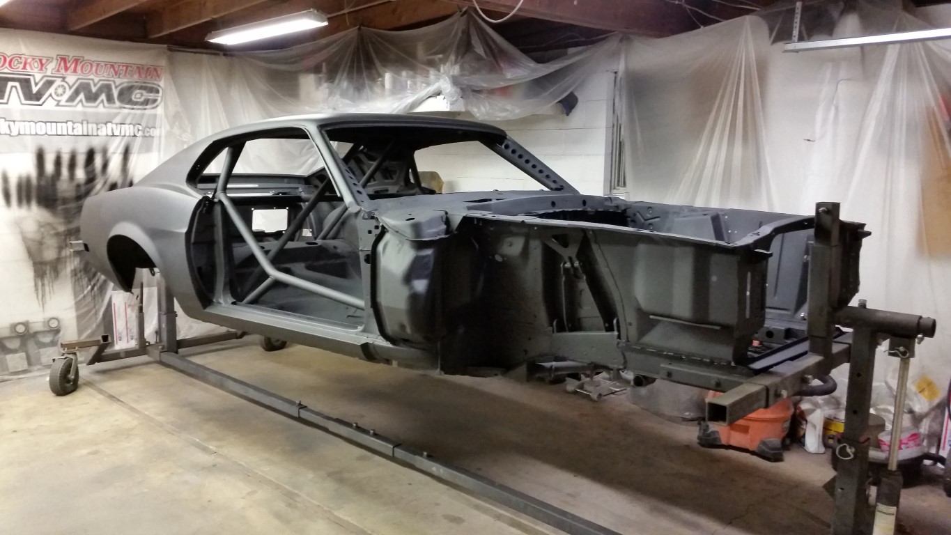

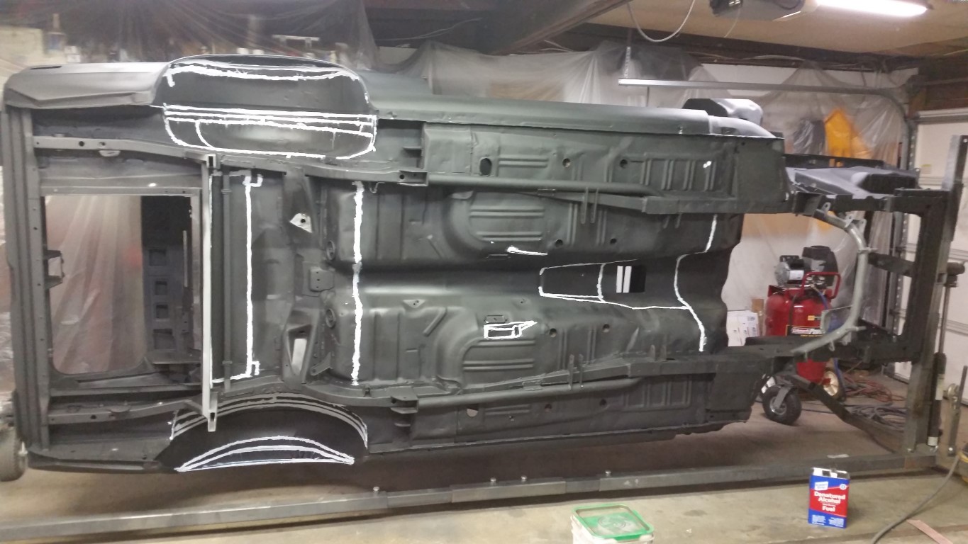

      Lizard skin, engine compartment, undercarriage, and interior done.
      I could start assembly soon, but am debating whether or not to paint the door jambs first. Final paint will be last.
