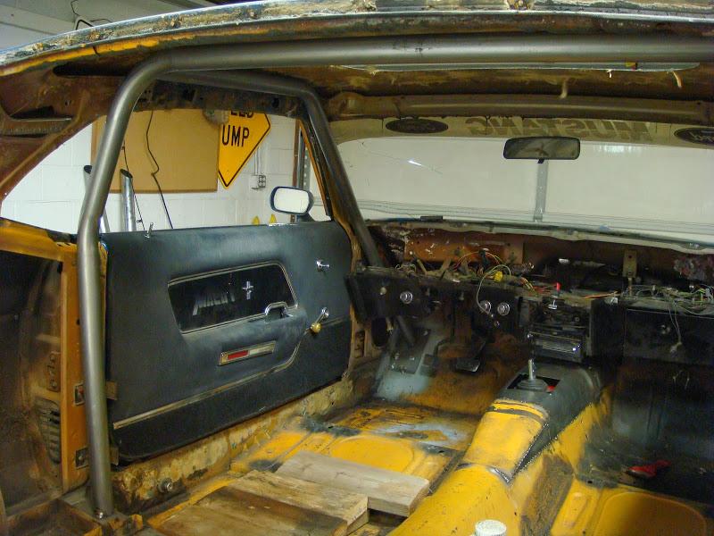

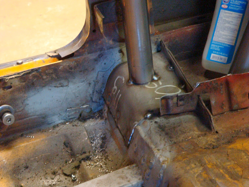

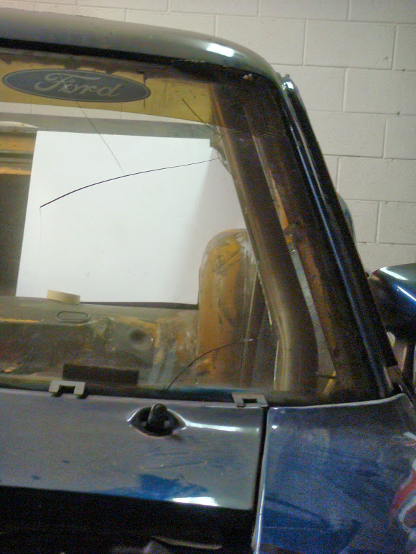

      Started on the roll cage. the main hoop is tacked into place and one of the forward bars is ready. just need to figure out what im going to do with the kick pannel vent door. if I put it in then weld the cage in, it can never be removed. the other option would be to deete it and put a plate over the hole.

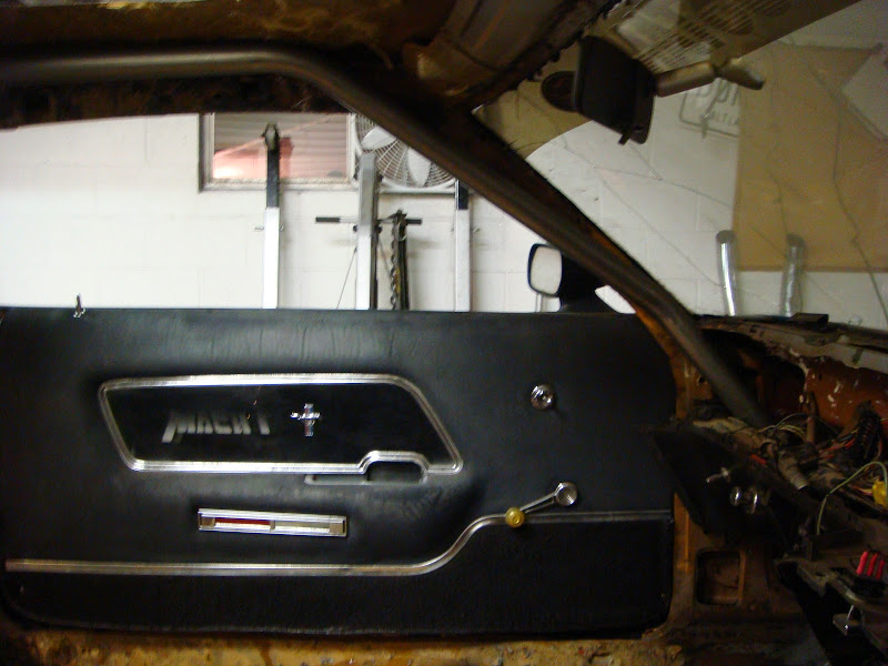

      fits pretty close to the a pillar
      the a pillar bar is intentionally a different angle to provide better visibility. from the drivers point of view it is almost completely in linie with the a pillar, so not much view is lost.

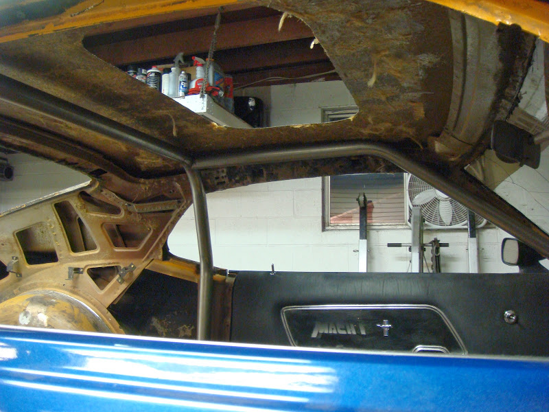

      sun roof?
      yeah, tasteful mod by a previous owner. I'll be replacing the roof skin because of this, so welding the top of the cage should be easy.

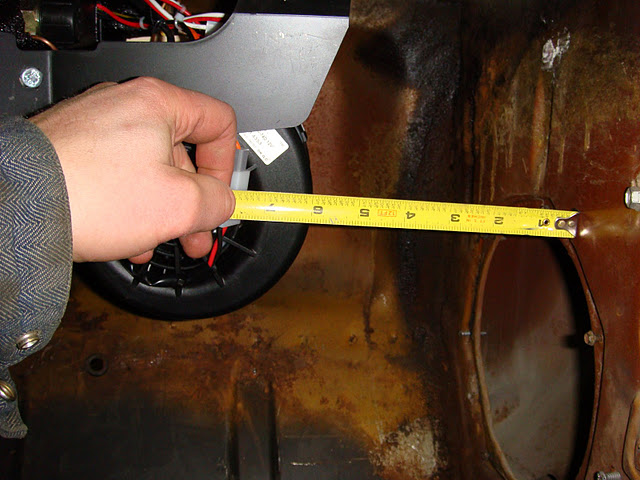

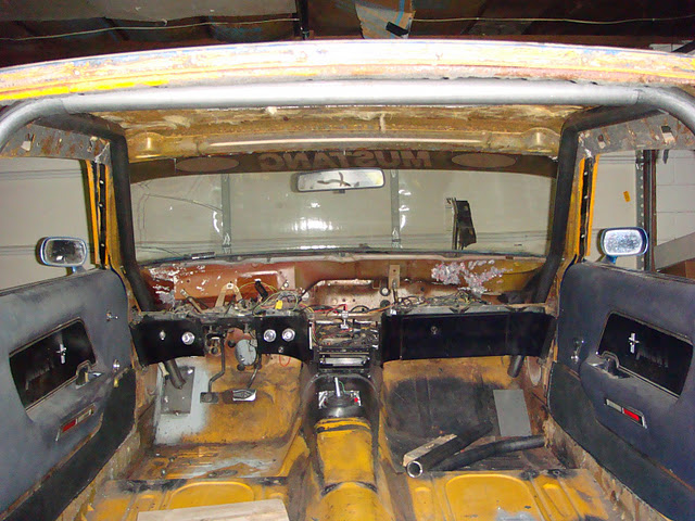

      made a little progress over the weekend.
      I was able to borrow some vintage air stuff from another car I'm working on to help me figure out where to route the right side of my cage.
      here's the original box:
      with the dash in place there isn't enough room to run the roll cage tube in the same place as I did on the driver side.

      I still need to do a little more fitting on the passenger side before I can tack it in place, but I'm pretty happy with the fit.

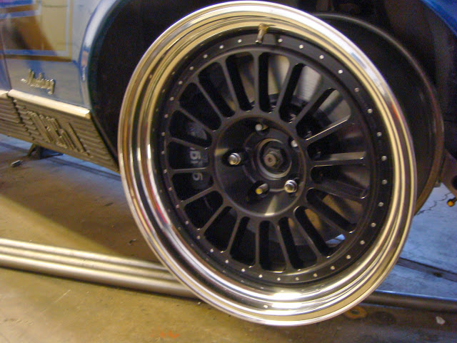

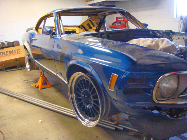

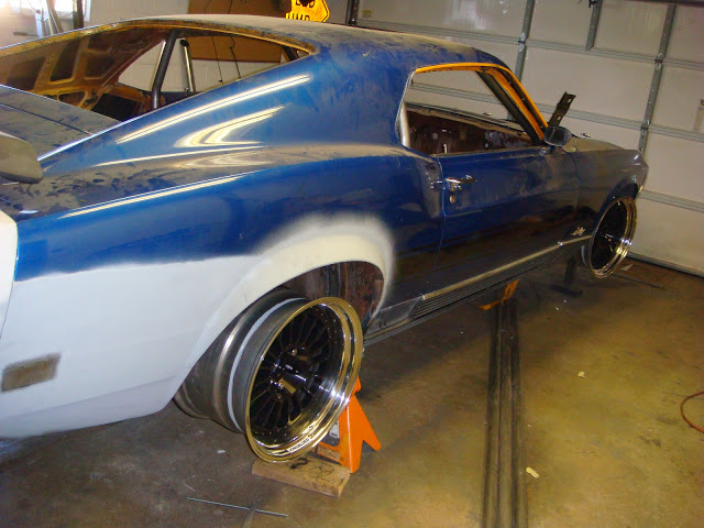

      not much progress to report, just some cool pictures.
      it's discouraging to think that I will be disassembling all of this to finish the chassis.
      Zach
