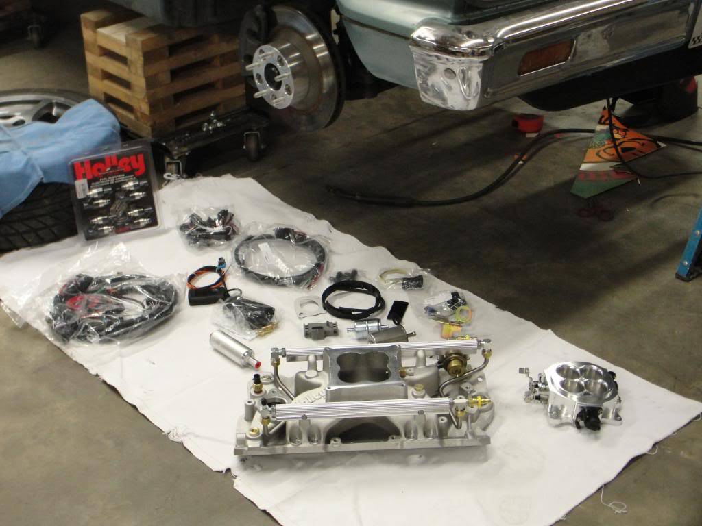

      I mentioned a while back that Deb had won the Holley EFI setup, so here's a little eye candy that's getting ready to be installed on the ZZ4.

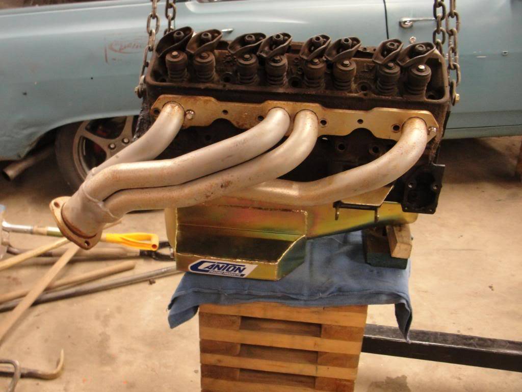

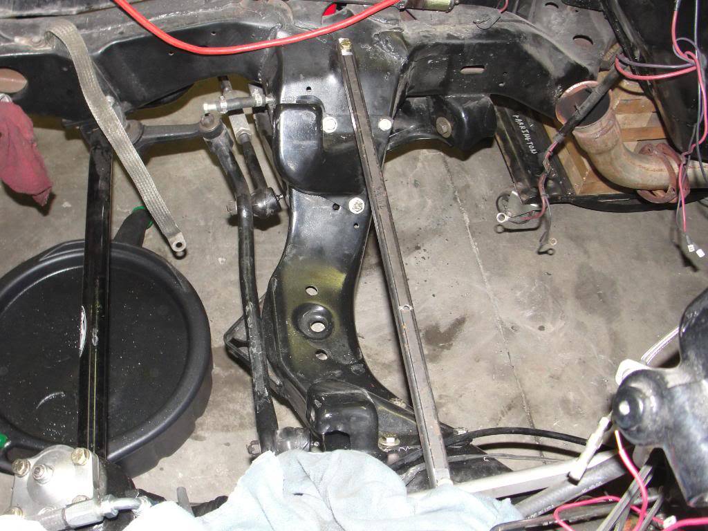

      Then because we really wanted a road race oil pan for the "new" engine we purchased this Canton pan that is really designed for a Corvette chassis. The sump is 13" from front to rear so we knew fitment would be an issue.

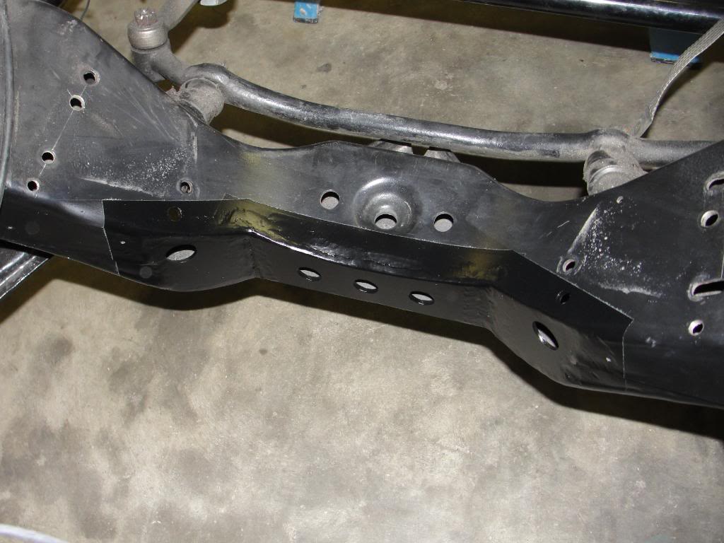

      Solutions; move the motor mount frame stands back 1" and cut a little off the engine crossmember. I've never been a fan of cutting on crossmembers, but I know guys alot smarter than I do it and I'm confident that I can do it without loosing any strength. I'll spare you the pictures of the first attempt where we completed it and it still interfered with the oil pan. Second attempt was much better... I really should know better than to prime and paint something before test fitting! I know the paint is not pretty, but it's the wagon and if anything should stand for "form follows function" it should be that thing!

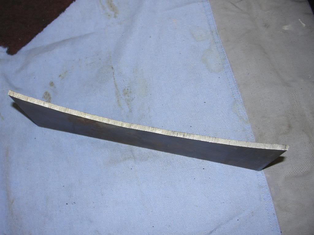

      a little bracing before cutting
      3/16" plate steel

      What seat(s) are you going to run with the T56 change and engine set-back? The bench seat might require a heck of a curved shifter handle..... you may have already said, but I forgot.

      Nice job on the engine set back Tom! Deb's going to be tearing up the autocross come summer!

      Nothing firmed up yet. I planned on a set of ebay seats like we bought for Sam's car, but Debbie said no. We'll probably end up searching the local pic-a-part and pull-a-part to find an oem takeout. No matter what, the bench seat has to go. Deb is done sliding around while cornering!
