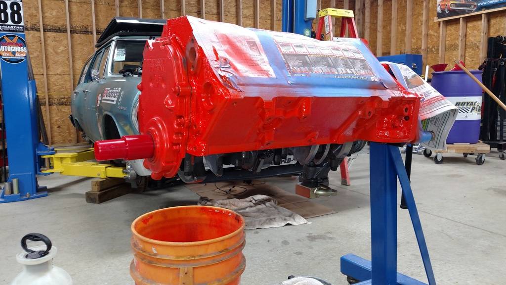

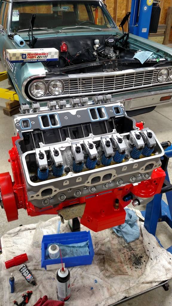

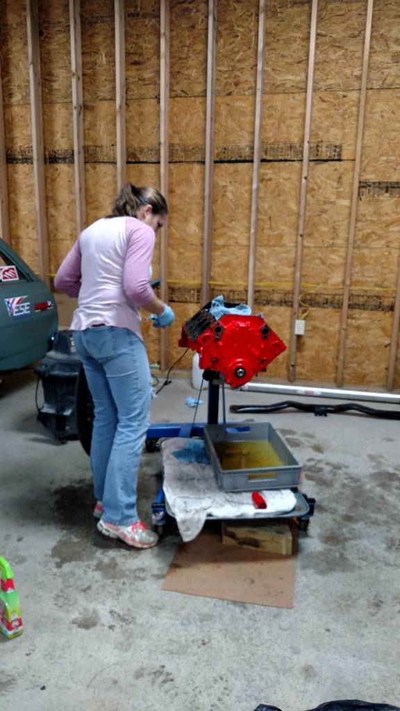

      Finally getting around to bolting on the GMPP Fast Burn heads. Since everything was looking pretty dingy we decided to yank the engine and detail things a bit at the same time. Deb, cleaned the heck out of it before the fresh coat of paint.

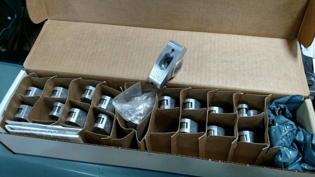

      After buying the heads I found out that the new version of the Fast Burn heads use beehive valve springs and they get a little more top end out of them so I figured we had to upgrade to those. Then just a couple of months ago Hotrod did a story on the new ZZ6 engine and they made significant improvements by adding 1.6 ratio full roller rocker arms so I found a new set on ebay and executed that plan. Of all the performance things we've done, this is the first small block we've had with full roller rockers. They also look cool to me!

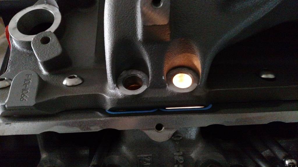

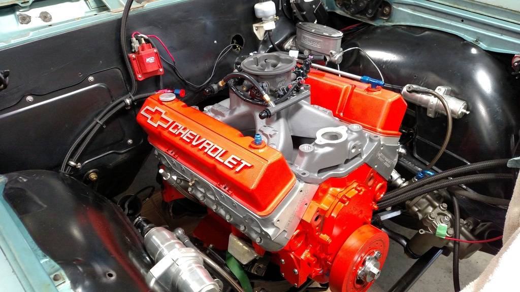

      The big issue came when we went to put the Holley Avenger port injection intake back on and realized that I could look right down into the intake ports. I had read that they had .240 raised intake runners a hundred times but never made the connection on what that meant...
      We basically had a handful of options but the one we chose was to buy a Chevrolet Performance single plane intake manifold (same as the ZZ6) and use a Holley throttle body injection system instead of the Holley Avenger port injection that was on it. I bought the Terminator system last year for a 1985 Suburban that I'm working on so it was just sitting there. Now the Burb will get the tried and true Avenger system that has been on the wagon. The only hassle was removing the Avenger ECM and harness and replacing it with the Terminator one. At least they mounted the same way. With Sam and I trying to get it out from under the dash it looked like we were playing twister.
      So that's where we stand today. Hopefully tomorrow when I get home from the firehouse I can start to button things up. Still lots to do!

      The head swap and intake deal has been a little frustrating but we know that's just "hot rodding" and it would be silly to get fired up about it. We also found that we needed special gaskets for the Chevrolet Performance intake that were .120 thick. I have a stack of other Fel-Pro gaskets on the shelf that didn't work. Live and learn!

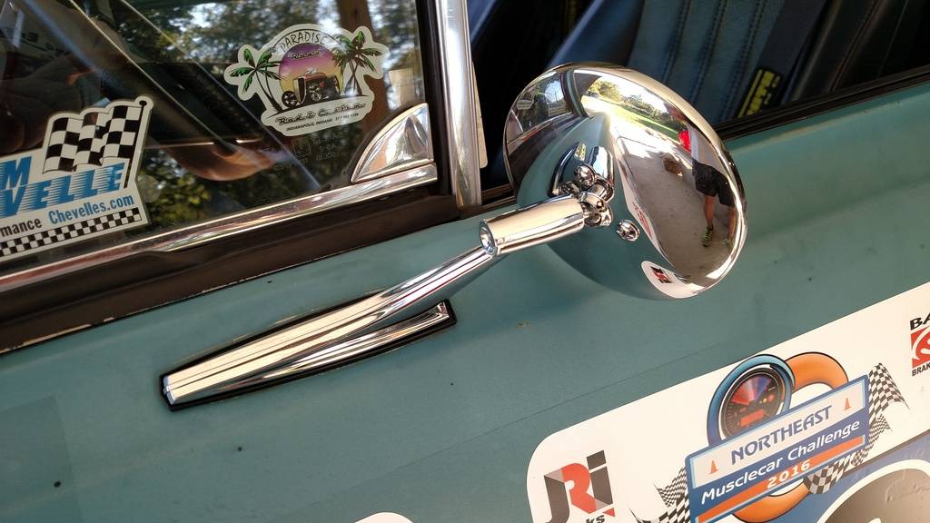

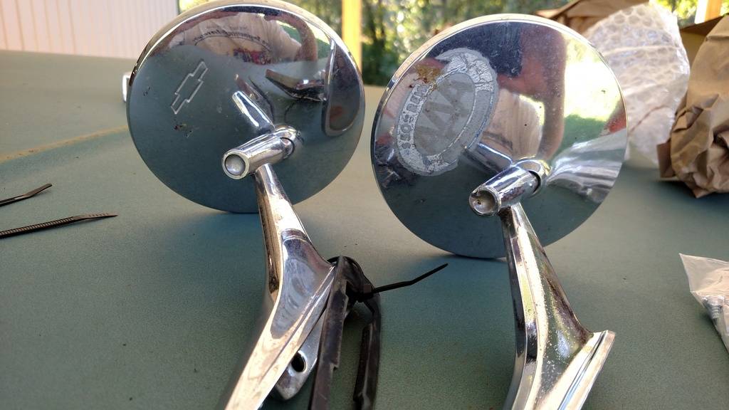

      We installed a set of Morris Classic Concepts mirrors on the wagon yesterday. The old mirrors were cool but at high speeds or door slamming they flopped around. I ordered these for a friend/customer a couple of years ago but because the way they sat in their car they didn't feel like they could adjust them correctly. So, they sat on my shelf all that time until we were finally fed up with the old mirrors. All good now!
      The old mirrors were cool especially the one with the AAA decal on it.
