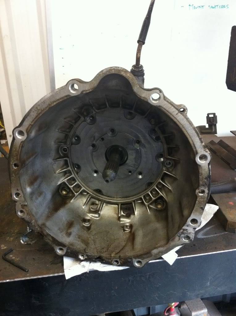

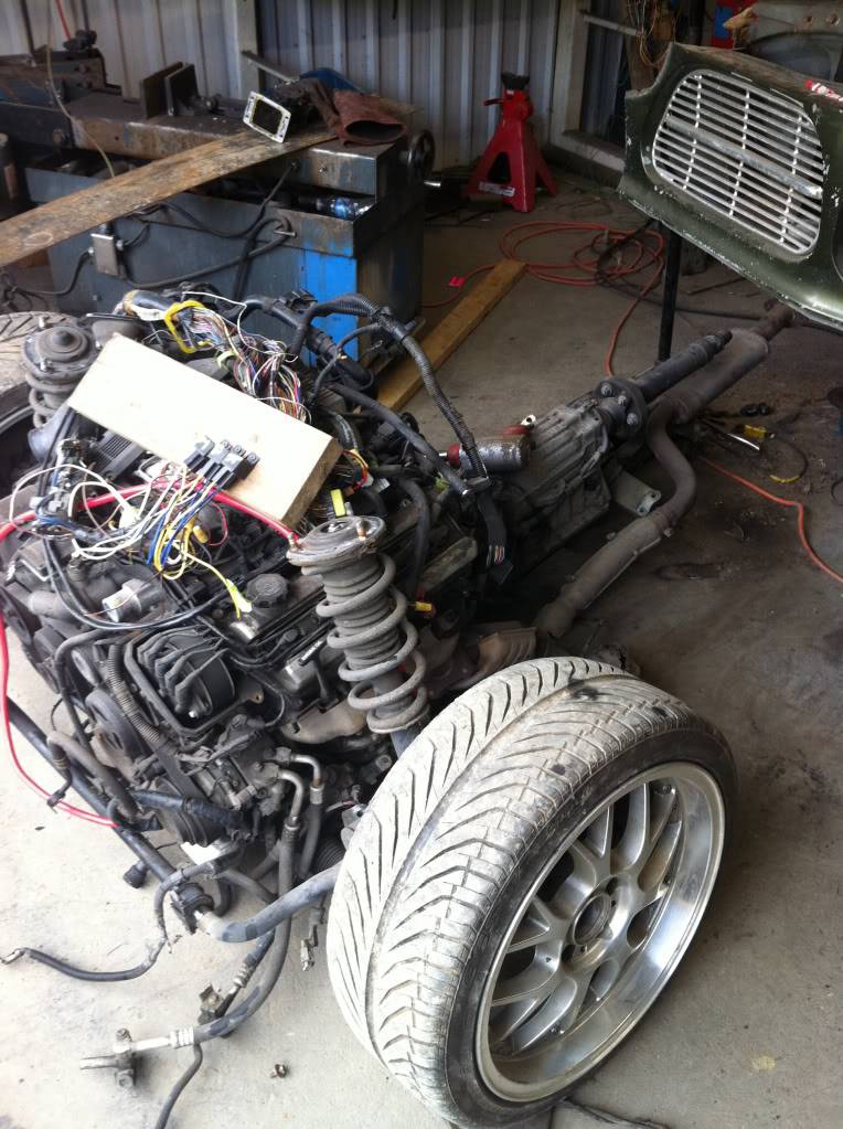

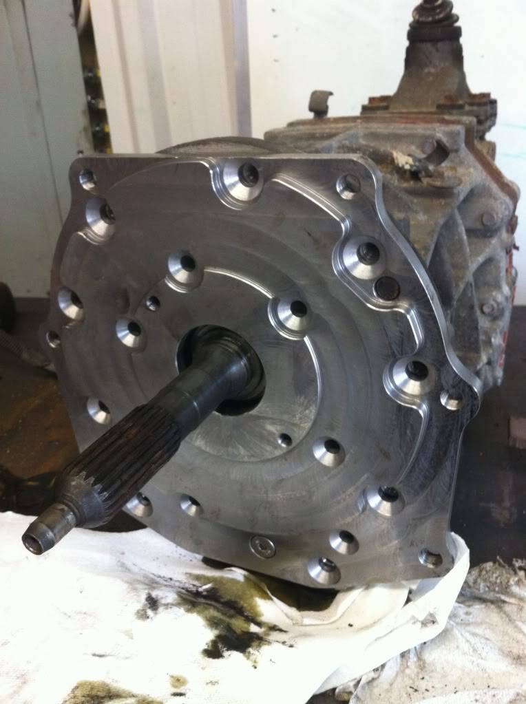

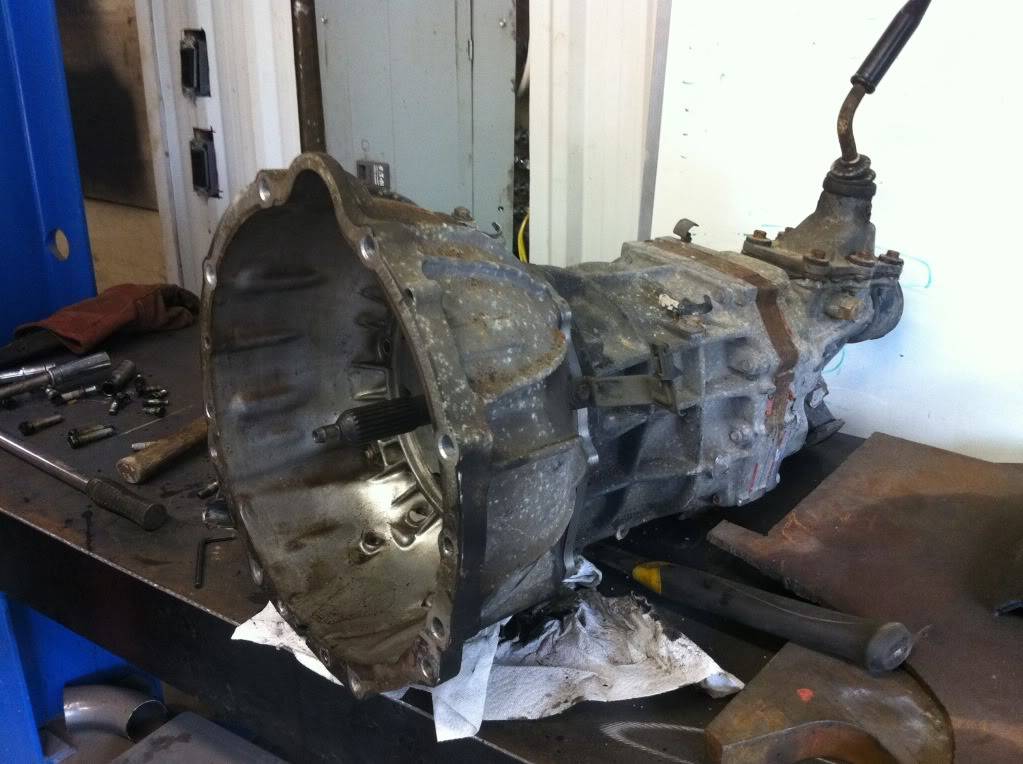

      I'm back.....shop is cleaned out.....got some new tools....I'm skipping racing this season to finish this car.
      16 bolts and the whole front suspension, motor, tranny all comes out! I love it!

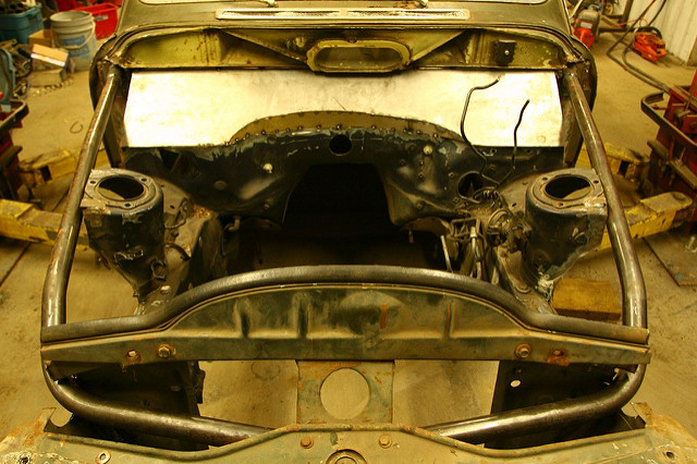

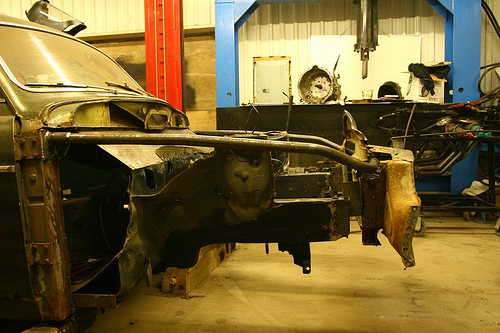

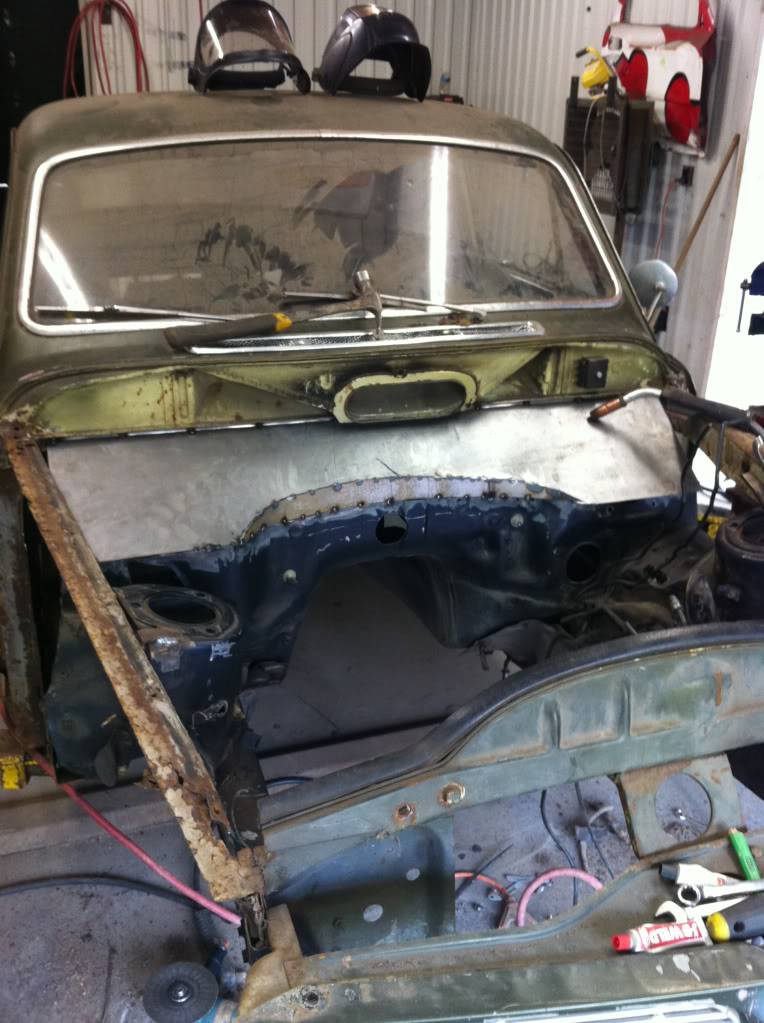

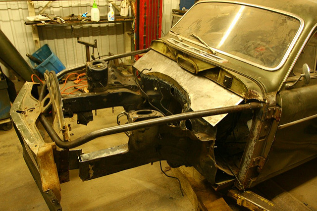

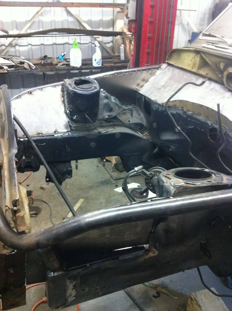

      Started putting it back together, but the supports for the fenders are rusted to ****, I decided that I'm going to rebuild the front end with 1.5" DOM tube and hang the fenders and sheet metal from that, should really stiffen up the front and and will tie the roll cage in nicely.
      And now that the motor and tranny are out.....I can steal the bell housing and test fit my new adapter for the manual tranny!
      Got a new die for the tube bender today so I can start making the front end tube work. Its adding some structure to the front end, as well as being contoured to fit the fenders so they have something to mount too. I wasn't planning on tubing the whole front end, but the volvo side was so incredibly rusty, this was the simplest, strongest solution. Tomorrow I should start filling in with more tube down to the frame, and sheet metal in between.

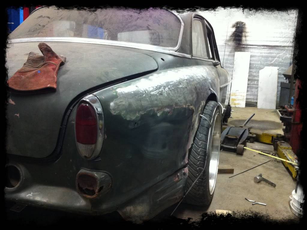

      Just gluing it together now....i'm fighting the line between race car and street car....I like race car because its faster and easier, and I by no means want this to be a nerdy show car. But I think its looking pretty cool.
