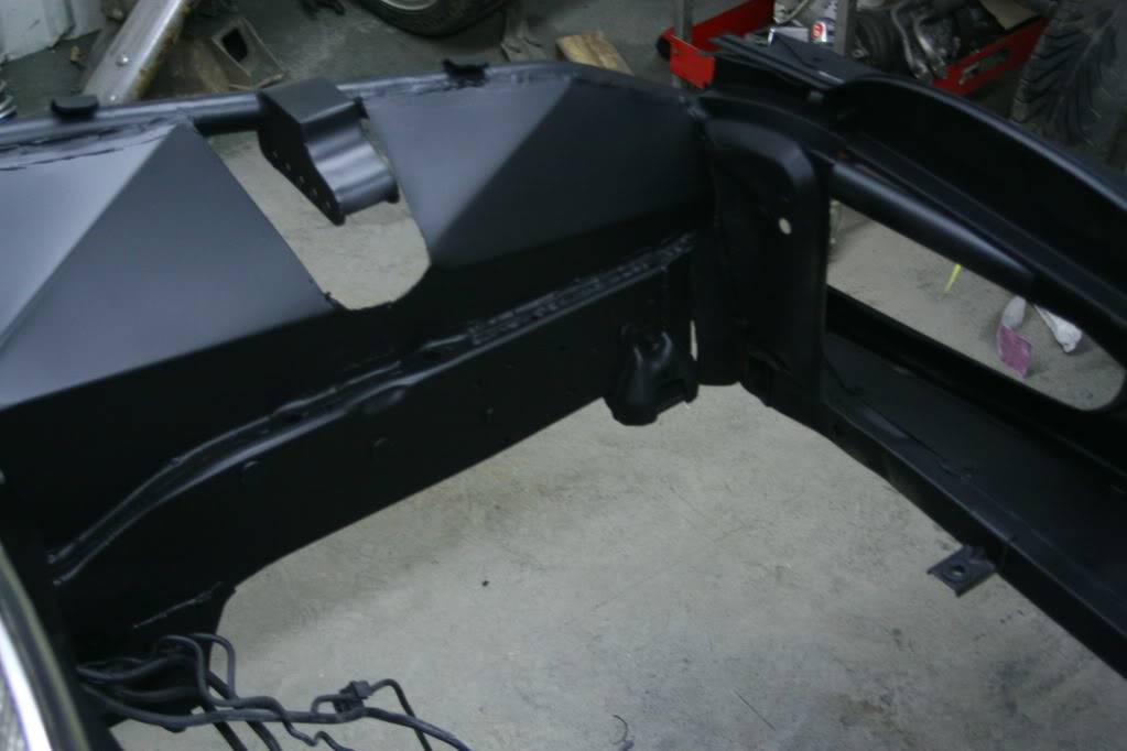

      Pedals hung....
      New plan for the crap I cut off:

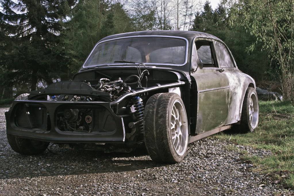

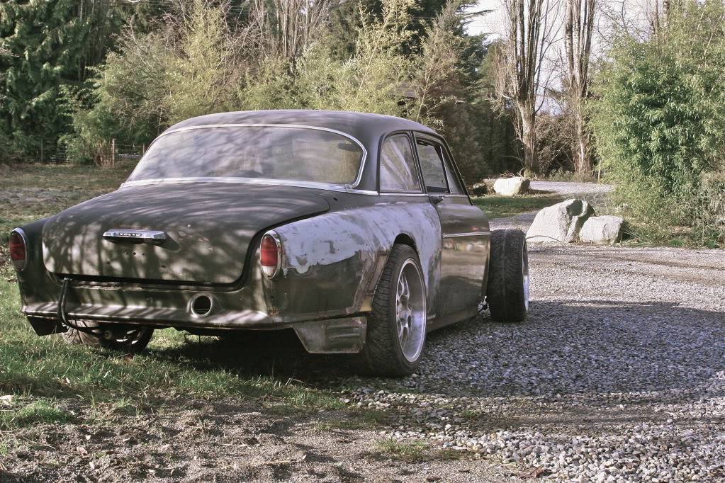

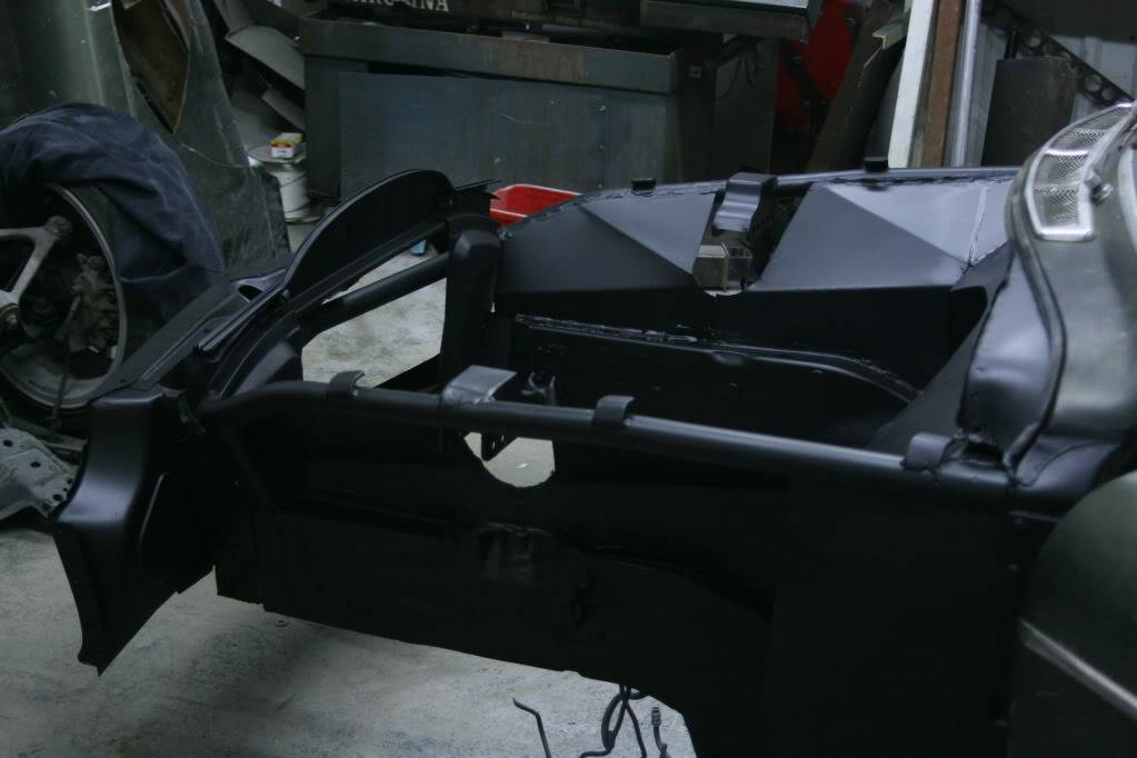

      So much awesome in one little package. What are you planning for the front fenders?
      Jon Rasmussen
      Ex Team OLJ.
      '72 Nova
      Abbotsford, BC
      359

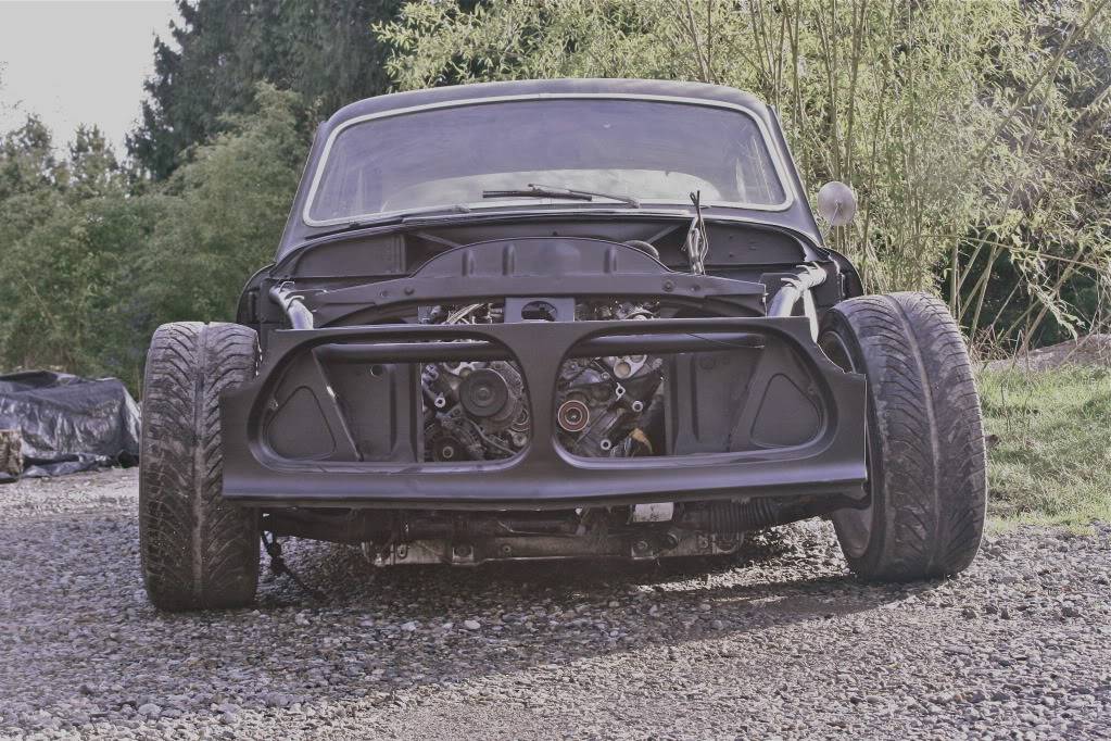

      Same as the rear, buldged, with a small flare. Likely will be the LAST thing to get done....not looking forward to it. lol
      Abbotsford, BC
      359

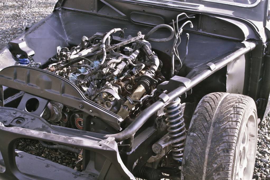

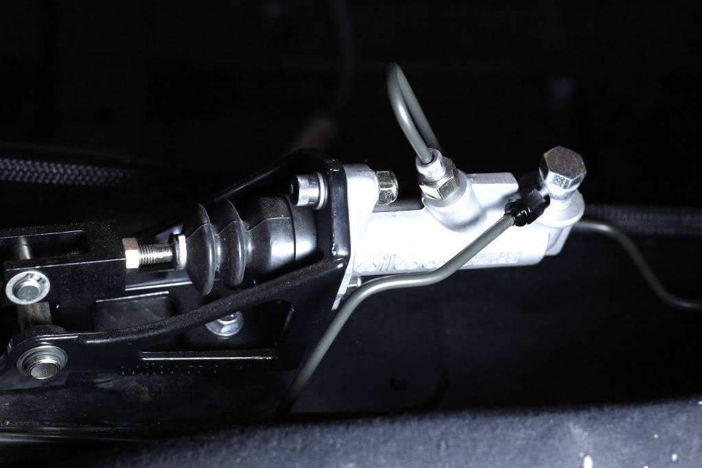

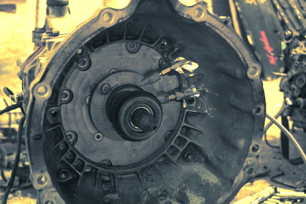

      Ok....it has finally rolled out of the shop sprung on its own springs. F*ck what a great feeling. ;)

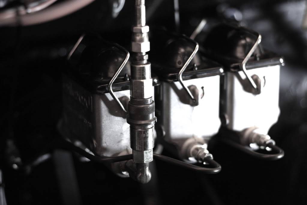

      Camaro hydraulic slave with custom line and quick disconnect:

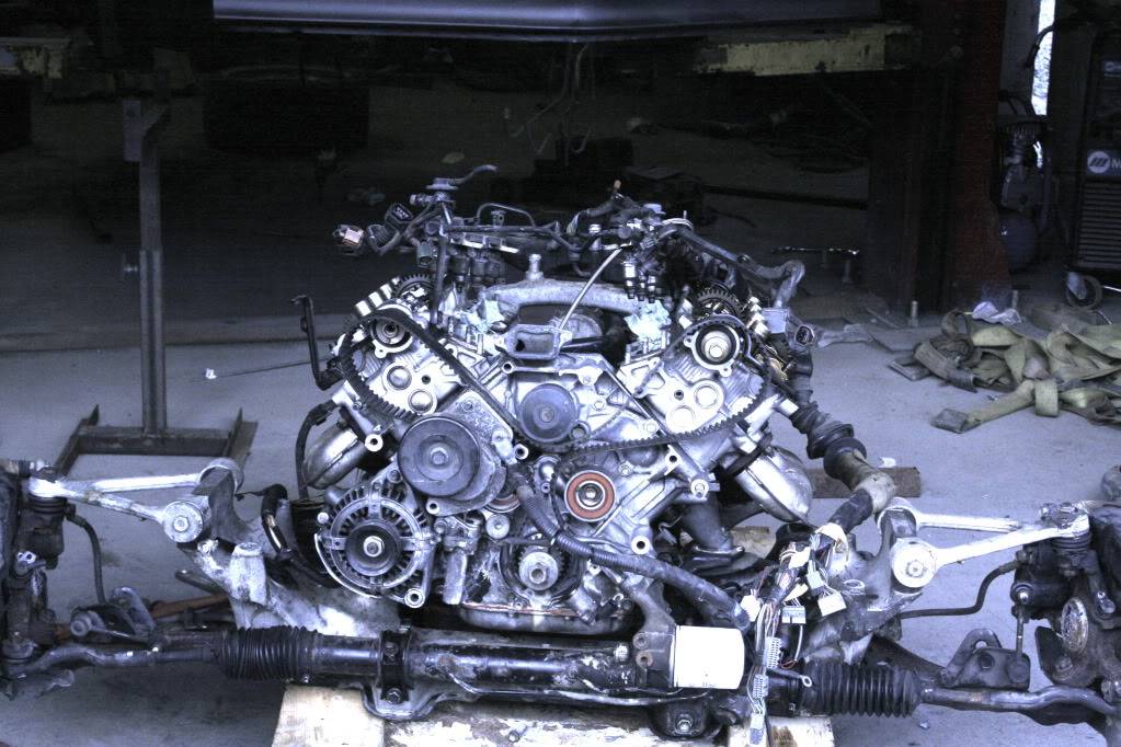

      hahaha I picked up your thought and got to work on it for ya.

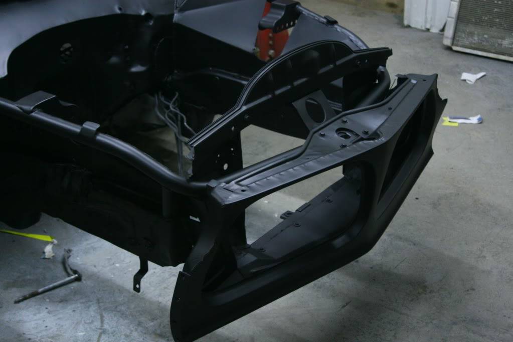

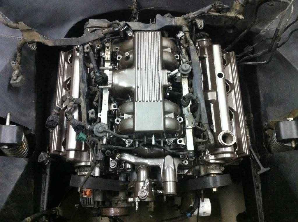

      Thanks to the powder coater.....motor parts look a little classier, the wiring and fuel rails will be cleaned up, I just wanted to see what it looks like:

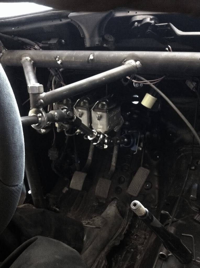

      Corporate whore day:

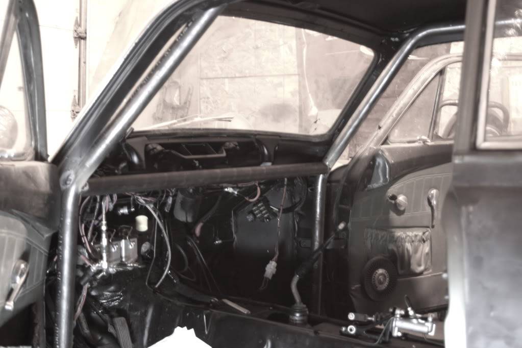

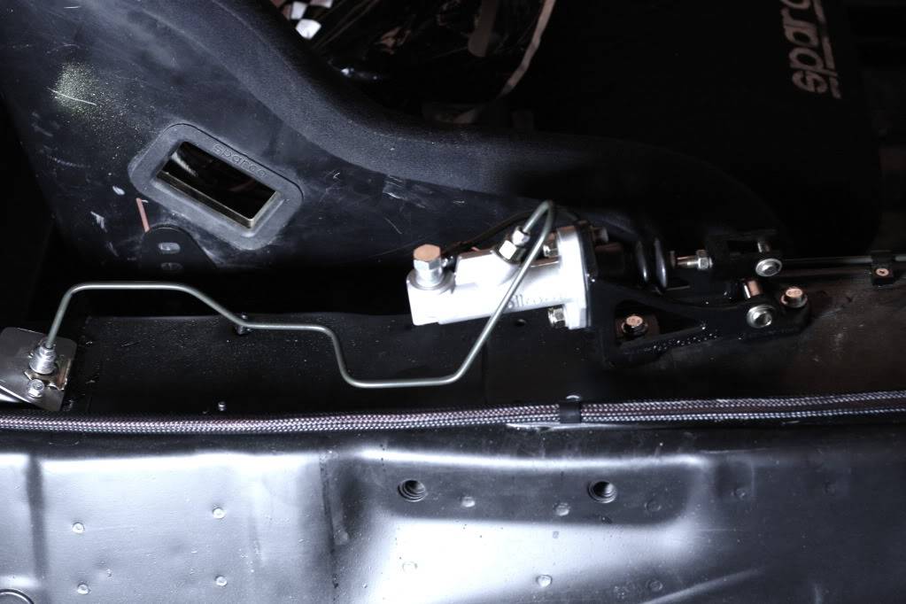

      Some of Bill at Independent Speed shops work....making me nice brake lines, plumbing and wiring everything. Dash is not installed so all the switches and buttons are just dangling.
      Hydraulic Hand Brake, I need to make the lever next:

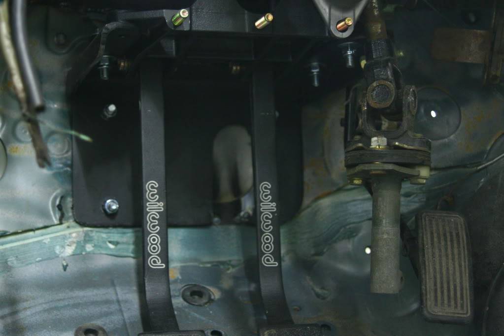

      Wilwood pedal assembly:

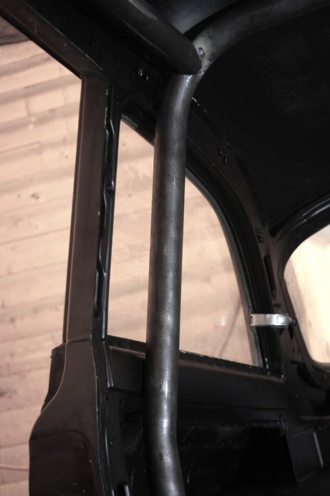

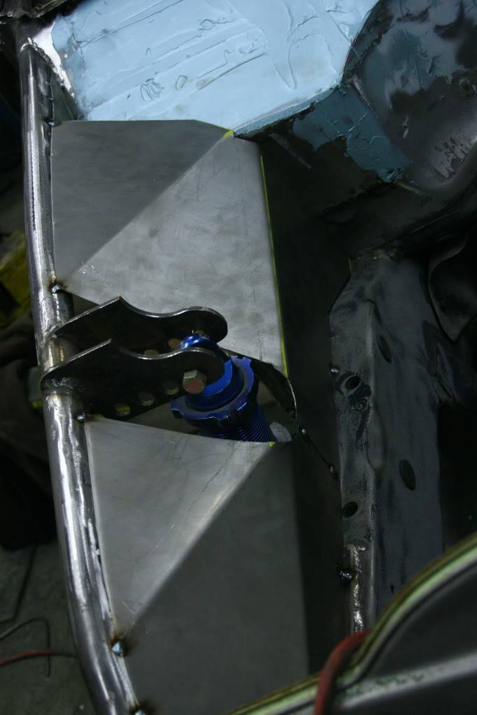

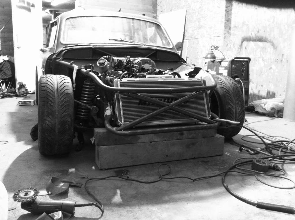

      Got a bit of a start on the cage today, all 1.75" .095 wall DOM to be legal for CACC GT class. And yes that is Flux Core....I'm just tacking it with a lil welder cuz mines to big to drag into this part of the shop.
      Got it to fit ultra tight.

      Everything looks amazing, great job.
      Diggin the hand brake, thats a pretty slick set up.

      I can see a monte carlo bar connecting the shock towers.
      Abbotsford, BC
      359
      Quote Originally Posted by Protour_Pinto View Post
      You sir are correct!
