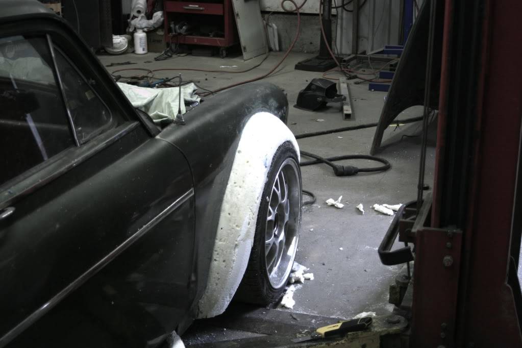

      Very nice! Do you know what a contour gage is? it would really help replicating the fender flares...
      Benjamin
      Twin Dusters
      Abbotsford, BC
      359
      Yes, that is exactly what I need. I might just make templates out of card stock if I can't find a contour gauge locally.

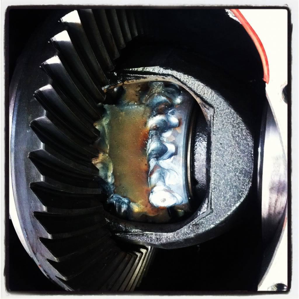

      Drift diff:

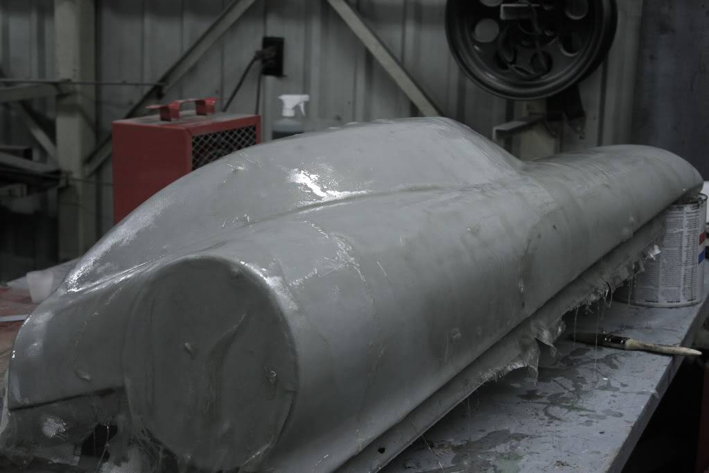

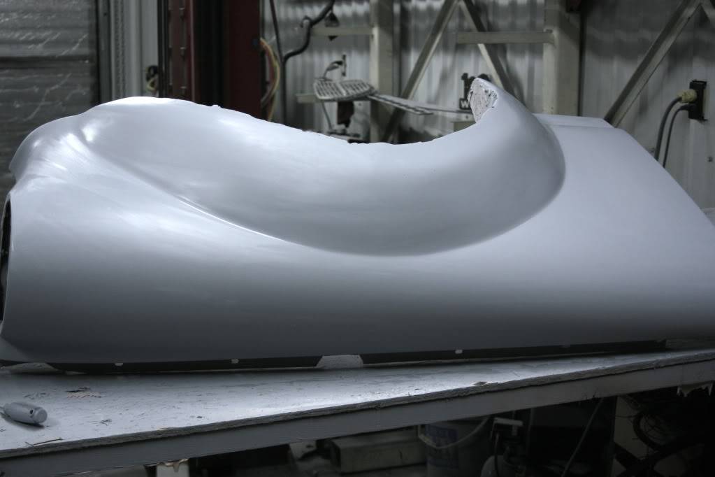

      Little more detail in the glass fender creation:
      Started with styrofoam and spray foam:
      Then many many layers of body filler to get the profile perfect.....then many coats of primer which gave me this plug:
      Wax it 10 times, add PVA mold release, then gel coat....then start laying glass and resin:
      after a few days of pissing around....its time to pop the mold:

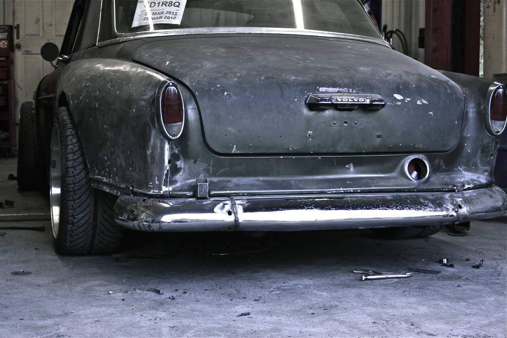

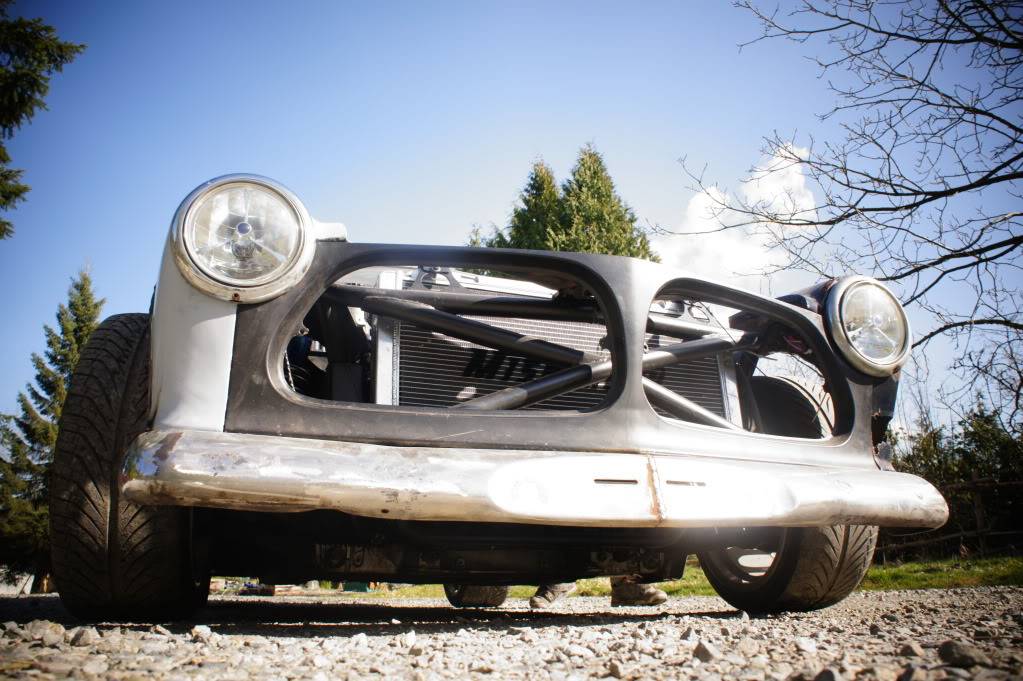

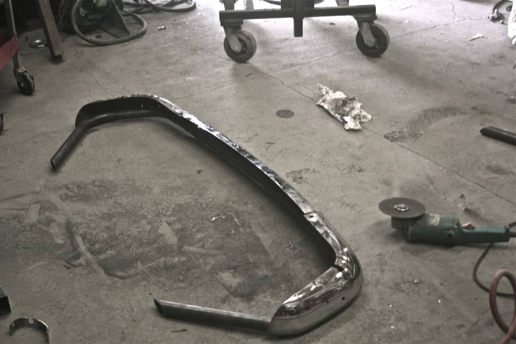

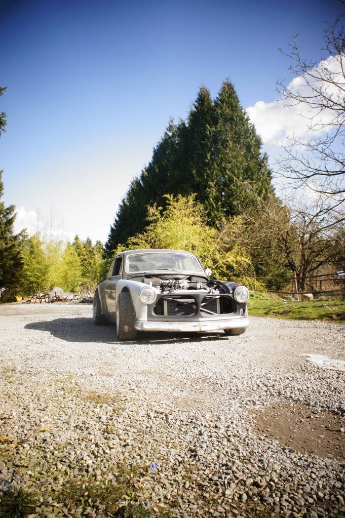

      Narrowed and tucked the front bumper tonight....

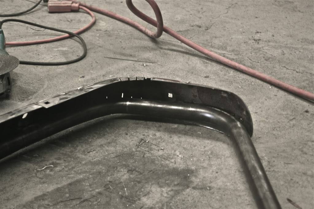

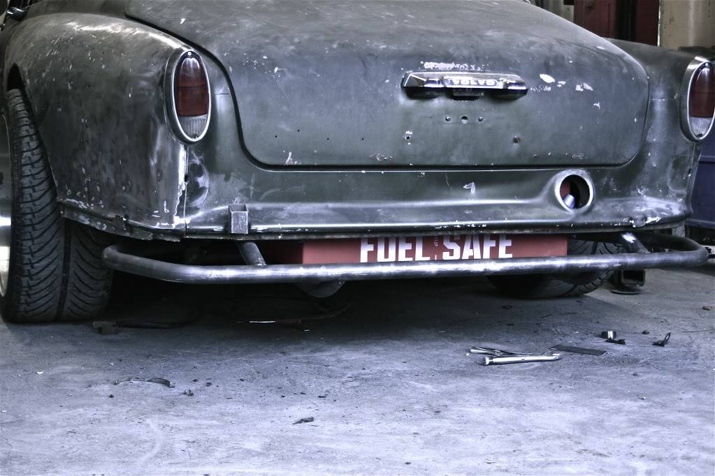

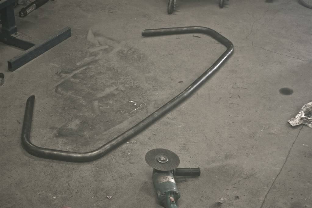

      Ok, so I have this idea that if I go drifting in this car, I don't want to rebuild the 1/4 panels if I tap a wall.....
      So I took what I know about building bumpers that survive short course racing....My truck bumpers are original, and I have personally destroyed or bent at least 3-4 rear bumpers from people in front of me
      And applied it to this car, with a touch of hot rod, and a dash of concealment....
      The tube:
      The plan:
      The application:
