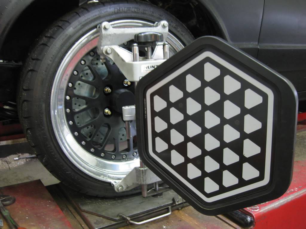

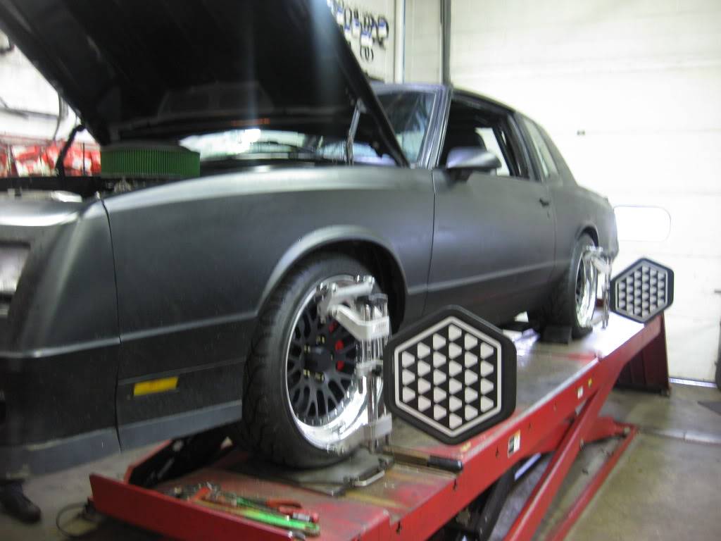

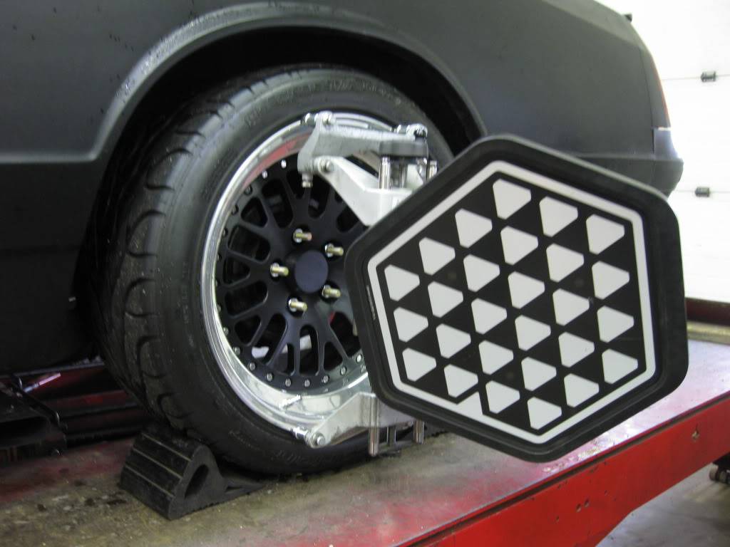

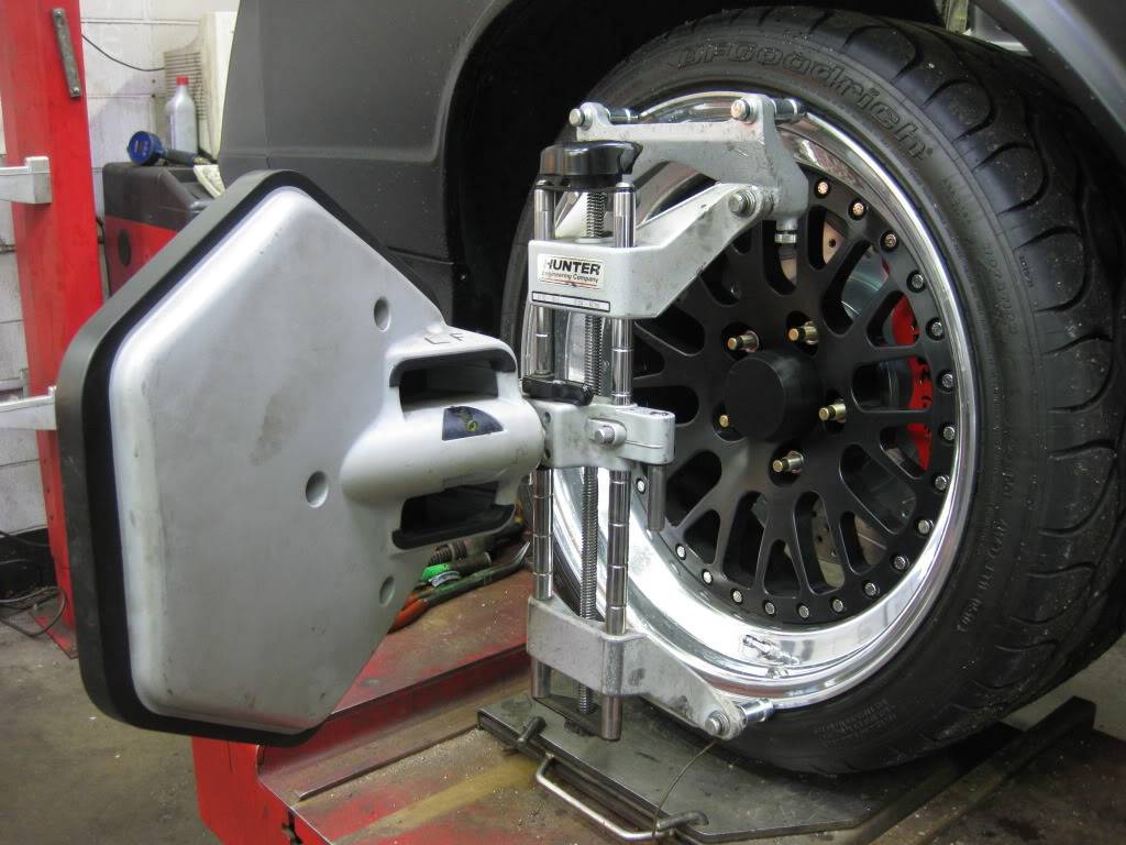

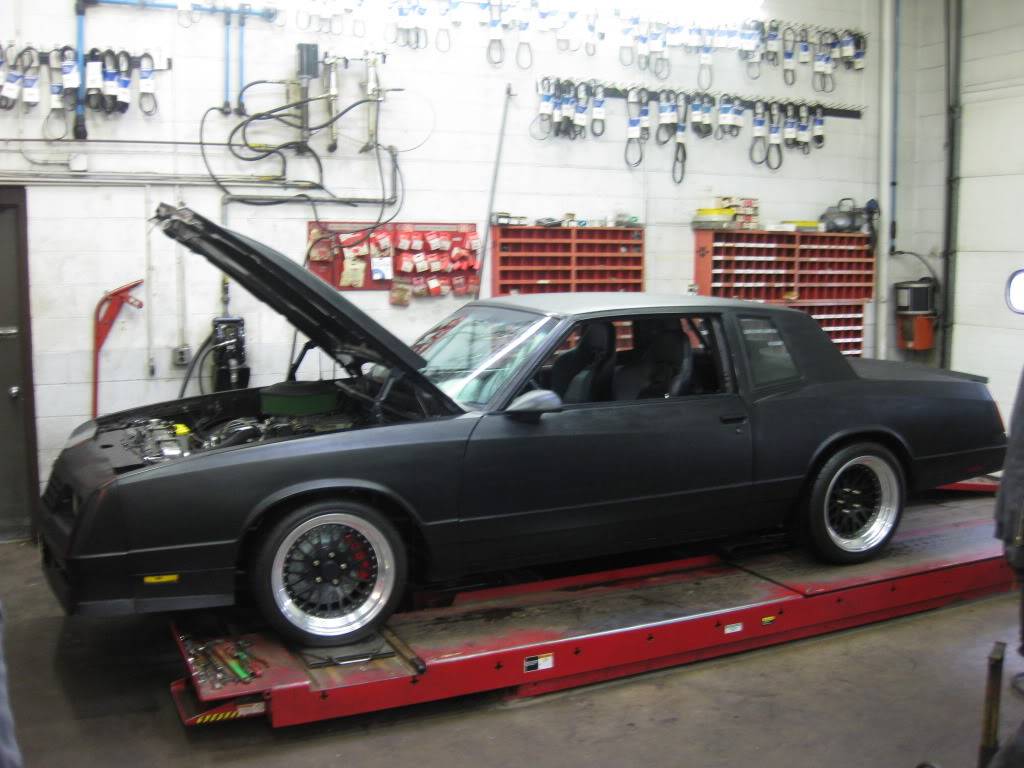

      At the alignment shop...Goss' Garage.
      Front
      Rear
      Back side of the fronts...

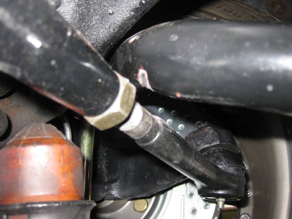

      Found out that the outer tie rod was hitting the sway bar when it was at ride height. I had to get a longer sway bar end link to solve it. I went from 3 3/8 to 4 1/2...fixed.

      Quote Originally Posted by SicMonte View Post
      Which model/application is the link from? Or, did you use a cut-to-length link?

      Quote Originally Posted by cornfed View Post
      I used a specific length Energy Suspension Sway Bar End Link PN: 9.8181R
