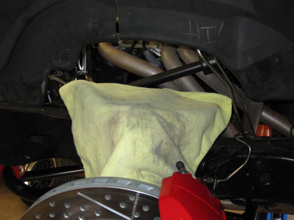

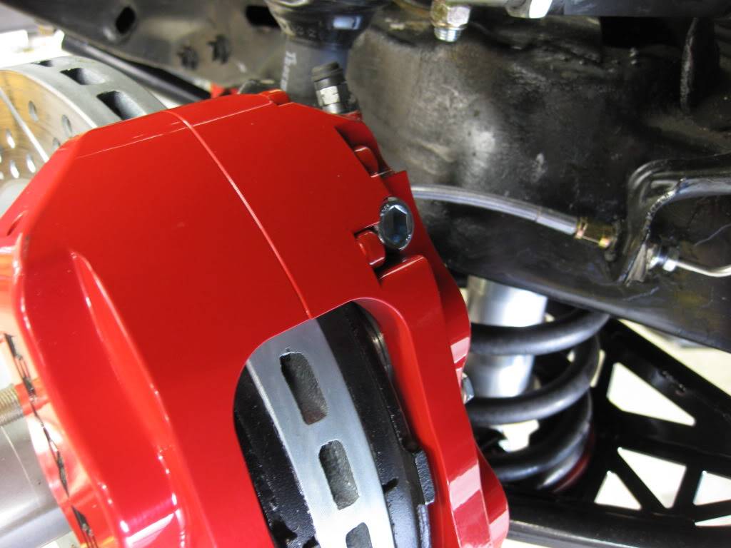

      After RTTS I had a lot of noise in the front brakes when I applied pressure to the pedal. It was a very high pitched squeal. Here is what I found. This will also serve as a "how to" on replacing brake pads on the new Baer T4 calipers.
      Here are the brakes...
      Before even starting the job I thought of where the capiler was gonna rest while it was unbolted. The upper A arm is perfect for this, just make sure you cover it so the nice new caliper doesn't get scrathed.

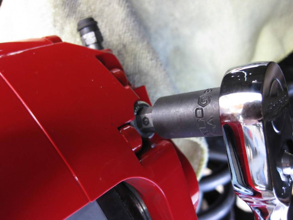

      These are the caliper bolts. A 10mm allen socket fits them.
      Caliper is off and resting on the padded upper A arm
      The caliper bolts came with locktite on them from the factory, be sure to use more when installing the calipers again.

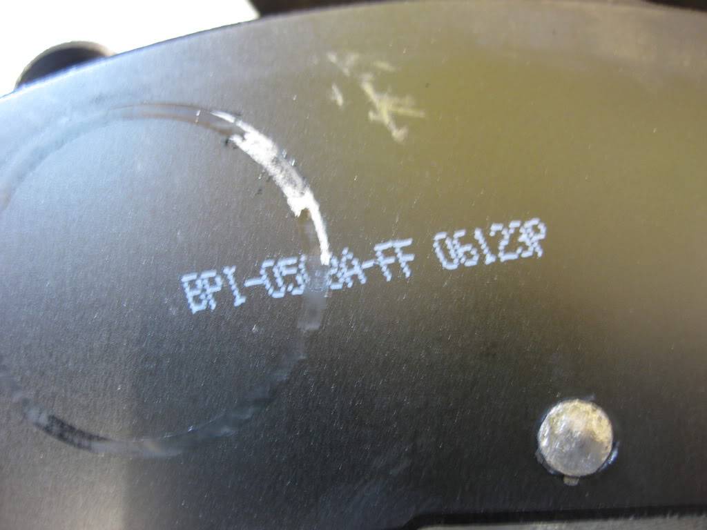

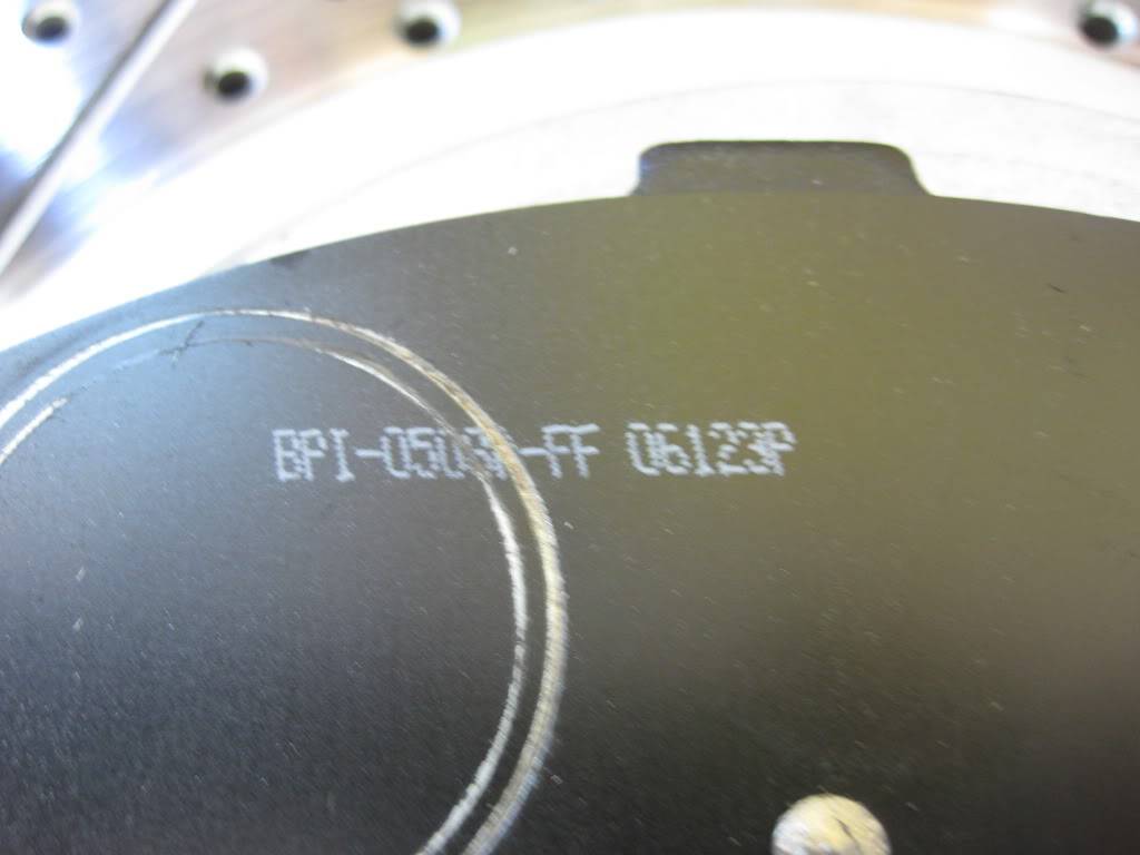

      Looks like the pistons were digging into the backing material on the pads. This could be a major cause of the squealing. I added some grease to where the pistons contact the pads to help with the problem. **Note: Both sides had this issue.

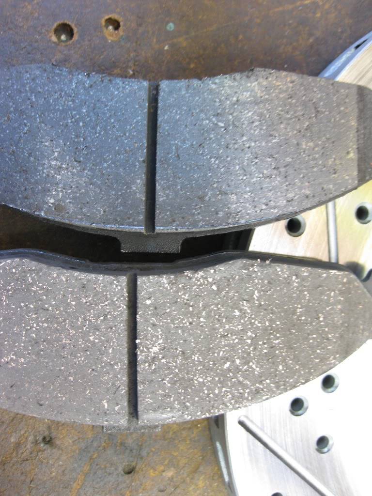

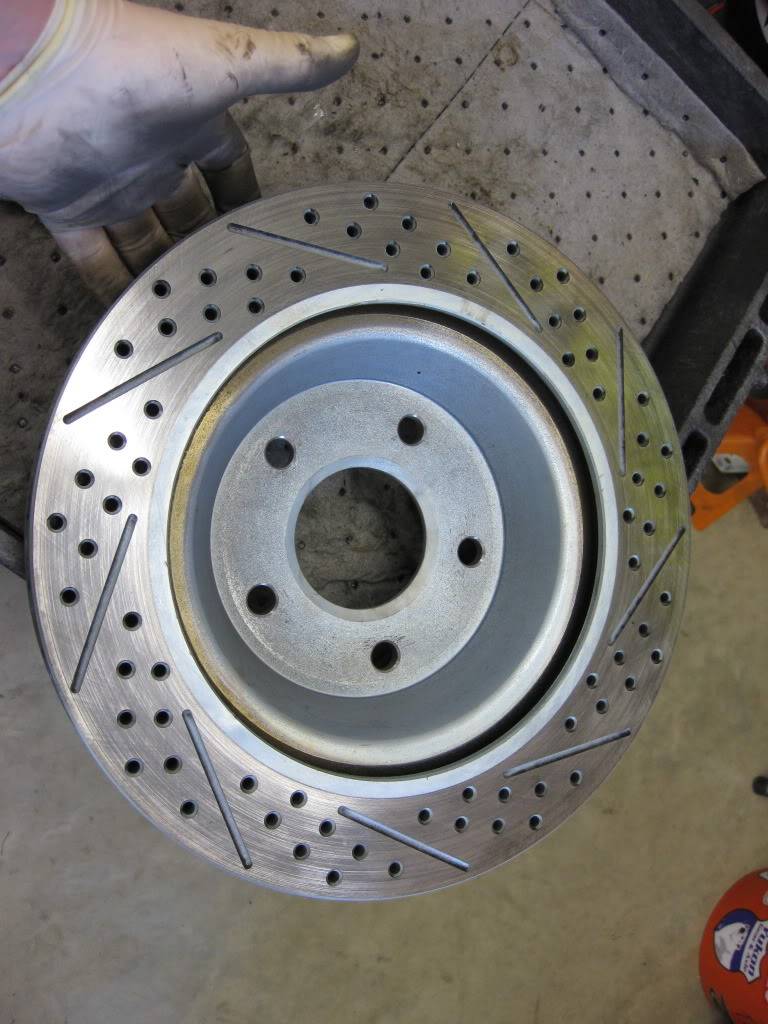

      I also noticed that the pads and rotors were glazed. I took some emory cloth and sanded off the glaze on the pads. You can notice a difference beween the two pads. The glaze occured because I did not properly bed my pads before I took it out onto the track.
      Here are the glazed rotors.
      To de-glaze the rotors I simply scuffed them down with a scotchbrite roloc disk on an air angle grinder. Glaze came off no problem.

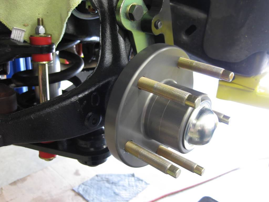

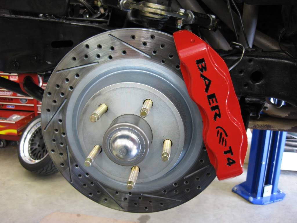

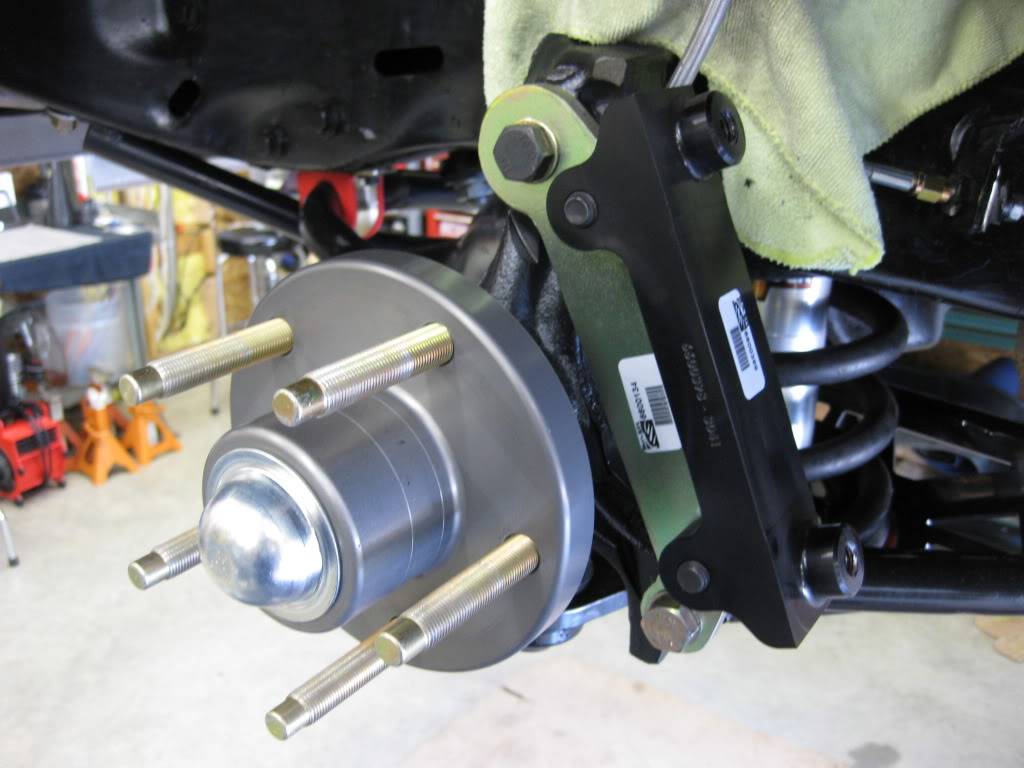

      Here are some shots of the Baer hubs with the ARP wheel studs. The caliper brackets are no joke!!

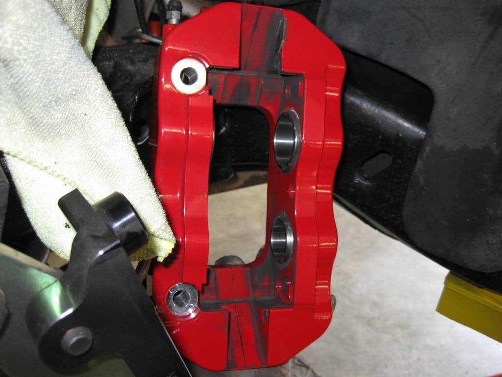

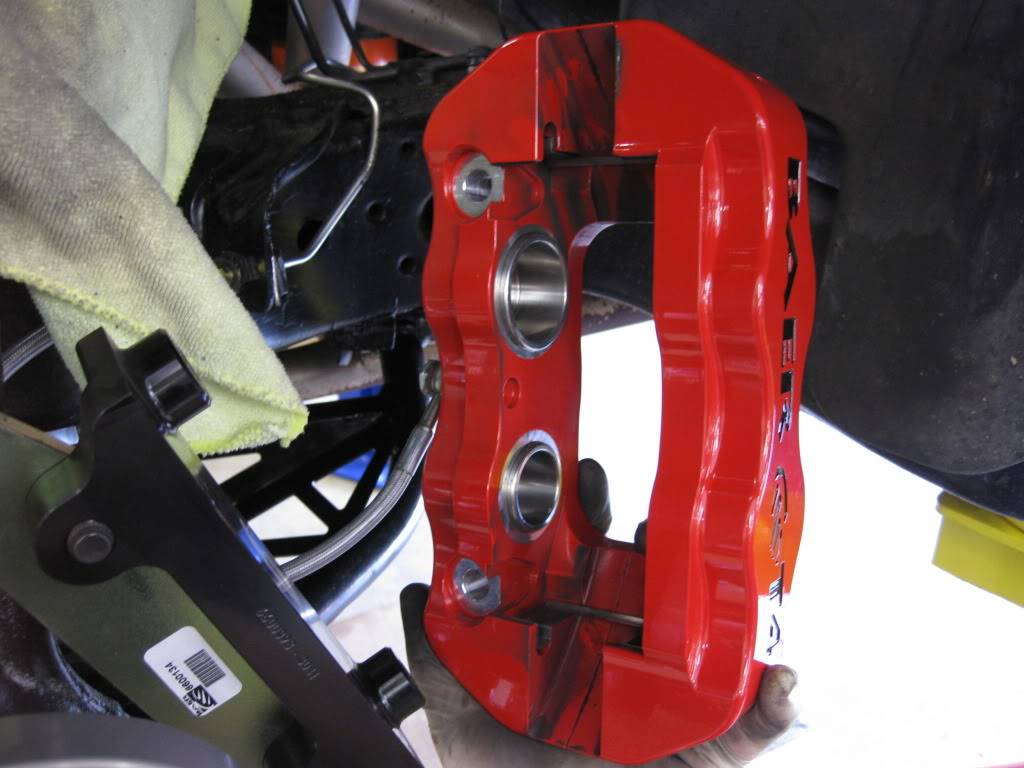

      Here is a look at the inside of the T4 caliper. You can see the four pistons very well.
      When I went to put the pads back into the caliper I greased the slots where the "ears" of the pads go into the caliper. There is a small metal bracket that sits in there that holds the brake pads just like every OEM caliper. I put some grease where the pads hit that metal bracket and there is now more squealing!!
