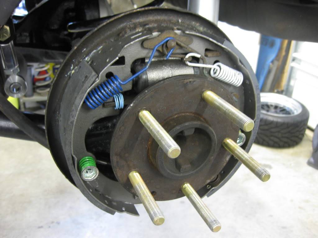

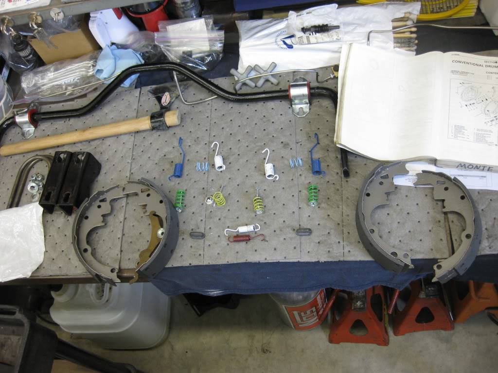

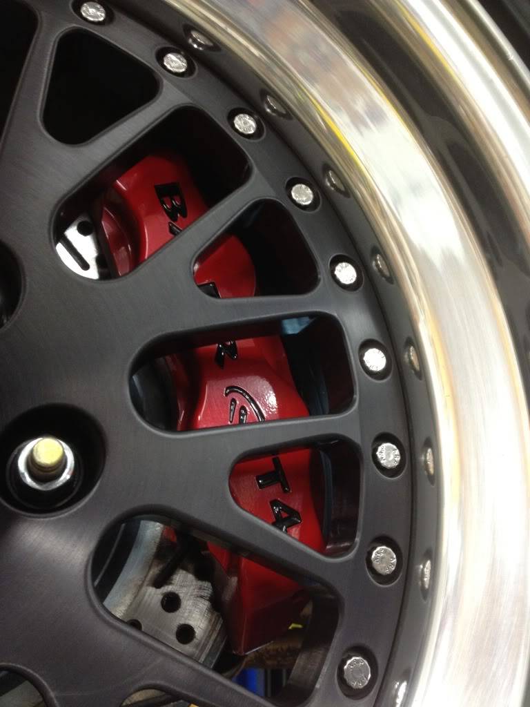

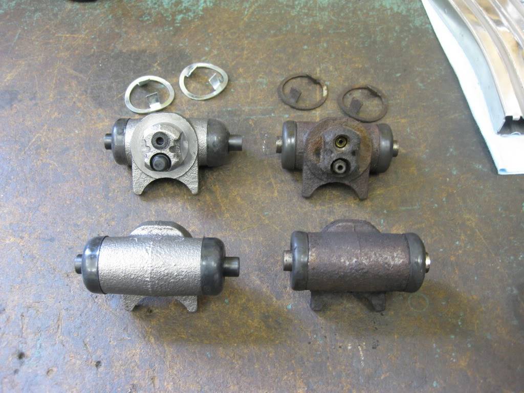

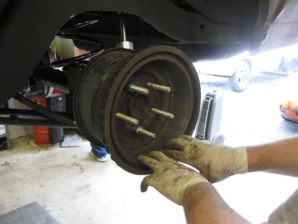

      Put all new rear brakes on a lil while ago...and it actually made a big difference!
      I have a 8.5" rear i am building this winter that will have matching Baer brakes...
      All the hardware laid out on the work bench.
      New vs Old
      Douglas Lutes
      1988 Monte Carlo SS
    2. #182
      MD
      232

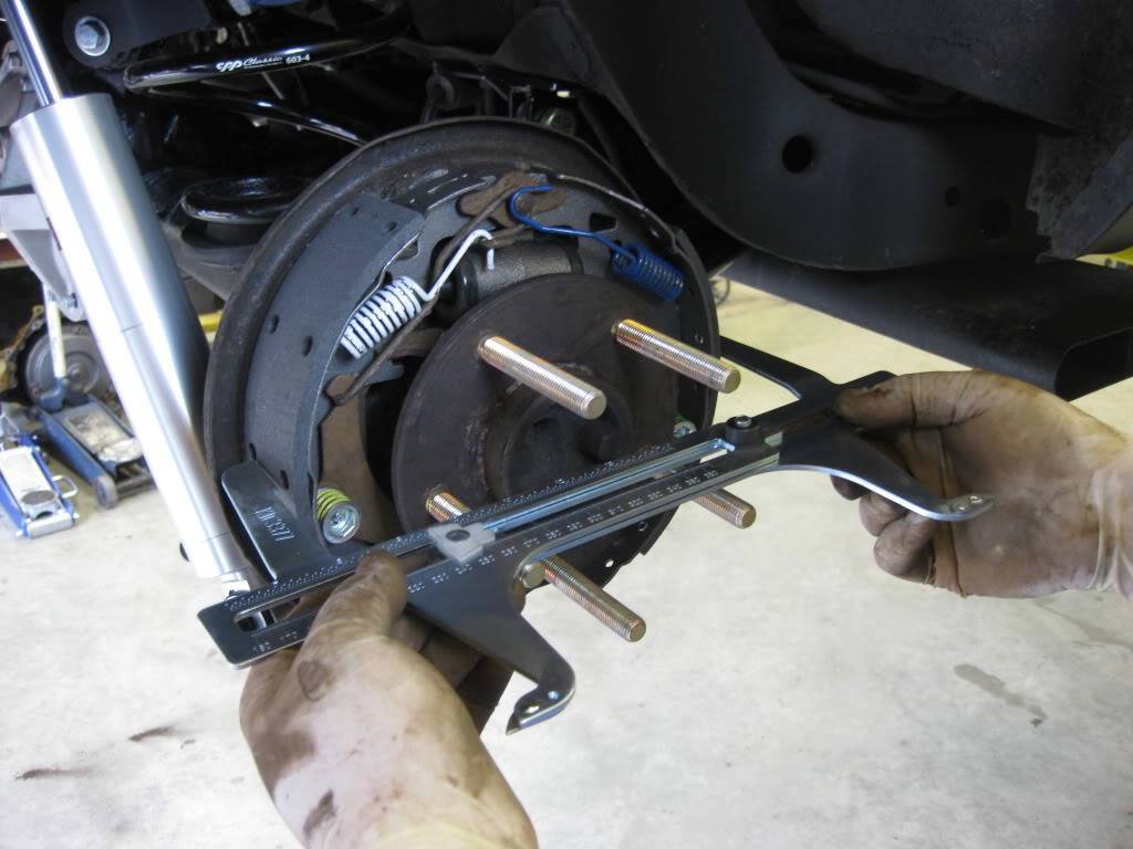

      The drums go on the other way
    3. #183
      Charlotte
      1,295
      Those backwards drums will stop on a dime!

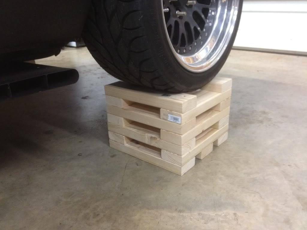

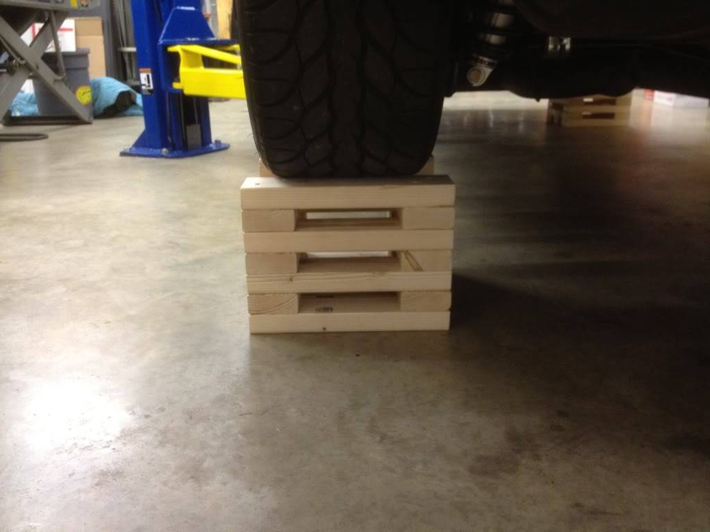

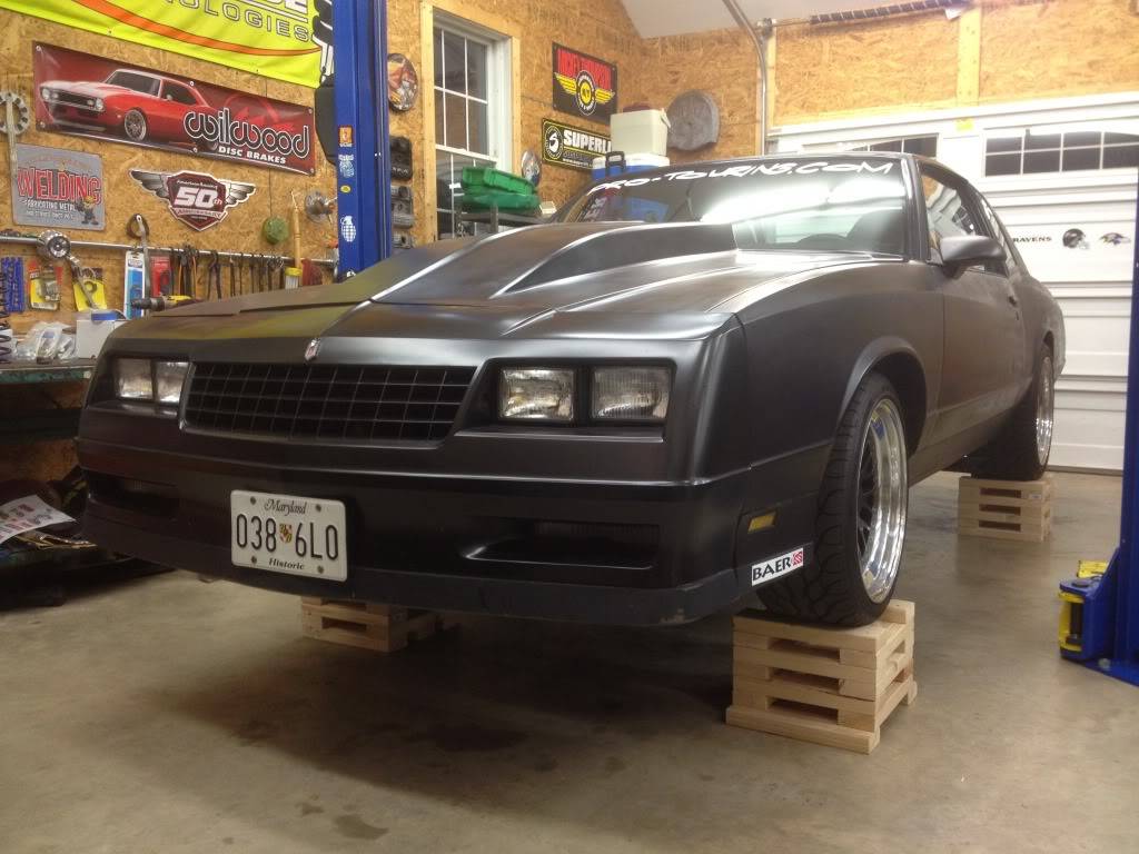

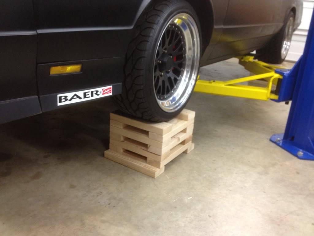

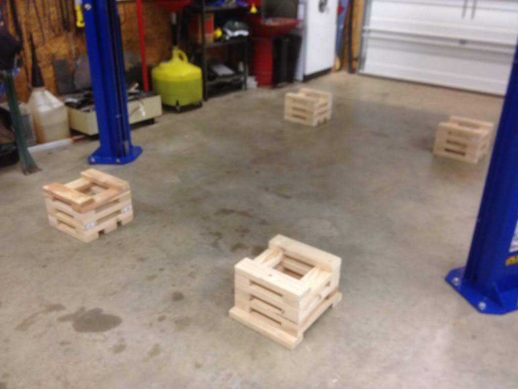

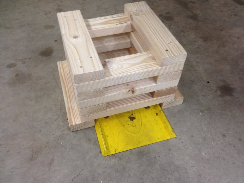

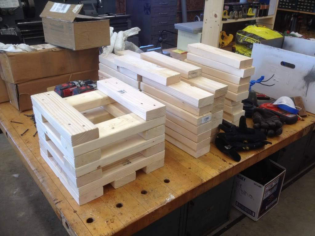

      I made these car stands today so I can have the car at ride height and work on the coil overs to get them adjusted just right!!. They are made of 2x4's and are 14"x14".
      I had to modify the base on the driver front one so it would fit with the lift plate there.

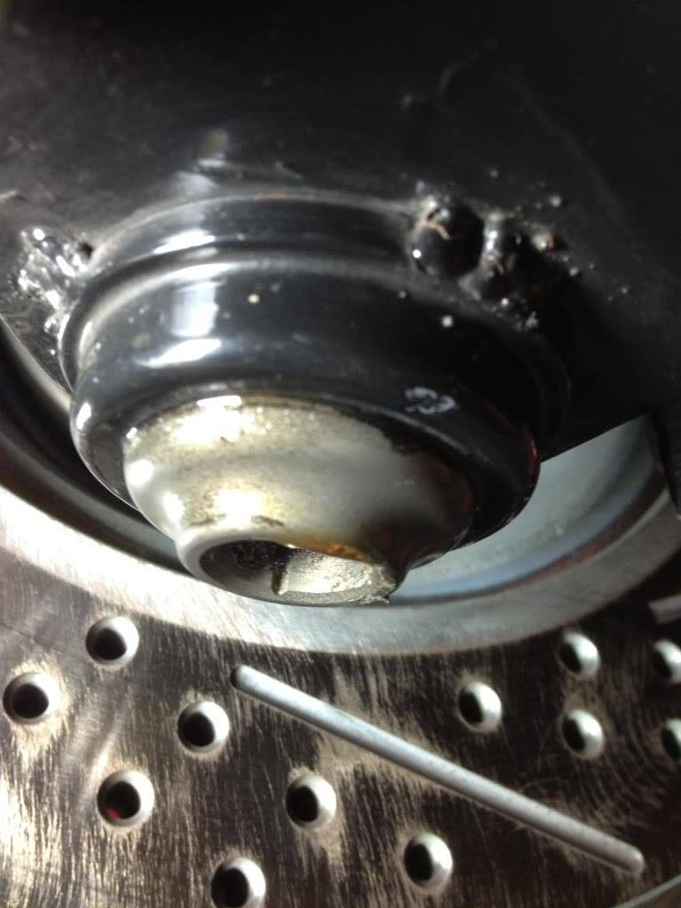

      While working on my prop valve I noticed that something was leaking onto both of my front tires. It turned out to be my lower ball joints!! Have any of you heard of the grease liquefying in the lower ball joint? I did weld them in about a year ago and have since re-greased them with the Valvoline Syn grease that I have always used. Is there a way to drain these things??
      Douglas Lutes
      1988 Monte Carlo SS
    16. #196
      Feb 2010
      Central NJ
      791
      My new BJ's and other grease fittings did seam to leak some liquid or sweat... i'm not positive but it may be the nature of synthetic greases??? I used Green Grease.... I just pumped in some more... i think the liquid was very minimal... try adding some grease and see how much is actually liquid...
