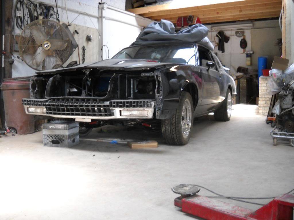

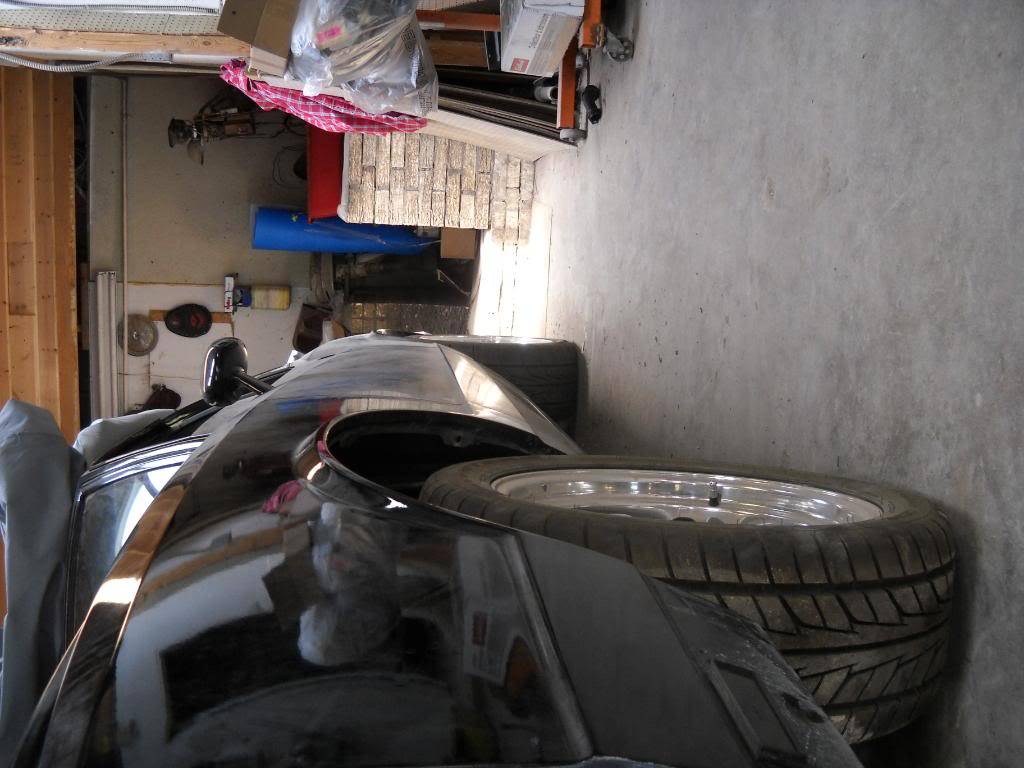

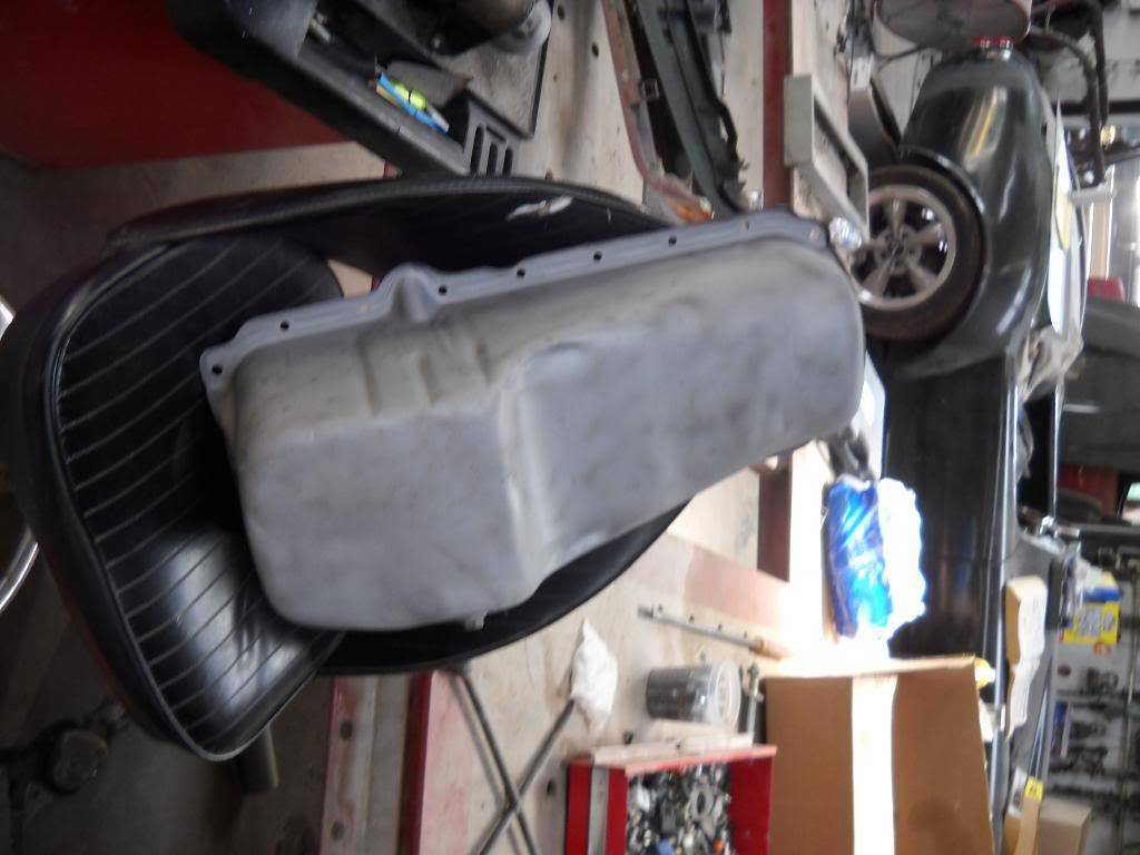

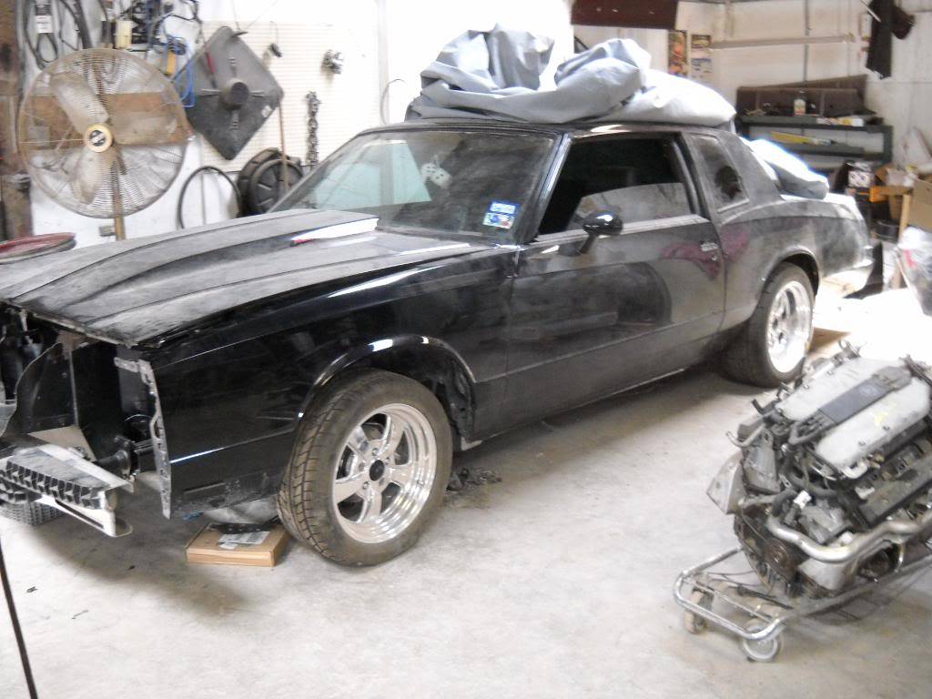

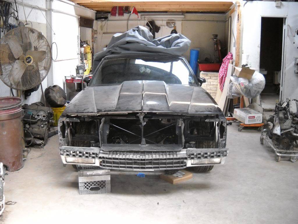

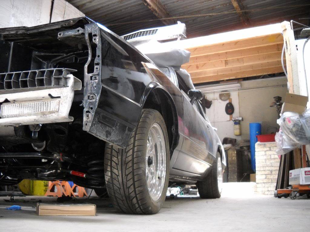

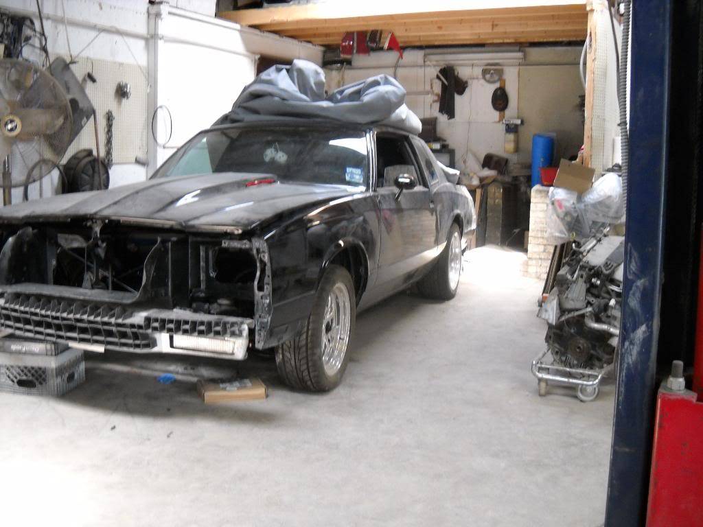

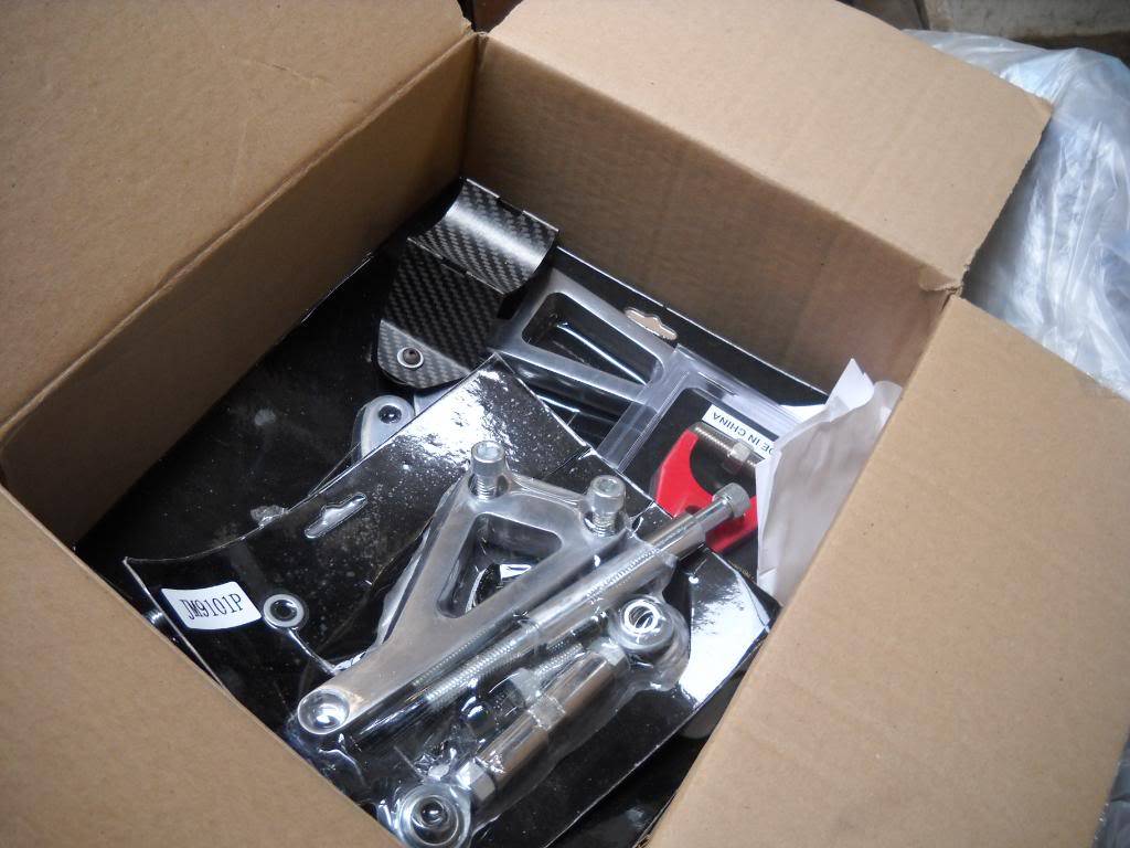

      Update time...
      I didn't get TOO much done, but I did do something. I got the car back down on all 4's... finally. I got my oil pan sandblasted and off to the powdercoaters, my trans will be off to the trans shop this week. I did a few other things to the car not really worth mentioning here. Mainly I took a BUNCH of pics so here you go...
      On the ground!
      Final ride height... J/k lol
      Blasted pan...
      Some accessory brackets, and my CF Coil mount.
      Thats all for now. Hopefully more progress will be made on my four day weekend this weekend. I'm trying to finish it all up by June 18th, thats the weekend of the car show my Uncle Mac used to put on before he passed. Lets just hope I can pull it off.
