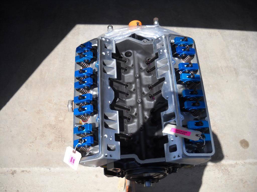

      Motor plans are 383 stroker with about 450Hp 430tq

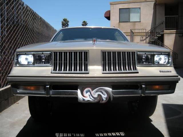

      Where it all began 6 years ago.

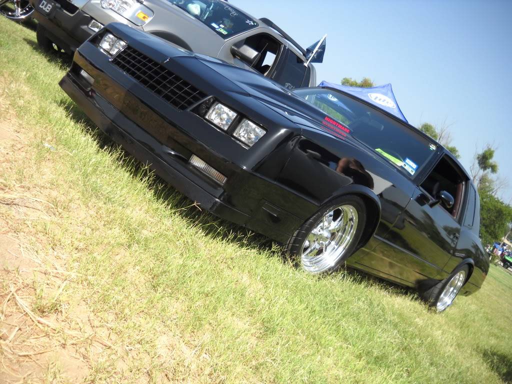

      Last car show before I took the car off the road (ignore the model...lol)

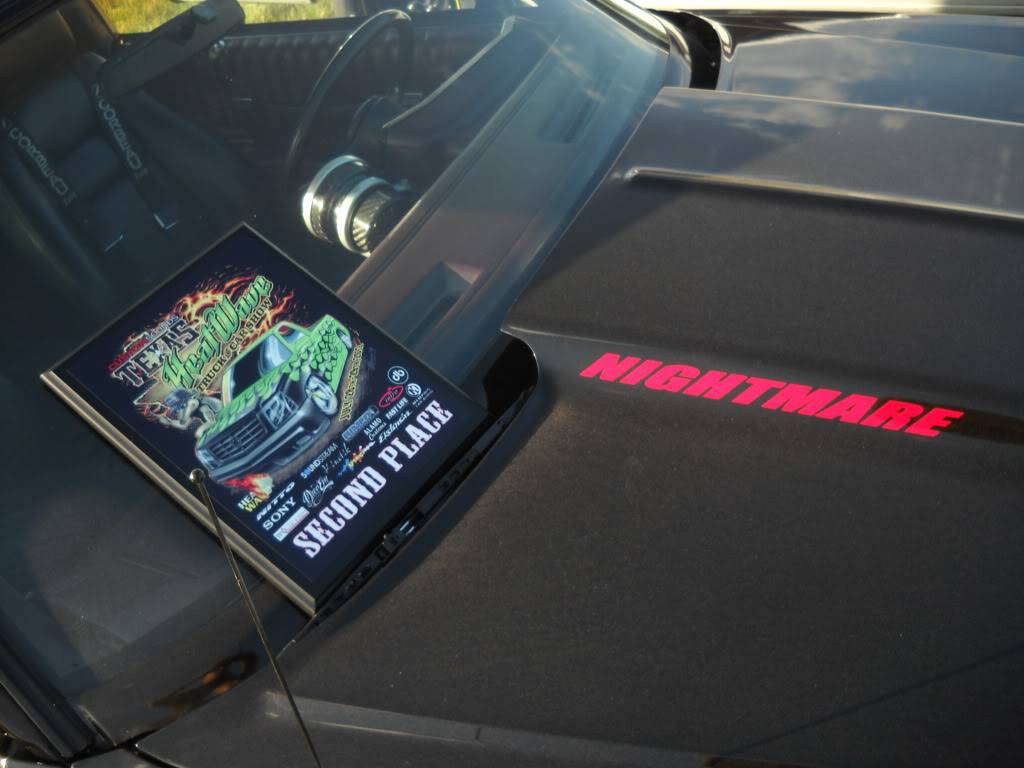

      Myself with the 1st place plague.

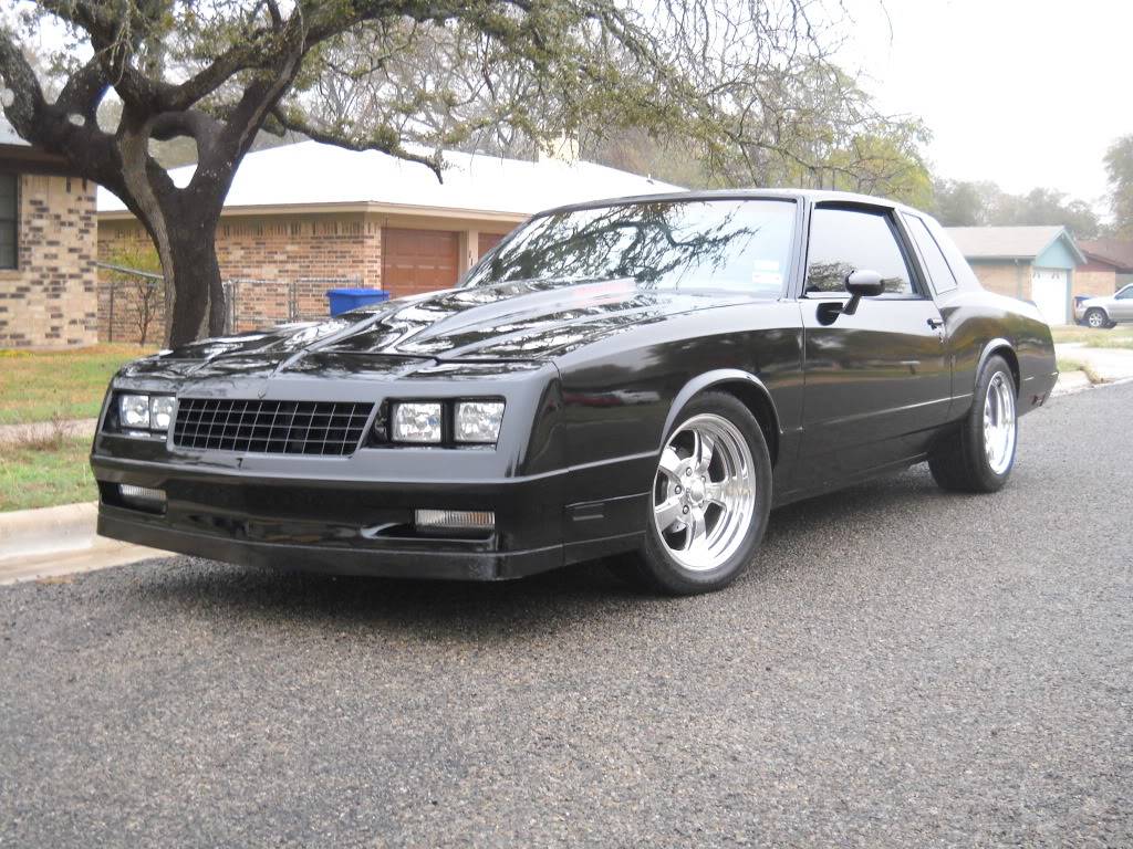

      This kinda gives you an idea of what the car looked like when I pulled it off the road, this was the day before she went in for tear down.

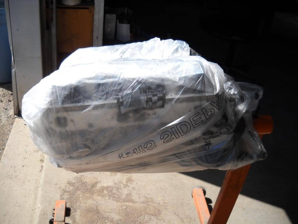

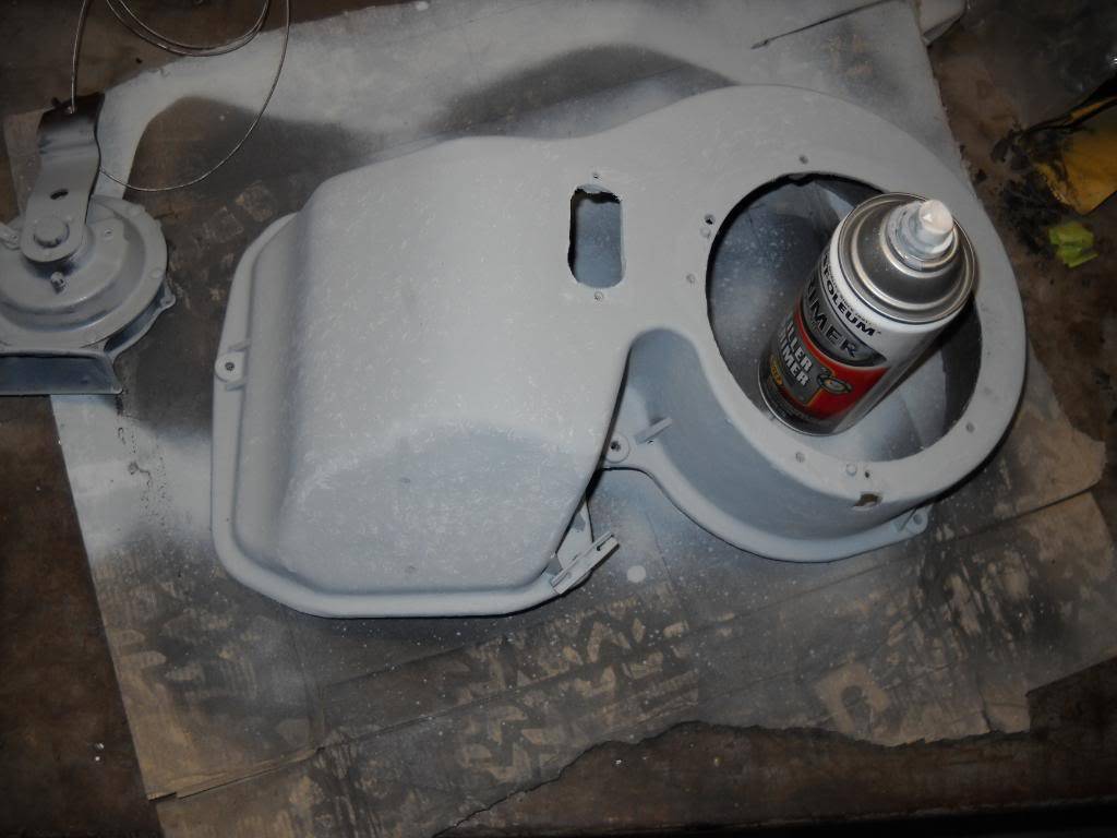

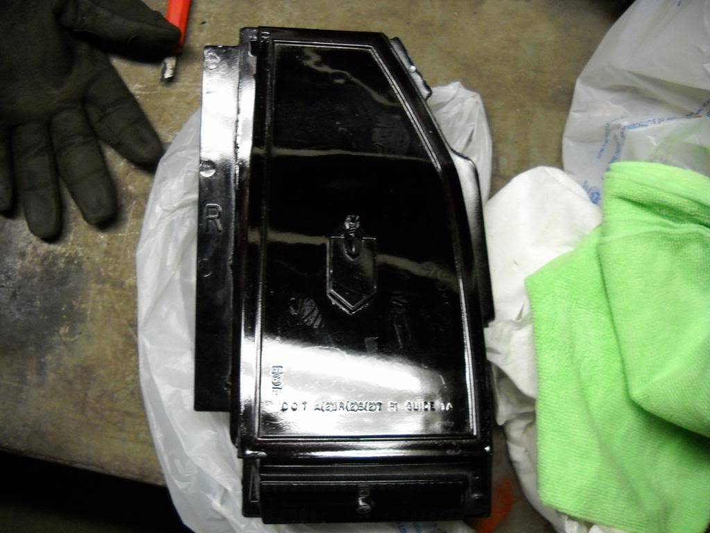

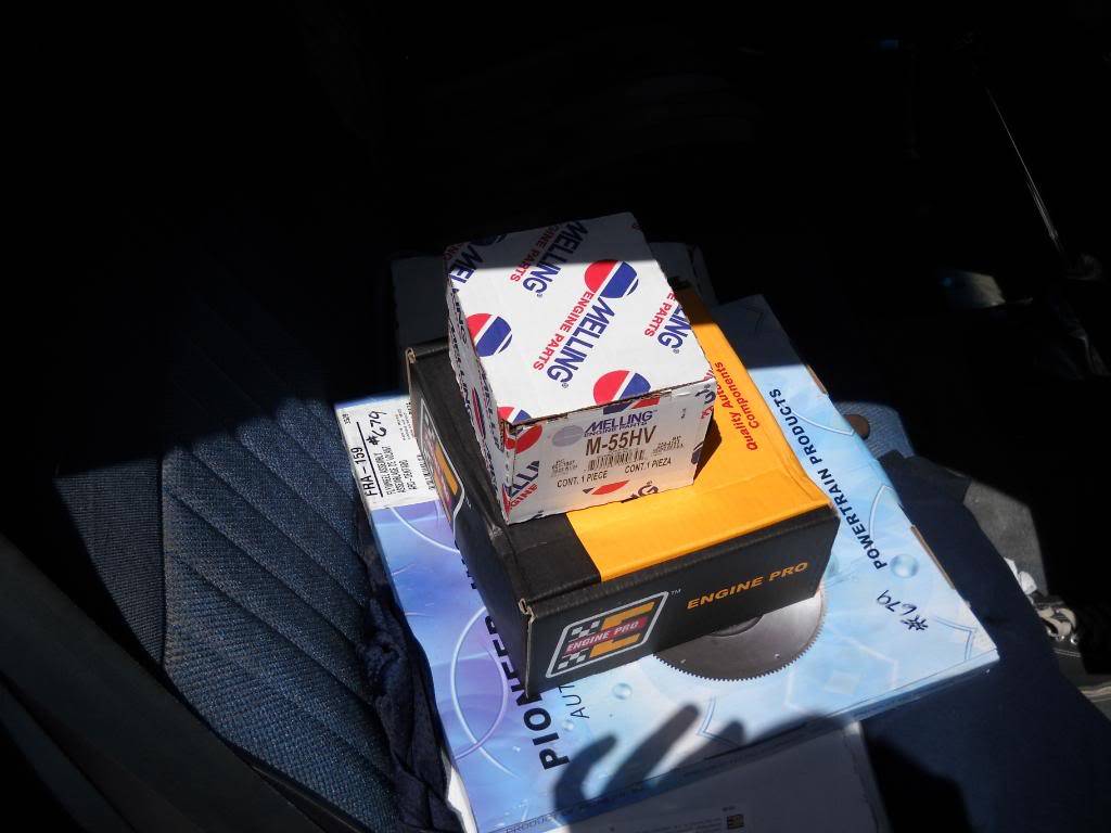

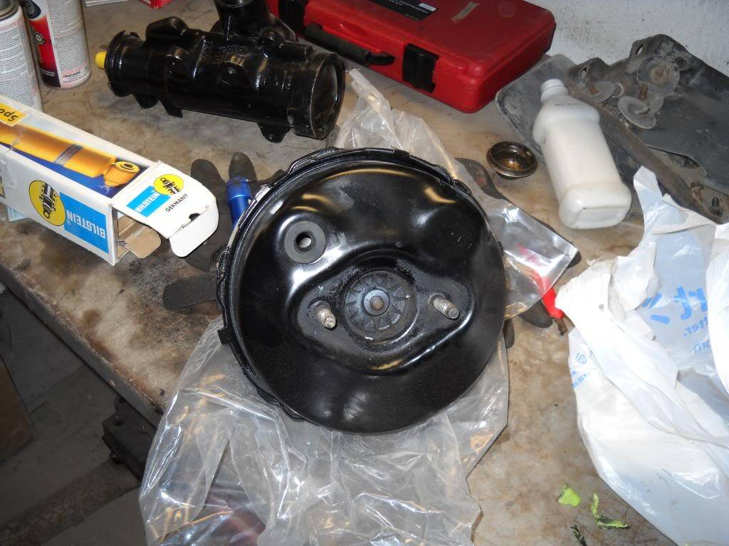

      Parts....

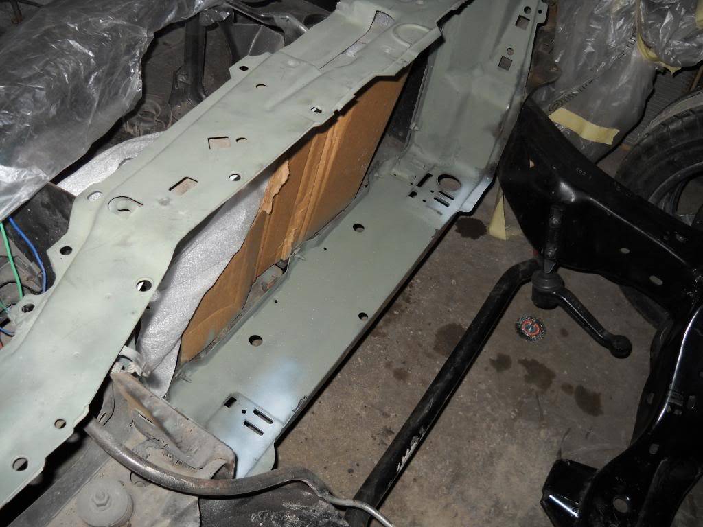

      This give you an idea of how the whole bottom of the car looked. I would just like you northern guys to notice ..........NO RUST, not even a single pin hole... LOL

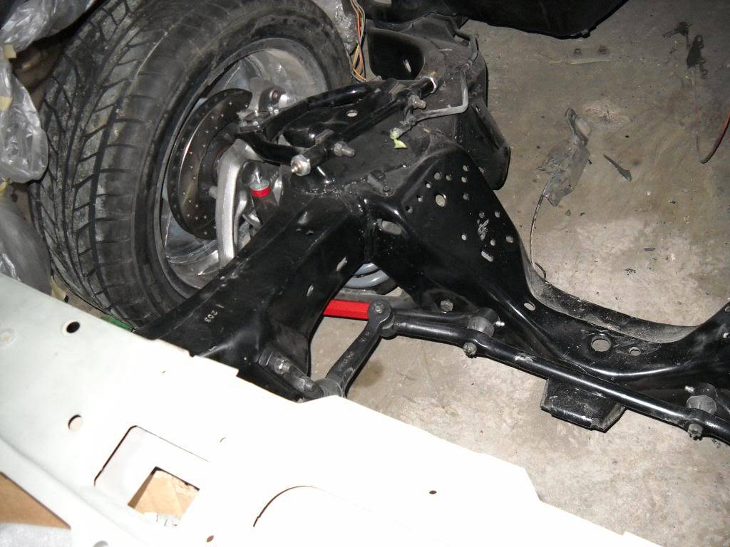

      The rear suspension, that goofy exhaust is gone.

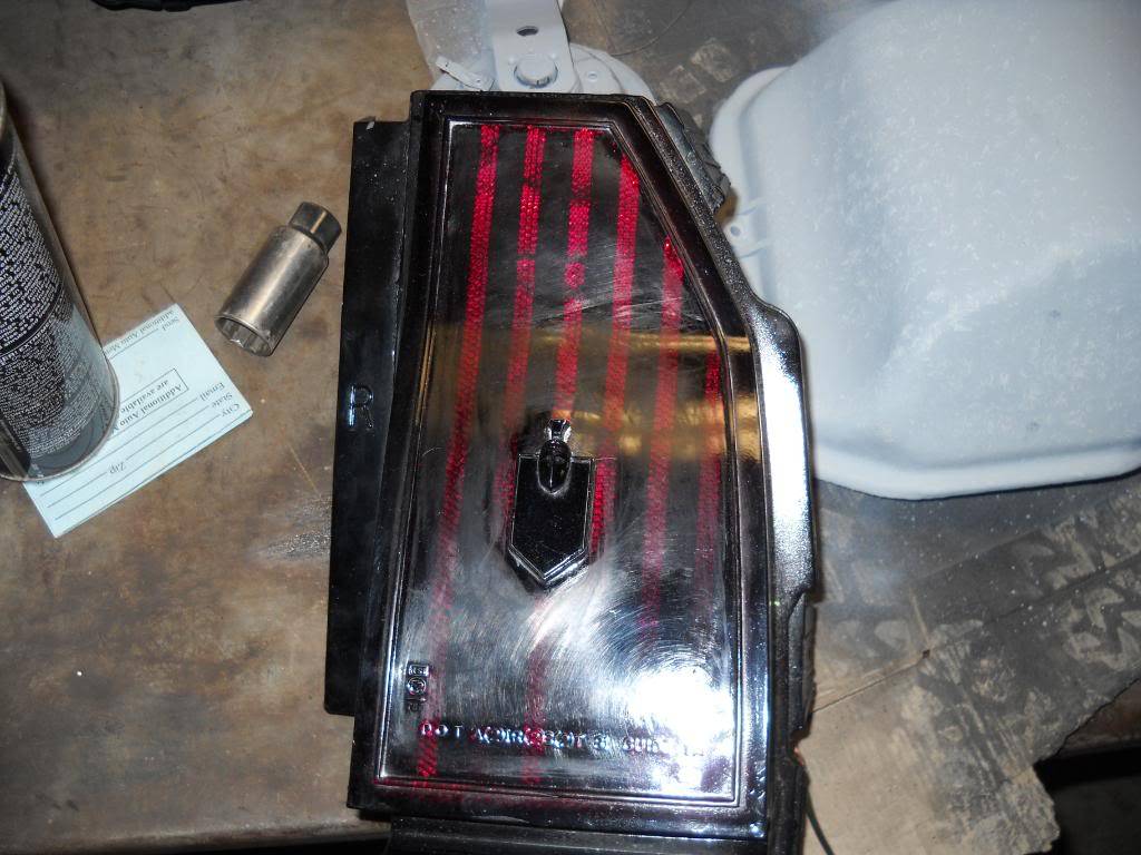

      Yes, I know the tank is all kinds of scratched up, that has been fixed.

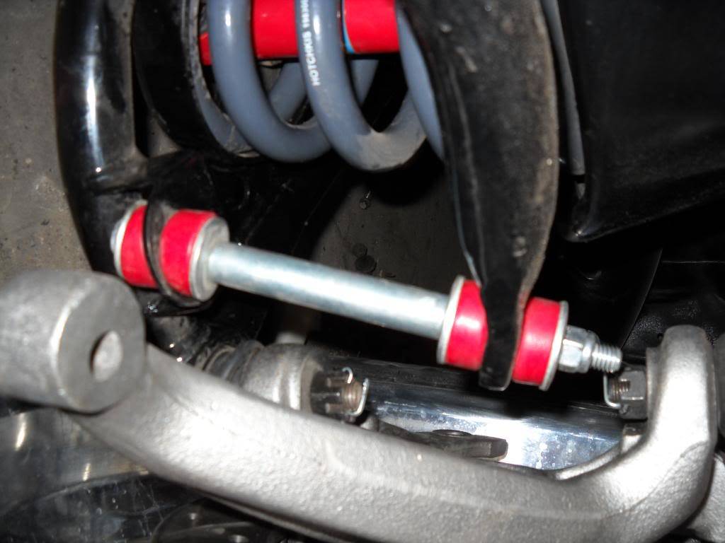

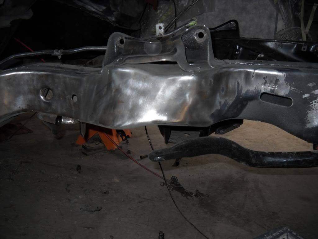

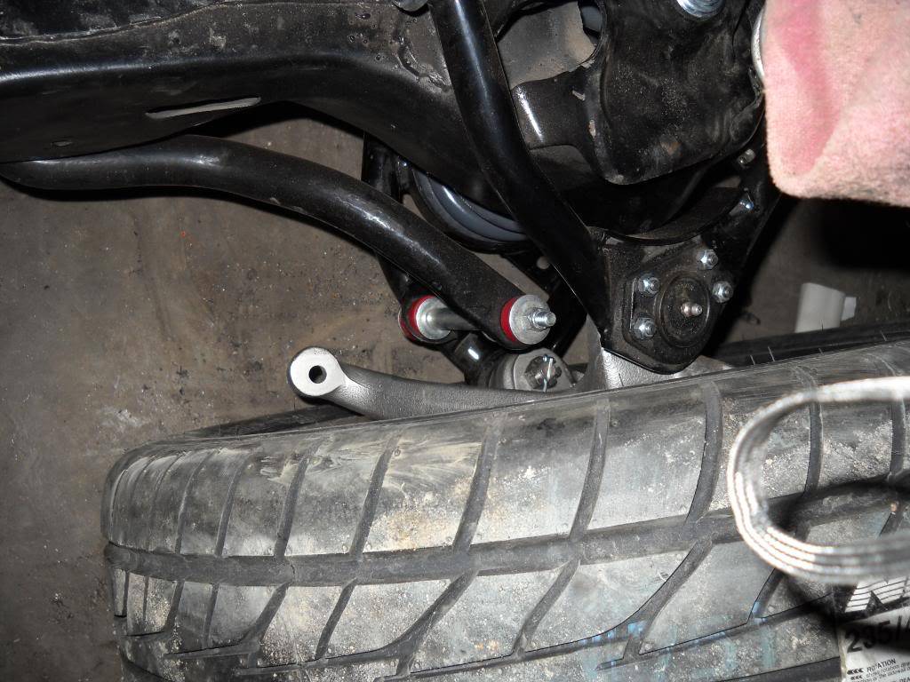

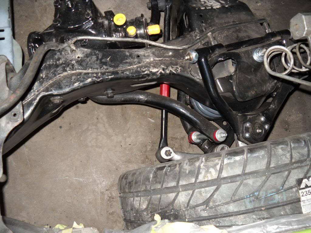

      How the front looked upon tear down. I must say that I was horrified at some the things that I saw when tearing it apart, five years of hard driving really does take its toll on factory suspension/steering parts.
      The before:
      The after...kinda.

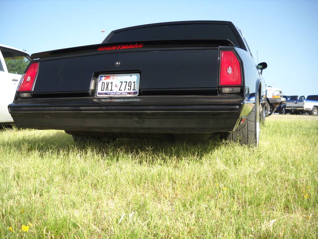

      How she sits today, excuse my poor picture taking skills.
      So, tell me what you guys think? Any advice?
