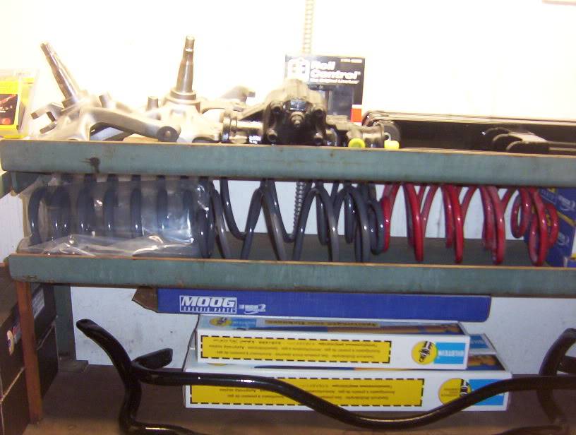

      700r4 trans
      3:42 Eaton locker (7.5" rear for now)
      Rear Suspension/brakes
      Boxed rear lower control arms
      Tubular upper control arms
      opg 2" drop springs
      Bilstein shocks
      UMI 1" sway bar
      Factory drums with S-10 cylinders for now
      Front suspension/brakes
      1" Hotchkis drop springs
      Bilstein shocks
      1 5/16" UMI sway bar
      2" belltech drop spindles
      Tubular upper and lower control arms

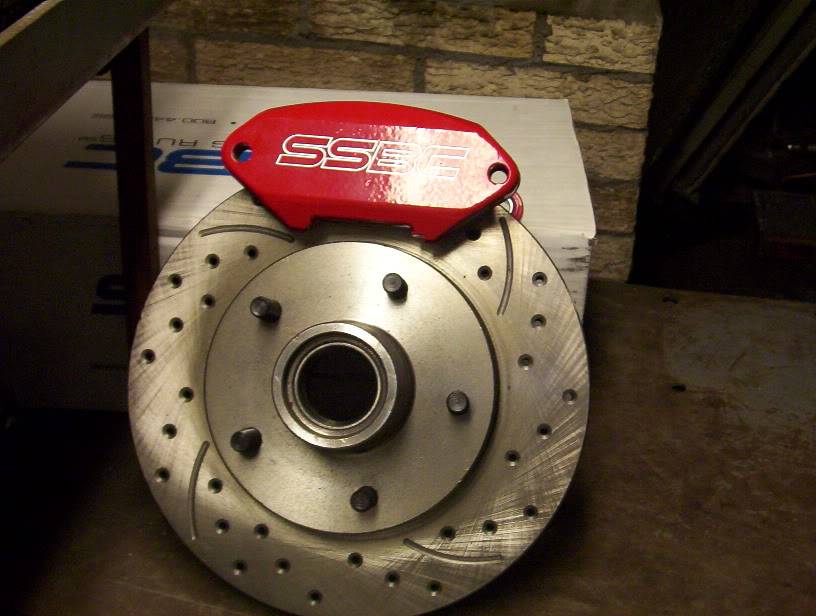

      Cross drilled/slotted rotors
      SSBC dual piston calipers
      Stainless steel brake lines all the way around
      Quick ratio steering box
      Jeep steering shaft upgrade
      Moog ball joints/ tie rods etc
      Kirban front frame brace/ f41 braces
      Motor plans are 383 stroker with about 450Hp 430tq
      Wheels and tires are
      17x7 front 17x9.5 rear Centerline Retros 235/275 Nitto's
      Future plans once the car is back on the road:
      SC&C Stage 2+
      SC&C front frame brace
      Baer front and rear brakes
      9" rear
      Frame notch
      Watts link?

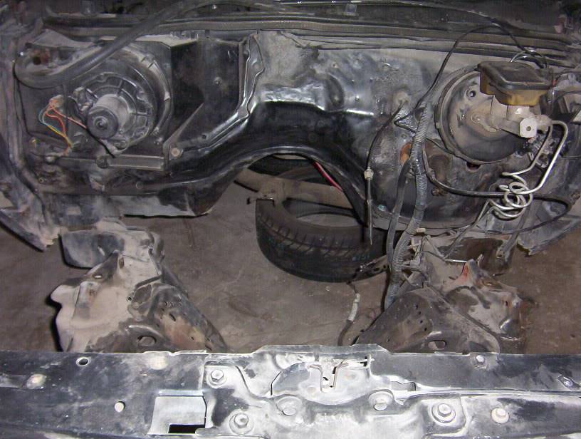

      This kinda gives you an idea of what the car looked like when I pulled it off the road, this was the day before she went in for tear down.

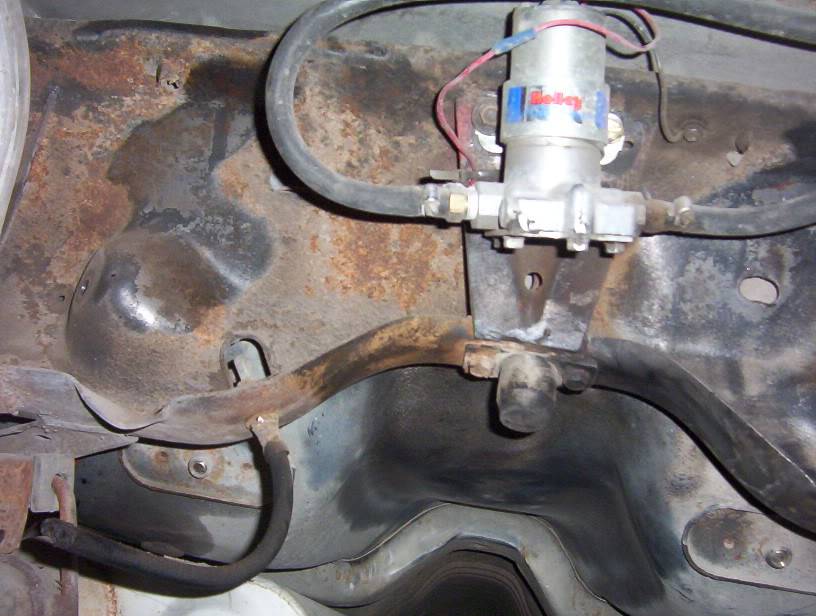

      This give you an idea of how the whole bottom of the car looked. I would just like you northern guys to notice ..........NO RUST, not even a single pin hole... LOL

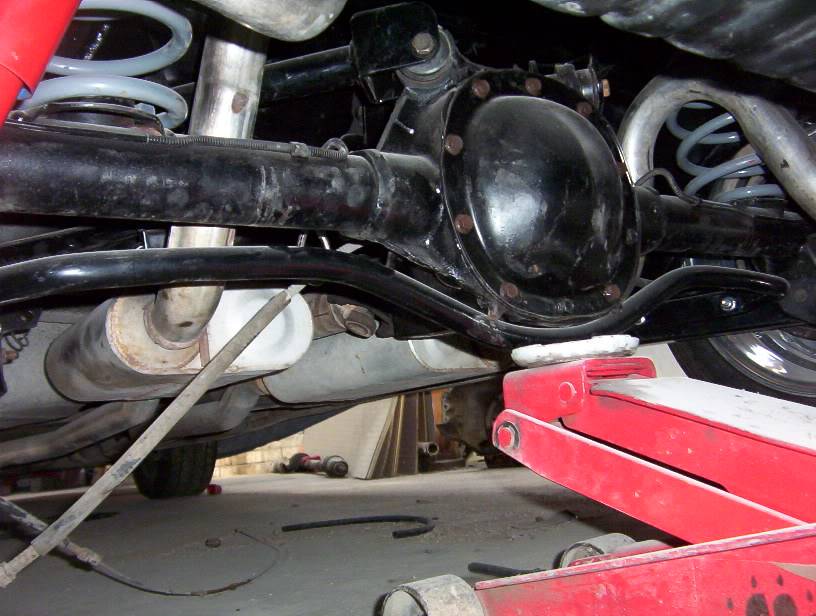

      The rear suspension, that goofy exhaust is gone.

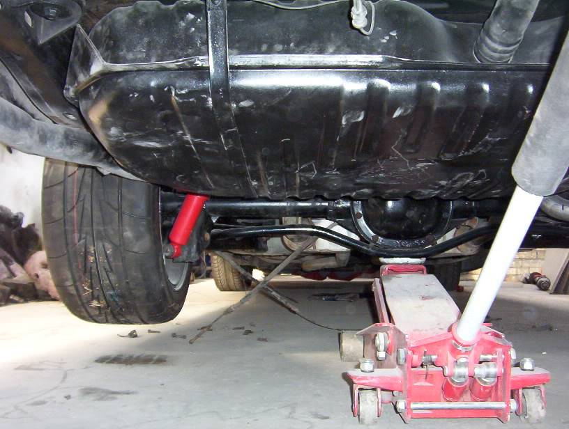

      Yes, I know the tank is all kinds of scratched up, that has been fixed.

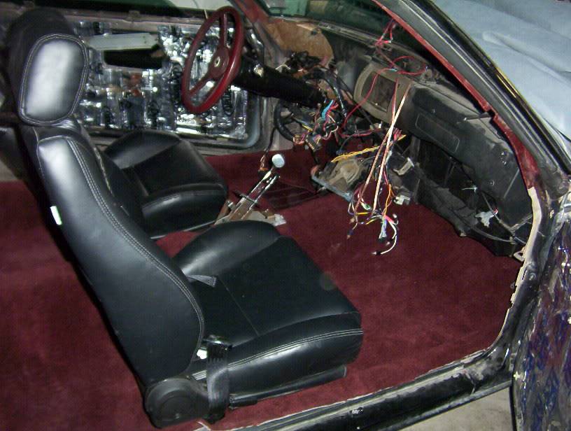

      The interior going back in.

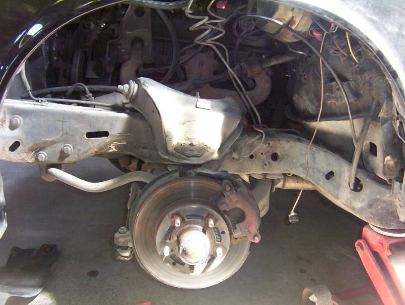

      How the front looked upon tear down. I must say that I was horrified at some the things that I saw when tearing it apart, five years of hard driving really does take its toll on factory suspension/steering parts.

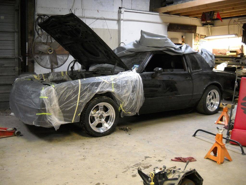

      How she sits today, excuse my poor picture taking skills.

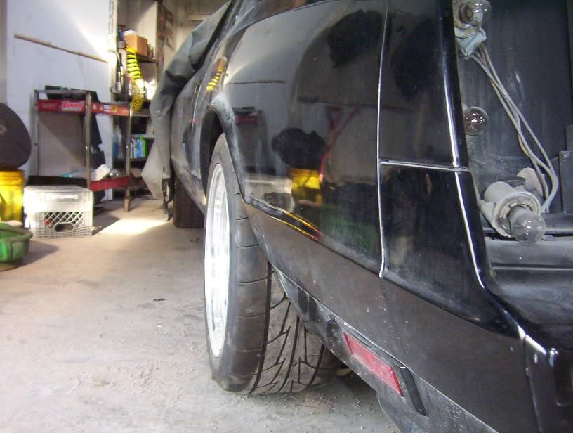

      whats the back spacing on the rims you got?

      The rims are as follows:
      Front 17x7 with 4" Backspacing
      Rear 17x9.5 with 5" Backspacing, on the rear I had to use a small 1/4" spacer on the passenger side because the rears in these cars are not centered, you may or may not have to use one on your G-body.

      what kind of seats are those?
      Oct 2009
      Copperas Cove, TX
      325
      Quote Originally Posted by bmx1112 View Post
      The seats are made by Scat/Procar, they are the 1100 series. I bought mine from Summitracing a while back, and also bought seat brackets for the Monte so they are direct bolt in. I love the seats, they are of very nice quality and super comfortable. I felt the styling was similar to that of the original seats, and I like them black vs. Oxblood like the rest of the interior.

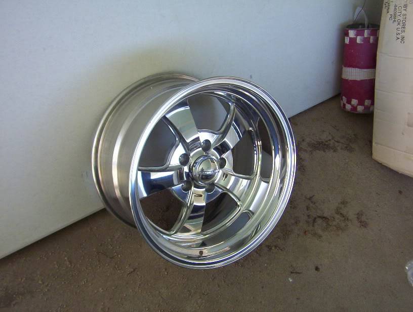

      I like the new wheels:
      Who makes them & what size(s) you running, along with the tire sizes?
      Quote Originally Posted by montessaj View Post

      ALOWERLEVEL--- Thanks for posting the info on the wheels
      Sam--- There ya go. Front 17x7 w/ 4" BS 235/45/17 tire.
      Rear 17x9.5 w/ 5" BS 275/40/17 tire.
