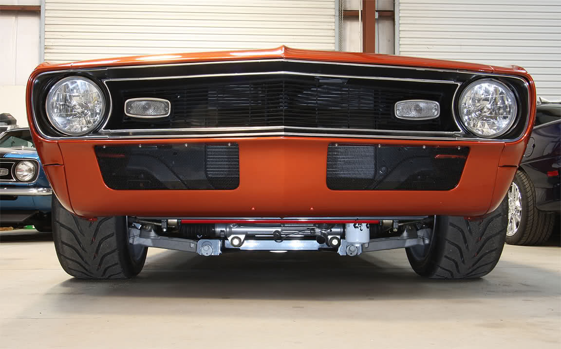

      Here's that lower control arm angle we mentioned. The good news is that you can see that the tie rod is parrallel to the control arm resulting in almost no bumpsteer.

      Silly question for Dave. In an SLA setup can it not work with either the top OR bottom arm parallel? Of course that setup would have to be designed in.
      True T.
      My blog
    6. #46
      Central CA USA
      6,114
      Penny seems to work darn well right now, so even though the lower arms are not level, it seems to work OK.
      Penny is darn low, so a lot of cars would not see any issues. One thing I just found out is Penny's subframe has vette suspension but it's been narrowed a lot more than I thought it was.
      For most cars, the lower A arm needs to be pretty close to level, and the upper arm inclined downwards towards the center of the chassis, some are around 2 deg inclined but that's variable depending on a lot of factors.
      Mustang II suspension has short upper and lower A arms, and a lower A arm angle the reverse of penny seems to work better for short arms.

      Tell me about it,I don't know if you have been following my Mustang build.I'm using a factory C5 subframe,and its about a foot wider then a 66 Mustang.Its funny I just did a bumpsteer test on the car the easy way.With the spring out of the front I cycled the suspension through its full range of travel,and the steering wheel did not move at all.Gm engineers were on the ball on that one.Keep the pics coming,love the build.Ron
      Just noticing that oil filter appears so vulnerable hanging out front there to debris. Ever thought about a shield of sorts?
      First, the K&N has a thicker housing and can take more abuse. Secondly there's usually a front spoiler offering some protection.
      Chance are that if I hit anything big enough to really damage the oil filter that I will have "bigger problems" to worry about.
      Hey, it's air cooled!

      You're definitely going the right direction with the spindles. That lower arm angle looks hideous. In fact I've found some of my best results on the computer are with a slight angle upwards to the chassis. Seems to reduce scrub while maintaining good camber control. Minimizes roll center movement as well. Those things must cost some serious dollars, but in your case they will be with it. Just make sure that you still have your turning radius. With high backspace front wheels you may run into tie rod interference as it will now be lower in the wheel and closer to teh outside radius. On the other hand the backspacing on my front wheels is 9" so maybe itsj just me. With the more normal 6.5-7" backspacing it probably isn't an issue.
      I should note that with the 17" wheels the angle was slightly less. Still, as bad as it looks it didn't seem to hurt the car very bad. But, if we make a bunch of little things better it should make a noticable difference.
      I looked and I don't think the turning radius will be an issues, but I will keep an eye on it. A bigger issue is how close the tie rod end is to the rotor. I worry about heat off the rotor killing the tie rod. Maybe I need a little heat shield. lol
      Yeah,I would look into fabbing something up there,it's a tight fit as is,surprised you haven't cooked them.

      Heat shields are a good idea. I noticed on the DSE and Morrison subs they are close like that too.
      David
      Yea, think of a small curved shield tacked to at small tab. That tab would sandwich between the tie rods castle nut and the steering arm. The tab could then be thermal coated to reflect heat. Or the tab could possibly be held in place by the zirc fitting.
