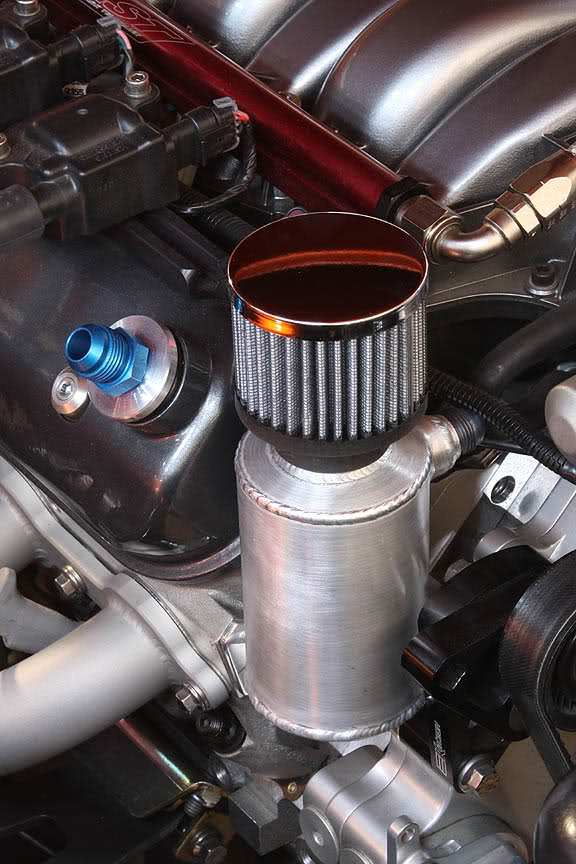

      The first item taken off the list was the oil breather system. Dave's skills and tons of equipment let us make my idea work.
      We welded a baffle into the Katech valve cover and then turnd down a part we had on the lathe to accept an AN fitting (it's 10-AN in the photo, will be 8-AN). We then cut down a breather tank to just the right size to package in front of the head. An 8-AN bung was welded in place. The tank was then welded to a head plate I had laying around. The whole tank assembly will be powdered in fine-texture-black like my closeout. I also have a cool idea to customize the breather.
      When done it will be a very compact and hopefully good looking breather tank and my oil spewing days will be over.
      Next up, sway bars and spindles...
