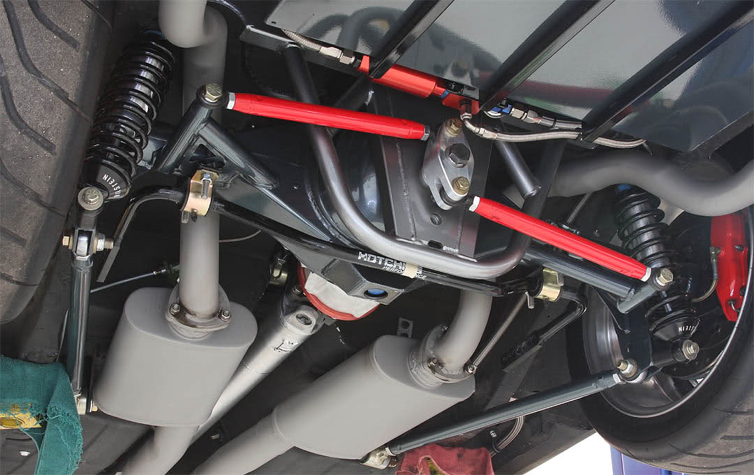

      Also, here are the adjustment points for the new rear sway bar. Quite a range of adjustability to choose from.
      The rear bar lb ratings per hole:
      hole lbs
      1. 737
      2. 612
      3. 516
      4. 440
      5. 379
      6. 330
      7. 289

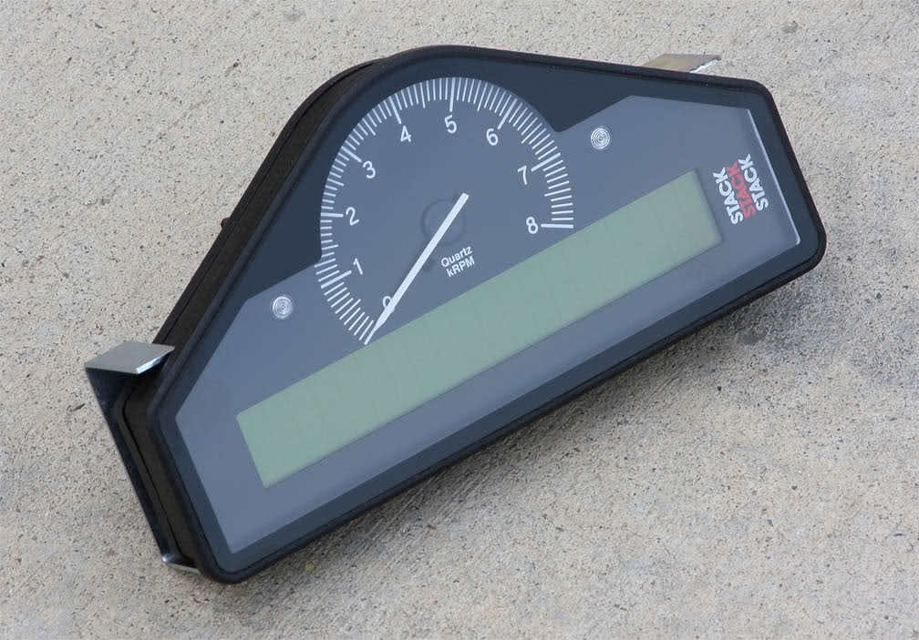

      My new STACK dash arrived from England today.. can't wait for the rest to get here since I've never had a analog tach that worked right.
      Here's the site.. pretty cool stuff and I like how it has an analog tach rather than a digital one.
      I got the street version since I don't need data-logging (my racepack does that). I also have a set of the center gauges on the way along with a sequential shift light option.
      http://www.stackltd.com/
      It's nice since they are part of autometer now. Beats calling Europe for tech questions.

      Wow the sway bar setup is really cool! How did you get the adjustability in the bar? Dont the hotchiks bars usually have enough room for just the 1 mounting hole?
      Michael
    19. #79
      Jul 2003
      Anaheim Hills, CA
      11,967
      Quote Originally Posted by ebncrdr View Post
      True.. but Dave modified the bar to accept more holes. I will grab a picture when I'm up there later this week.
