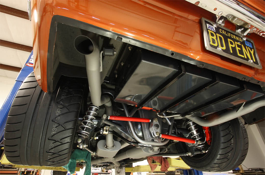

      Does Bad Penny ever get dirty???? Great looking suspension though.
      Quote Originally Posted by Steve1968LS2 View Post
      Pics of finished rear suspension:
    17. #137
      Jul 2003
      Anaheim Hills, CA
      11,967
      Yep, Penny gets dirty all the time.. I just keep her tidy
