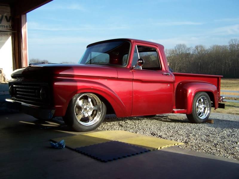

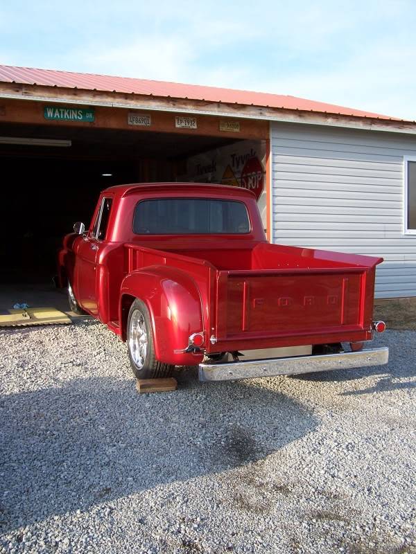

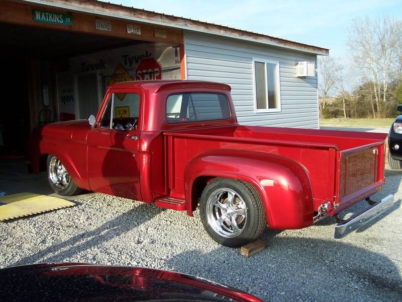

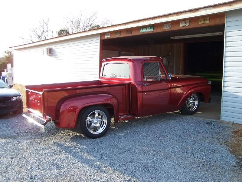

      Today was the first day that it was not rainning or snow coming down. So I took the truck out for some quick shots. I dont have the steering wheel on yet so thats why I didnt take it all the way out.

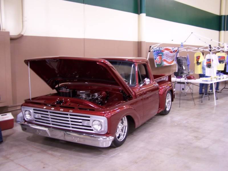

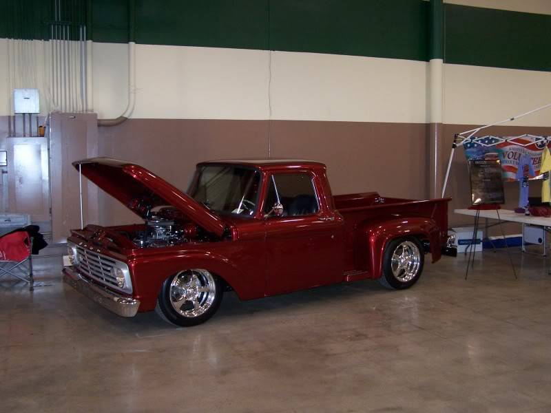

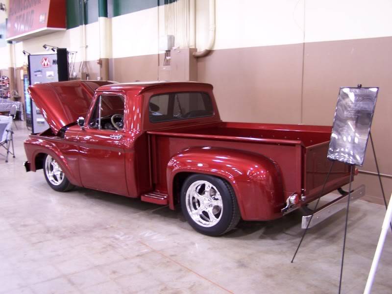

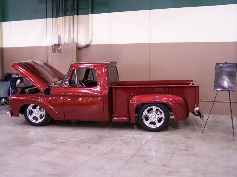

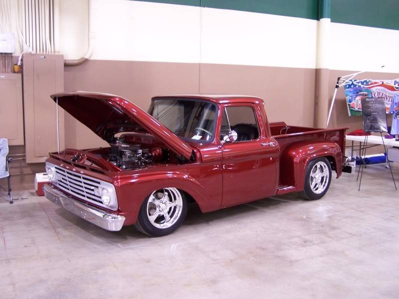

      Well the 63 made it to the first show. It was a local show here in Knoxville Tn. Looks like Im going to be pretty busy now. Me and Will from Hudsons Rod & Customs were able to get together about the Interior so It should all be done in a few months. Here are a few pictures from the show.

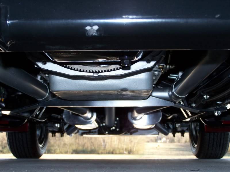

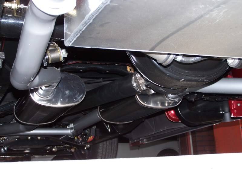

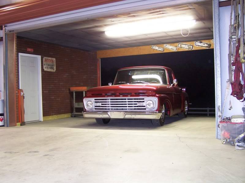

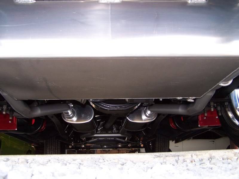

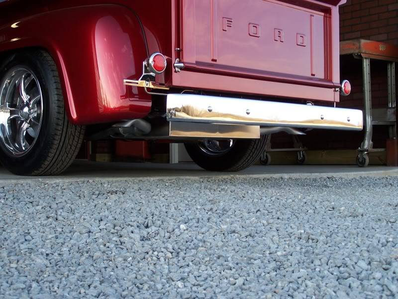

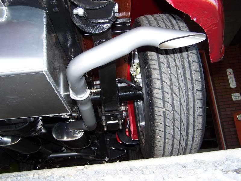

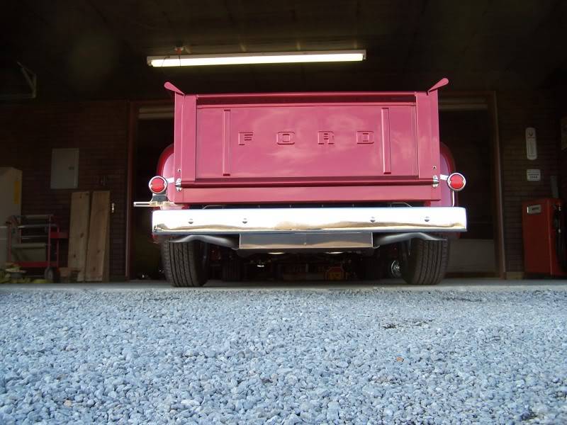

      Got the truck back from the Exhaust Shop today. We didnt have much room under the back but I think it turned out very good. Its 2 1/2" all the way to the back with S.S. MagnaFlow's and a H-pipe. I made a video too, I mean what good is pictures without sound right...lol and yes its running rich.
      NOW SHES OFF TO THE INTERIOR SHOP.

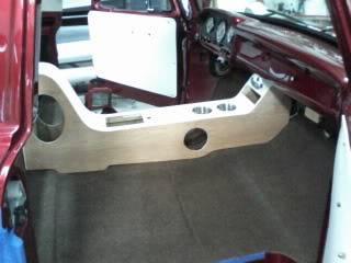

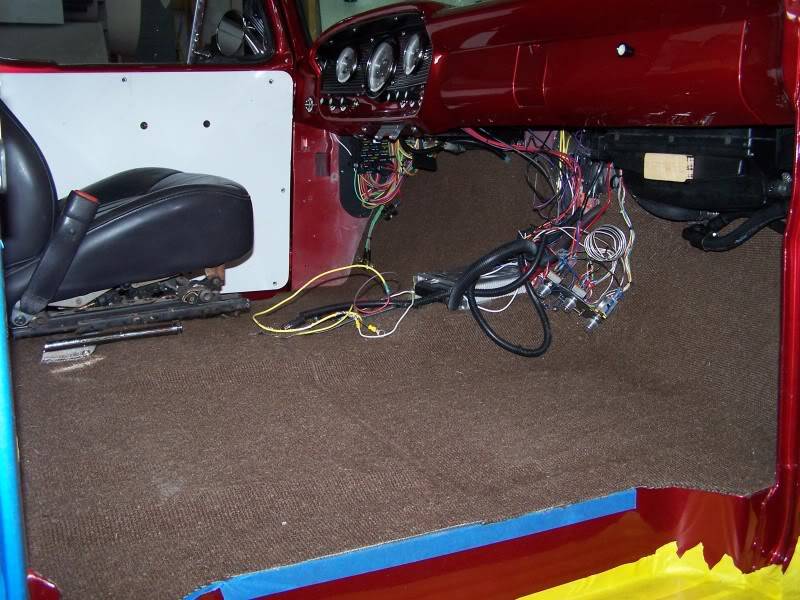

      Little update on the Interior. All the Inside stuff has been mocked up and pulled back out for the last time. I took a few pictures while I was up at Hudson's Rod & Customs. It should all be done next week and making its first big show at Chilhowee Park Knoxvile Tn for the Streer Rod Nationals South Show. See you guys there.

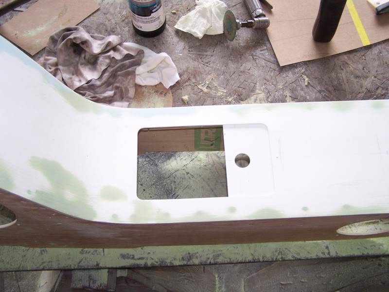

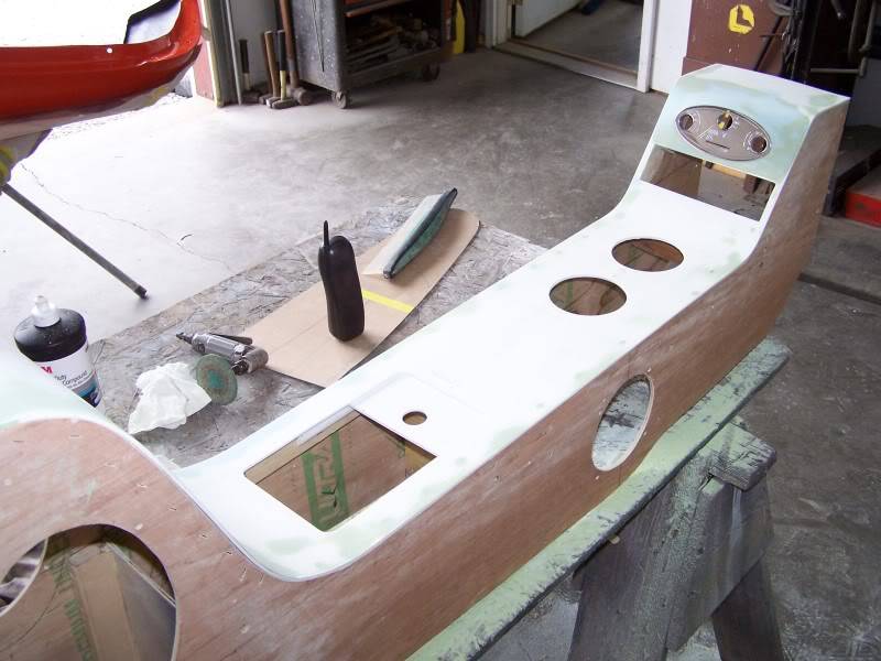

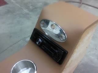

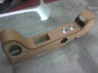

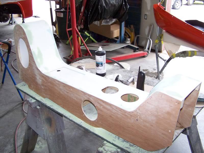

      Could you tell us more about the console? I'm interested in making one for my ride and would like to know how you came up with it. It appears to be a couple of pieces of thin plywood attached to spacers, with a formed top. My biggest question is how did you create the top (Curves, etc)? Is it fiberglass with some body filler on top?

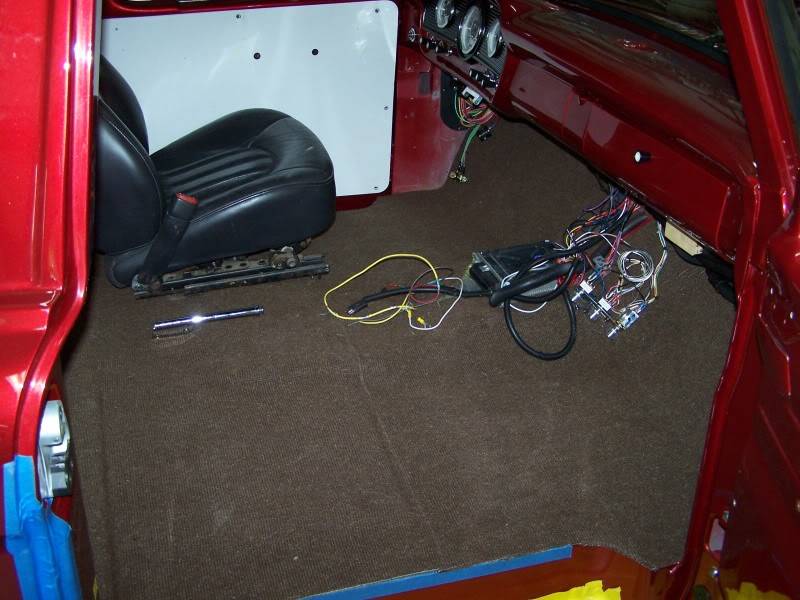

      I'll try to tell you what I can but Im not the one doing the Interior. We knew to get a Radio,Speakers, A/C contorls, Cup Holders and the E-brake hidden In the middle would all have to come from a console that would look good and take the load. O this also helps cover the EFI wiring and computer in the floor, see pictures above. The side's are a plywood with a wood trim Inside to be albe to screw too. The top is a ABS plastic that was cut out and them Heated and bent to the forms we need. The small amount of filler you see is just to smooth our screws heads and other edges. I hope this helps some.

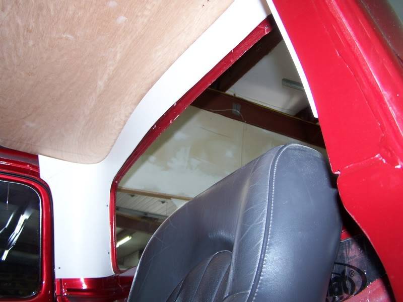

      Here are a few more pictures from today.

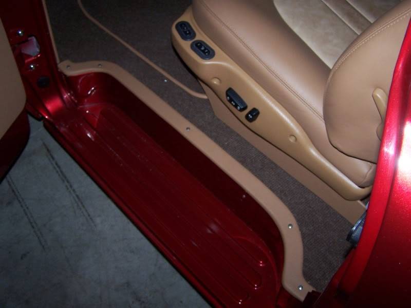

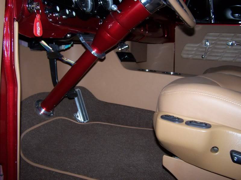

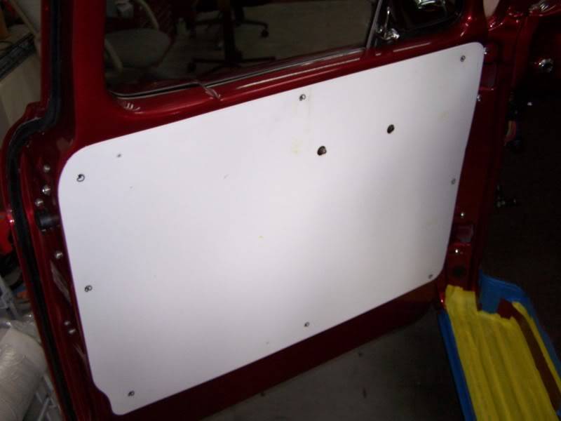

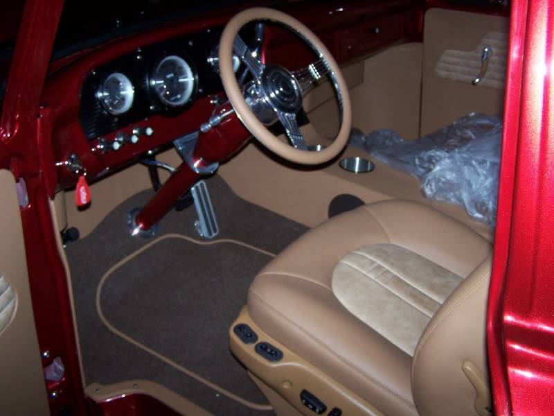

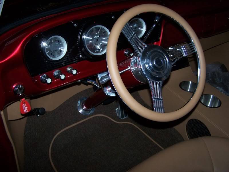

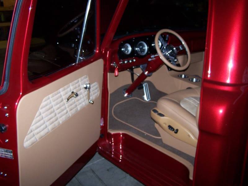

      Well I got the Truck back from the Interior shop and man what a good job they did. Our customer didnt want some thing that just jump out at you like most street rod Interiors do, so this is what we had Will at Hudson's Rod & Customs come up with. As you can see We used distress leather In the middle of the seats and doors. The smoother darker leather on the out side parts. When I get the truck out side I'll take some better pictures. O and this past weekend at the N.S.R.A. show in Knoxville Tn, Classic truck did a photo shoot of the 63. Any ways here are some pictures for you guys.
