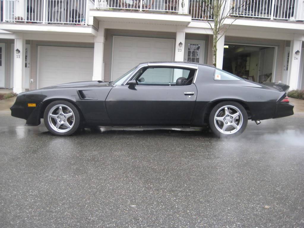

      Nice to see you've been driving it. I've been following your build for a long time. My 81Z has taken me longer than anticipated(due to many reasons LOL) but I'll be putting a permit on it and finally getting an alignment on July 4th then it's off to get dyno tuned. I hope to hit 400rwhp with my cam/longtubes LQ4. Here's a pic with the suspension finally done and the ZR1 wheels I'm using until I decide on the new wheels.

      Bad. The spindles that I used are my stock ones cut down to accept the KORE3 C6z brake parts. I did use Tobins billet hub to save some weight. Its not a hard mod to do and once I had them powder coated they didnt look bad at all.
      Yeah I was happy with the numbers that I got will what minor thing I did to it. next I will be doing a head and intake swap to try and get 450 rear wheel.
      I will post some pics once I get the car back together. Im having the front wheels widened to 18x9.5 so I can run a 275 tire. Also did a Ride Tech front coil over upgrade with a stiffer spring rate.
