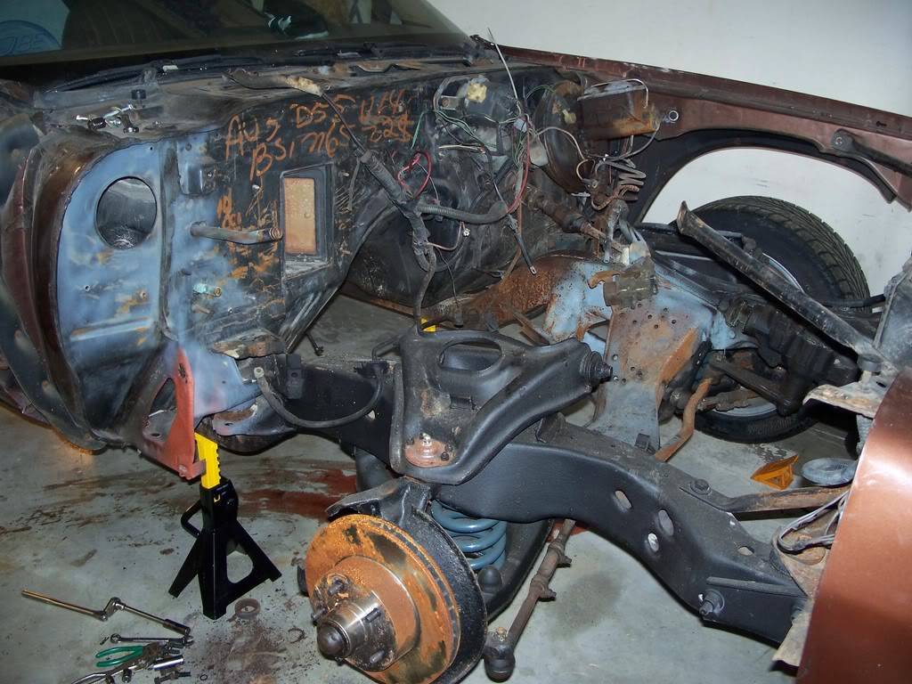

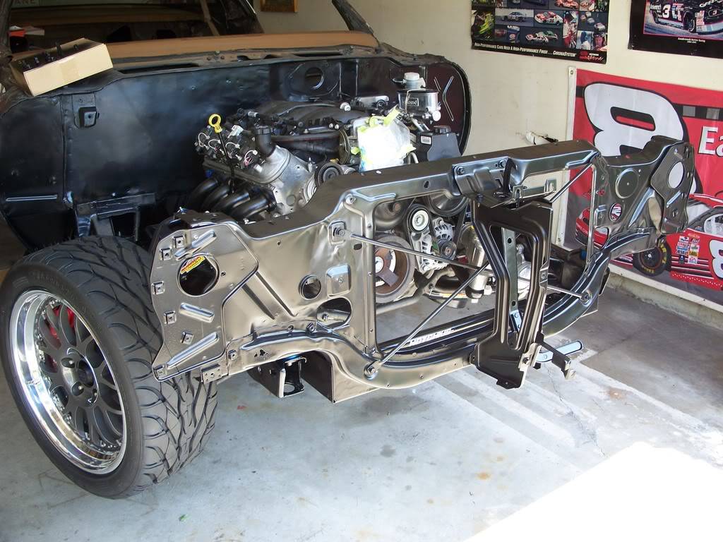

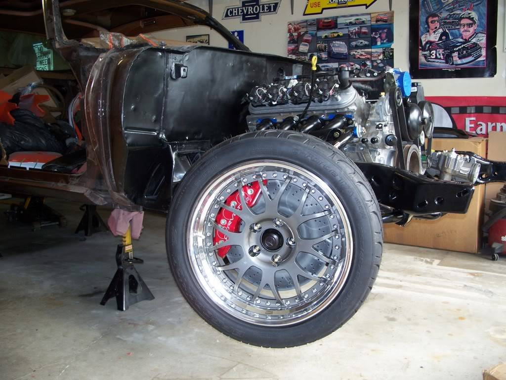

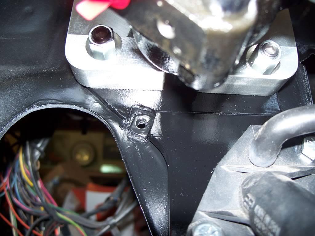

      Iam 23 years and have had the car since i was 15 years old. well its a 79 Z28 and iam trying to rebuild it. so I have a 2002 ls1-t56, with a torquer v-3 cam kit, ported ls6 oil pump, pushrods and pacesetter long tubes, and a moser 12 bolt rear. all the other stuff you can make out for yourself as its not much yet. so here are some pics.

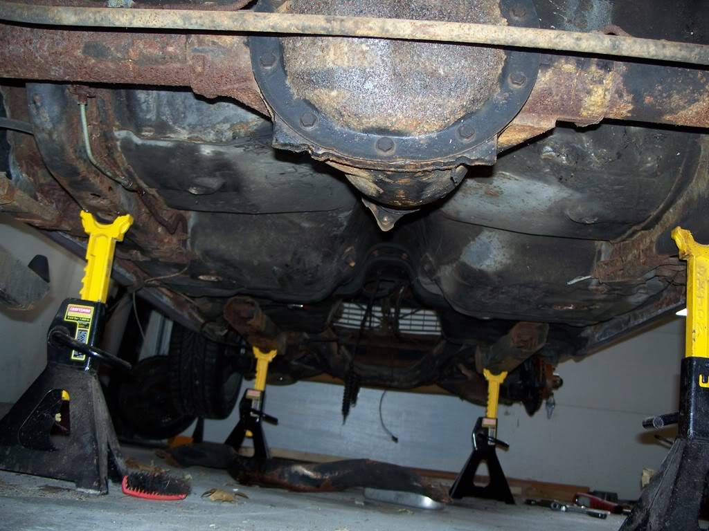

      Here you can see what i had to do inorder to use the ATS clutch braket. cut the slot our to the bolt/screw for the steering column
      and what i started with after i took it apart the first time when i was going a diffrent route then PT from stock

      Great work.. the car is coming along nicely! What did you use for your underbody black?
      its POR15 but i sprayed it on about 35psi I think that gives it a diffrent finish.

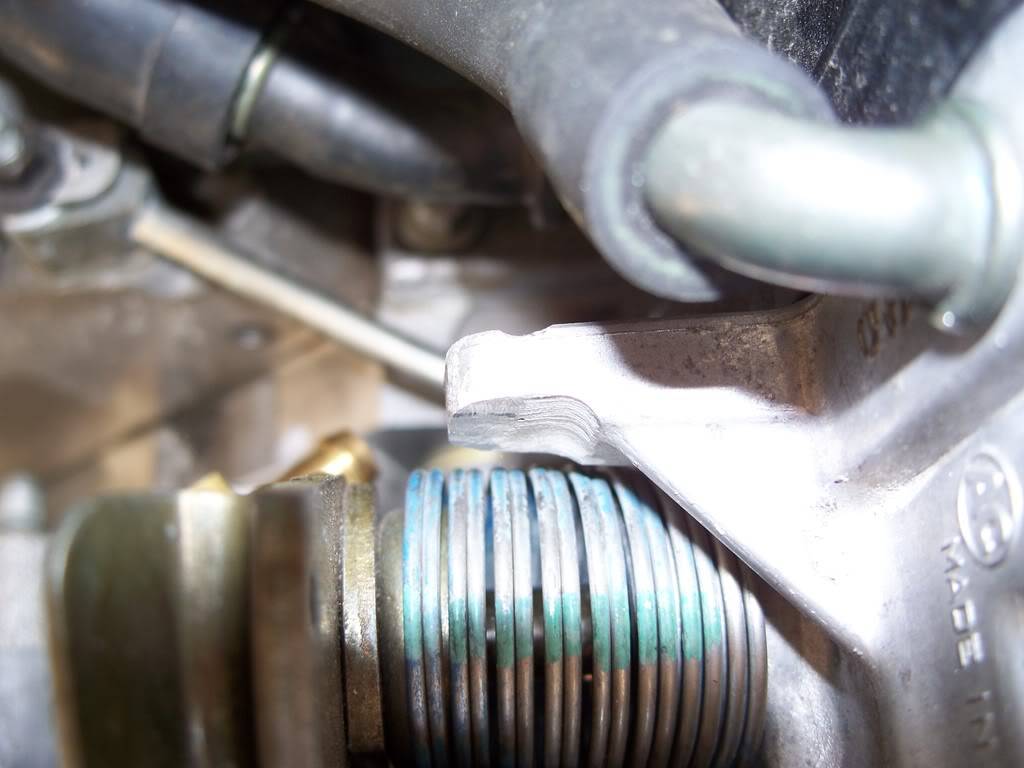

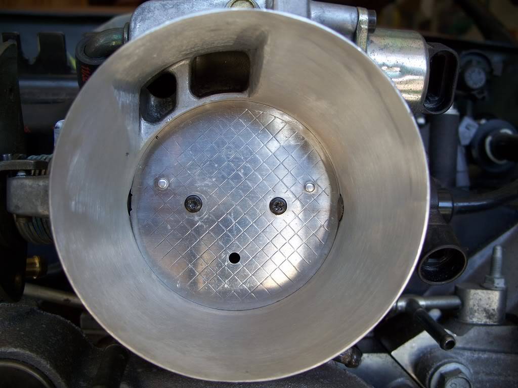

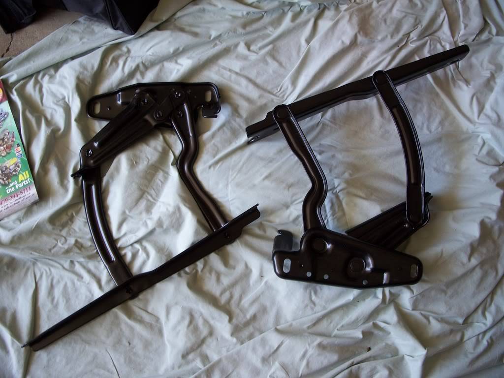

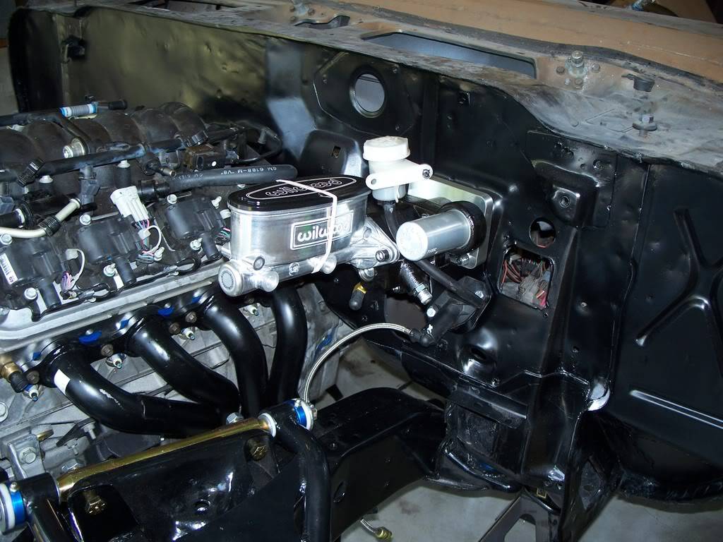

      Have not done much as I cut a tendon in my left hand and have not been able to use it for the past three weeks and still have about two more to go but I still get around and work on the car just dont tell my Doc got the core/support back from powder coating and you can see were the blasting broke threw were the battery had been leaking, but not much i can do about that now. at least you wont see it, along with the hood hinges.I also had sent out my LS1 T/B to be ported, and to have the cross shaft and bump stop mod done to it and I think that it came out real nice, for those that know about the rear brake situation iam having to get a machine shop make the rear t-bolts that i need for the KORE3 e-brake kit to work with the big ford bearing on my moser 12 bolt but i should have it together next week but hear are a few pics of the parts on the car and still need some clips and stuff but i cant get those free from work will post up more whn it happens.

      I used the big style ford bearing but got the chevy 12bolt ends. with these ends you haft to use a t-bolts because the tube is so close to the hole. and with the kore3 kit need longer bolts so i having them made. I hope that makes sense
