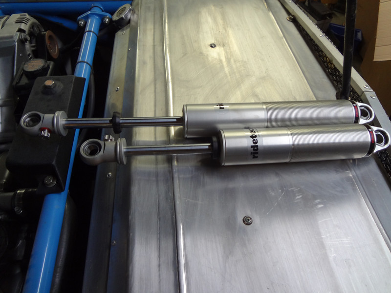

      You shouldn't have to wait too long, I'm dragging the old girl into the shop this week for some upgrades. Finally taking off the 4x4 Rancho shocks, Brett at ridetech just sent in the new shocks, was joking with him that I hope they work as good as they look, because they have that jewlery bling to them. Have new sway bar from Hotchkis, and I'm pretty sure I'm going to do a full floater rear, with 3.18 gears (to cure my knockback and rev limiter issues). And finally gets some harnesses in the car that fit. And one last thing, windows, yes I'm tired of getting wet at out rainy events. Would like to have it all done before my first event in Jersey, while still pecking at my AMX, lofty goals but I should get it done.

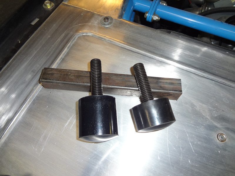

      This is really weird, have two threads going at once. Started getting this car ready for the new season, put the new higher bumpers on the new Vette Brakes 940lbs front spring to get the car up a bit. Putting the new ridetech shocks in, these shocks seem sooo much better then what I had. Need to change up some baffling for the oil cooler, and then go back to the rear.

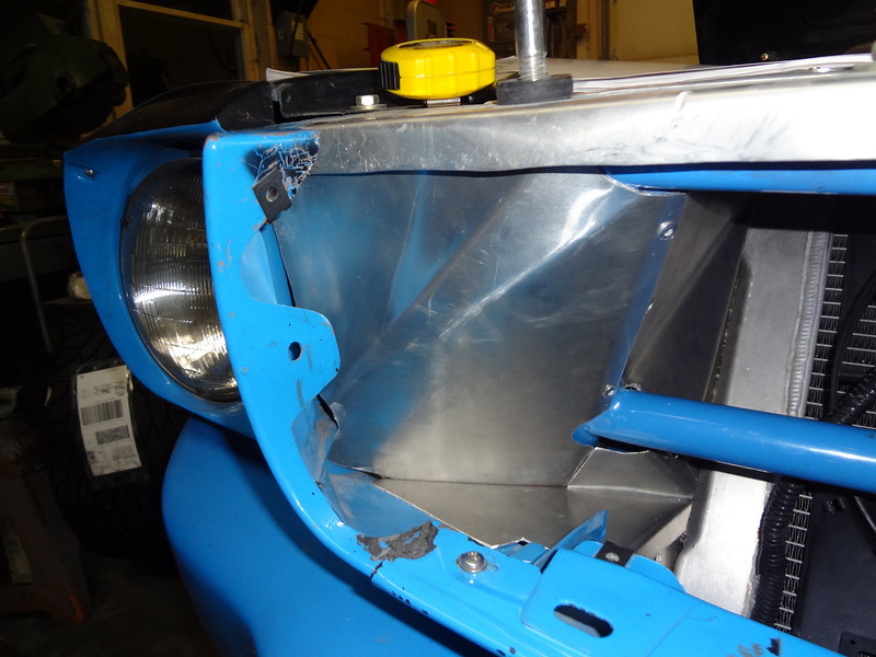

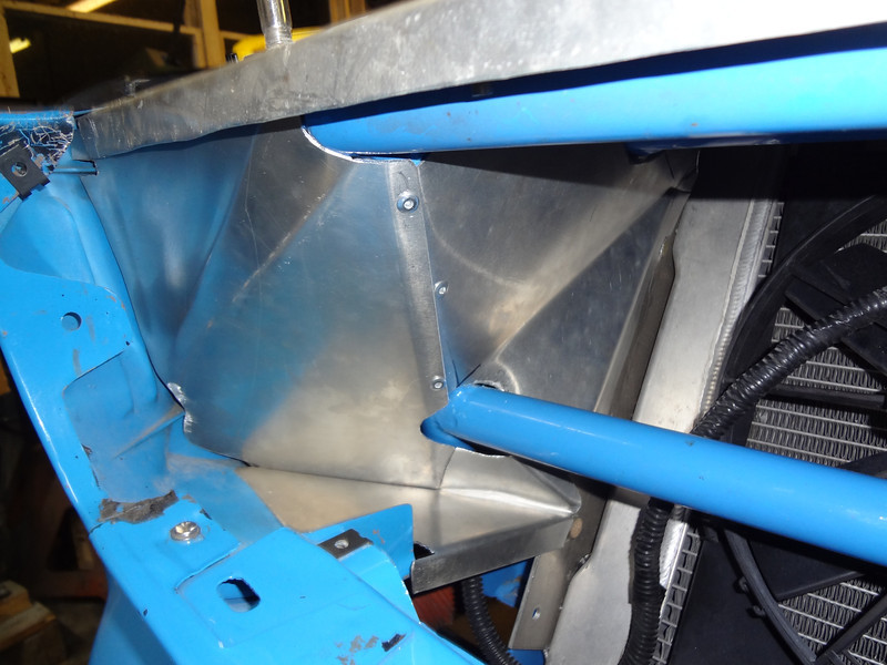

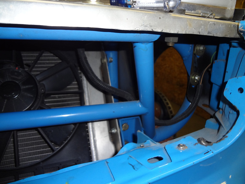

      Pecking at a bunch of little things on this car, got the new shocks and swaybar on. Had an overheating issue last year when I was really leaning on it, got to 300 degrees a couple time at VIR. Don't really know why, at 150 mph I'd think the air would just push through and cool OK. Thought maybe the air was bypassing around radiator because the front of the car was wide open. Started filling in these areas with aluminum, what a PITA. Hoping it funnels the air were it belongs.
      Ron Schwarz

      That should direct the air to the radiator a whole lot better!

      I sure like your sheet metal work, great job on radiator director
