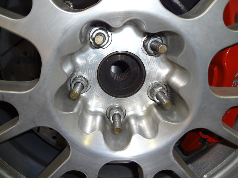

      I've driven cars with Detroits in them before, I remember the ratcheting, I just don't remember them sounding like they're broke. Those cars had interior, mine is the inside of a beer can, that must be the difference. Took it out again tonight, that is one sideways sliding machine. Will try to drill and change out the front studs to the 5/8" units later tonight.

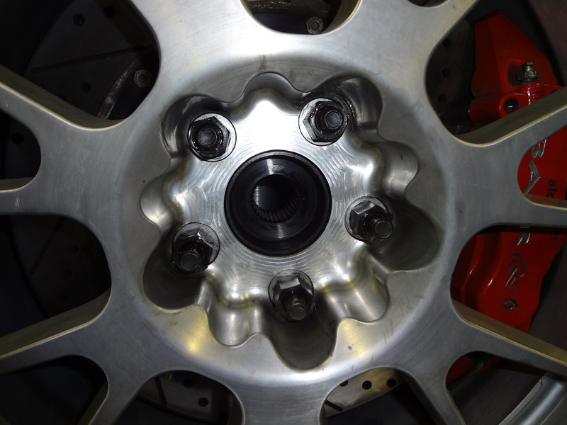

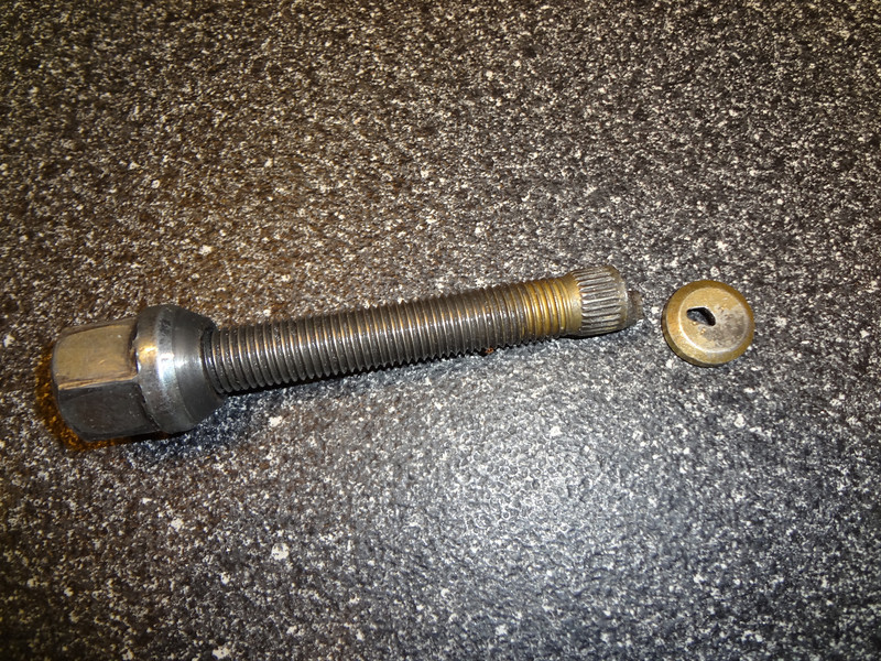

      Got the new 5/8" studs in, still can't beleive the ARP stud head popped while torqueing the wheels (the head is tiny), kind of scary. I think I'll get used to the locker, its just different.

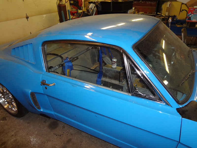

      OK, anybody that runs in the American Street Car Series needs to send me cash. It is now a guarantee that any event that I attend, will not have rain or any inclement weather. Because I now have windows and weather stripping, what is this world coming to.

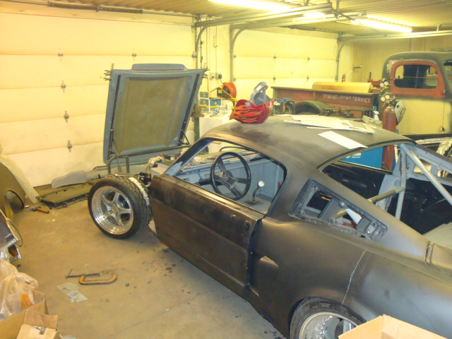

      I knew I wasn't going to be able to use factory hinges,and front portion of the cage is landing right where the hinges would be.I figured I'd hinge the hood in reverse,but didn't realize how hard it would be.The nose of the car is so far past the pivot point, the hinges had to lift up before they pivot out.Took a whole day to calculate and fab some mock ups.Ron
      Do you think its possible to put this hinge setup on a factory radiator support?

      I don't see any reason you couldn't put that setup on a factory core support. It took like 8 hours to fab that thing, getting the angles right is crusial, because the hood has to lift up before it pivots back so it can clear the grill. I remember I made that hood bracing out of an old bed frame, (makes me giggle) what a peice!
      The car has changed alot since then, I had alot of fun making something out of nothing . Unfortunatly I'm back to my normal call and order it self, kind of miss the $5000 budget. On a side note, I hadn't looked in a while but this cheesey, low dollar build thread that I thought no one would care about, has almost 400,000 hits. Goes to show you Pro Touring is not all high dollar super shiney show peices.

      I seriously contemplated making a one peice side glass, fabbing new tracks etc., but I just have too much going on right now with the AMX and a bunch of family comitments. For as twisted up as the body is, the car is amazingly air tight, and like Tommy said, its finally a street car, a heavy street car, but a street car.
