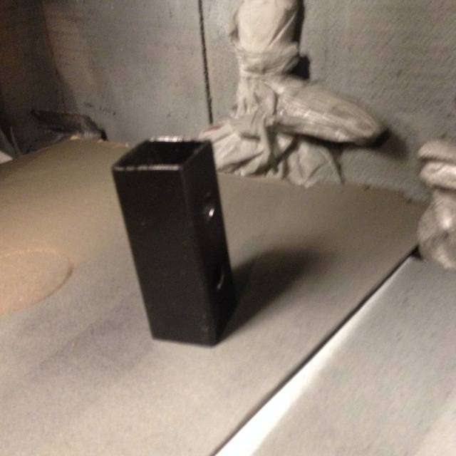

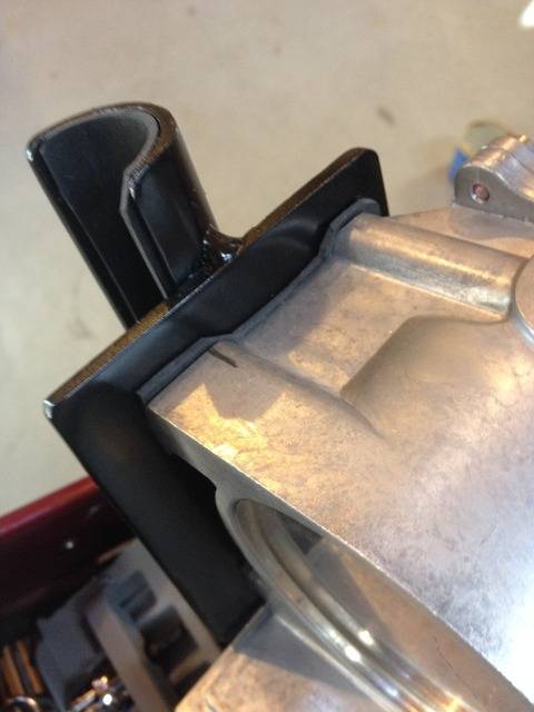

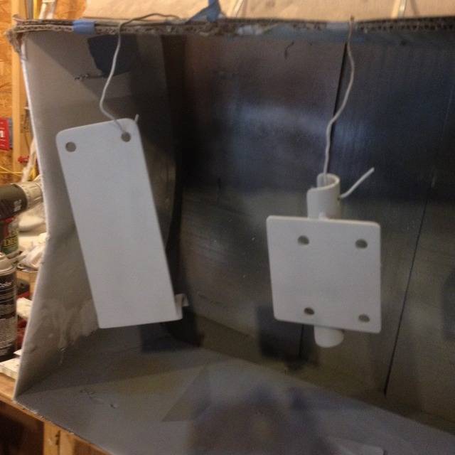

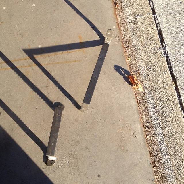

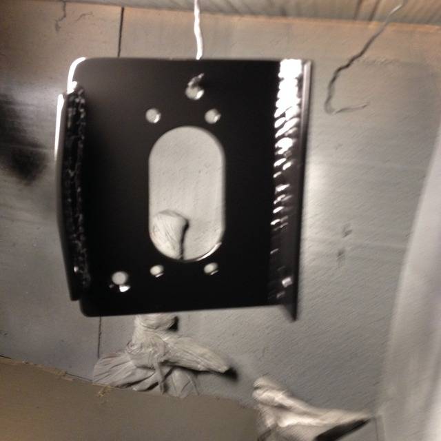

      I spent all day and most of the night in the garage Friday removing mill scale from my brackets we made. Holy moly I wish I was as tough as that crap is!! It took for ever, had to quit because I could feel my neighbor zeroing in on me with his rifle for the compressor running after 11:30. He shouldn't complain there IS 9' between his bedroom and the garage. The next day I used Eastwood fast etch on all of them, then sprayed them with high zinc content primer. Then some black paint. Thank God for my reperator, that zinc paint will kill you quick.
      Here's a few pictures.
      Here's a couple of the brackets after Fast Etch
      Some primed parts. Smaller is for the Heat exchanger pump and the long one is for the remot oil filter.
      Both installed
      I also did the same to the spacer for the trans mount, and the remote hood latch.
      Next will be the piece of the latch that connects to the hood.

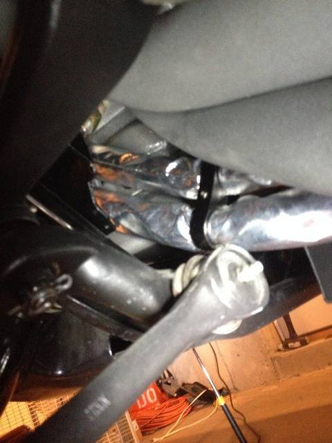

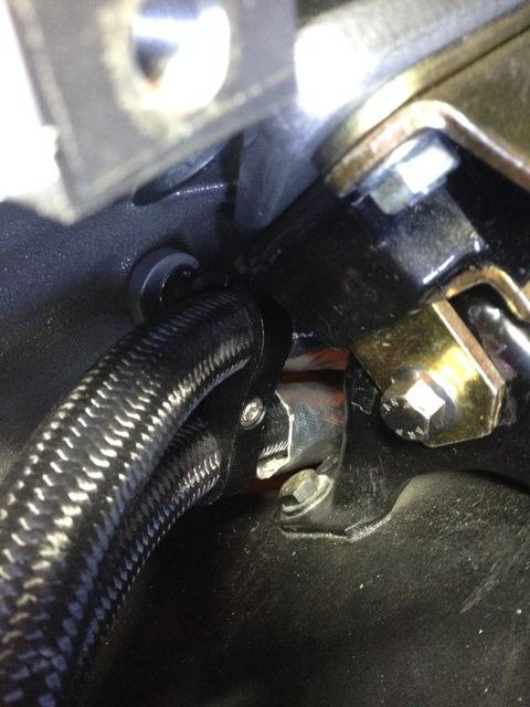

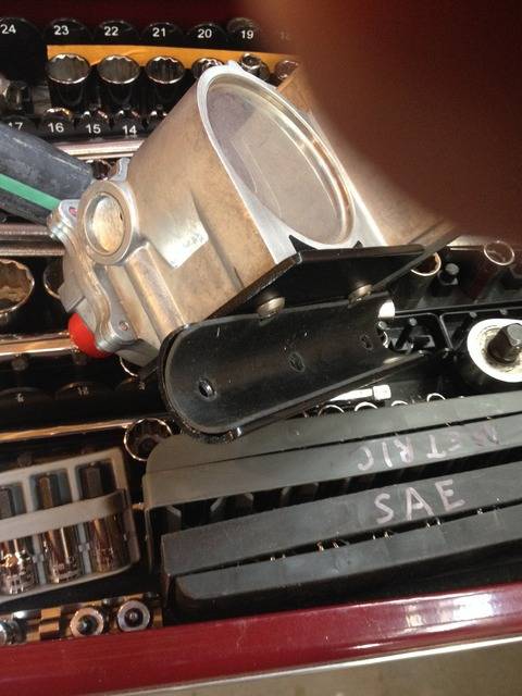

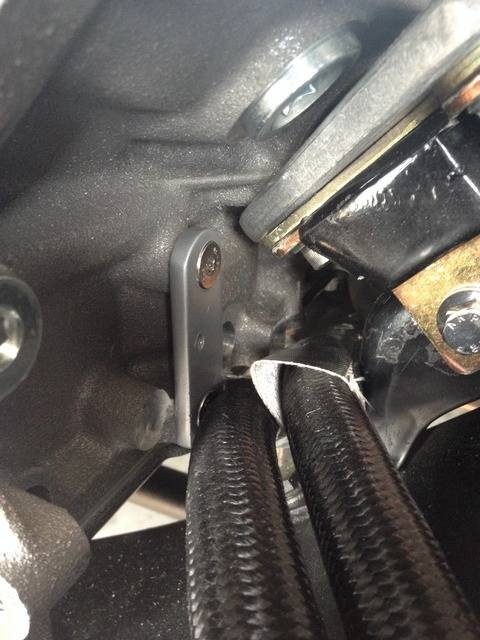

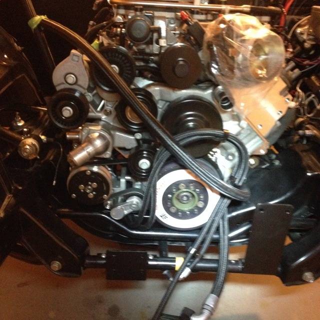

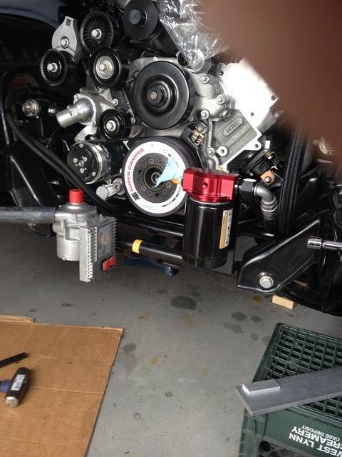

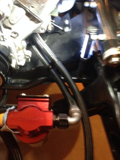

      I was out there all day today and got some stuff done. I installed the HX pump and oil filter, then I put some hose seperators to keep the oil lines away from the headers.
      I put a rubber liner between the brackets and the mounting point so I won't get any vibration from the pump.
      Here's where I mounnted the hose seperators.
      These will direct them awa from the Headers down near the oil pan.
      This keeps them away from chaffing on the framee stand and the third one away from the power steering pulley.
      I'll add one more once I get the radiator back in so I can make up the hose in it's final position.
      Here are the oil filter and HX pump mounted.
      Tomorrow I might get the radiator support back in.

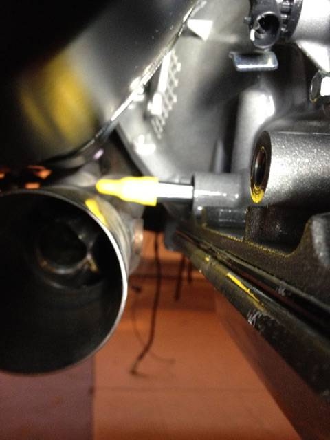

      The headers bolted up.
      I noticed the driver's header isn't bolted up all the way. clearance issues with the linkage?
    9. #409
      Nope Just left loose so I could get to my oil cooler hoses, they were only on loose so I needed room to tighten them. The headers are tight to the block where the line run to the front, and if you are using a 4l85 the bungs for the 02's need to be on the outside not on the inside (facing trans) like they come from ARH. There is actually plenty of room near the steering box than it looks like. If you need any pictures of anywhere special I can get some for you. But I'm a hack photographer.

      Mar 2016
      84
      yes, if you don't mind, can you get pictures of the clearance near your transmission at the linkage area with the header bolted fully down? my ARH headers clear beautifully everywhere except the collectors are burried into my linkage. ARH said that the headers will not work with the auto transmission (although their website does not advertise that fact).
      have you fit up the headers with your actual shifter linkage in place yet? the shifter bracket is what's in my way. mine are 2" primary on 3.5" collectors though.
    15. #415

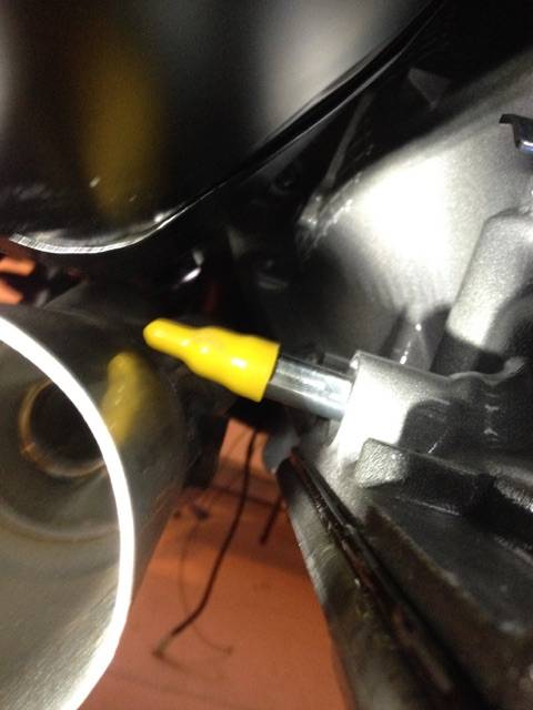

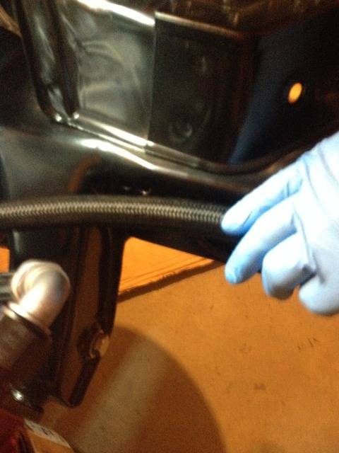

      Mine is the same way The newer 4l85s have a long linkage rod that comes out of the trans for the connection to the linkage. The older version has a short rod sticking out. I was told by someone who works on these transmissions that you can change the long rod to the shorter one which he says is an easy job.
      Here's how tight mine is
      The other rod is, I would say an inch shorter.

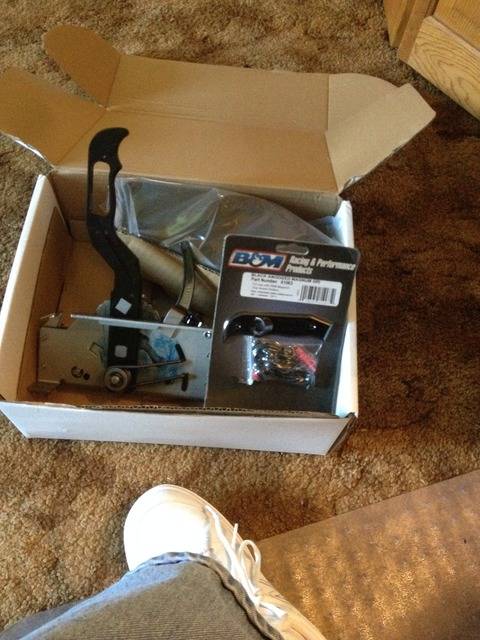

      I just got some parts in, I ordered my XRP hoses and fittings for my intercooler and Hydro boost plumbing. They came in yesterday. I got the new shifter in this week its a B&M Pro ratchet shifter in Black pistol grip.
      I also got the handle for the momentary button for roll control. I'm going to try to fit the shifter in the 5th gen Camaro console.
