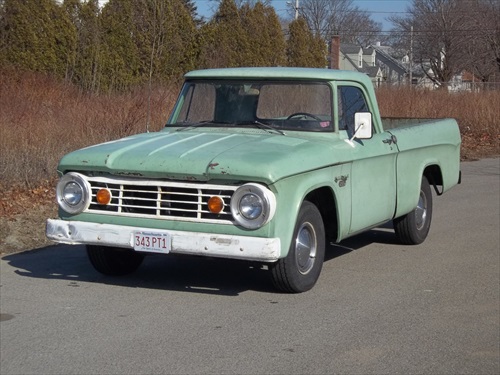

      This is just the beginning of my latest project. It a 1967 Dodge D100 shortbed that's getting a Gen III Viper engine, trans and rear end from a 05 Ram SRT10 chassis I bought. I also hope to use the brakes and anything else I can.

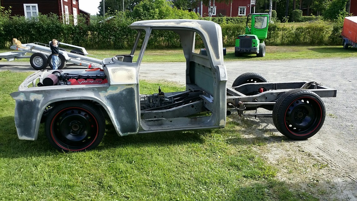

      looking forward to your progress Tin. check this link out
      http://fordodgetrucksonly.forumotion...viper-stepsideName:  69 v10.jpg
      Nov 2010
      579
      I've seen this build before, it was on a European website ( the text was in Swedish ). It's a cool build, I was hoping to steal some ideas....;-)
