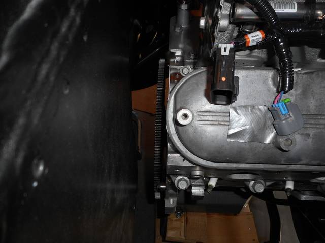

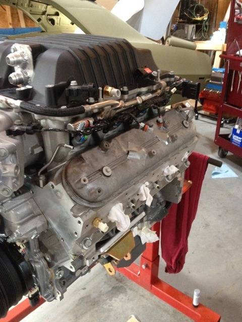

      After punishing my self by hand digging a 4'x4'x 42" deep dry well in the front yard Saturday. I was going to get some stone for it today but the weather tuned nasty up here so I got out in the garage. I Changed to an old set of valve covers so the LS lift adapter could fit and finally got the engine out of the crate and on the stand. I'm hoping to prep it and paint some clear on it to help make it easier to keep clean. Then I'll put the Auto Kraft oil pan, motor adapter plates and motor mounts on it and see how its looking. I'll probably try the headers on it to see if there is enough room to run an Improved Racing oil thermostat off the oil filter area.
      What do you guys think about the way the engine stand is bolted to the back of the engine, the way the right side is on the two lower bolt holes because of no bolt hole at the 2 o'clock location?

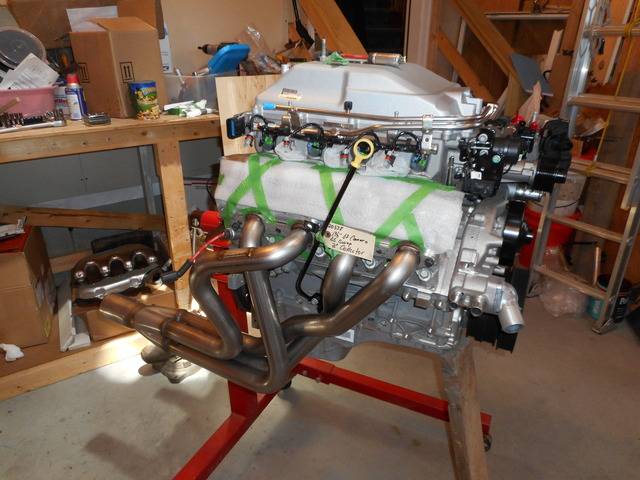

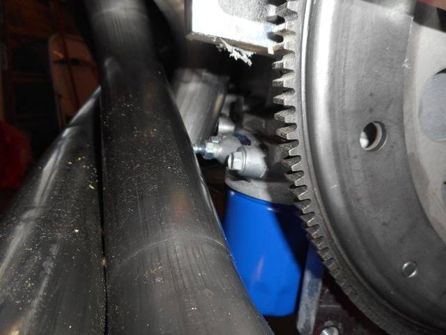

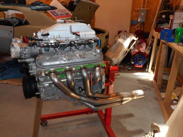

      I tried the headers on the motor to see what they looked like for fitting an oil cooler thermostat near the oil filter, it looks kind of tight.

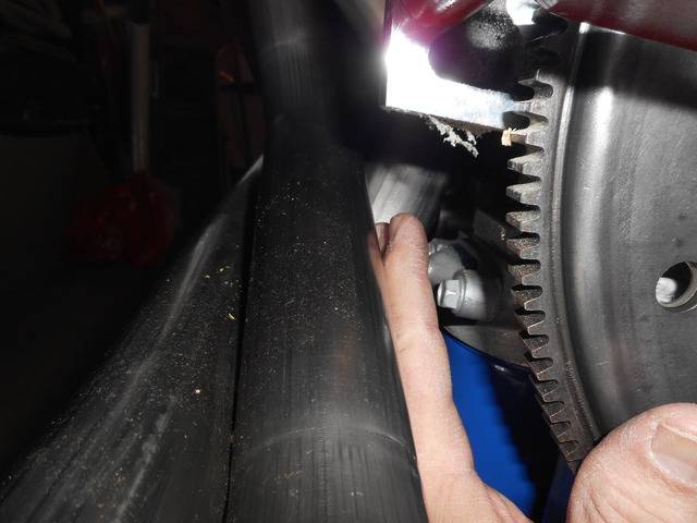

      This is tight ! Its a bad angle.
      There is just enough room to get my finger in there
      I'm not sure if its too tight to the headers for the Improved Racing oil thermostat to fit without soaking up too much heat and the thermostat staying open because of it.

      Headers look great Wayne, maybe you can get away with modifying them slightly.
    9. #309
      5,560
      They sell a remote thermostat but this would be a cleaner set up. If It won't work I think I'll use the remote set up.

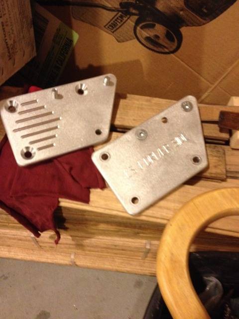

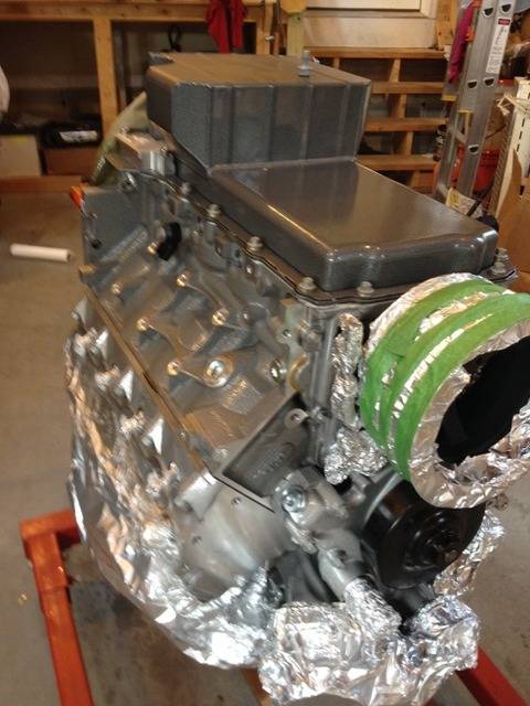

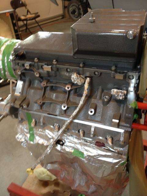

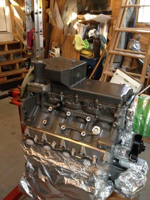

      Spent most of the day out in the garage today. Installed the AutoKraft oil pan and dip stick, then I washed the motor down and sprayed it with Eastwood's 2K High temp ceramic gloss clear. I'm no painter by any stretch of the word but I'll tell you it came out nice! The nozzle was great, nice fan pattern and it worked great. I also cleared my Street & Performance LS swap adapters. They look great.
      Tomorrow I plan on rotating the engine right side up.( This thing seems so heavy on this engine stand.)
      Then we will change the supercharger lid to the ZL1, and put the swap plates on. then see what we do from there.

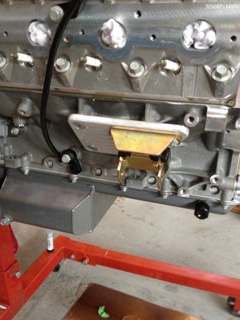

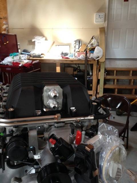

      Went out in the garage today. We got the ZL1 lid on and the swap plates and motor mounts. We had to grind down the spacer plates from the back of the poly motor mounts so they would sit flat against swap plates, then I sprayed them with some paint to prevent any rust build up. If I would have thought of it before I painted the swap plate, I would have routed them out to fit. Lesson learned.
      I had -12 AN fittings put on the the ZL1 lid so I can use a -12 to-16 hose fittings to matchup to my Stewart EMP water pump which has a 1" hose ends, it should make a difference in the IAT2 temps with more flow.

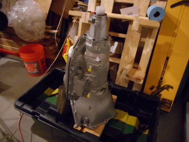

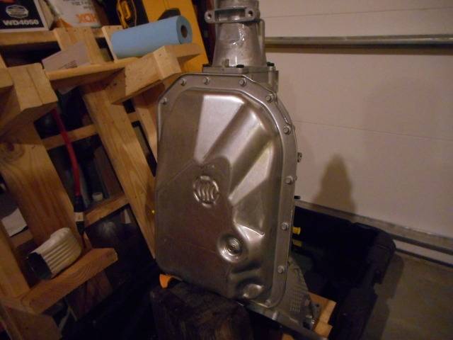

      I spent most of yesterday in the garage working on getting the transmission prepped and clear coated. First I had to go and pick up a new respirator my old one failed on me when I painted the engine. I didn't smell anything but boy did I get dizzy and a head ache. Not good!
      I washed the transmission down and sprayed it and the dust cover with the Eastwood 2K Clear. They look pretty good. This paint is easy to spray because I'm usually heavy handed when I spray but no sags with this paint.
      Not much light in the garage but it shows the gloss.

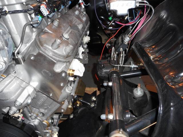

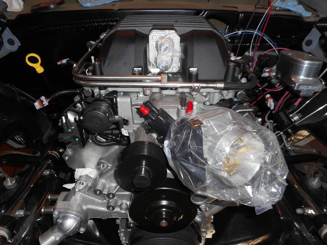

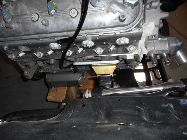

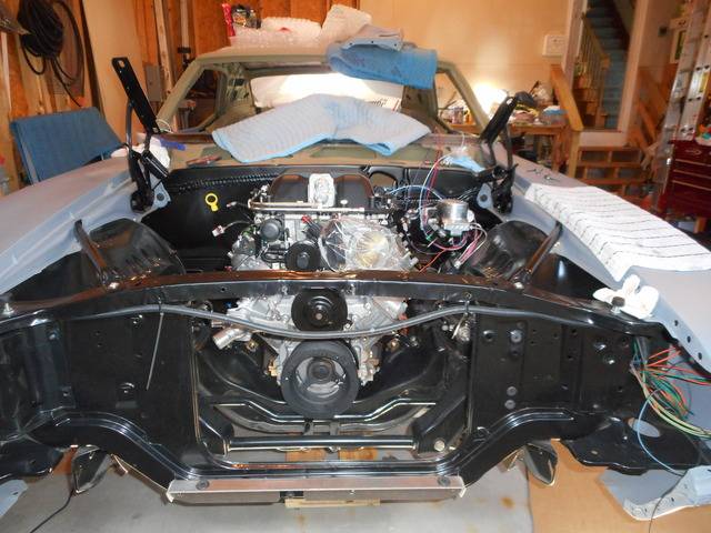

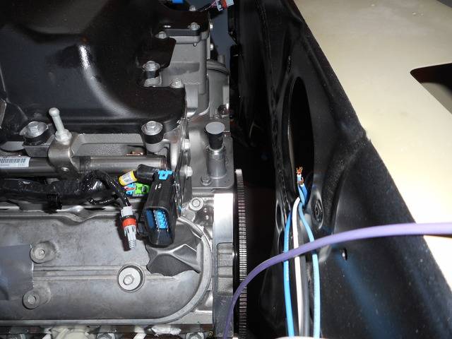

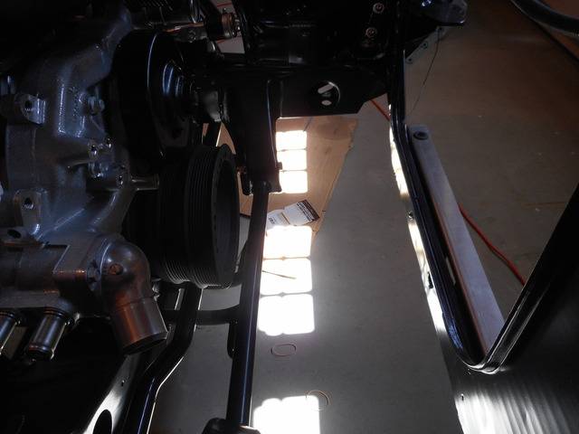

      Yesterday I went to my friends house and got his engine crane. Took it home and got it assembled and put the Mac's lift plate on the engine. Then the dreaded honey do list reared its ugly head and I was toast for the rest of the day!
      But today was a good day! We hooked up the crane to the engine and rolled it over and within 30 minutes it was in! When we tried the first time the bolt on the driver side went right in. I couldn't believe my good luck, then the other side was not even showing the hole in the frame mount. CRAP ! We put the jack under the drivers side and lifted and I saw daylight on the passenger side mount. I worked a screw driver in and the bolt went right in. These plates were an excellent fit. Now if the headers fit with them like they are supposed to we'll be golden.
      Here are some pictures.
      First the money shot LOL
      Room on the drivers side 2-3"s
      Tons of room in front of the motor
      Looks like plenty of room for the headers on the passenger side.
      Plenty of room back here.
      I have an Auto Kraft oil pan on here and it has plenty of room with the factory frame mounts and steering. Not touching anywhere. I turned the steering both ways and no problem. I used the backing plates that came with the poly mounts. If I see there is enough room, I might try it without them but if it helps the headers tuck up tight to the floor they will stay. I have plenty of room above the Transmission because I had the tunnel raised just incase the T56 I was going to use was tight.
