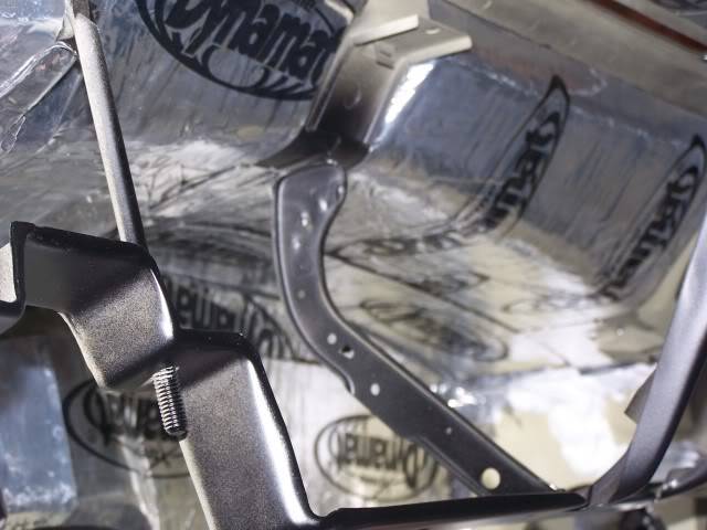

      Well here's a small overdue update. I've been tied up with the back and family stuff but I have been working on it a little.
      I started putting the Dynamat in. Here are a few pictures.
      I did the complete door skin and the front part of the quarter panel.
      Under the dash is started is started.
      and most of the floor is done.
      I put a couple of small pieces in the vent holes where the kick panel goes just to deaden the sound a little.
      I finnished the 1/2" fuel line from back to front but don't have very good pictures. I'll get some better ones.
      Here's what I have planned for my filters, pump and regulator. It will go at the front of the tank something like Lenie used on his car.
      I also put in the brake line front to rear and across the front of the sub frame.
      And I bolted up the plates for the DSE connectors so they can be welded to the sub after they are painted.
      We drilled and tapped the plates plus put a nut on the back side.
