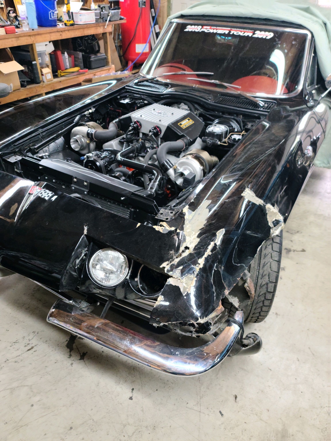

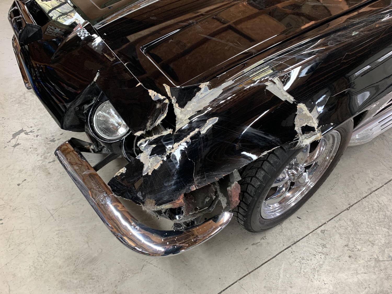

      2020 strikes again... Sorry to hear about the car, that's an awful thing especially since you just got it up and running again. Care to share any pictures of the damage?
    7. #87
      Apr 2020
      101
      Quote Originally Posted by ryeguy2006a View Post

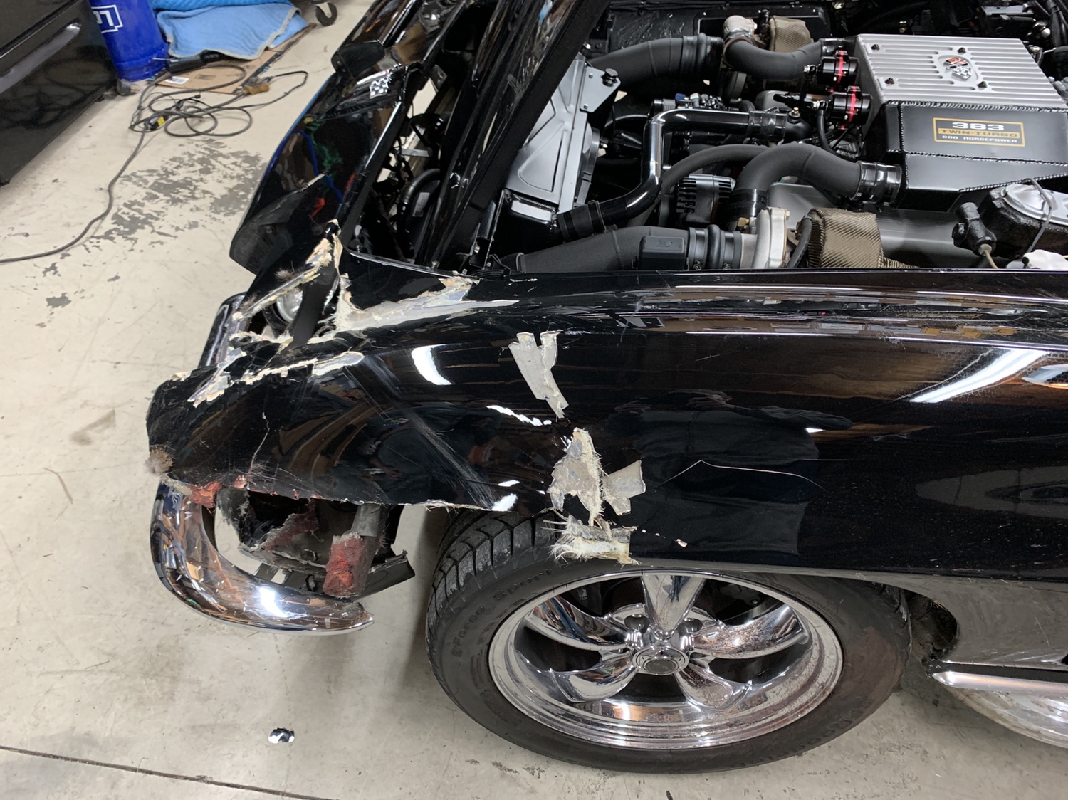

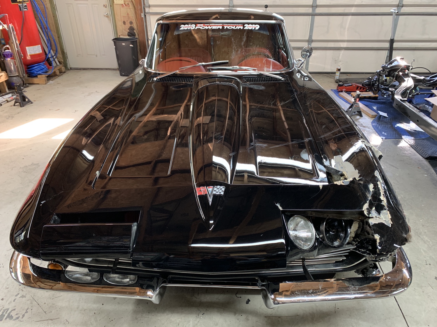

      Ah man...you called me on it! LOL. I try not to look at these, but I don’t mind to post a couple. I actually keep the car covered up in the shop right now just so I won’t dwell on it. Anyways...
      The good news is, I put a deposit down on a SRIII chassis today. So I’m stoked about that. It’s about 4 months out, though. So I’ll remove the wrecked front end and break all the turbo stuff down while I’m waiting. Will also cut out the stock rear tub and bond in the new rear tub with larger wheelwells. Then once the chassis arrives, I’ll transfer the cab and rear body to the new chassis and take the car to Charleston for the repairs and paint.
      The car is going to be down for a while and that’s disappointing, but what can you do at this point.

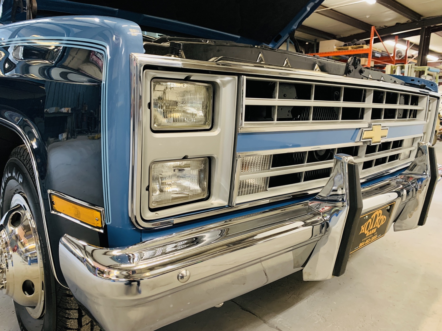

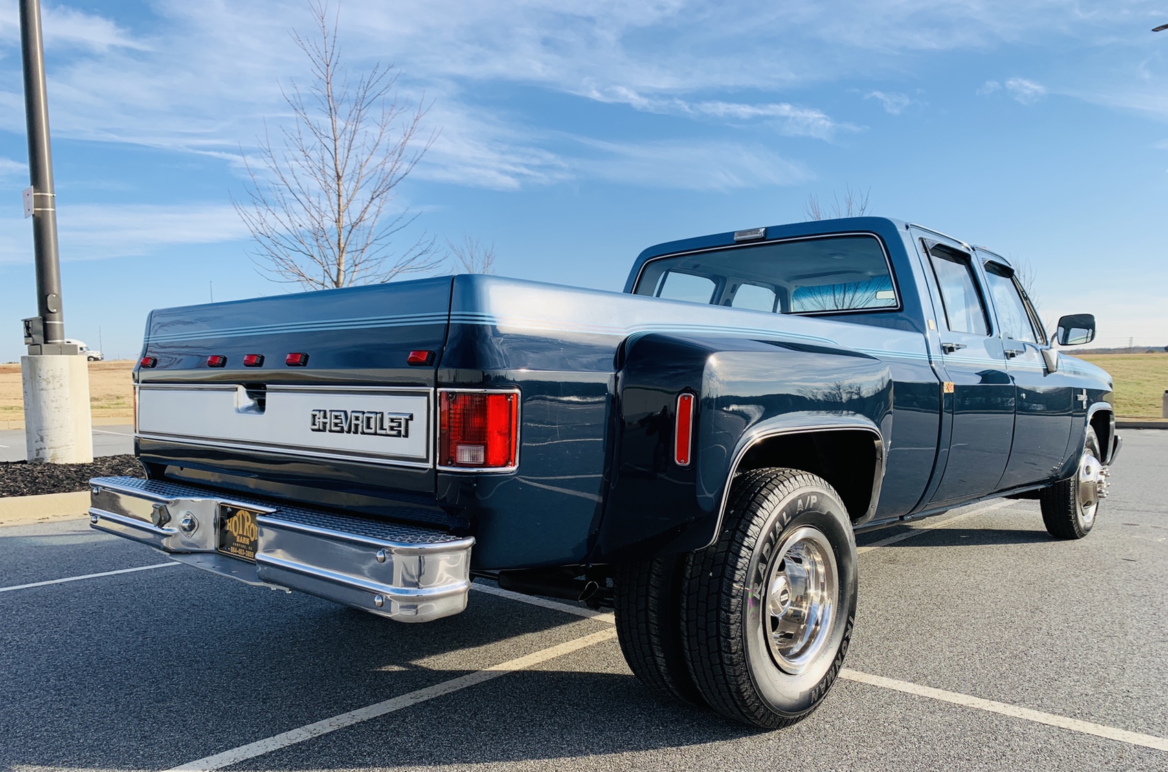

      I did pick up a new tow rig / dog transport vehicle, though...
      Got a couple small projects for this thing, too.

      Absolutely love the two rig!! 4wd??

      Wow, those pictures are hard to look at. I'll be honest, that was way worse than I was envisioning in my head. Glad that you are keeping a positive attitude about it and will keep moving forward.
      It’s 2wd. A 1986 C30 with 454 and th400 trans.
      Got decent plans for this thing. I sold my 2018 Sierra because it just sat and was never driven. For half the cost of the Sierra, I got the C30. It’s been completely repainted and has a new interior. It’s original 70,000 miles and is in phenomenal shape. Got a few mods planned though...
      Have bought:
      Gear Vendors overdrive
      Headers
      Intake (which will result in the removal of all the smog stuff)
      Belltech 3” front / 4” rear drop
      Alcoa replica wheels
      New stereo system
      New hitch receiver
      New fuel tanks
      So yeah. Should be busy with this for a minute.

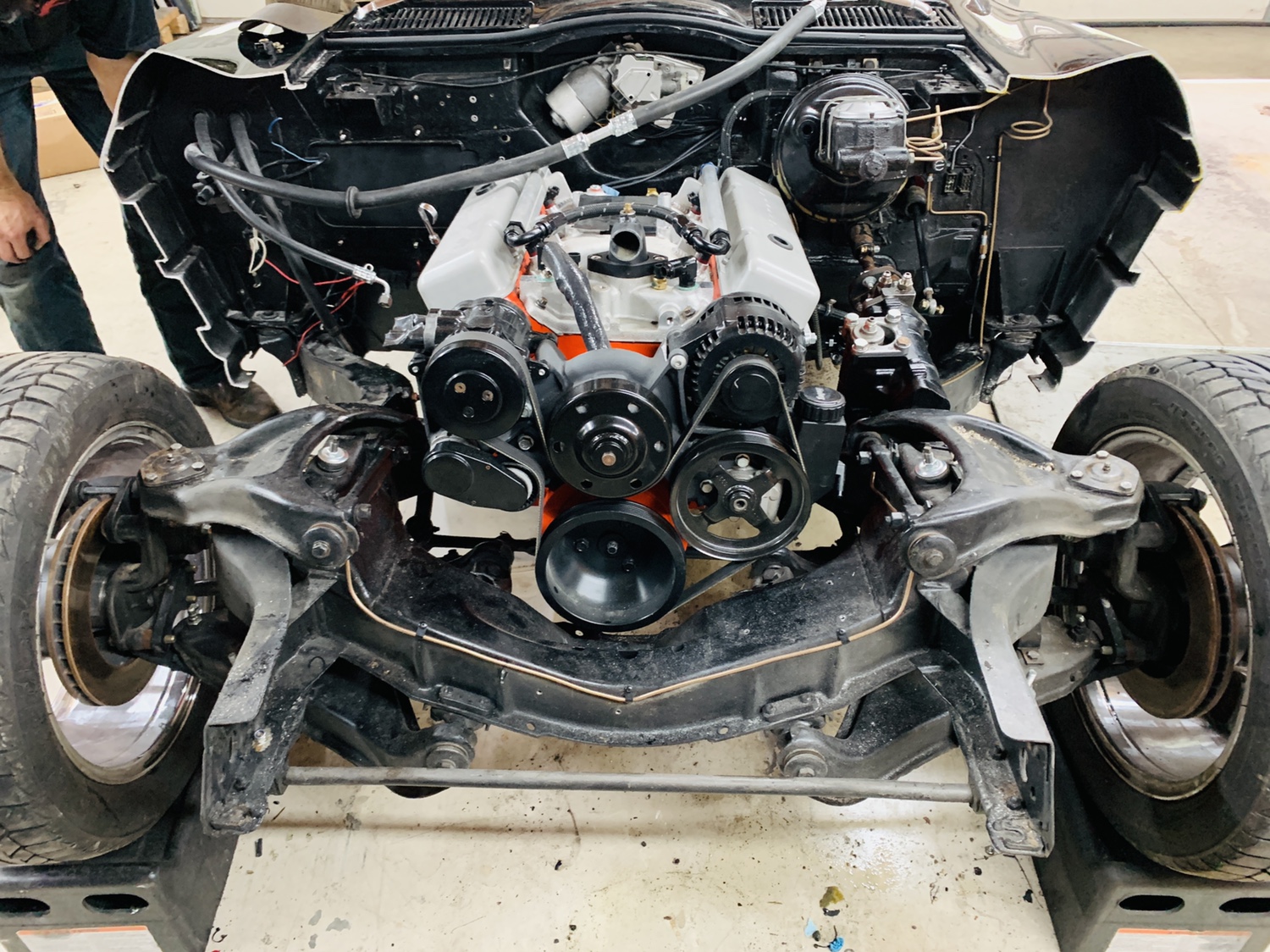

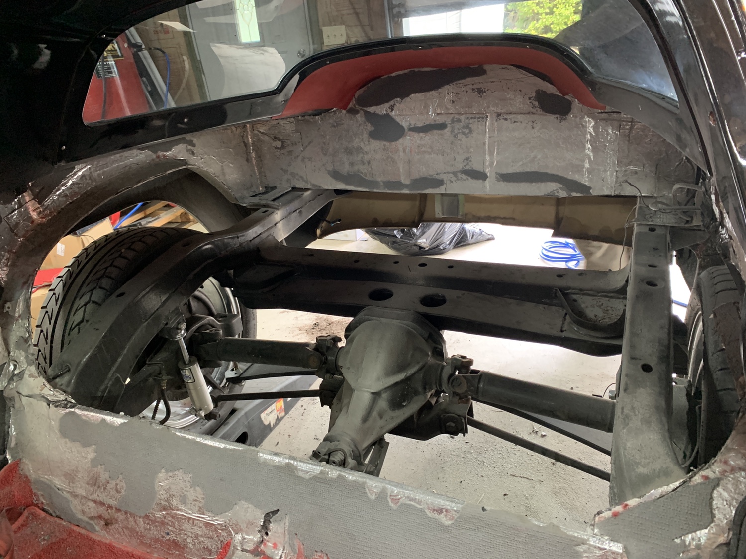

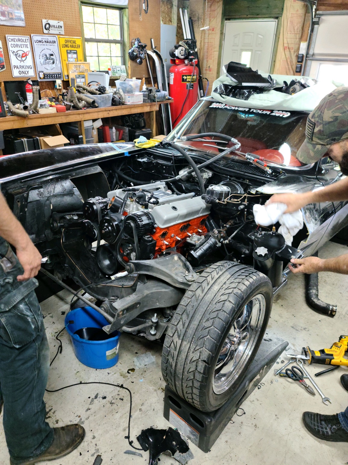

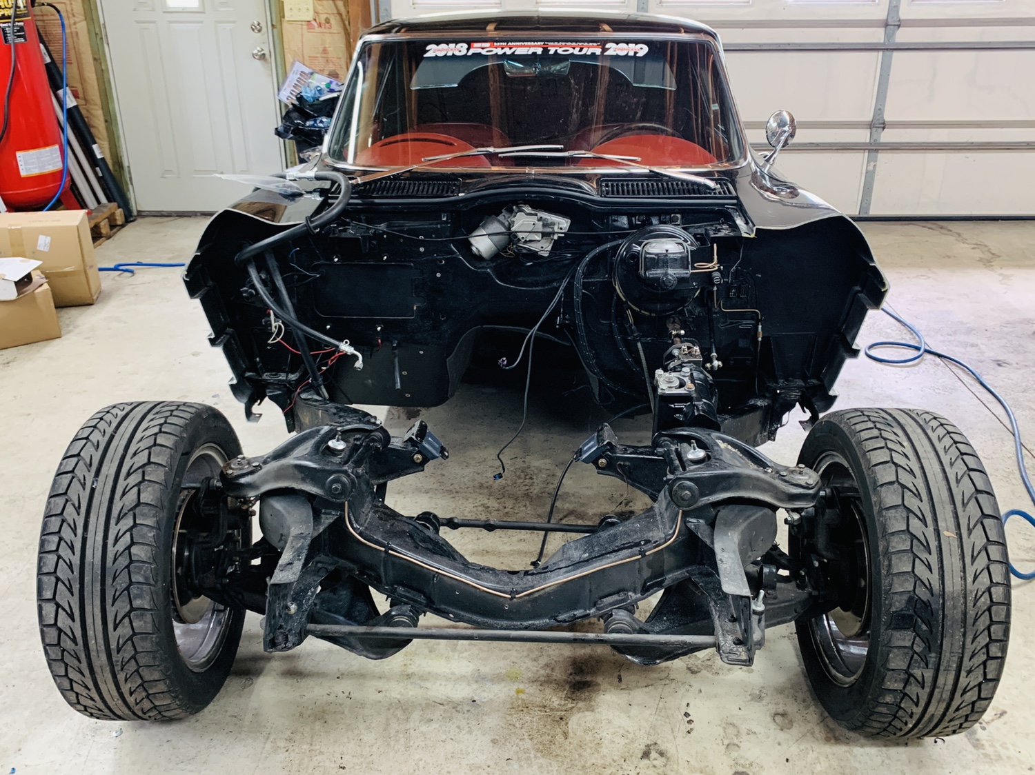

      We are back at it again. FINALLY.
      There has been no progress on the car up until this weekend, other than I am in line to have the body work and paint done at Jamison Custom Corvettes in Charleston as soon as the SRIII chassis I have a deposit on is built and delivered. The waiting game has been slow, and it still looks like another 1-2 months before my chassis is even built. But my brother decided it was time for him to head my way so we could start breaking the car down and getting the body ready to come off when the new chassis arrives.
      We began by removing the hood and some of the major engine and turbo components, but soon we were ready to be rid of the wreckage once and for all…
      Once everything in the fender wells was removed and clear, we broke out the sawzall.
      Now we had a lot of room to work with, and we had the engine and trans ready to come out in no time.
      We removed the gas tank and all the fuel lines, and pulled the heat exchanger and water lines for the inter cooler water tank as well. Pretty soon, we had it all wrapped. So we began breaking open the box that contained the new rear floor that will be installed to accommodate the new chassis and 345 tires.
      At first, we just kind of held up the new wheel tubs and some of the floor panels and giggled and laughed about how awesome it was going to be. Then, carpet started coming out. Then someone grabbed a sharpie and started tracing. Then the sawzall and cutoff wheel reappeared…

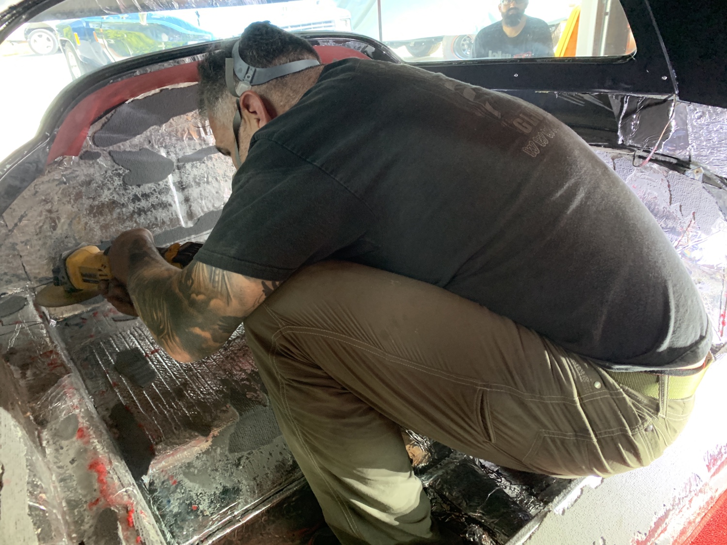

      We made such a huge amount of progress this weekend. It feels good not to be staring at the wrecked car any more and to be progressing towards what I intend to be the baddest midyear Corvette on the planet.
      The new floors will be going in as soon as a buddy and I do some final trimming and cleco everything into place. Then the body comes off.

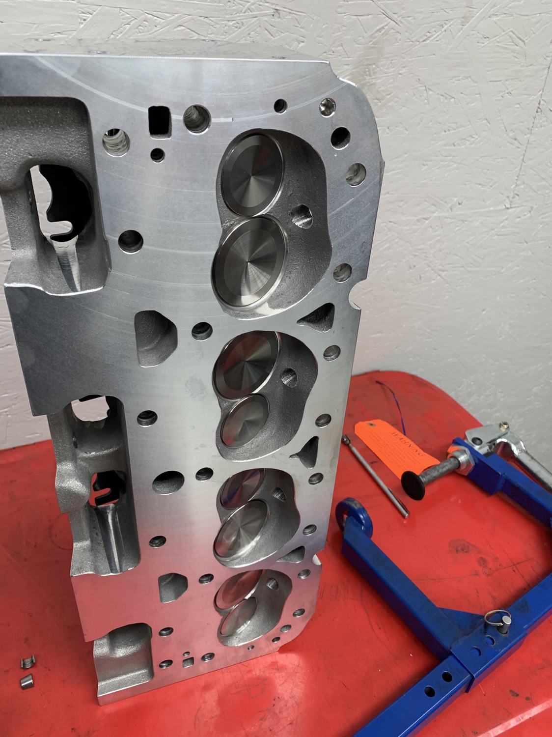

      One other update…decided to change cylinder heads and go with aluminum. Got a set of Brodix IK200s. Should help carry power a little higher in the rpm band and improve everywhere.
