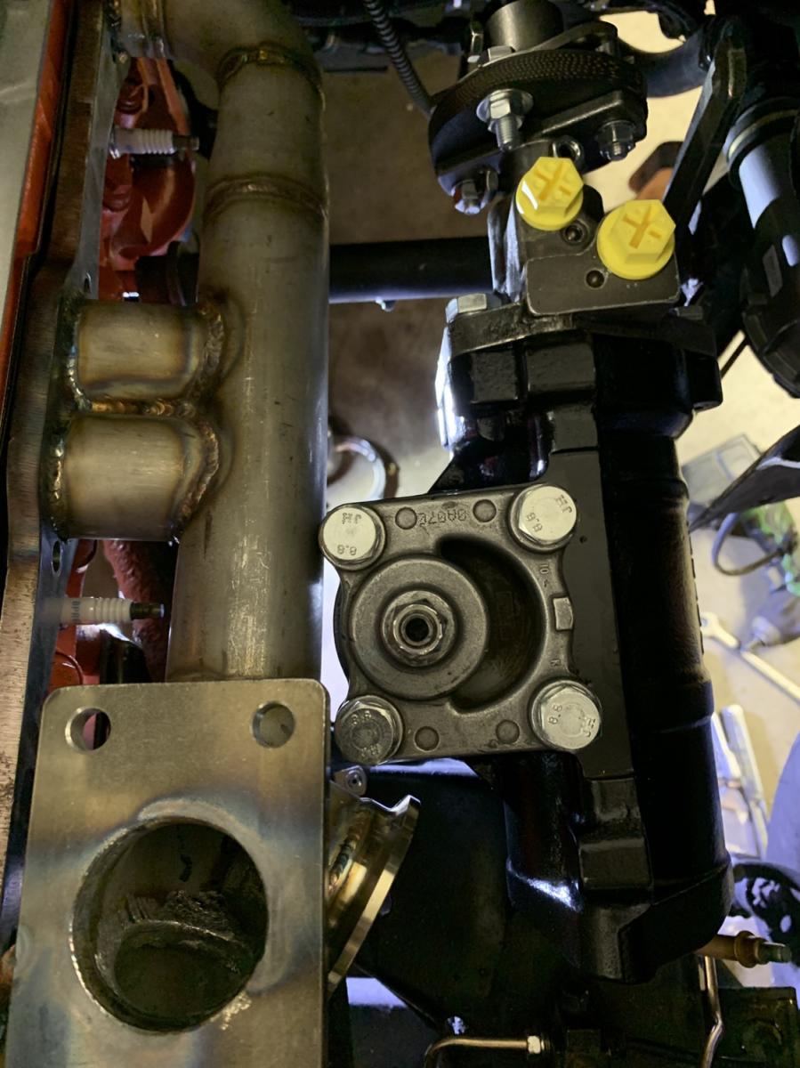

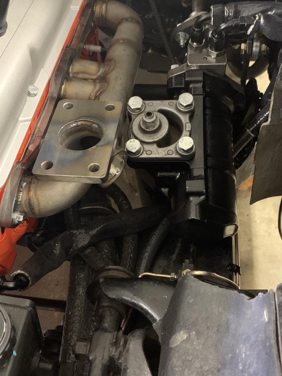

      The car has always had manual steering and I really had no intention of changing that, but the Holley Mid Mount accessory drive came with a PS pump so I figured it was finally time to convert. I got a Borgeson conversion kit and we installed it first thing to check for interference with the turbo plumbing. It’s tight. Had to make a minor tweak to the wastegate location but it fits and it’s installed.

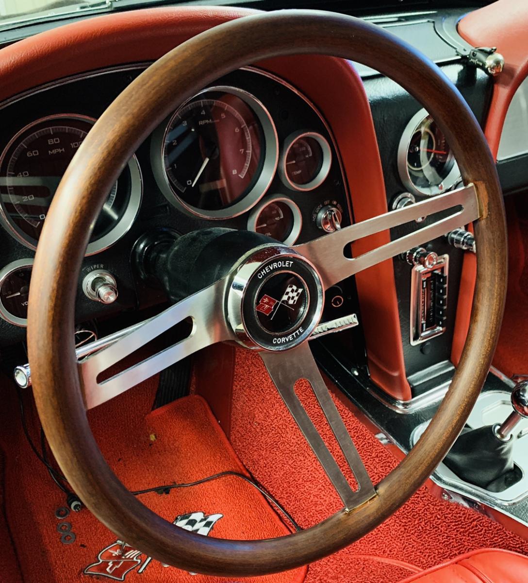

      To compliment the new power steering, I picked up a 15” Grant steering wheel. The mahogany finish looked great with the interior, but I didn’t care for the super glossy finish. A scotch brite pad took care of that and it came out great.

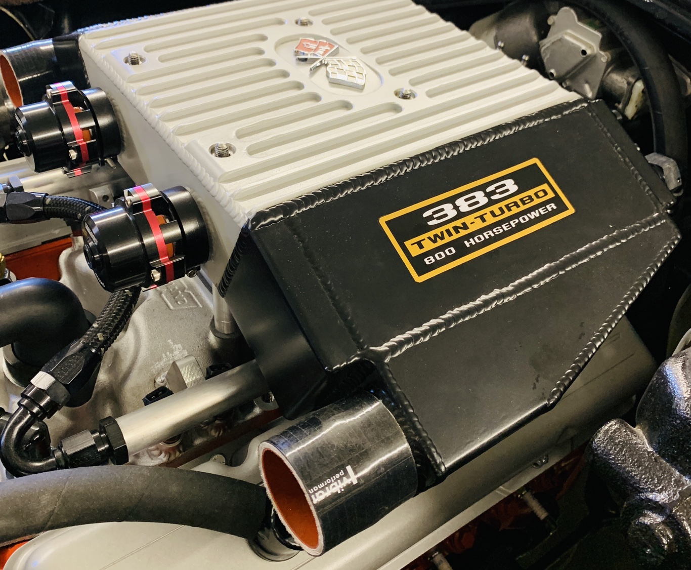

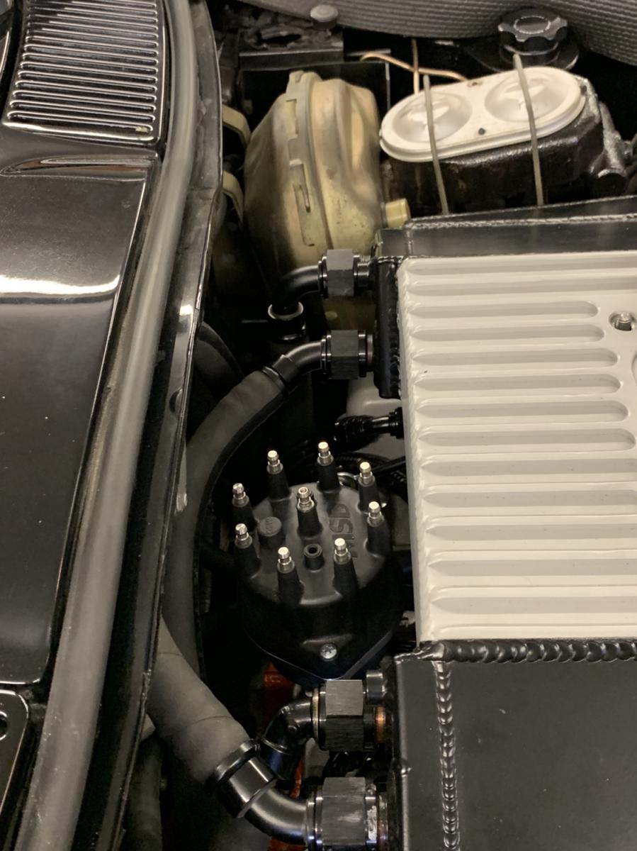

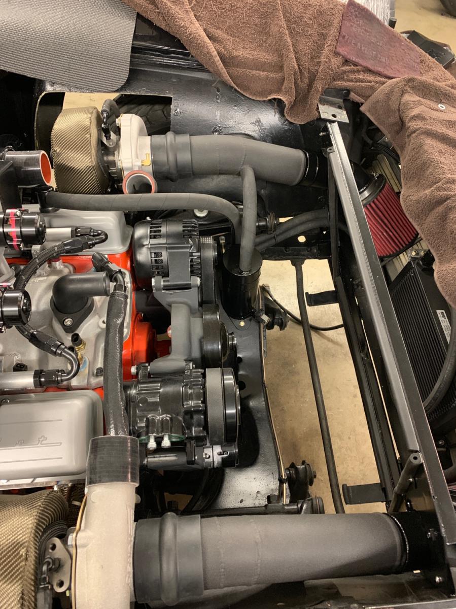

      Intercooler inlet and outlet hoses plumbed and secured for what we hope is the last time.

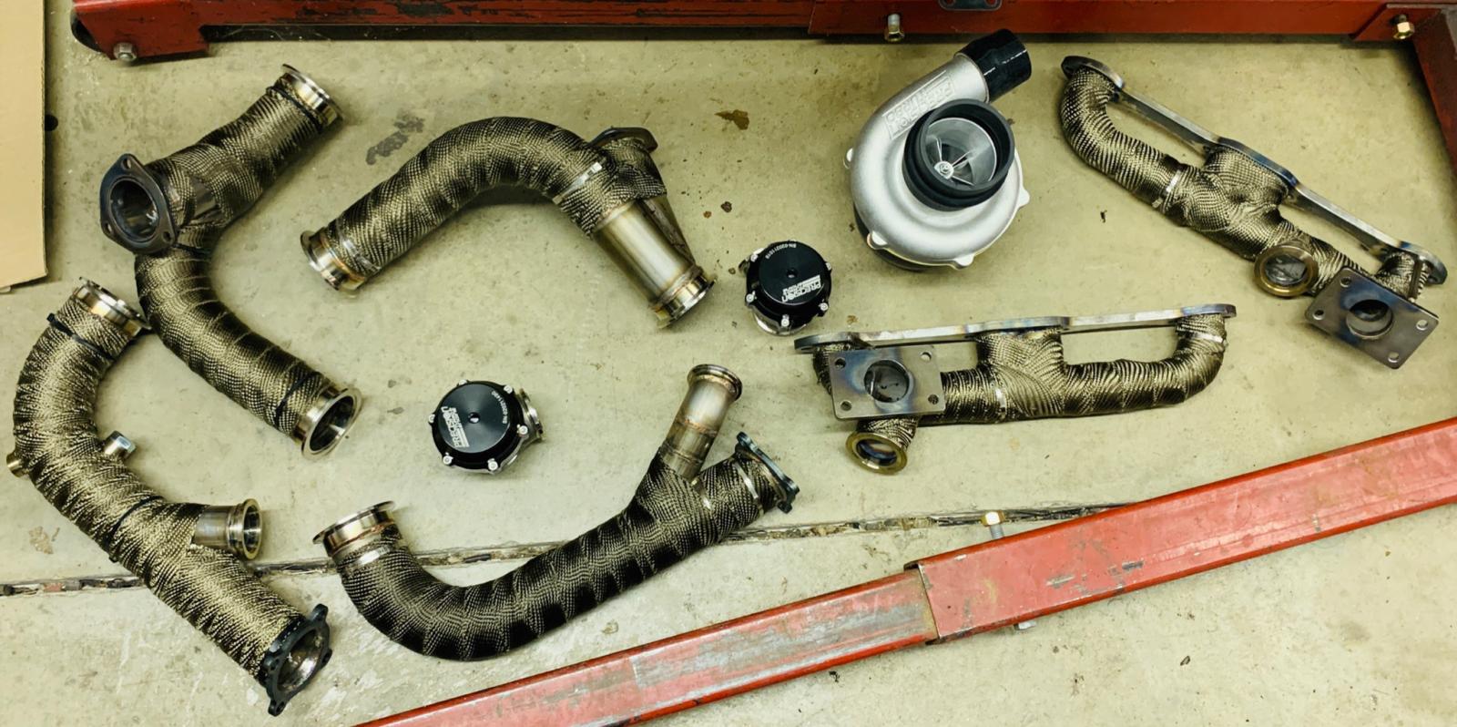

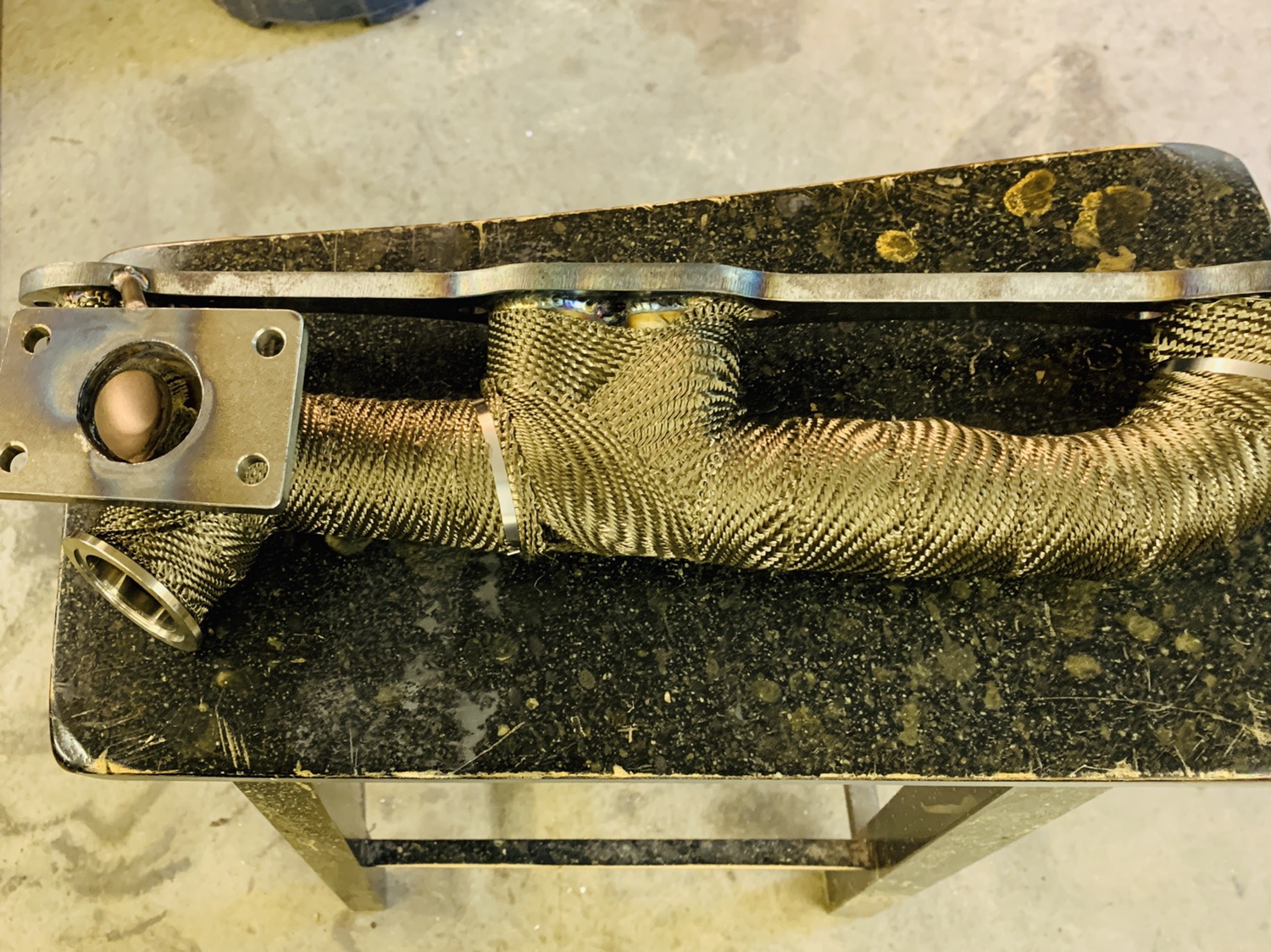

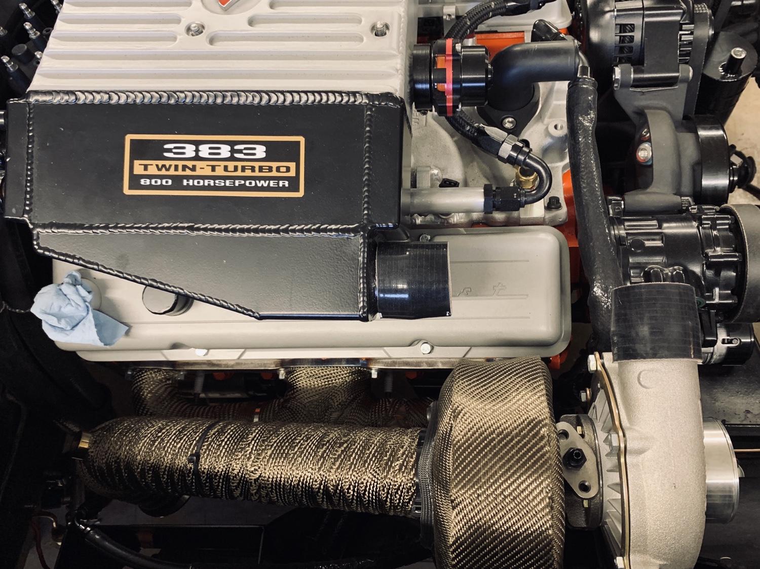

      We spent a ton of time running oil feed and return lines for the turbos, as well as wrapping the hot side components and installing blankets on the turbos themselves. The wrap came out pretty good...hard to get it perfect, but it should get the job done. We also wrapped probably 3/4 of the side pipes themselves. (Please ignore the black zip ties you see on some of the plumbing...we ran out of metal zip ties. That will be rectified shortly.)

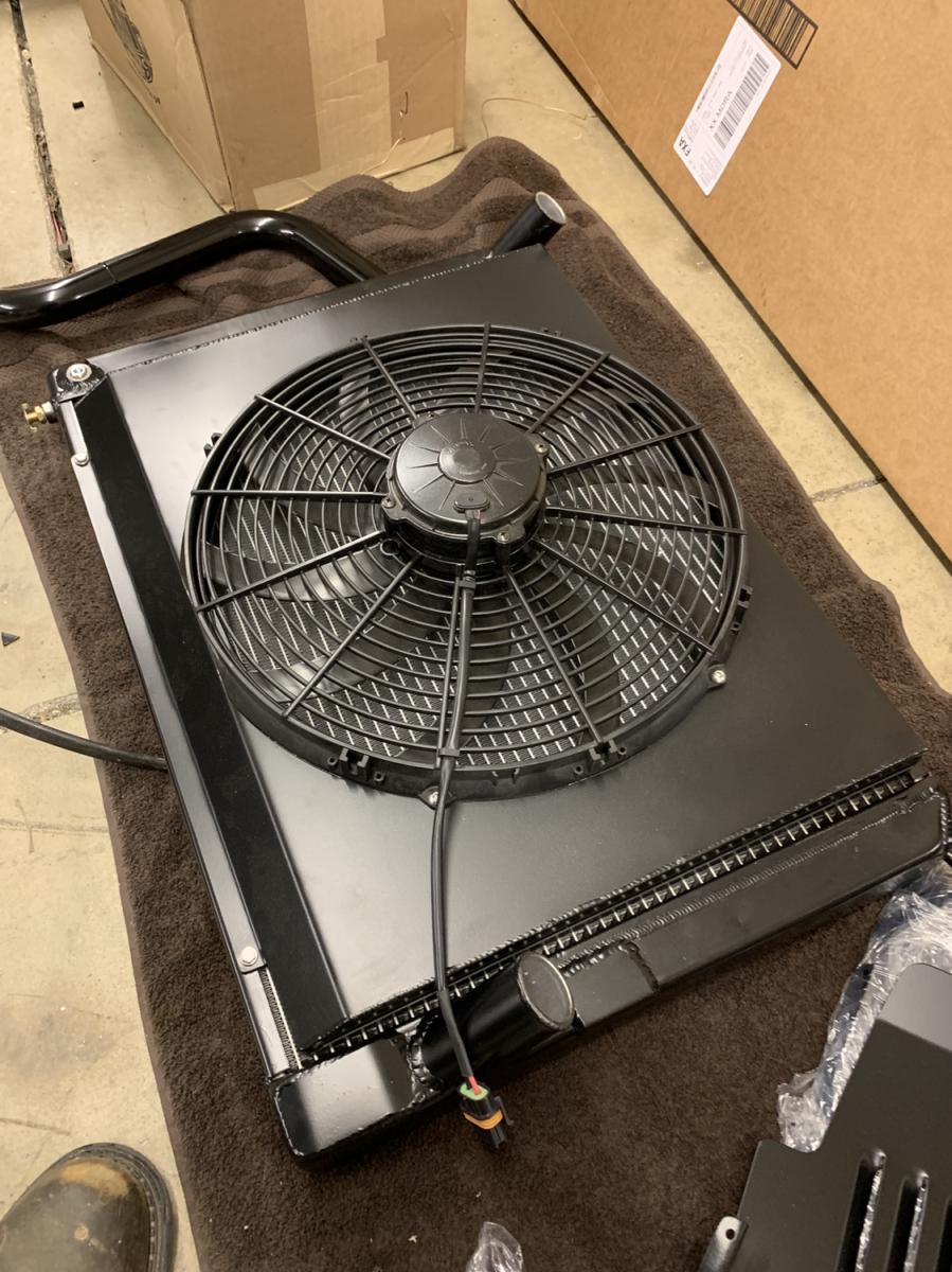

      The rest of the parts came back from powdercoat. Ready for final assembly and wiring.

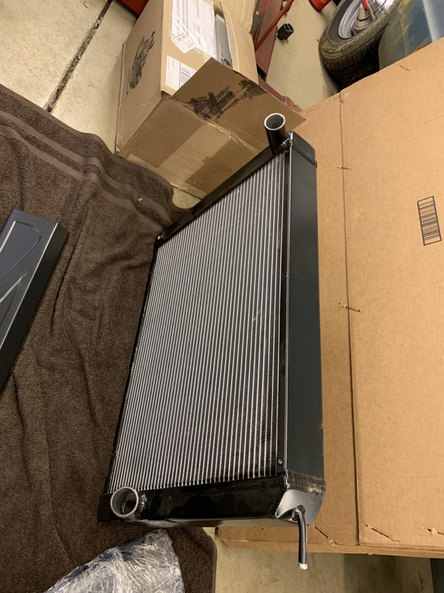

      Radiator and radiator hold down:

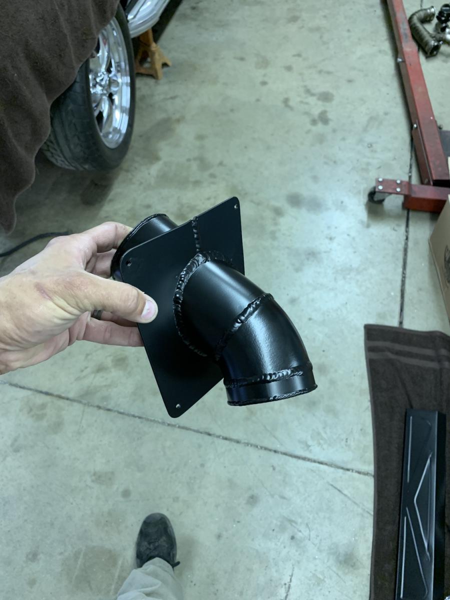

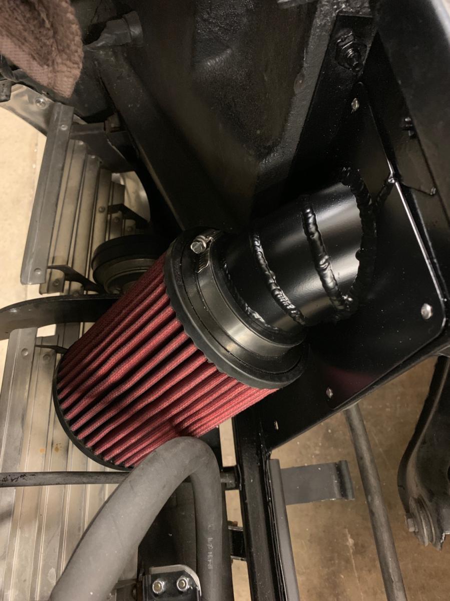

      Air filter mounts for radiator support

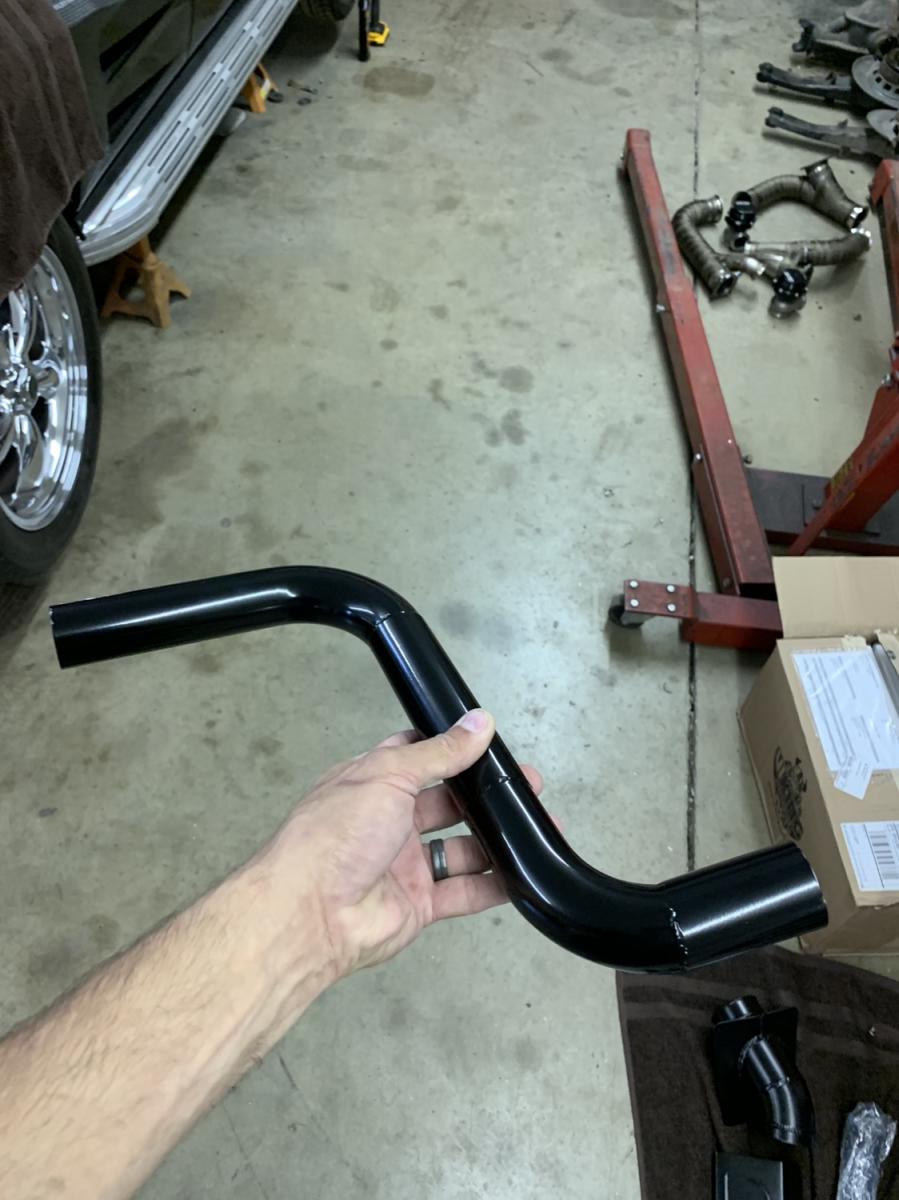

      New radiator plumbing

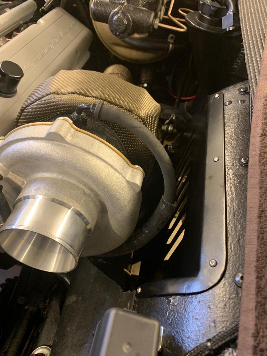

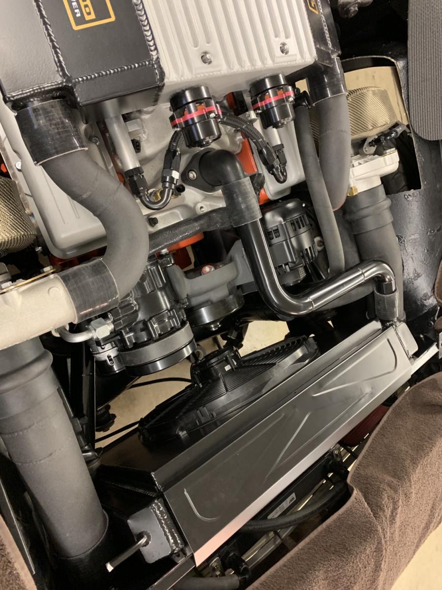

      Radiator, shroud, fan, hold down, and rad plumbing are in. All that’s left is to install the hot side, AC lines, and finish wiring. Getting really close.

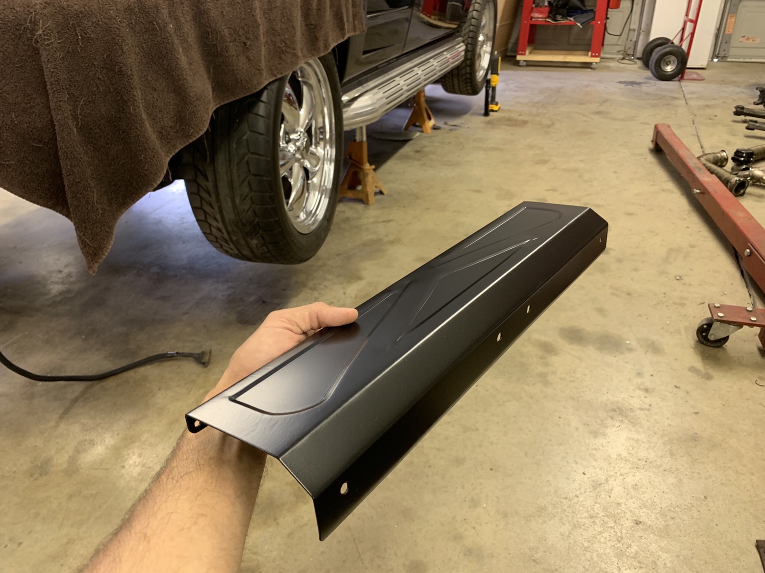

      These are the fenderwell inserts that my brother made to make room for the turbos, finally installed. Came out fantastic and very functional with the louvers.

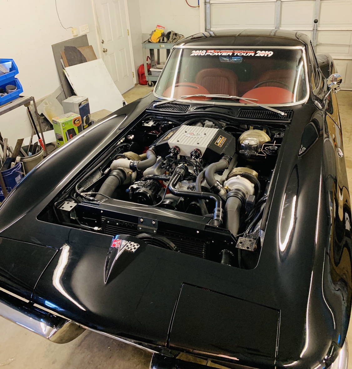

      Well, the hood is on. I feel like that is a good sign.
      Like pretty much everyone else, 2020 has put us through the ringer. There have been delays on this build but we’re moving forward and are finally approaching the finish line (fingers crossed).
      The car is idling with no leaks. This is big progress. We also struggled with the cooling system holding air pockets and have remedied that situation as well. Only some minor tweaking to the final overflow setup and it’s finished.

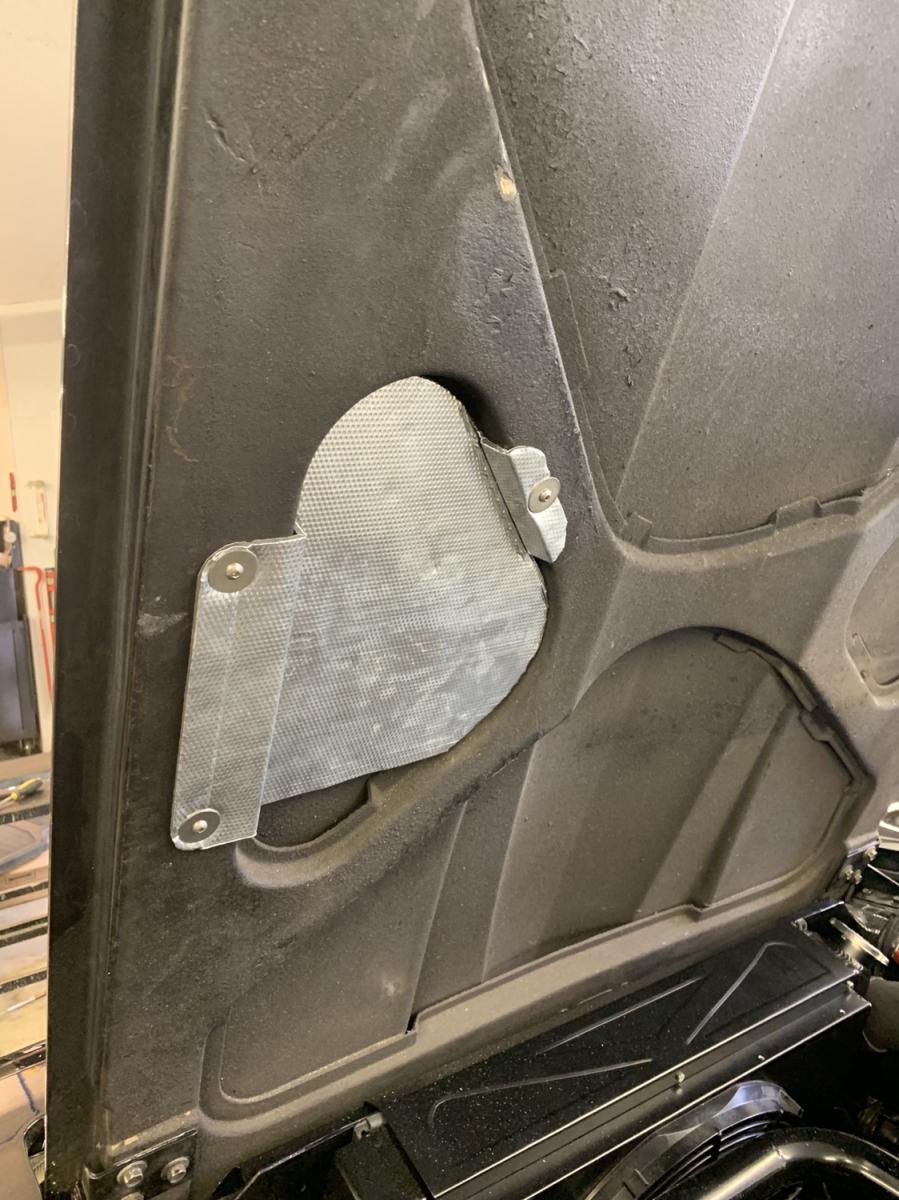

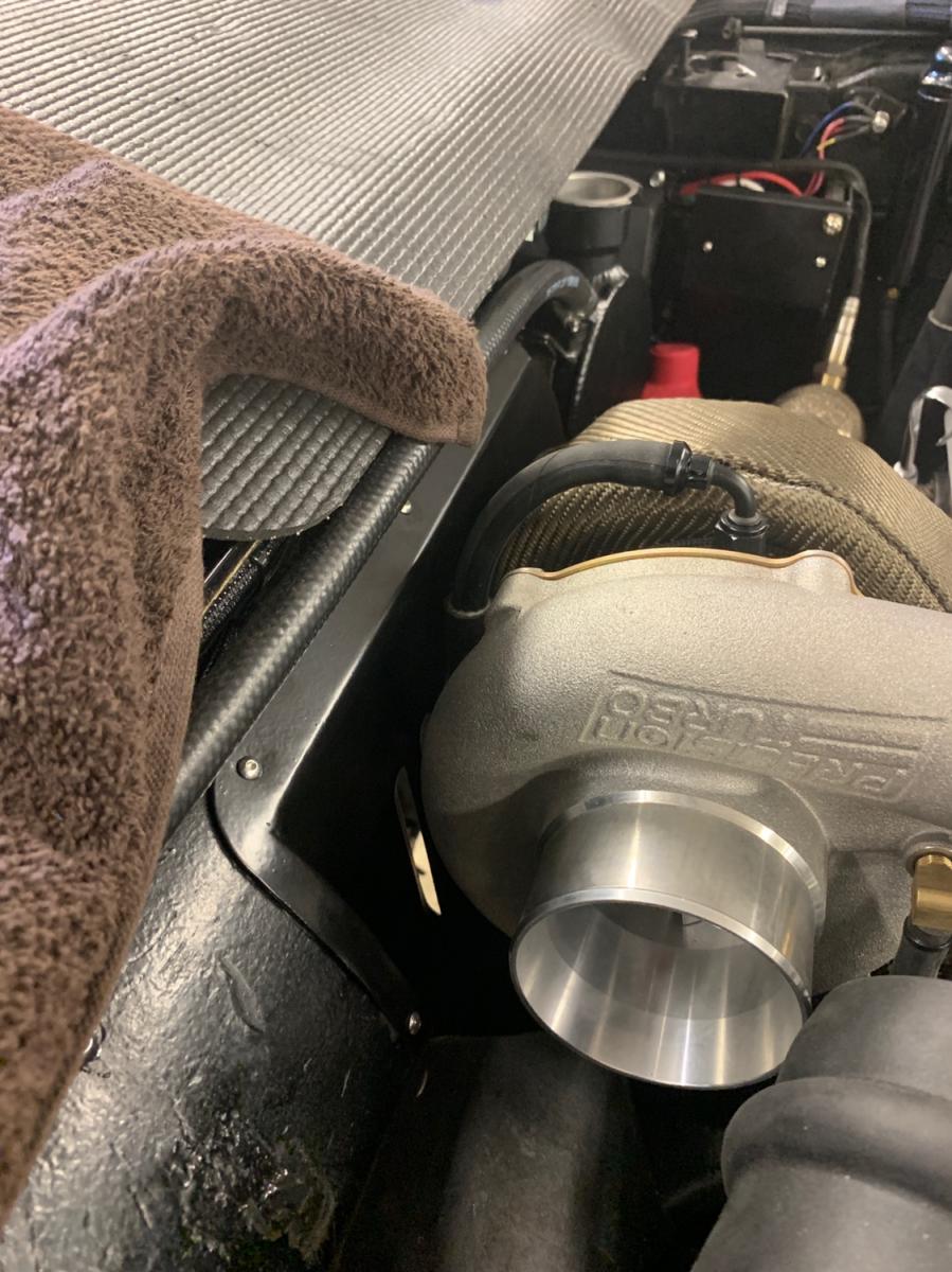

      These panels are fabricated to protect the hood just above the turbos. The location for these couldn’t have worked out better.
