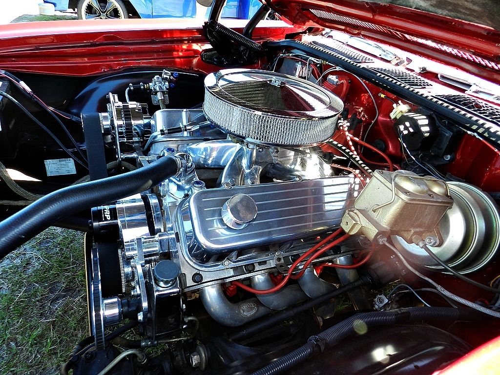

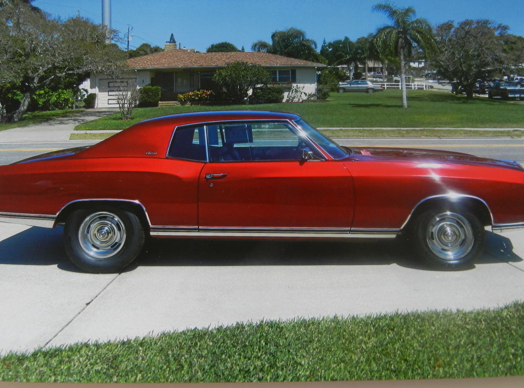

      Good job... I love these first generation Monte's. I'm currently building my third car. I chose the same wheels that you are using. (They were mounted this weekend and will be bolted on in the AM) It, like my first one, is a '72. I purchased another man's project... he spent quite a bit powder coating the frame and building up the drive-train and suspension for the strip, and then died before it was complete. My second Monte was a numbers matching '70 SS454 that was stolen in 2006 and just recovered stripped this past Thursday.
      I'm changing direction with this car as I want a cruiser and to run stop-light to stop-light. I therefore just pulled out the built powerglide w/ transbrake/ quarter-stick / 3600 stall converter, and shoe-horned in a 4L80E. There was fresh scarring on the trans-tunnel, evidence of blowing a tail shaft off of a previous transmission, due to the torque of the solid-lifter 468 under the hood, so I beefed the 4L80 and had a strong chromemoly drive shaft assembled with billet yokes.
      The 12-bolt had a new Eaton posi and 4.11 gears installed just before I received it, so I stayed with the tallest tires that I could put on the 17's, to help the over-drive tame the highway manners a bit.
      Name:  Candy Monte.JPG
      The Hooker Comp headers and 3" Flowmaster system had the classic "Oil Drum" tinny sound to it, so I pulled it and installed the polished stainless 3" Dynaflow system behind Headman headers on Friday. ...It brought about a world of difference! Becoming a deep, low rumble instead of an oil can clanging.
