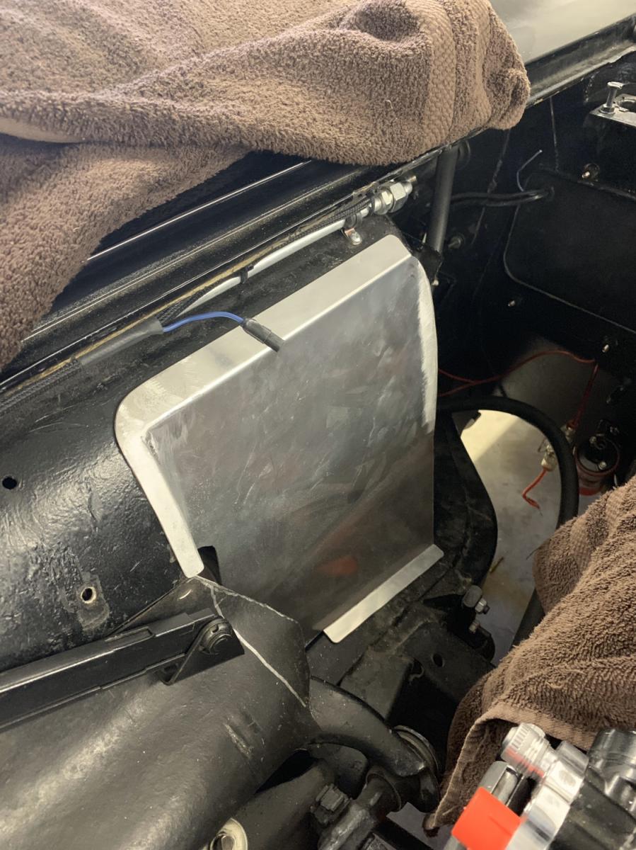

      Small update...
      You may have noticed that in order to keep the turbos from sticking out of the hood, we had to cut reliefs in both inner fenderwells. My brother fabricated these patch panels by hand to fit, and then created a jig that would allow him to cut louvers into the panel. This will give us needed clearance room and allow heat to escape right night to each turbo.

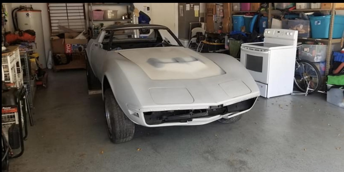

      I also found a new project car I couldn’t resist. It’s a 1971 coupe, original big block car that was optioned fairly well with PS, PB, PW, and AC. Numbers match, although it’s an auto trans. I plan to bag the auto and put it away in favor of a manual, and also add a Holley Sniper I previously had on the ‘64. I also plan to paint the car myself.
      Maybe it’ll get its own thread soon. Body is coming off almost immediately to get started on it.

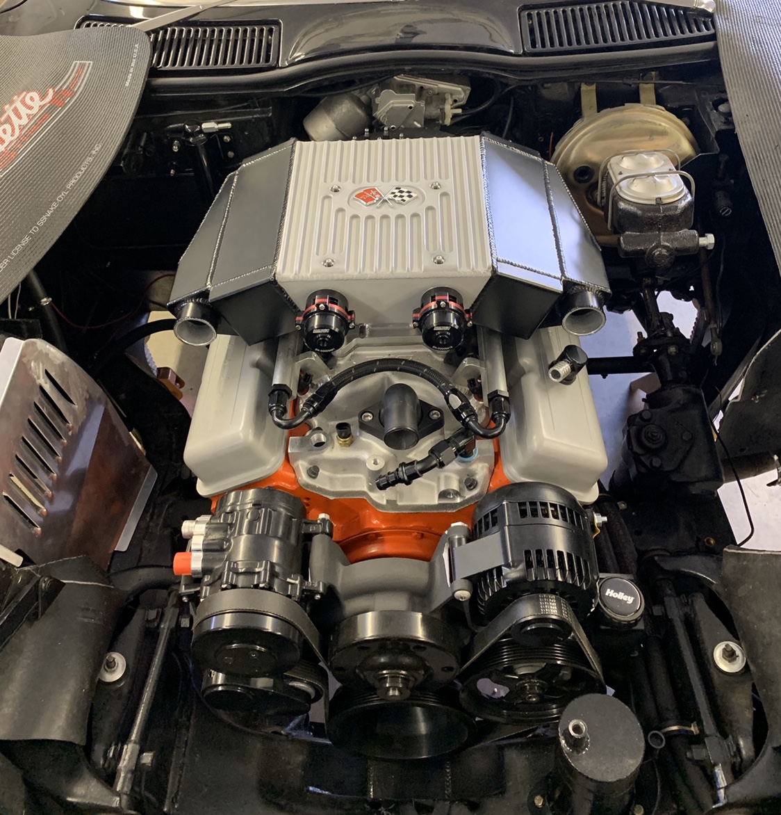

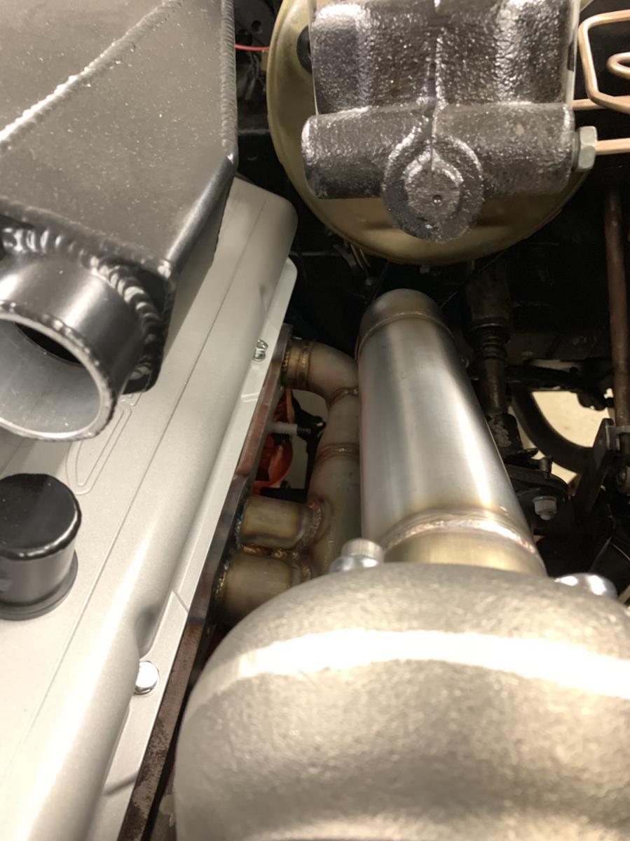

      Got this pic tonight of the hat and valve covers on. Just the look we were going for. Name:  Adjustments.JPG
    13. #33
      Oct 2012
      Kennewick, WA
      258
      Clean and sanitary, looks great.
    14. #34
      Apr 2020
      101
      Quote Originally Posted by RMMiller View Post
      Thank you, sir. That brake booster is killing me. LOL. Getting painted ASAP.
    15. #35
      Oct 2012
      Kennewick, WA
      258
      I didn't even notice it but I can see why it's bugging you!
    16. #36
      Apr 2020
      101
      I do not want anything in the engine bay to draw your eye away from the engine and turbos. So, I’ll paint that booster black and we’re probably also going to make a small block off plate for the wiper motor as well.

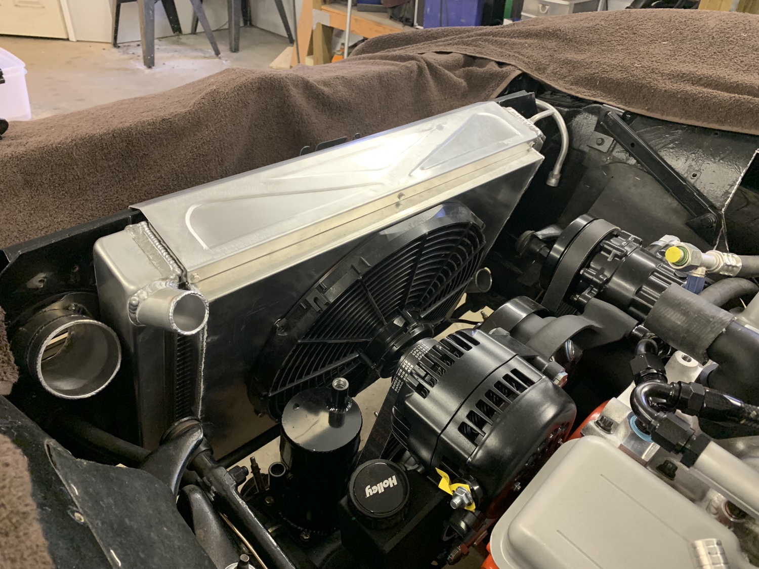

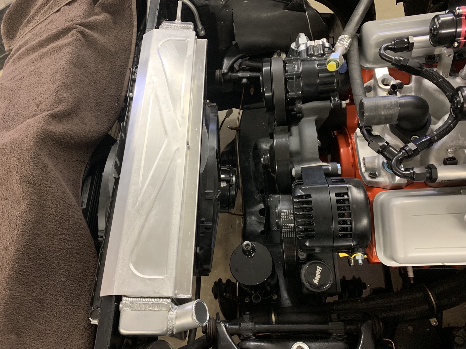

      A little more progress.
      I had cooling issues at slow speeds on the Power Tour last year. The car wanted to get fairly hot as we idled our way into a lot of the venues, which, at times, took a while. I figured it was an airflow issue because when the car was at speed, it ran almost too cool.
      We found that the radiator that was in the car was a stock-style replacement, but that it had less than the factory spec capacity. We decided to go with a custom unit that maximized every bit of room that we had in the front of the car. There shouldn’t be any cooling issues now..
      The fenderwell inserts, fan shroud, and radiator cover are off to powdercoat. Next up is the down pipes.

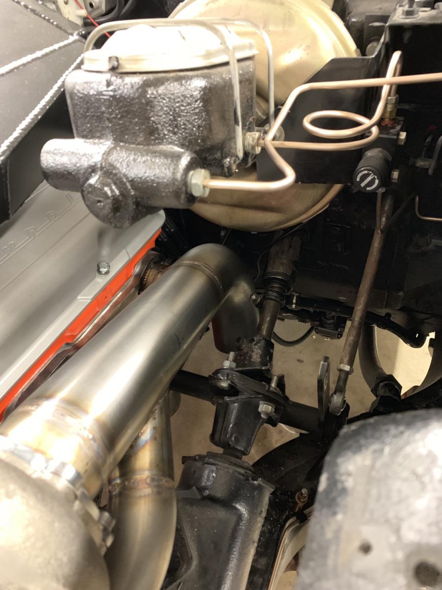

      Down pipes started
