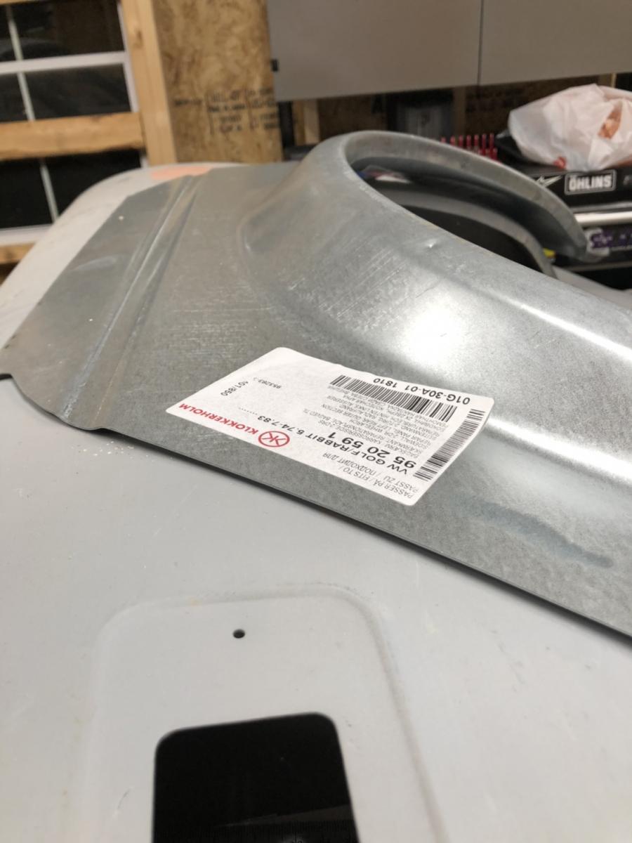

      So a patch panel from an ‘81 rabbit just might make a good flare. Name:  IMG_1388.jpg

      16,129
      That patch is perfect!

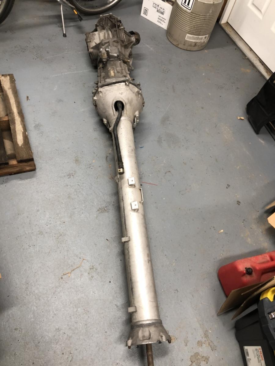

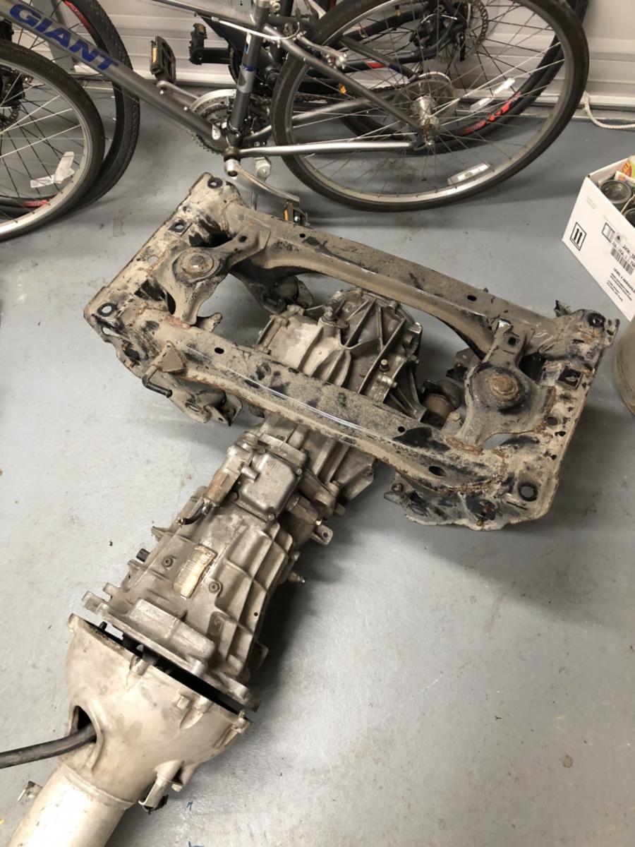

      So another piece of the crazy puzzle came home today. While it solves some issues, it creates a few more.
      I have been working hard to figure out what to do for a transmission. A lot of options were just too big. I could widen the trans tunnel but that would leave very little foot room. So then the brainwave hit. Transaxle. Looked around at a bunch of options but the obvious answer became c5 corvette. Managed to pick one up reasonably cheap and now I have to figure out him to mount it and it may be a complete custom rear subframe. And some more cutting of the floor. But that’s ok. Should be fun. A lot of cutting and measuring to do but I’m sure it will work. And also have to cut down the torque tube. Seems like there’s several shops that do it, any recommendations?

      Are you familiar with this YouTube build? He's dealing with slightly different components (no transaxle), but it might be useful as you plan your suspension. The entire build is worth watching, and he's doing some incredible work.
      https://youtu.be/O0dUbfkHQvk
