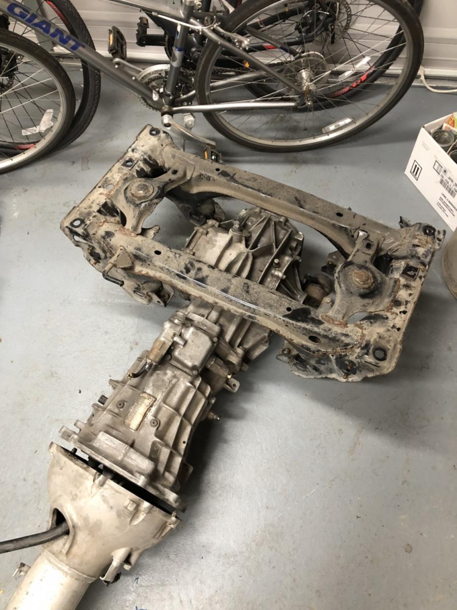

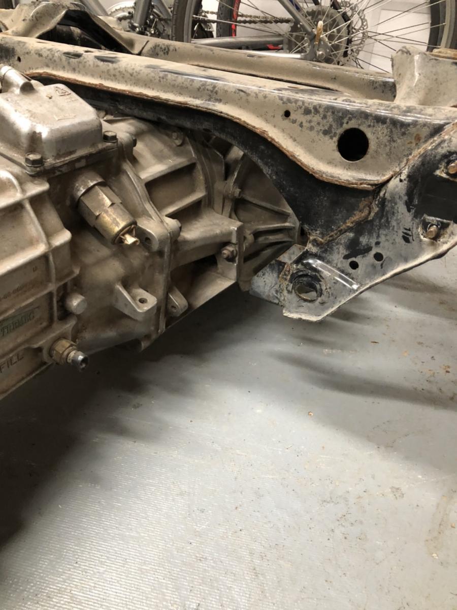

      Quote Originally Posted by j_man1100 View Post
      So another piece of the crazy puzzle came home today. While it solves some issues, it creates a few more.
      I have been working hard to figure out what to do for a transmission. A lot of options were just too big. I could widen the trans tunnel but that would leave very little foot room. So then the brainwave hit. Transaxle. Looked around at a bunch of options but the obvious answer became c5 corvette. Managed to pick one up reasonably cheap and now I have to figure out him to mount it and it may be a complete custom rear subframe. And some more cutting of the floor. But that’s ok. Should be fun. A lot of cutting and measuring to do but I’m sure it will work. And also have to cut down the torque tube. Seems like there’s several shops that do it, any recommendations?
      Attachment 181567Attachment 181568Attachment 181569

      No worries, "just a thought" is how some of history's greatest inventions came about. I'd think any driveshaft shop could shorten it for you, but if you want a driveshaft in its place I think you're going to have to move the trans to the engine.
      I don't think it's going to be that big a deal on the clutch anyway. That transmission looks like it's bolted to the rear diff the same way the trans would bolt to a transfer case, and it looks like the rear suspension is attached to the cradle as well. When it comes to it, it looks like you could just unbolt the rear cradle, then jack the car up enough to roll the whole thing back a bit to get the trans off the torque tube. It might even make it easier to replace the clutch since you'd be able to get full access to it. This is based off looking at the pics you have.
