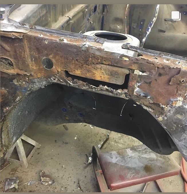

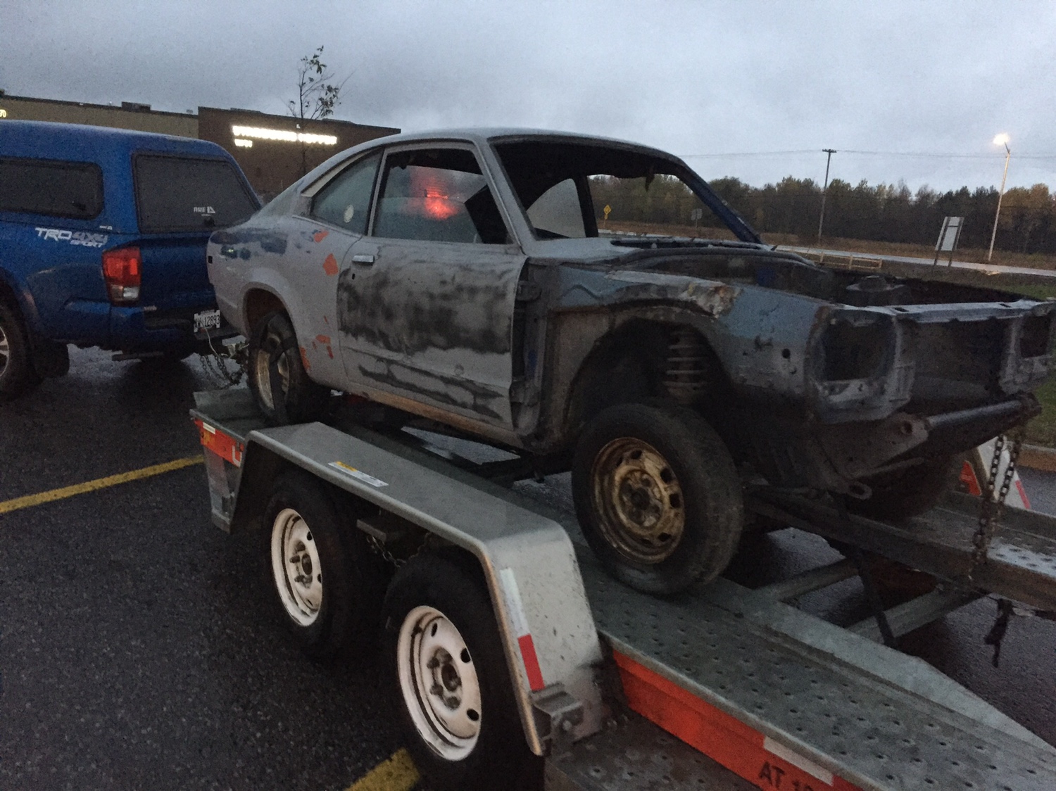

      Here’s what I brought to Sean at Better Motorsports just out side of Ottawa in Canada. Sorry I don’t have better pics, but that was my jumping off point
Size:  534.9 KBName:  IMG_1663.JPG

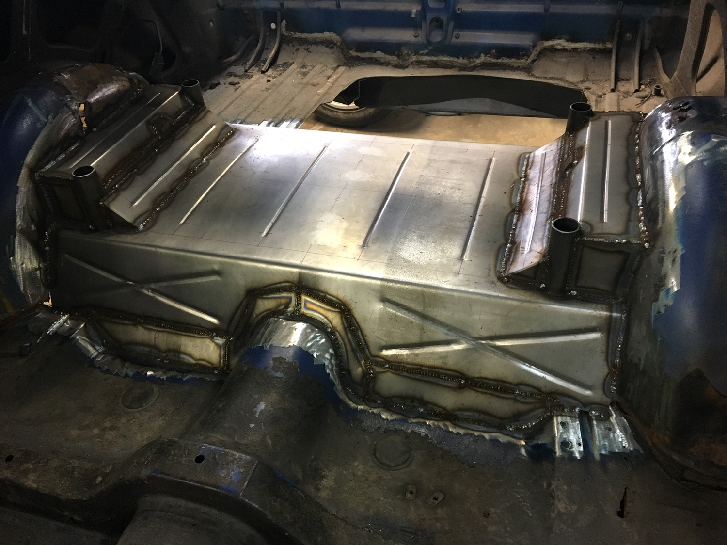

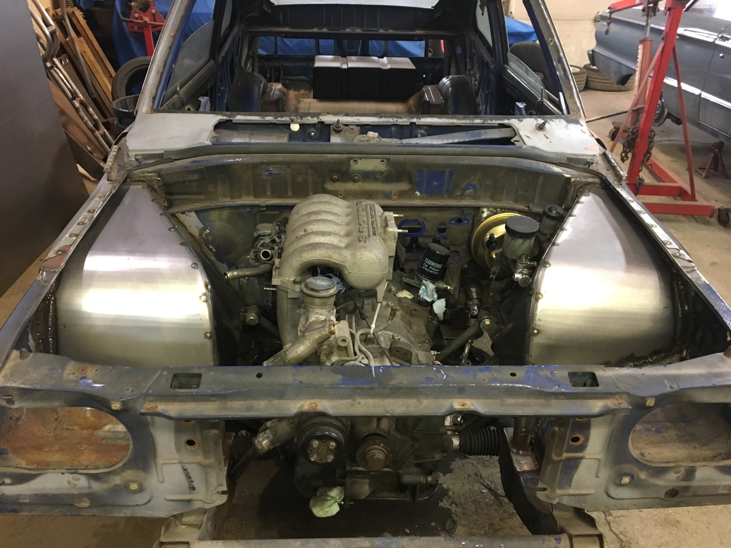

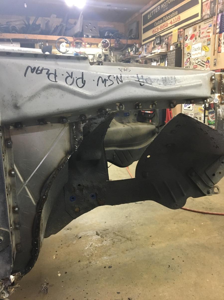

      So nearing the end of the time Sean had it, he closed in the wheel wells, retrofit the miata brake master and booster, and made the steering shaft. The stock one obviously wasn’t going to work but he managed to make it so I could use the stock shaft inside to car to keep the original appearance. He also had to move a section of the firewall back to accommodate the extra length of the 20b vs the stock 12a. Name:  IMG_2735.JPG
Size:  535.8 KBName:  IMG_0022.jpg

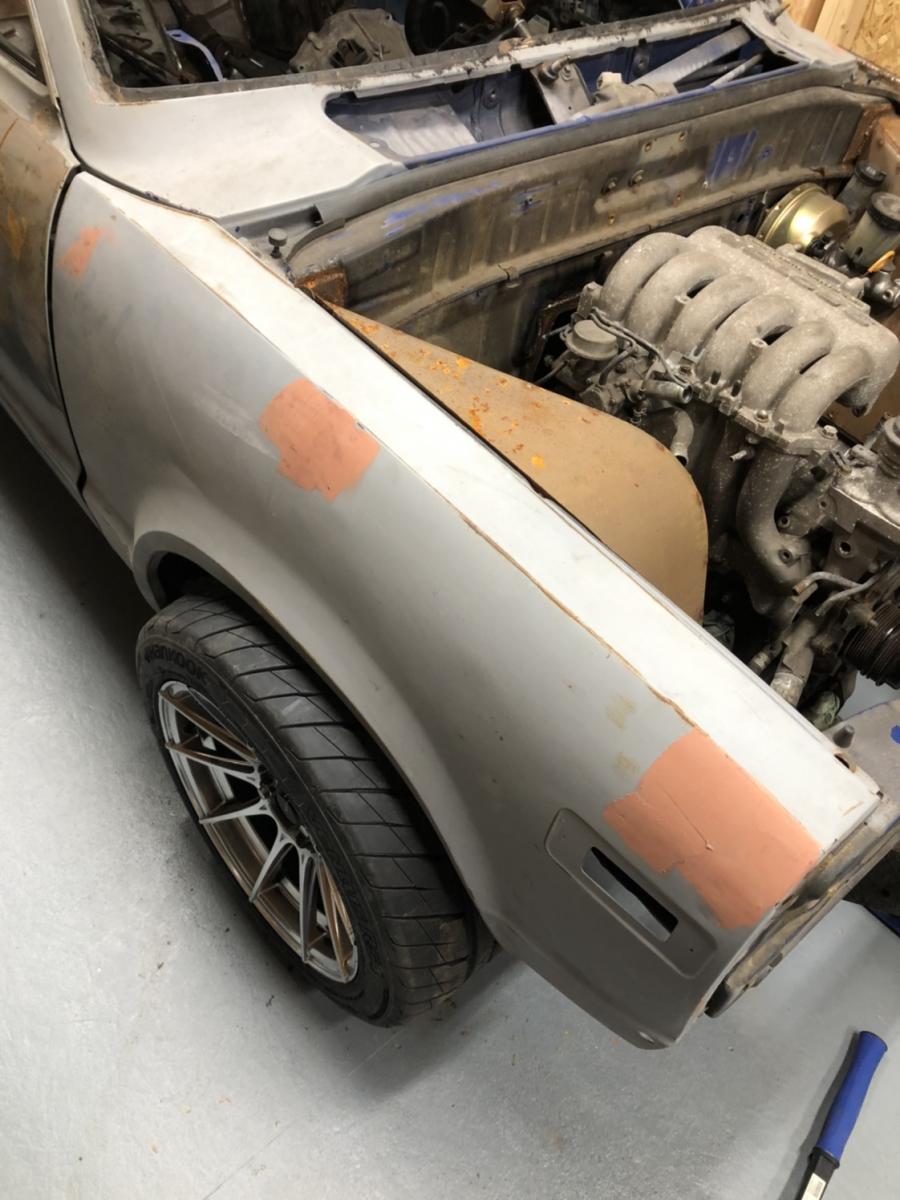

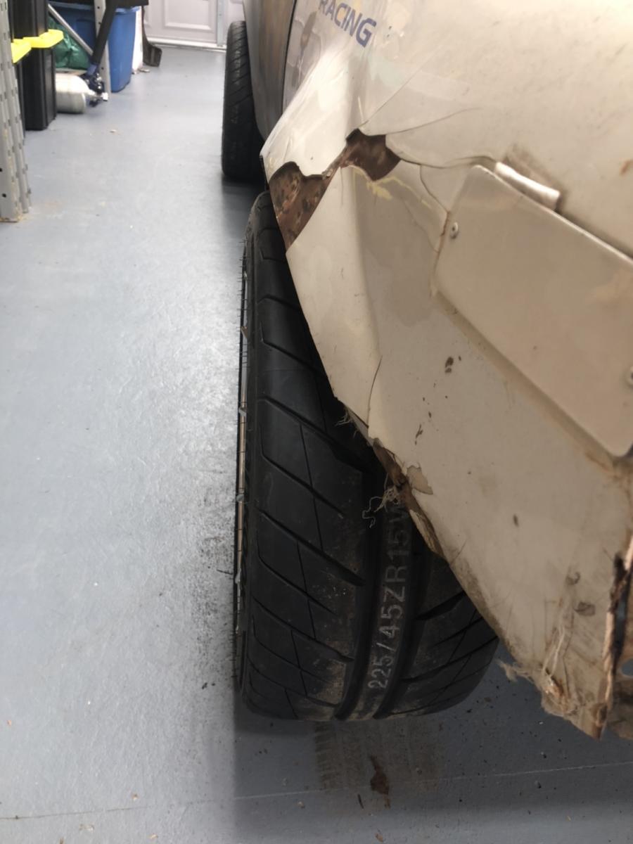

      So just a quick update. Have the new wheels on the car. Have a set of fenders from a car that had raced in a few Canadian series. They look good in the front. Need to flare the back but I knew that already.
      Rebuild kit for the motor has been bought and working on options for the trans. I have been considering trying to adapt a c5 rear end. There’s much more room for a transaxle and would help the weight distribution I think. It’s a crazy idea, I know, but wouldn’t it be cool?
      Currently waiting for the covid lock down to end so I can get the car out to acid dip. There’s a lot of bondo in spots so I’m thinking instead of trying to sand everything I’ll just go with a dip and know exactly what I have.
      Finally, here’s a few recent pics, because who doesn’t like pictures. Some with stock fenders and a couple with the flared fenders.
