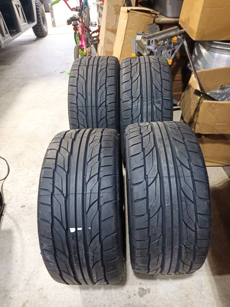

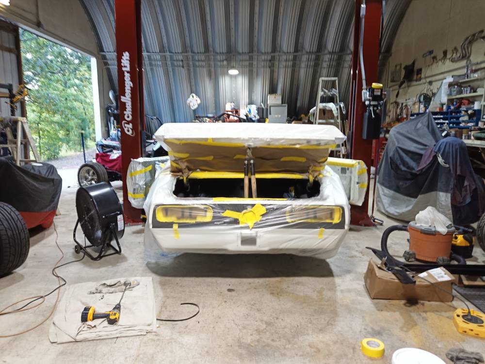

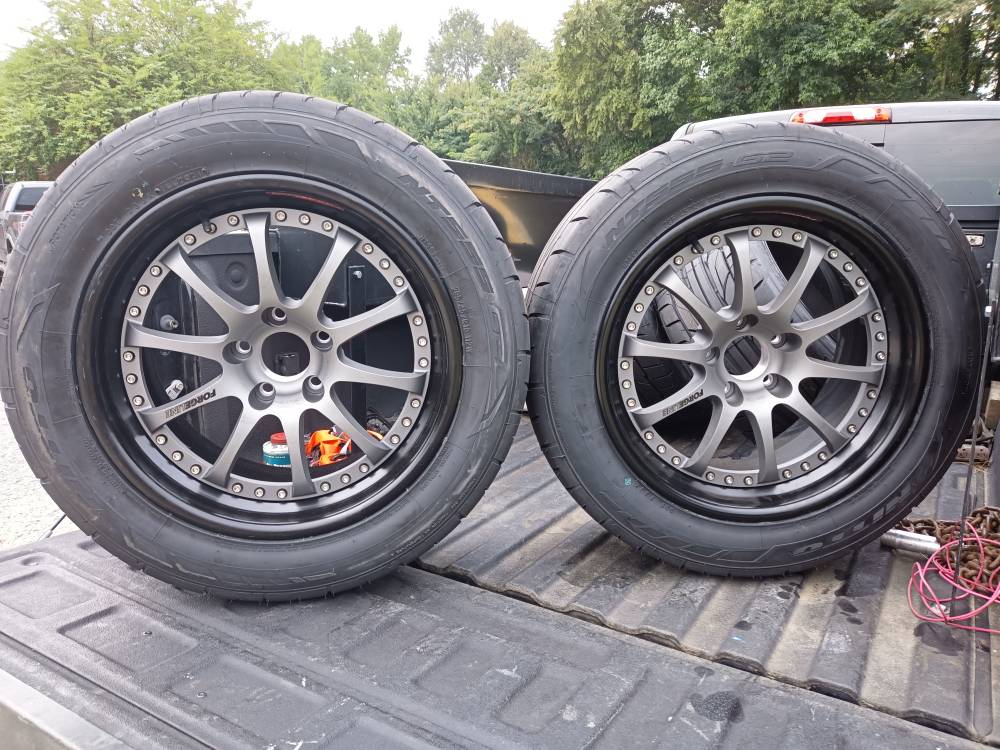

      Ok so I got the interior floor sealed, sanded and seam sealed. Partially taped. Getting ready to spray lizard skin sound deadener and lizard skin ceramic heat barrier.
      Also got my nitros mounted on some Forgeline ZX3 Rs.
      Titanium centers and black barrels.
      275-40-18 fronts
      295-45-18 rears. ( I wanted the height of the 45 @28.40" tall. I built thee entire car around a. 28" tire the 315s.
      I wanted nthe 315-40 rears but nitro is out of stock and not saying when
      I could ha e got a drag radial or dot road race type but I wanted a street tread so these will do to finish the build and roast them away while waiting on the 315-40-18.
      The last photo is the 275-40-17 that I had on the car before. Lot taller and wider. Name:  IMG_20210807_125919.jpeg
Size:  83.9 KBName:  IMG_20210807_125924.jpeg
Size:  61.1 KBName:  IMG_20210806_095658.jpeg
Size:  98.5 KBName:  IMG_20210806_092920.jpeg
Size:  140.6 KBName:  IMG_20210806_231703.jpeg

    12. #132
      Jun 2015
      175
      Country Flag: New Zealand
      Quote Originally Posted by TANKMASTERJ View Post
      275-40-18 fronts
      have you mocked up with these yet?
    13. #133
      Sep 2017
      839
      Quote Originally Posted by Gmc427 View Post
      Yes. The car is built around them. My rear is very narrow. 52 7/8" narrow. The rear wheels were mocked with a 3" spacer. To get me where I want to be and compensate for the 6.97 backspace. I'm going to use the spacers as to mill off a few thousands or 1/8 or whatever to fine tune where I want them. Then I'll re barrel the rears accordingly. I did that because I got the ZX3r wheels for 2800 new. .
      I want 315 on rear but they are long back orders nkw so 295s are temporary.
      The height of them is I built the car for a 26" front height and a 28" rear. I had 24.5 fronts and 25.5 rears and it was way to low and I had to floor jack to get it on my challenger CL10v3 lift. That was t going to work for me and it had really no rake or stance. So alot of math and tape measure on to conclude what I really wanted.
      TANKMASTERJ
      Jasons Toys
      2000 HD Softail

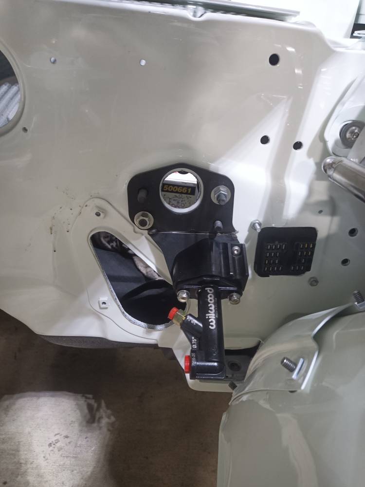

      Ok I wanted to start wiring. So I mocked up the vintage air unit and removed. Enlarged the bulkhead wiring hole and mocked up the. AAW wiring bulkhead. I then realized I need to mock up the clutch kit from bowler.
      I didn't like the geometry or how offset it was from the factory hole. So I sliced the bowler bracket shortened 1/2" and slid it t the center of the car 3/8" for perfect alignment. Re drilled the clutch pin hole for the master rod and all works flawless.
      Now remove all that and begin dynamat extreme.

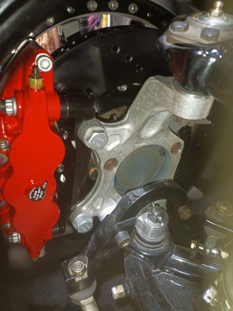

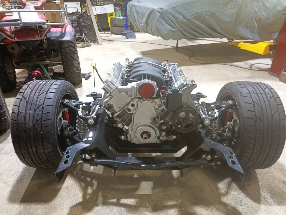

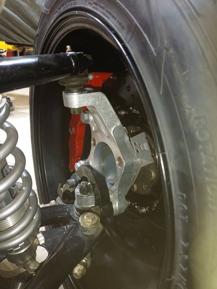

      The 275-40-18 Nitto 555 G2 tires look wide and good on the subframe. I think speed tech says you can run a. 9 or 9.5" wide wheel but I'm running a 10".
      It turns lock to lock both ways with about an inch of clearance.
      I'm tickled.
      Cannot wait to get my engine harness on, AC I'm, and other small stuff done so I can put the subframe back in to see wheel fitment in the wheel well.Name:  IMG_20210821_203039.jpeg
