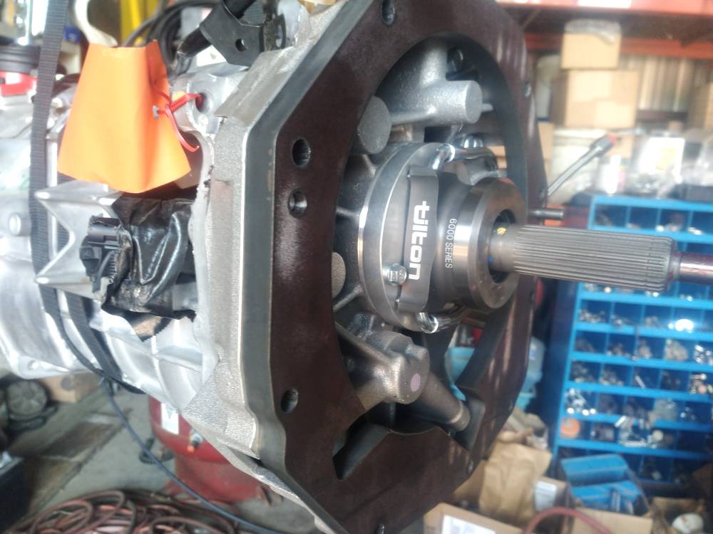

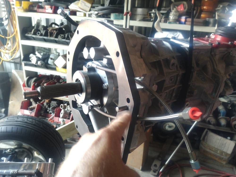

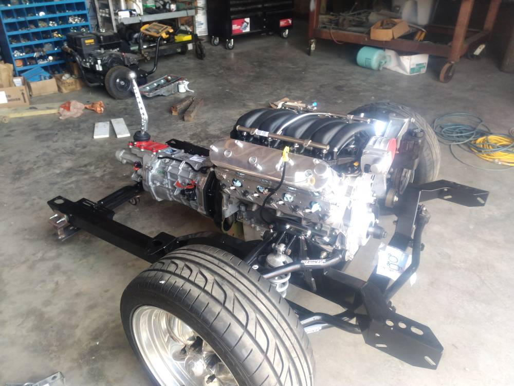

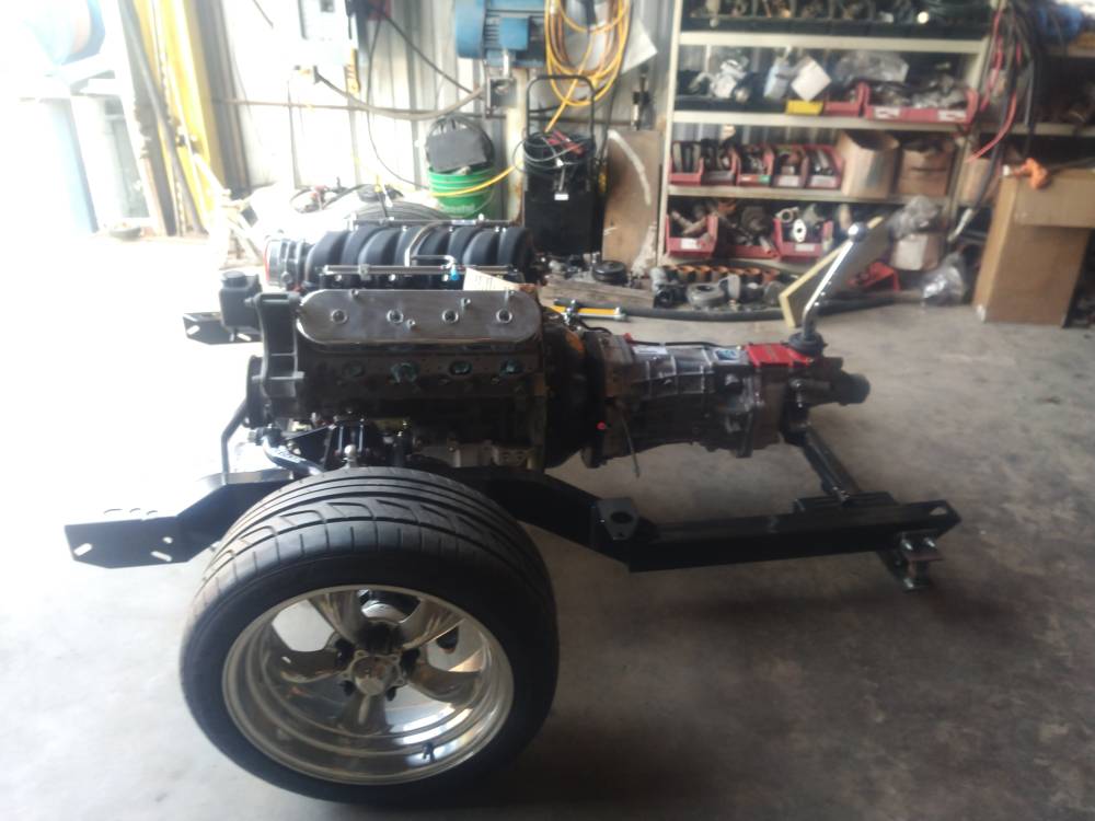

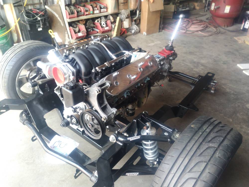

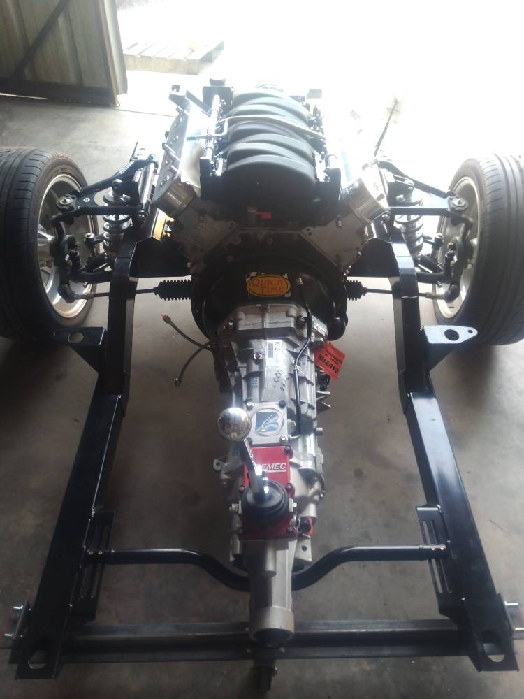

      A little weekend progress. Got my spacer machined for between the bell and the T56. Make it at .625 and you got room for the Tilton 6000 and an LS9 d disc clutch. I checked deck of spacer torqued to bell for maximum of .005 variance. Averaged ..0039 Made longer dowel pins and such. Checked all clearance t insure I got .125 airgap on my Tilton TOB.
      My TOB is all the way screwed down right on the adjustable mount. Good thing about that is if I switch to a McCleod clutch later I got room to stretch it since McCleod is alot shorter than the LS9 clutch.
      This. Setup allowed me to run the larger pilot bearing instead of the needle bearing. Great thing about that is way easier to remove when the time comesName:  IMG_20200919_152101.jpeg

      [QUOTE=TANKMASTERJ;1340150]A little weekend progress. Got my spacer machined for between the bell and the T56. Make it at .625 and you got room for the Tilton 6000 and an LS9 d disc clutch. I checked deck of spacer torqued to bell for maximum of .005 variance. Averaged ..0039 Made longer dowel pins and such. Checked all clearance t insure I got .125 airgap on my Tilton TOB.
      looking good! Very similar build to what I plan for mine. Definitely jealous of your power plant.
      Have you been happy with the quality of the speedtech package? I should be ordering mine soon.

      Zero complaints on speedtech. Absolutely excellent fit, finish , and quality.
      I bought my torque arm rear setup from a guy in Ms that didn't finish a build and my front pro touring subframe from a guy in IL that didn't finish his build. Both at about 15% under new cost .
      Speedtech is first class.
      My power plant come from a Vette that a guy just had juiced up at Late Model Racecraft. Guy just had it done and crashed it. I ga e 8200.00 for it! With all accessories and ECM, pedal and all.

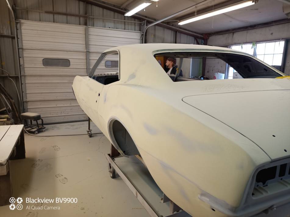

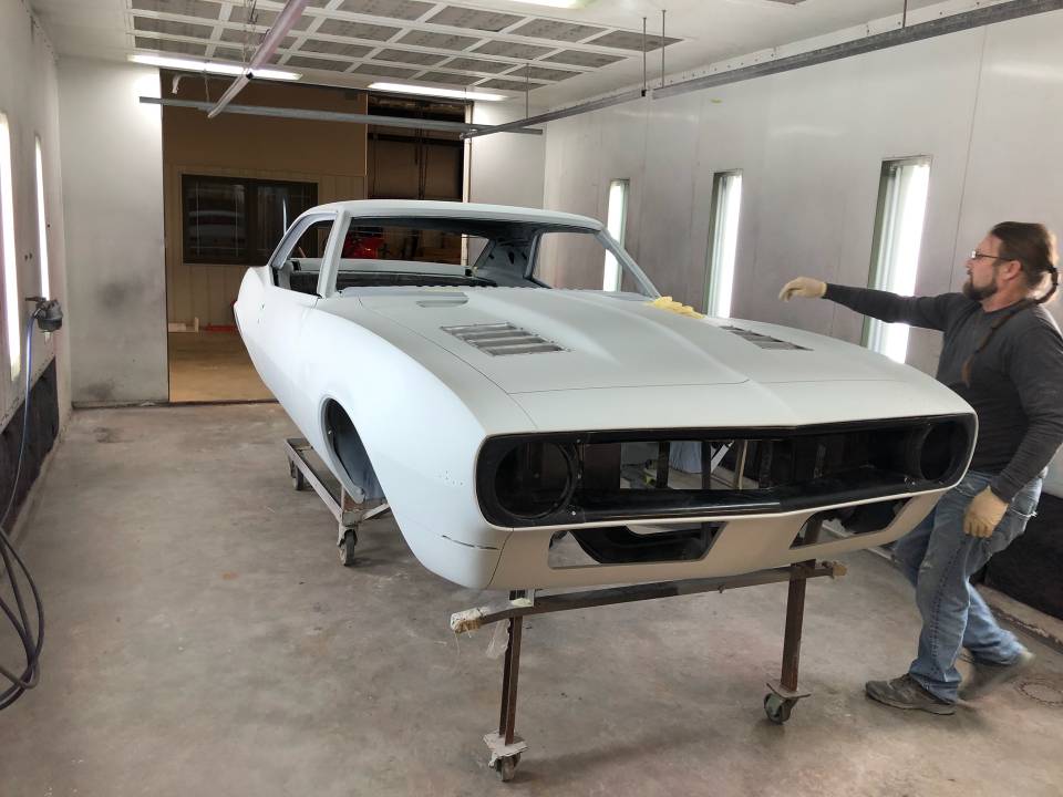

      Some photos of the mud room happening.

      Wow, that looks amazing! And your body guy looks exhausted haha. That's a lot of work.

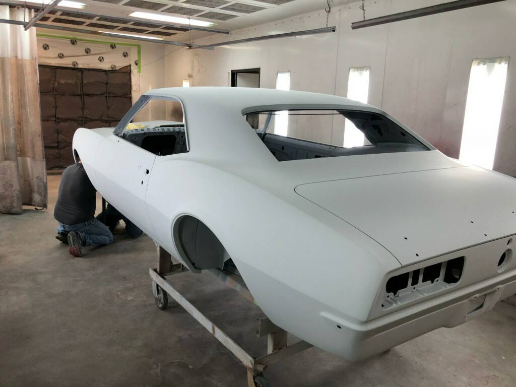

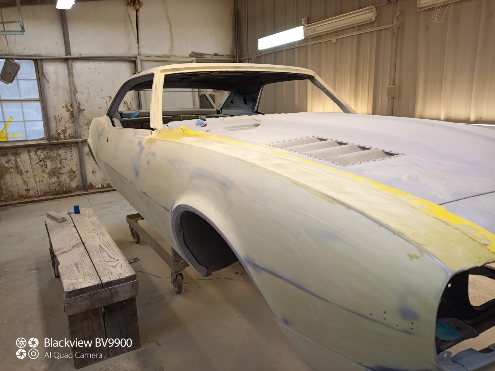

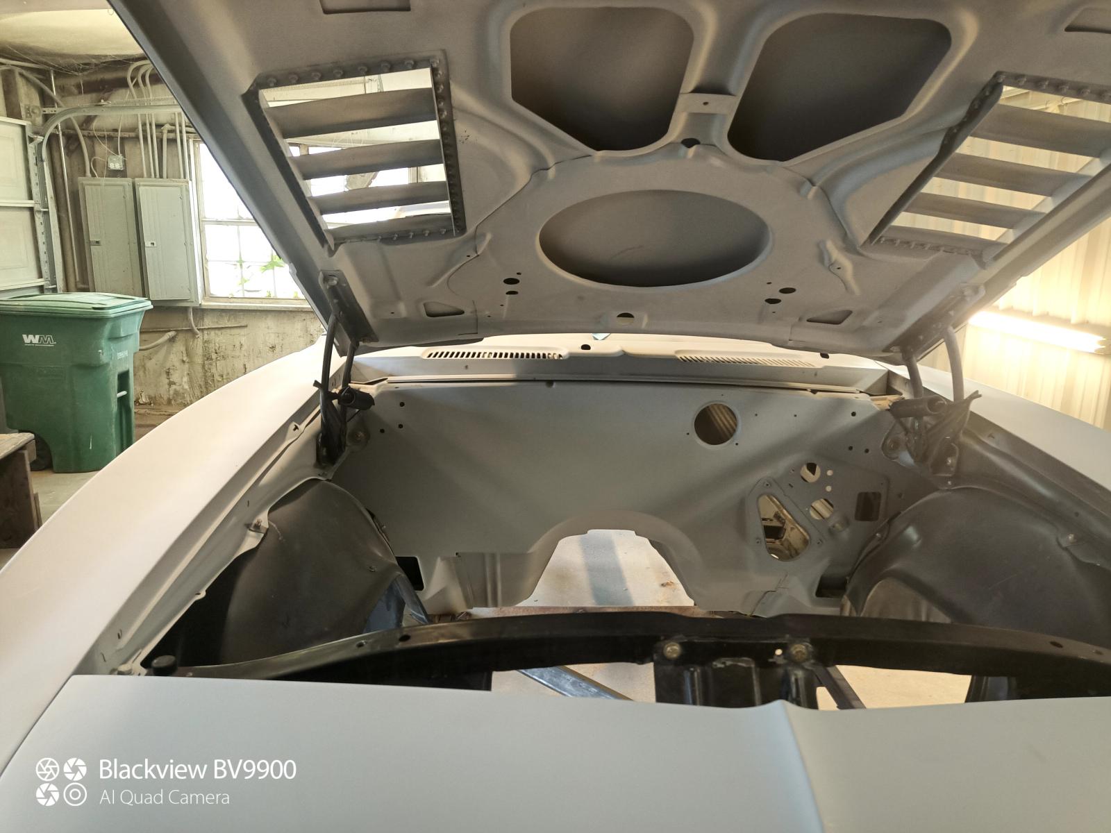

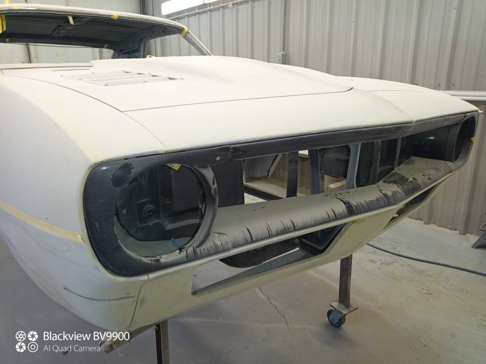

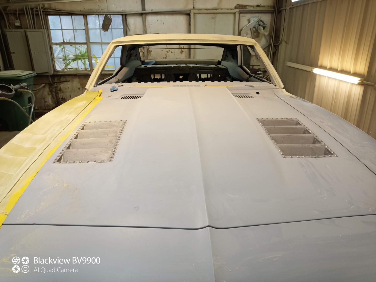

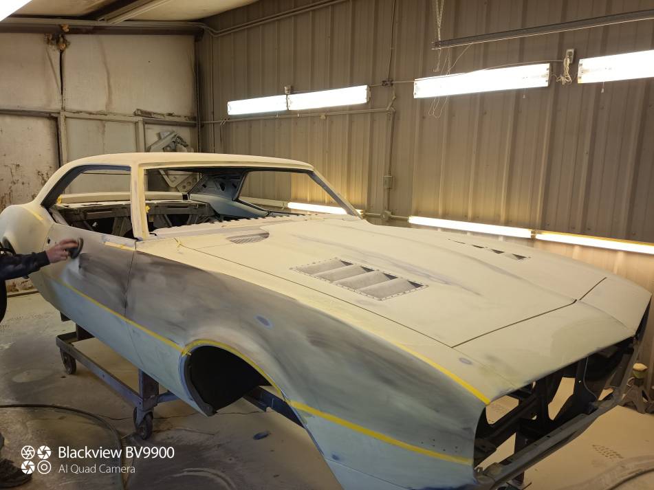

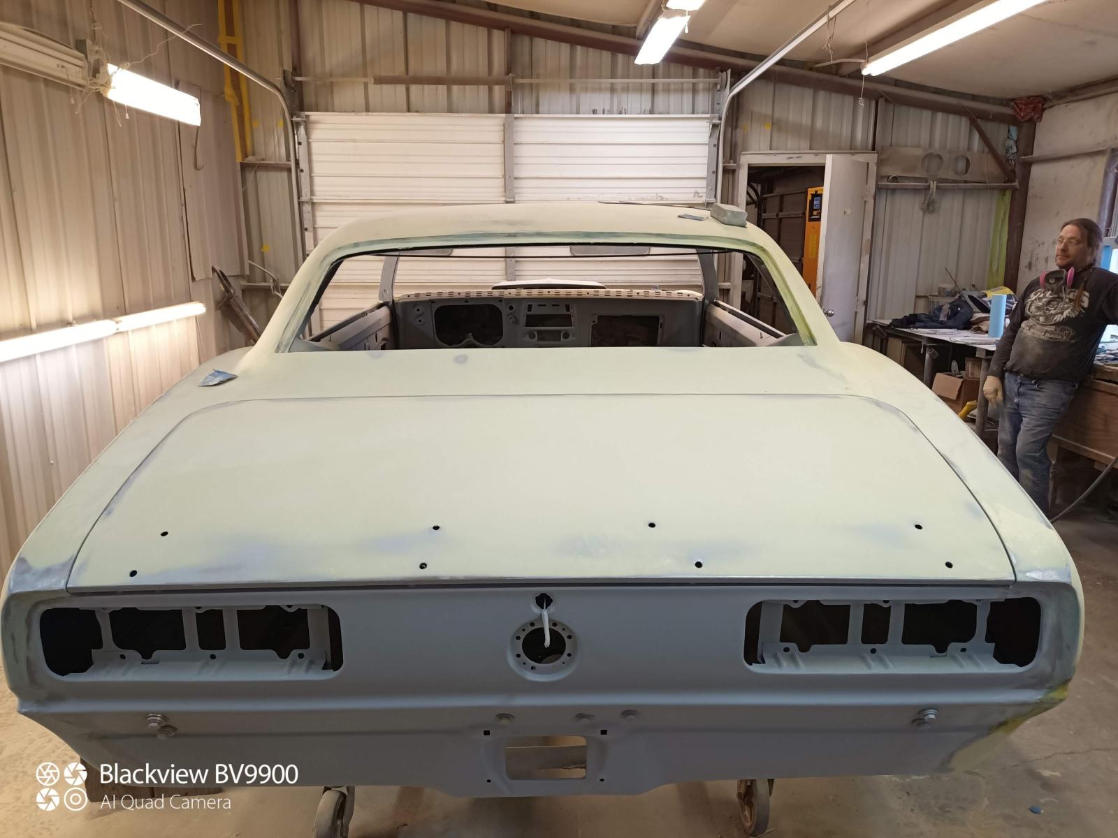

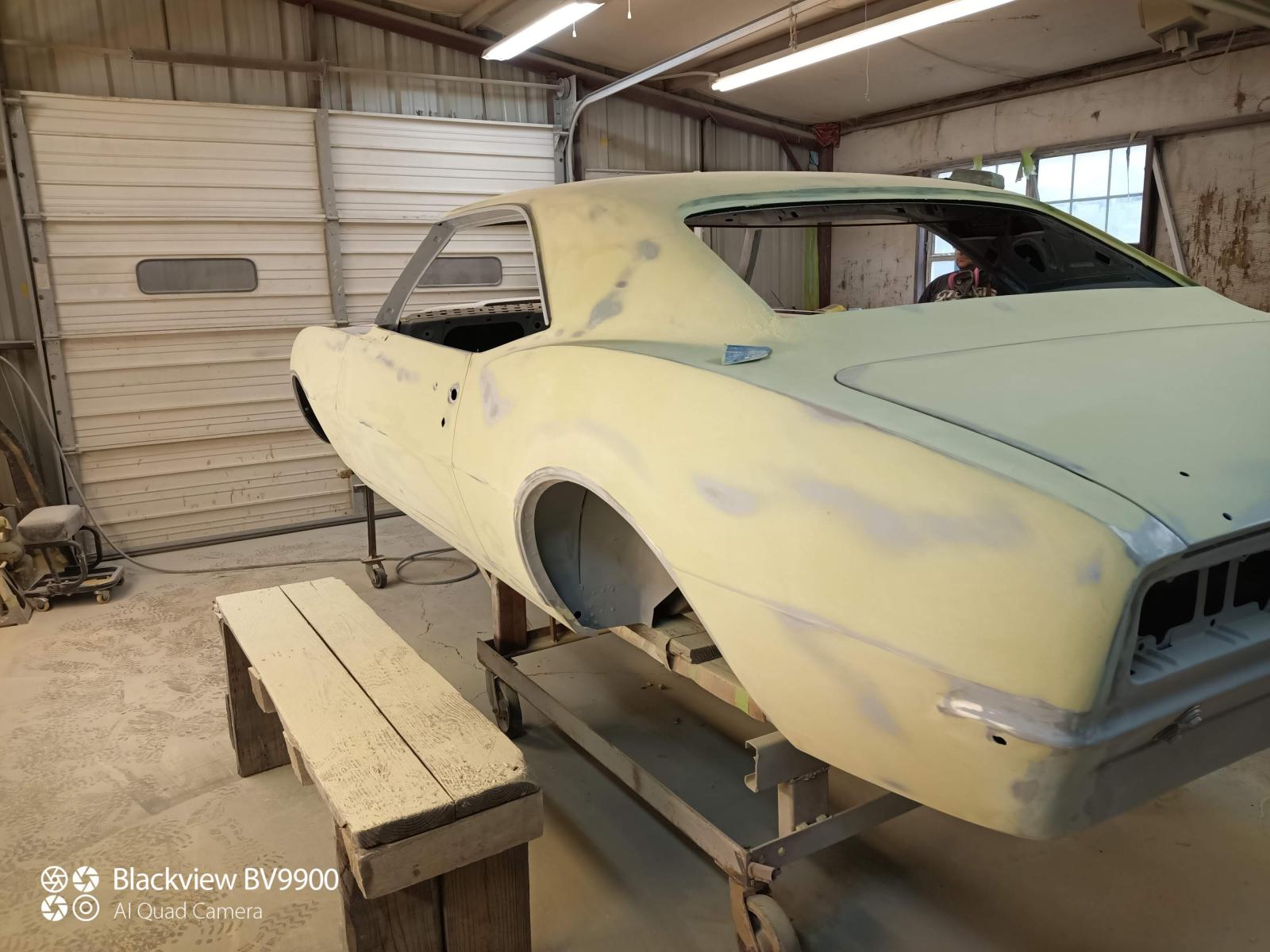

      Few more updates mud room photos . It's in primer coat #1 PPG. Note the fiberglass grill surround insert will give this 67 a more of a. 69 recessed grill look. I'll either fabricate a stainless or aluminum grill.
      I haven't decided yet.Name:  image000000.jpeg

      Can't wait to see it painted Jason ! Primer coat looks perfect !
