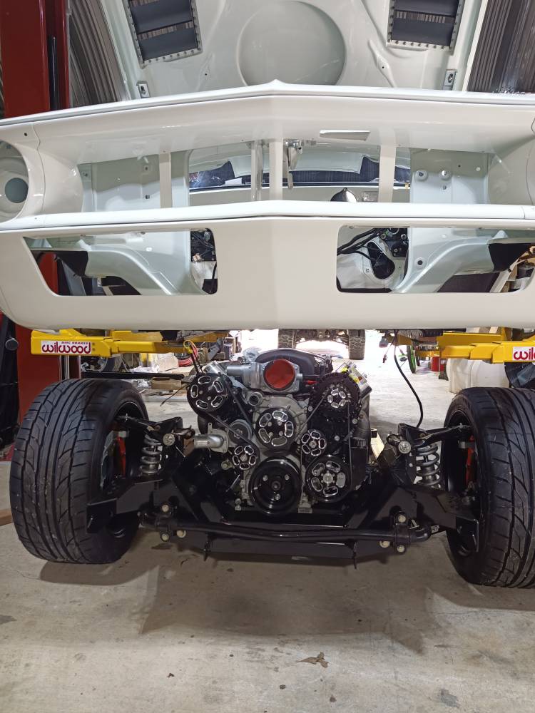

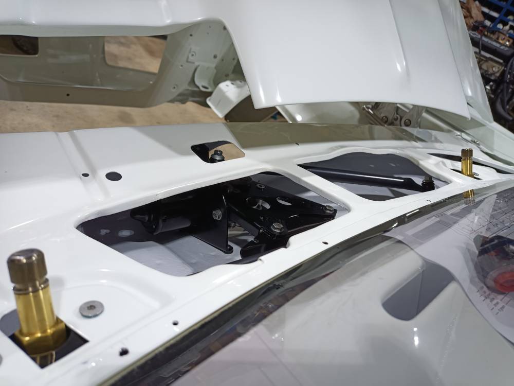

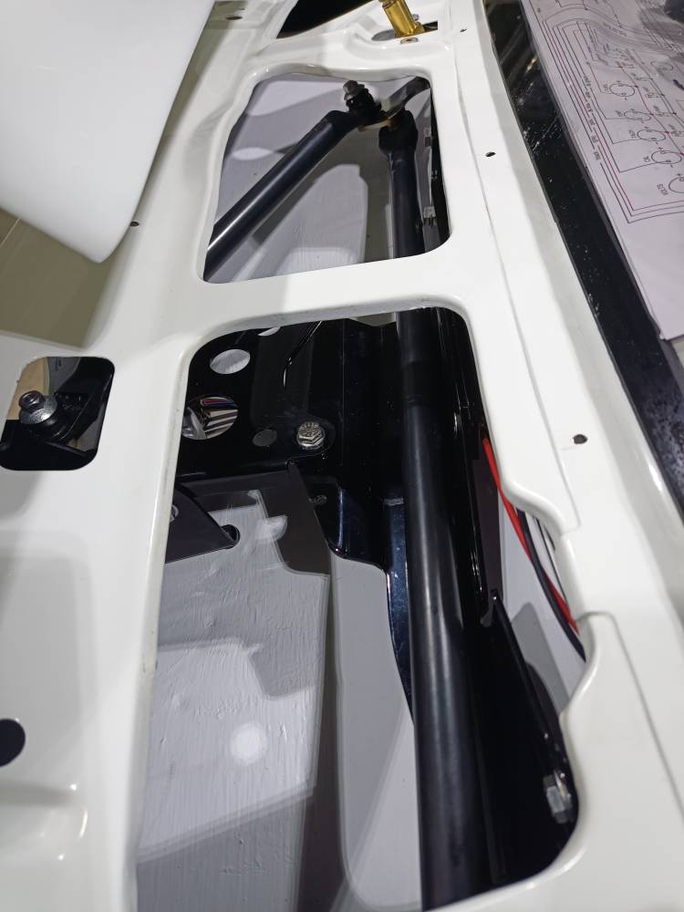

      Ok installed the rain gear wiper kit
      Very impressive and well engineered.

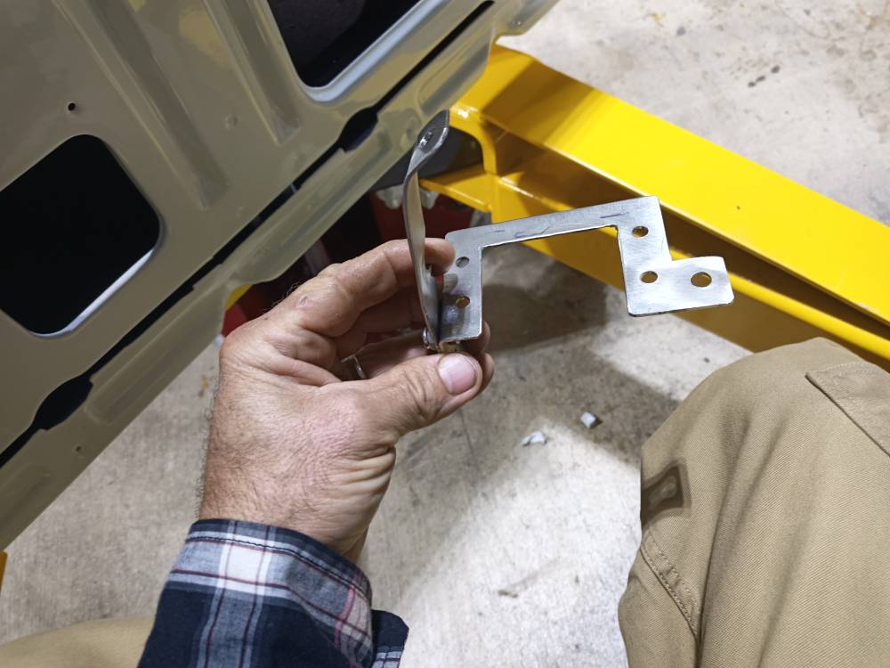

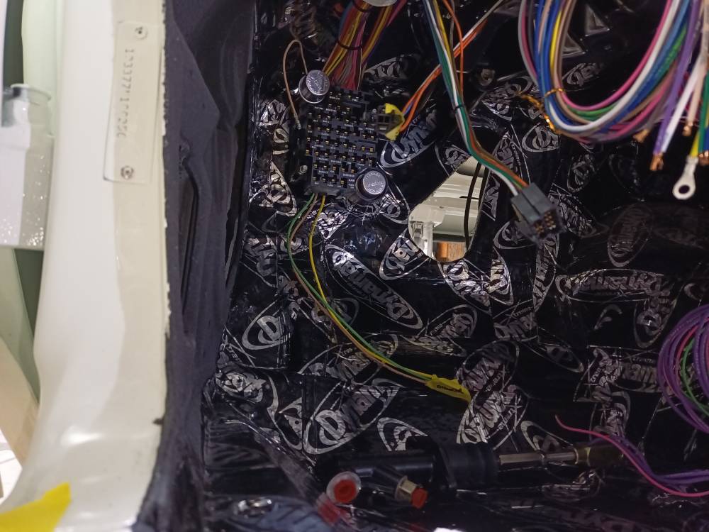

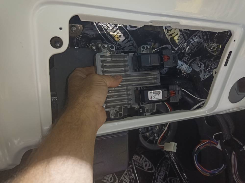

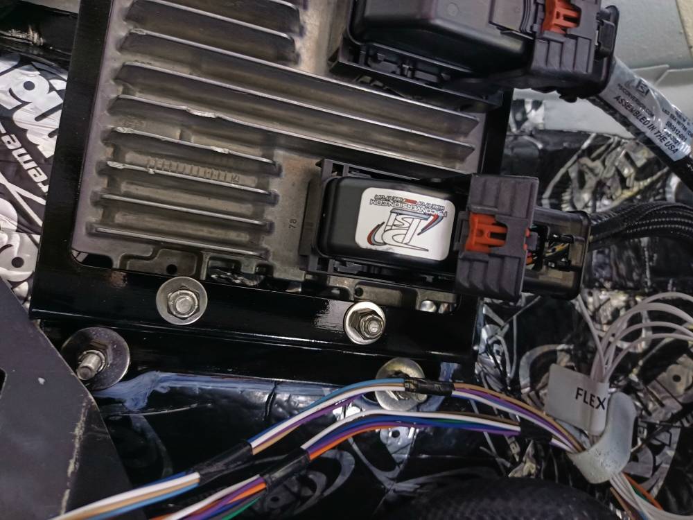

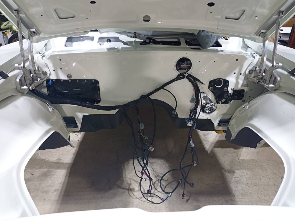

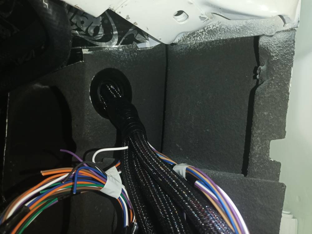

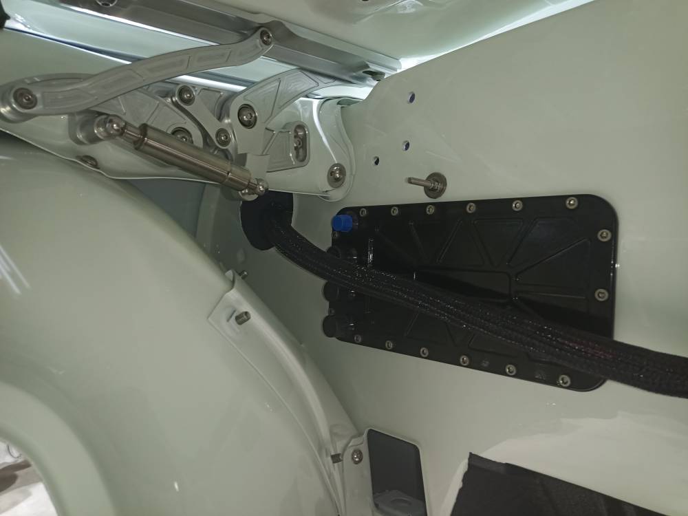

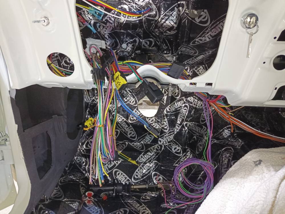

      Putting my E38 ecm in the glove box area.
      Going to be a tight fit. I drilled a 2" hole just behind the kick panel area in that small square are where the jamb is. Drilled it from there into the kick panel area ttl route thee LS harness out the fresh air hole.
      Since my paint shop left it open to run vintage air through but I used a bulkhead so I left that open.

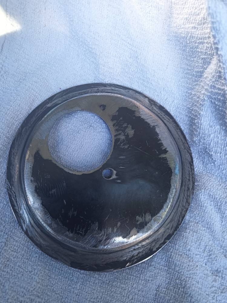

      I took and fabricates a plate like the vintage air fresh air block off plate and offset a 2" hole in it to get my LS engine harness through it. Waiting on it and. My cover plate for the wiper hole both to be powder coated in black gloss.

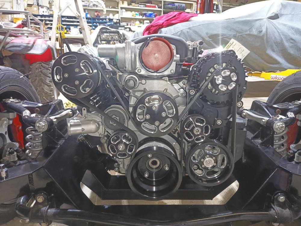

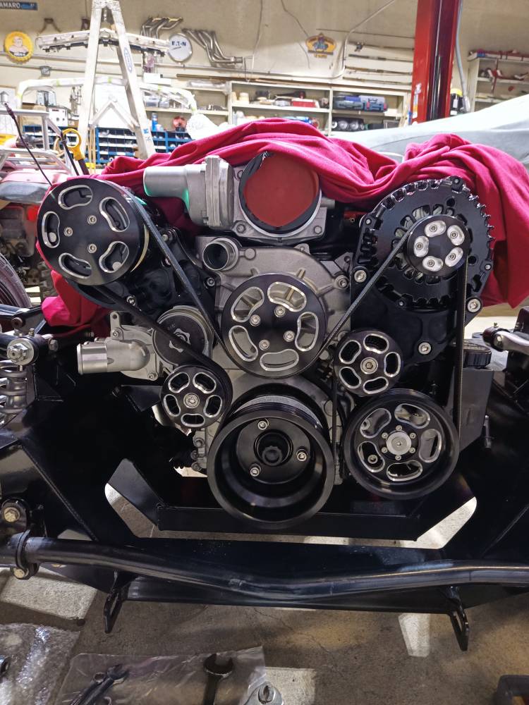

      And also installed the Wegner WAK033 LS3 accessories drive in diamond cut and black.
      Very nice quality.

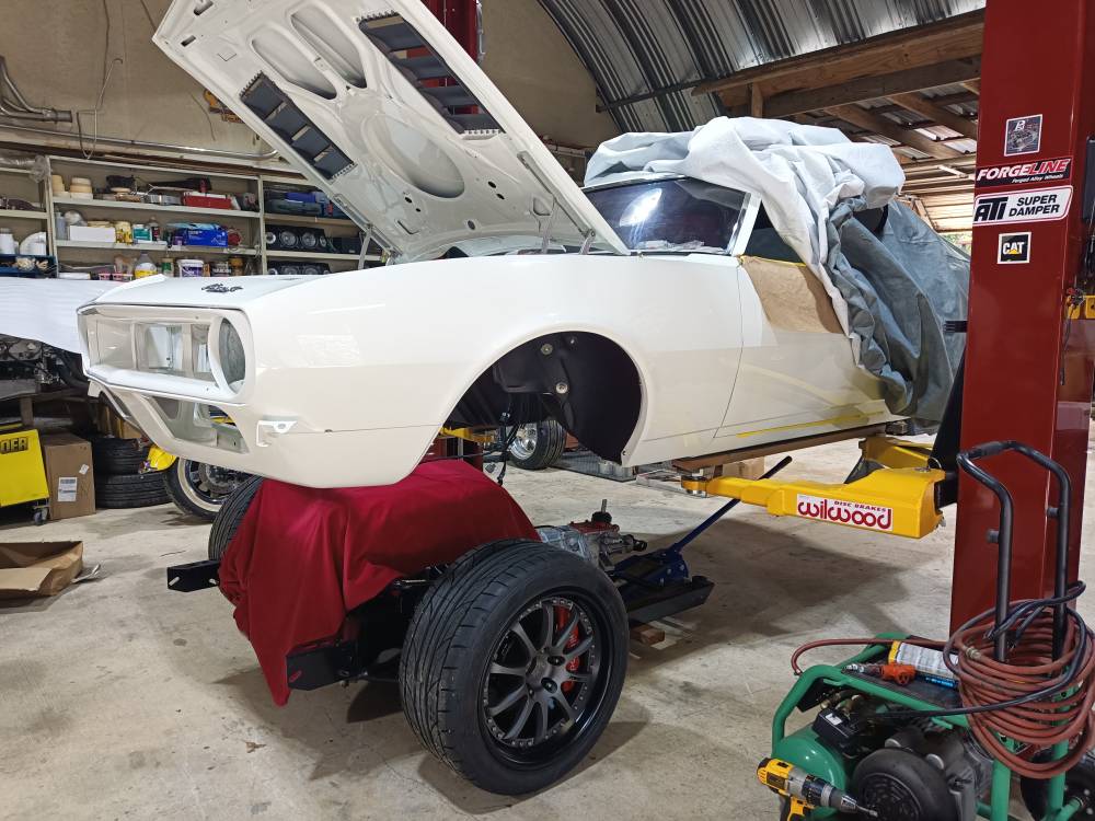

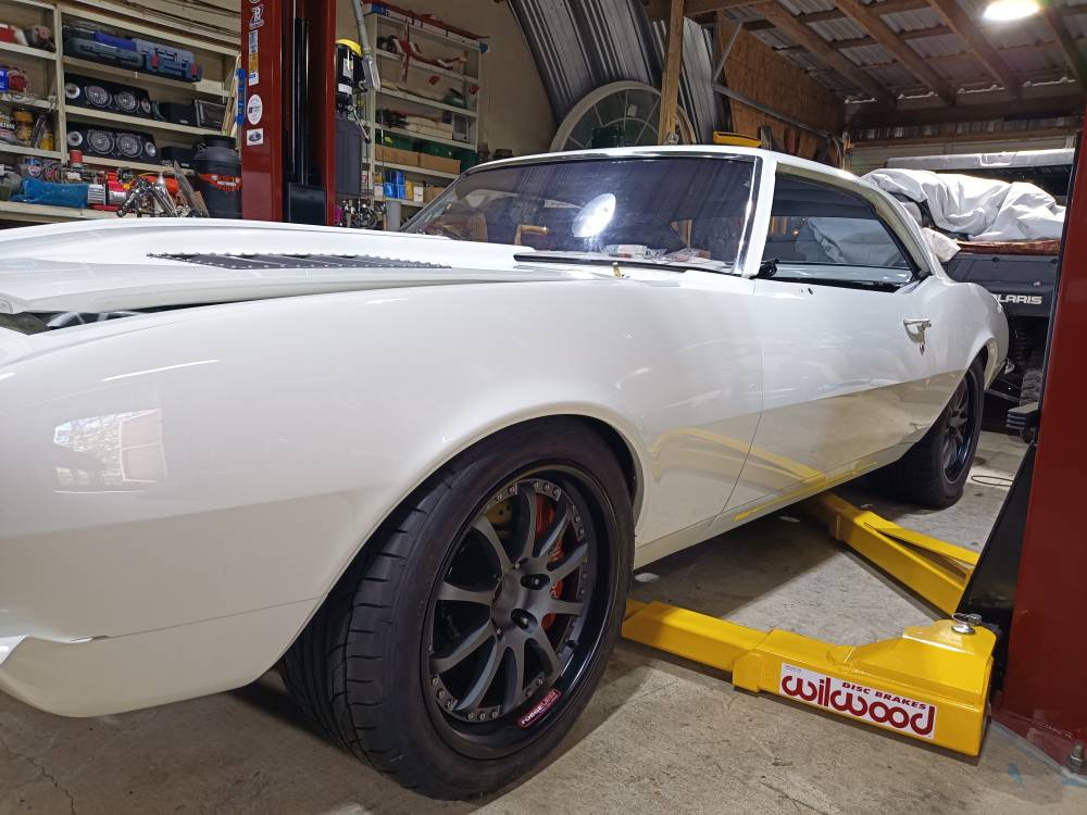

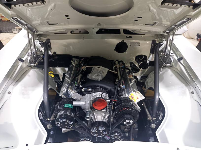

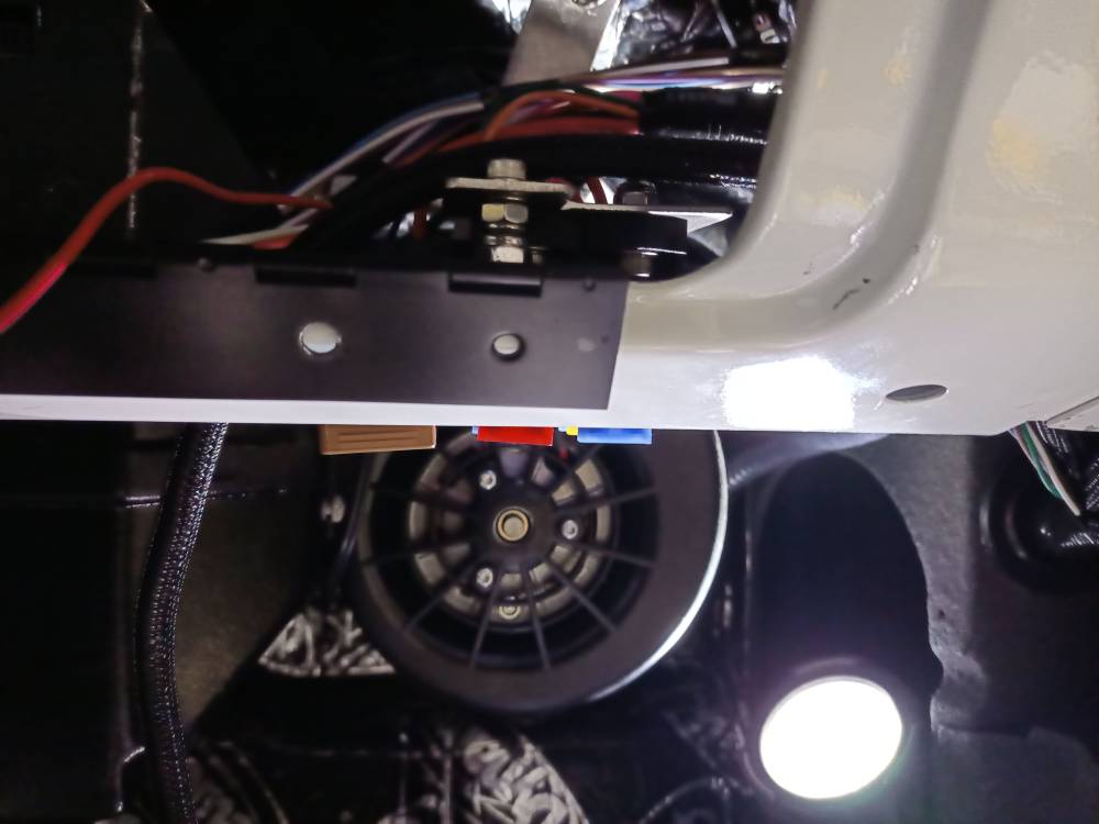

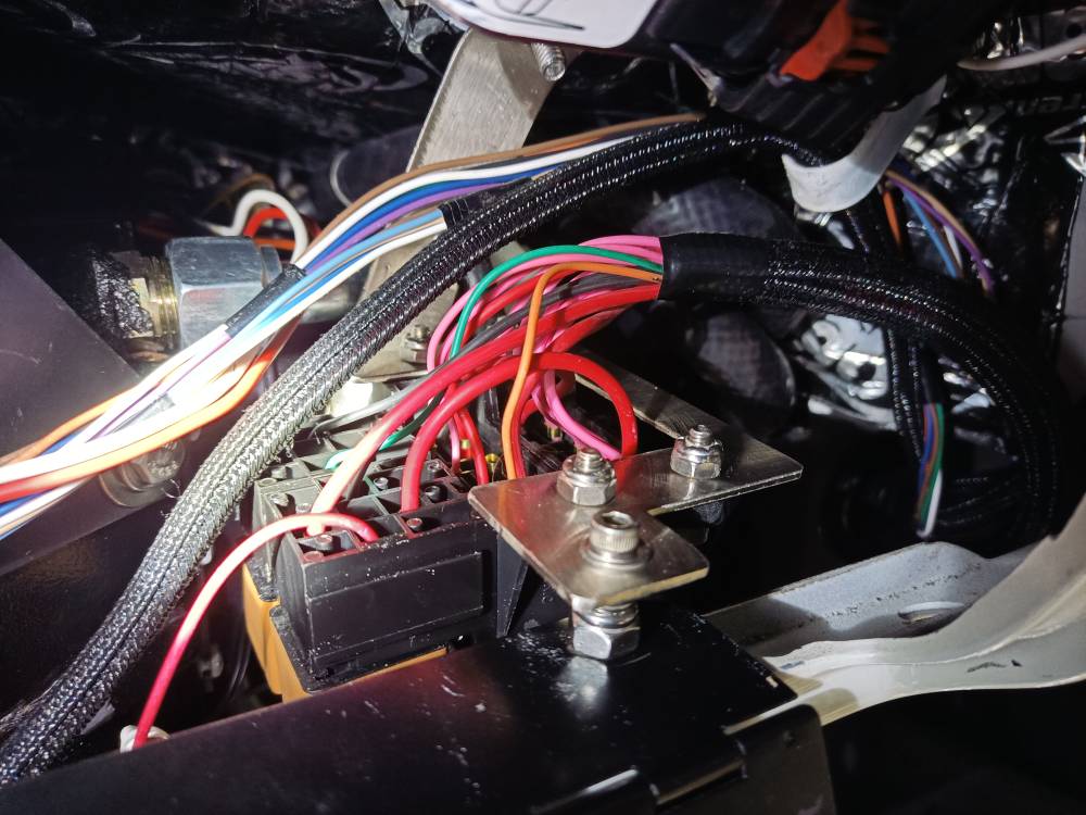

      Ok my car is back on the chassis.
      I got my ECM mounted up under cowl above the VA. Of course the pics suck a.d don't really show how it's mounted but I drilled through the cowl. Ran a stainless steel stud through and shimmed the under dash side to suspend the ECM so it's got plenty of cooling area all the way around.

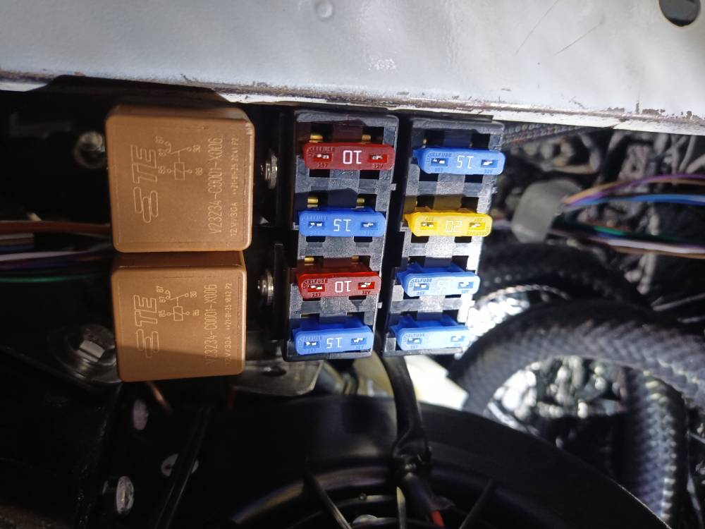

      Fuse box is mounted flush with bottom of the dash right under over box. Fabbed a quick bracket of stainless for it.

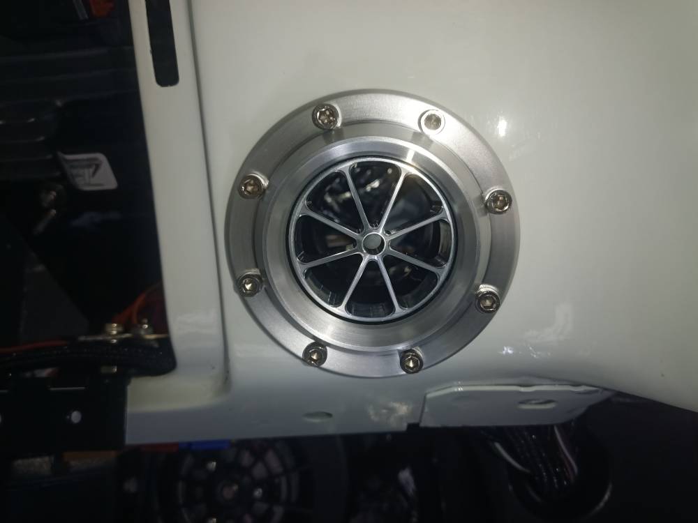

      Got my restomod AC Diablo vents in. They will nicely match my industrial theme.
      Got my speed tech down tubes in.

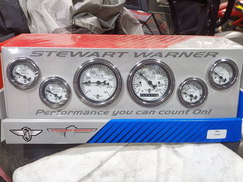

      A photo of my stewart warner wings gauges.
      Wiring is slow and continues in between deer hunting!Name:  IMG_20211030_150404.jpeg

      Looking at your wiper kit from Raingear, is it good quality ?
      Sep 2017
      839
      Quote Originally Posted by berdunord View Post
      You are building a sema car !
      I'm very impressed with the Raingear quality and fit in even the instructions are decent. But yeah quality is there. Way better than factory linkage
