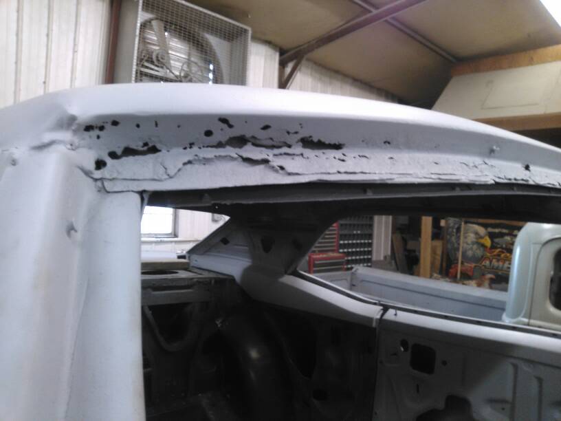

      And swiss cheese leaves this weekName:  IMG_20200320_105552.jpeg

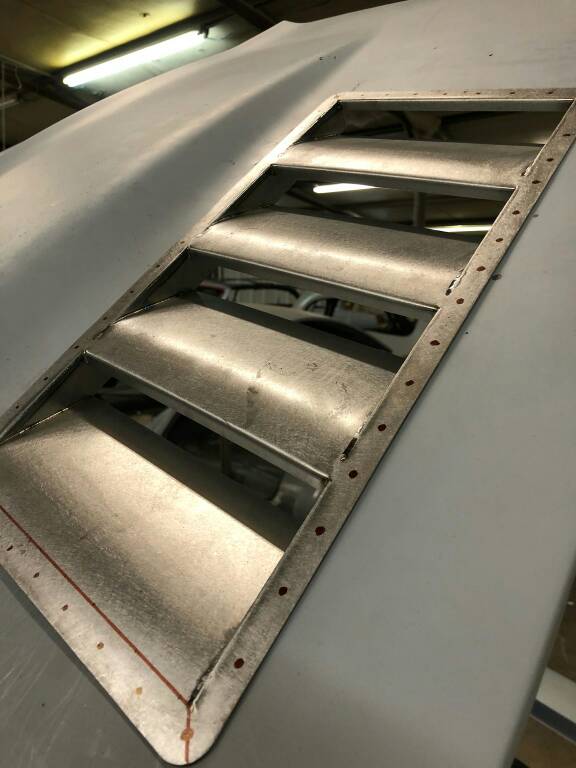

      Solid work! Always scary sanding the car down and finding not so pleasant surprises! I like the hood louvres=)

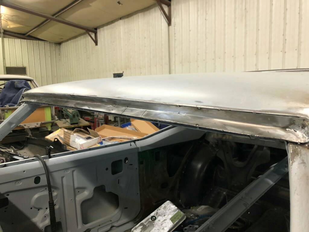

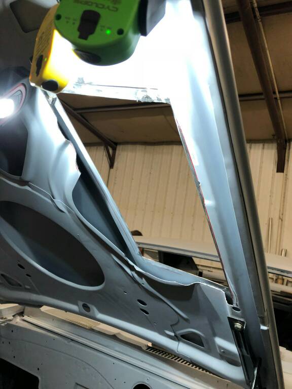

      And back of car Swiss cheese goneName:  IMG_20200526_120658.jpeg

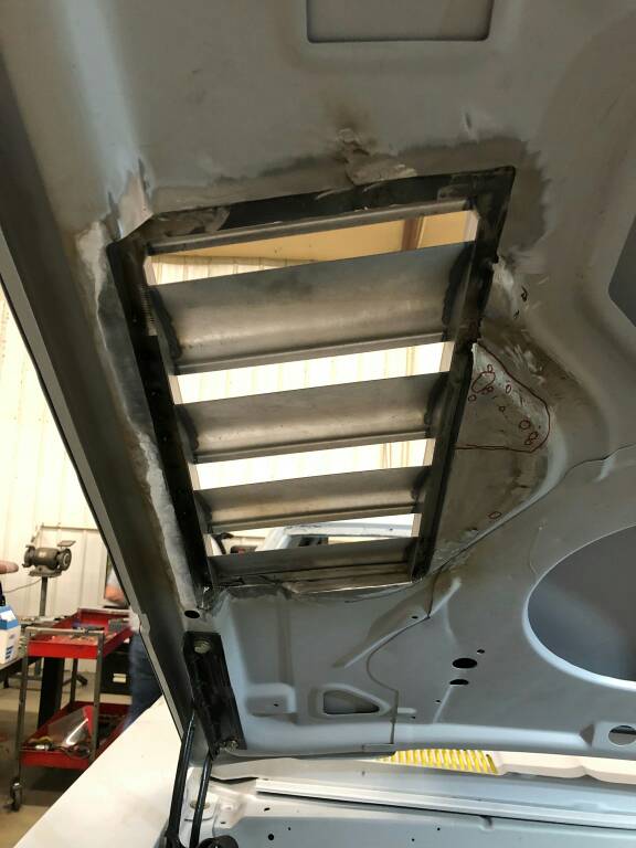

      need more info on these
      Quote Originally Posted by TANKMASTERJ View Post
      A fee new photos of my hood vents going in. Purchased these from Frank on PTF. Excellent fabricated product.
      Thanks FrankAttachment 175223Attachment 175224Attachment 175225

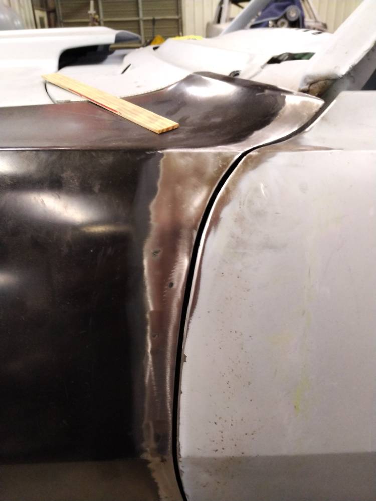

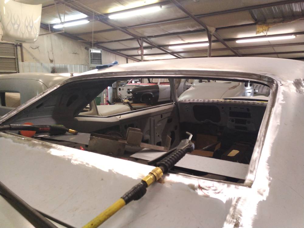

      A few more gap and metal photos. Slow but steadyName:  IMG_20200604_121321.jpeg
Size:  33.4 KBName:  IMG_20200604_121247.jpeg
Size:  49.7 KBName:  IMG_20200604_121305.jpeg

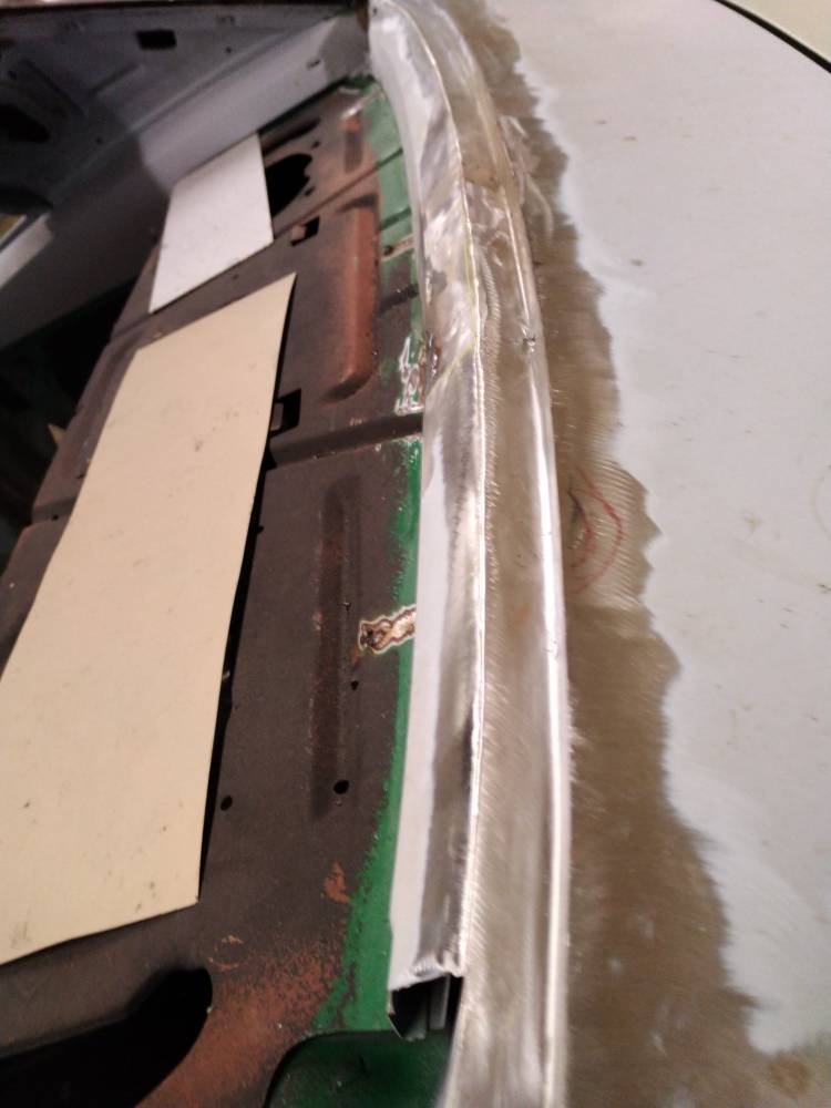

      And the firewall finally smoothes a little.

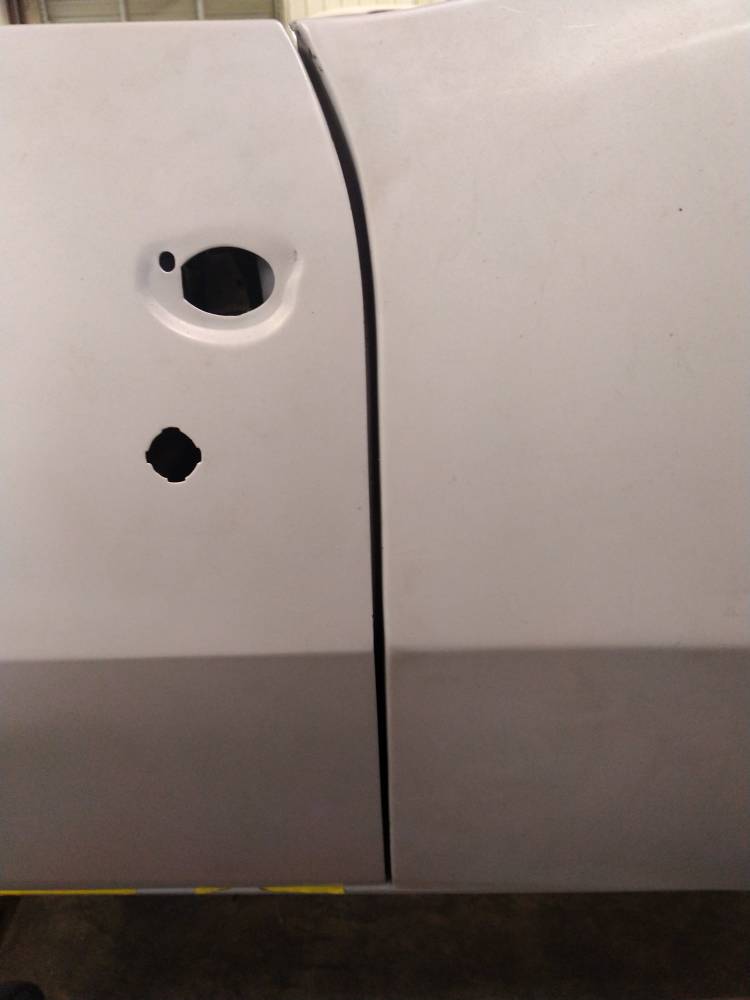

      And a few better pics of gaps. Last few blurred.
      Almost done with metalName:  IMG_20200630_142022.jpeg

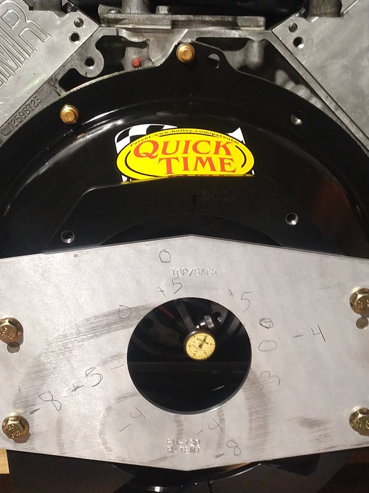

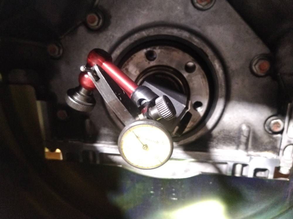

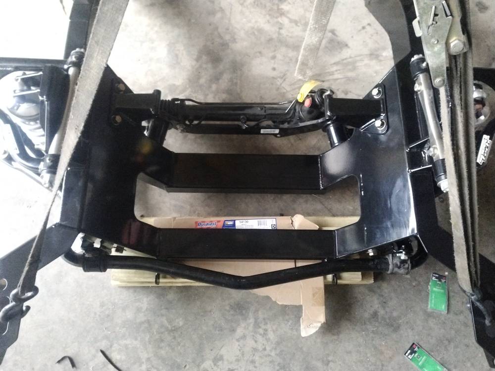

      Little weekend work. Dial indication on the new QuickTime bell on the LS7.
      Widest range was 0 -.008. so I'm. Within spec on run-out at just .004.
      Later this week I'll set pedal for the hydraulic throw out bearing and mock up my LS7 and T56 magnum in my freshly powder coated black Speedtech sub frame.Name:  IMG_20200726_200723.jpeg
Size:  58.3 KBName:  IMG_20200726_200149.jpeg
Size:  77.3 KBName:  IMG_20200726_200334.jpeg

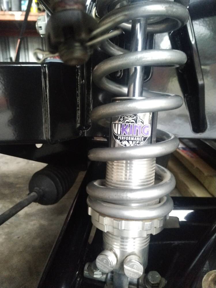

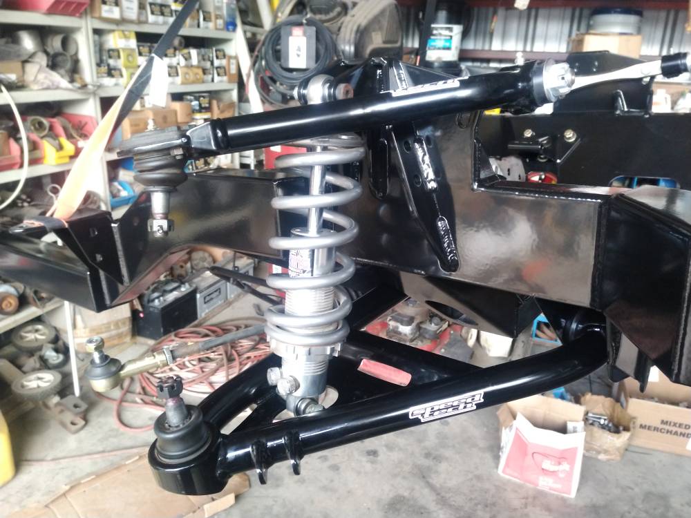

      Got my freshly powdered subframe Al together except my ATS spindles as they were at home and my sub was at my shop in town!
      Slow and. SteadyName:  IMG_20200731_193301.jpeg
Size:  88.2 KBName:  IMG_20200731_193320.jpeg
Size:  73.0 KBName:  IMG_20200731_191136.jpeg
Size:  83.3 KBName:  IMG_20200731_191128.jpeg
Size:  102.7 KBName:  IMG_20200731_191434.jpeg

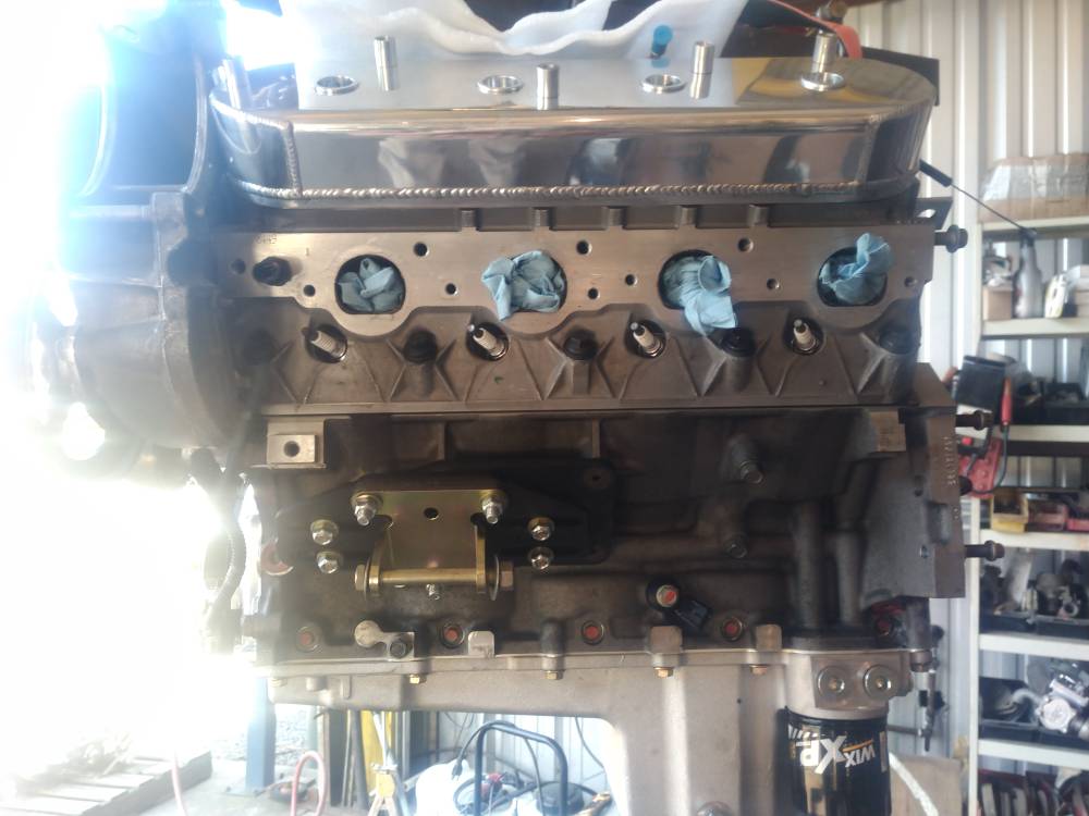

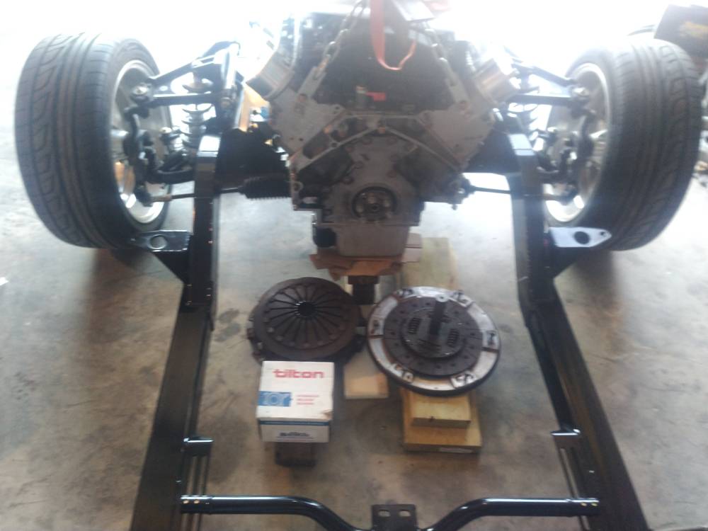

      Ok LS7 engine. Had this fidanza aluminum flywheel and LS9 clutch on when I bought it. Found out my tremec magnum along with quick time bell doesn't fit. Not enough room for the Tilton TOB. Measurements show exactly .500 not enough room. Turns out a McLeod clutch would so fine but I want to be able to go with the LS9 clutch. So I'm having a spacer machined .625 thick to go between the bell and the magnum. Besides being able to use the LS9 dual disc clutch I'll also be able to use the Roller Pilot bearing that runs the. Outer edge of the crank rather than the needle pilot bearing deep in the crank.
      They make 1/4 and 3/8 spacers but I don't want to sstack them so a machined one at .625 is just what the doctor ordered.
      .500 to get to fit and .125 for the TOB airgap. Name:  IMG_20200805_185621.jpeg
Size:  98.0 KBName:  IMG_20200528_130942.jpeg
      TANKMASTERJ
      Jasons Toys
      2000 HD Softail

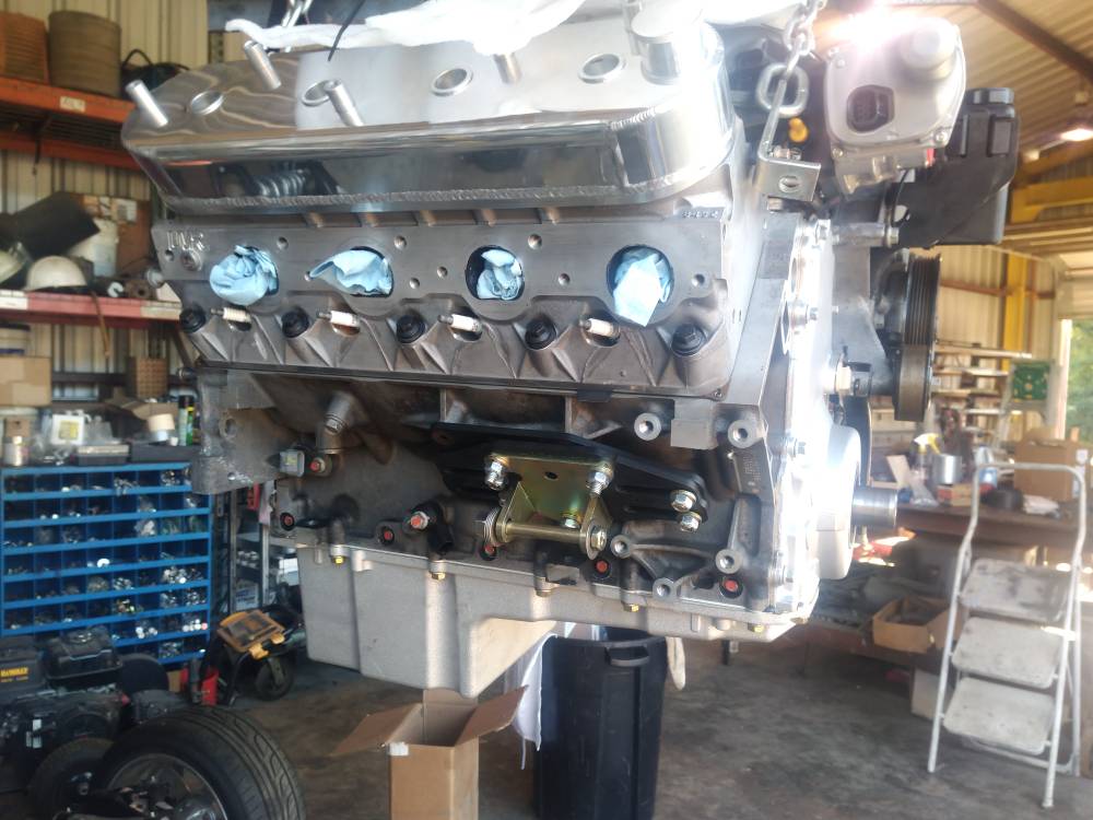

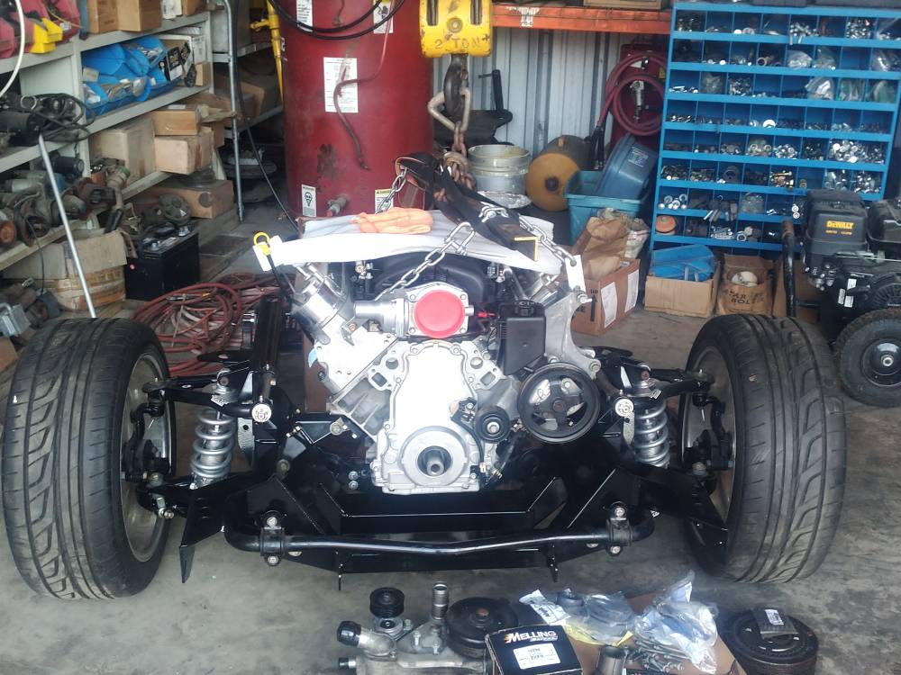

      So I got on the LS7 wet conversion today. Swapped oil pump, shimmed it to tolerance. Swapped front cover. Added a Katech C5r timing chain and a Mast Motorsports stroker oil pan kit. Fit is excellent on the pan.
      Clears the speedtech pro touring subframe with rack and pinion on the Rear
      Got the LS7 on the subframe. Just waiting on my machinist buddy to make my trans to bell spacer and I can install the T56.
      After that I'm going to wire it and start it for the first time in the subframe since I'm going crazy waiting for the car to be painted and get off the rotisserie.Name:  IMG_20200828_175651.jpeg
Size:  93.5 KBName:  IMG_20200828_175705.jpeg
Size:  72.8 KBName:  IMG_20200828_175657.jpeg
Size:  102.1 KBName:  IMG_20200828_182528.jpeg
Size:  122.6 KBName:  IMG_20200828_182613.jpeg
