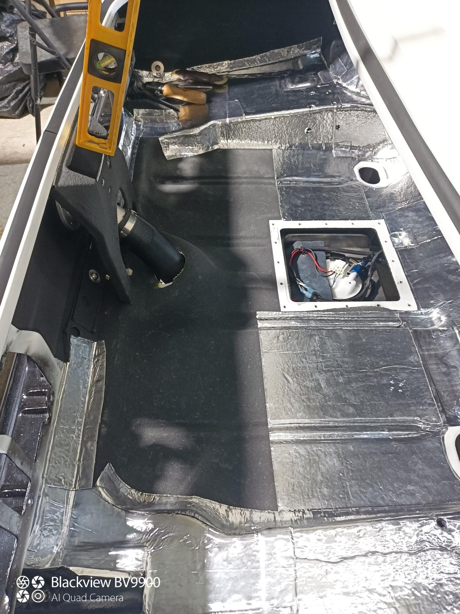

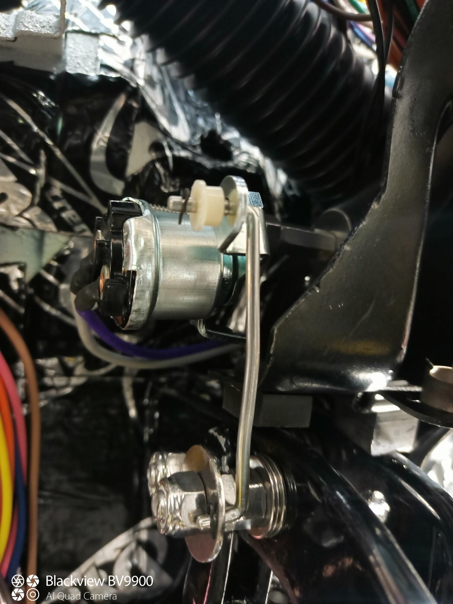

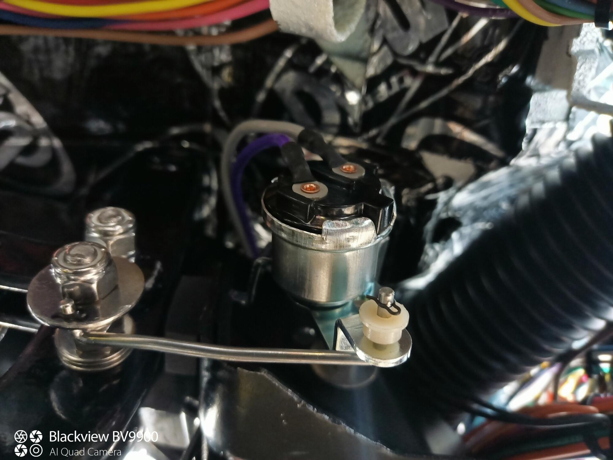

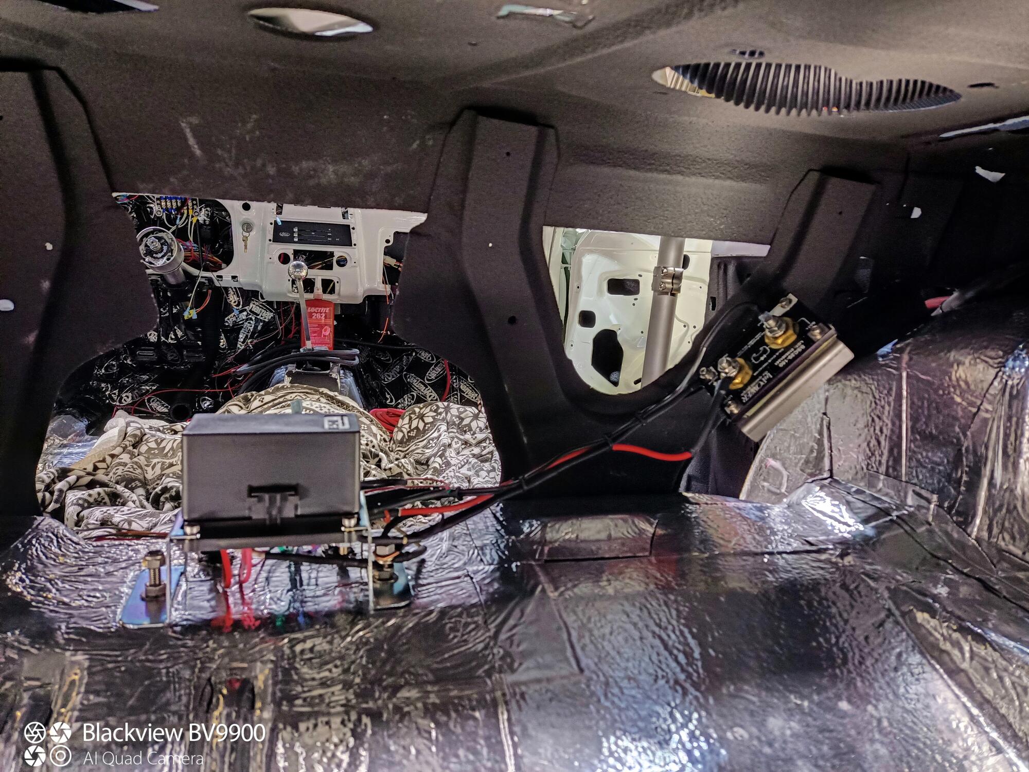

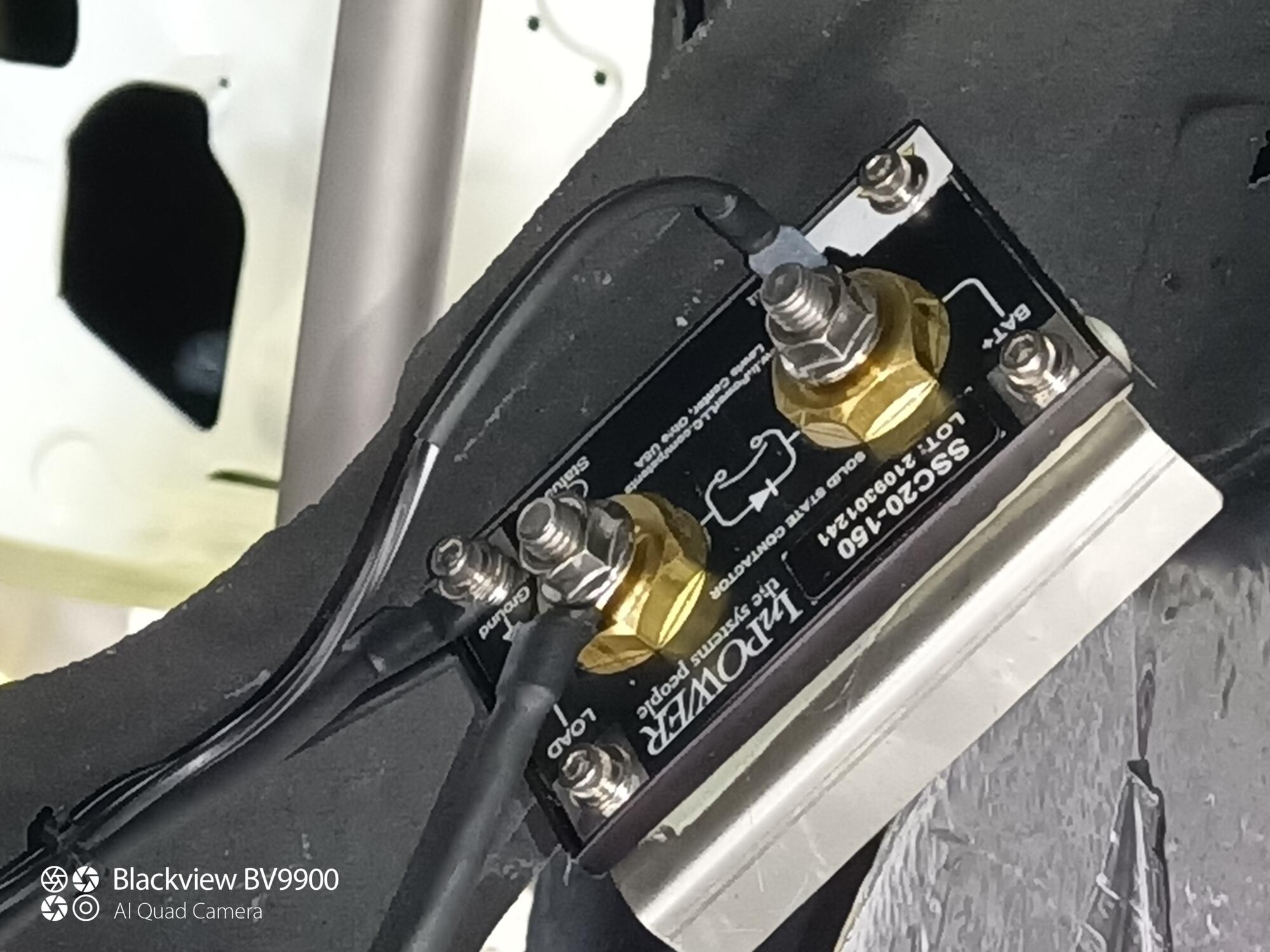

      Ok I fabricated a simple bracket to install a 69 clutch safety switch on my 67. I know many people don't use one but I like the idea of it.
      Secondly got my EATON 5 relay panel in the trunk and my Waytek solid state contactor. It will be remote control for theft protect. Of the 5 relays 3 are wired to be hot with IGN on. That's one for ECM switched, one for Stereo Amp Switched and one for Raingear Wipers. The other two are to heated seats 1 and 2 and won't be hot until you turn on the seat switch.
      After all that crawling around in the trunk I went to finish the hushmat. Ran out at the back of the trunk needing about 6 square feet more.
      fuel pump is also wired in along with fuel sender.Name:  IMG_20220205_195611.jpg
Size:  448.2 KBName:  IMG_20220205_200543.jpg
      Also started on wiring in front of the firewall.
      Cannot wait to hear it crank. Hopefully next weekend.
      I also made battery cables from trunk over he passenger wheel tub. Down to channel above rocker on passenger side. They will penetrate the firewall below vintage air as soon as pass through bulkhead parts arrive. I'll post pics of battery on cables and pass through after installed fully.

      I read the owner's manual for the Inpower contactor. Are you planning on using the control circuit with a hidden switch or some kind of unit that will have a remote such as a key fob?
      Sep 2017
      839
      Yes I'll have a hidden switch for just in case but I'm running a hidden remote with a Key Fob. I tried finding a quality remote and key fob that wasn't china. No luck so far bjt did find one that I can hide pretty easily and it handles 20 amps.. the Intek contactor came from a company called Waytek. They make it in several amperage largest being 200a.

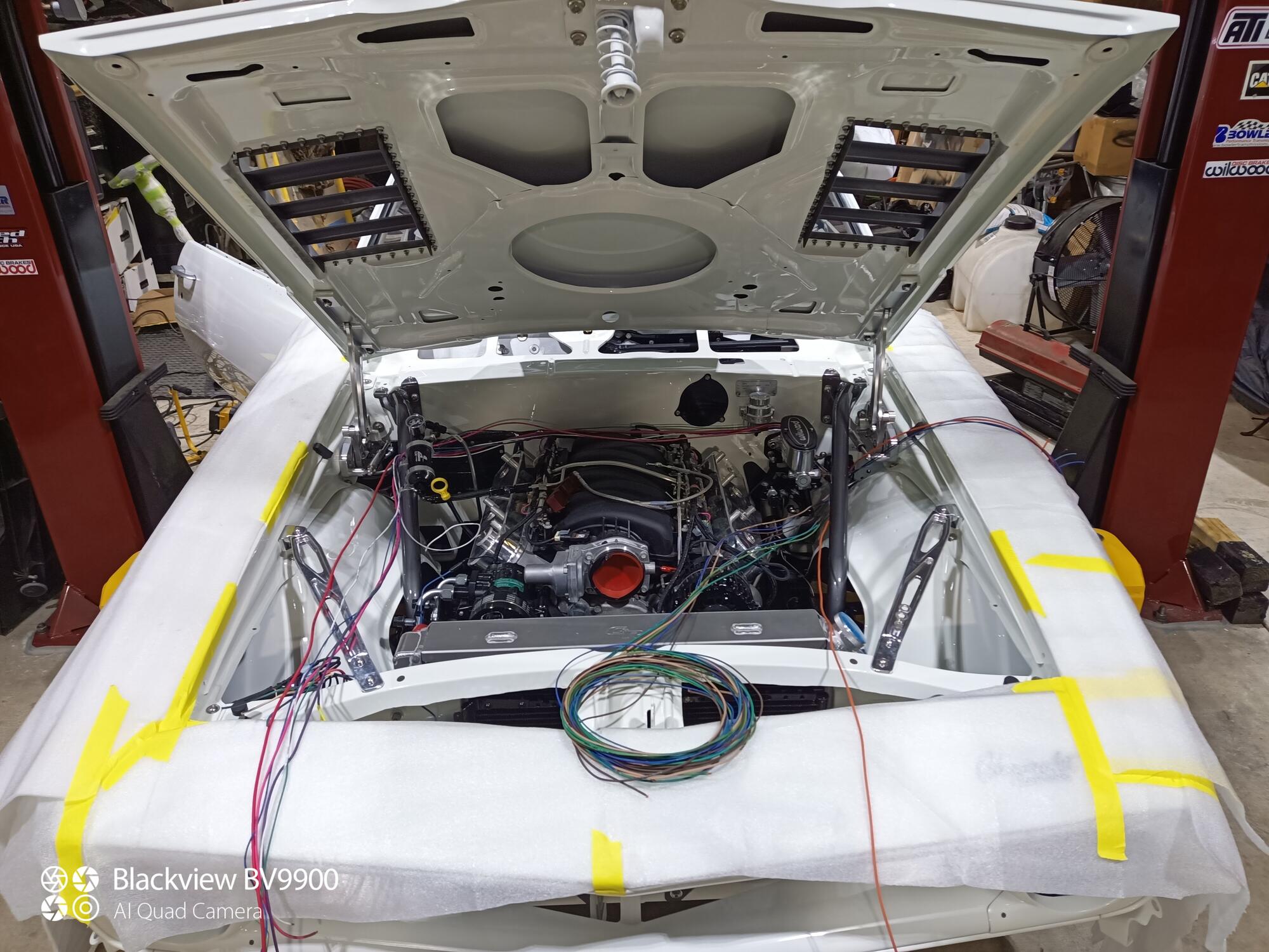

      Ok from the top is my corvette pedal bracket.

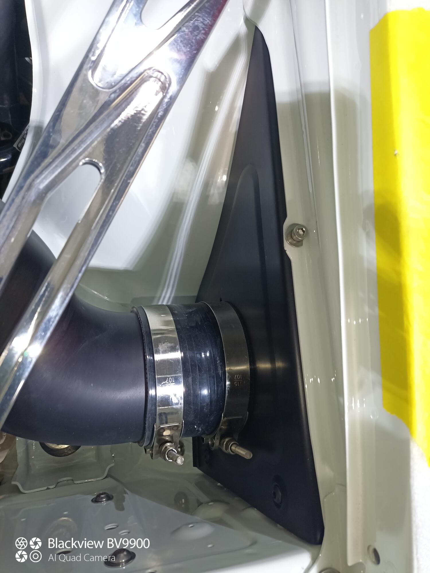

      Then I installed intake tube and K and N kit with closeout for passenger side from Frank here on the forum.

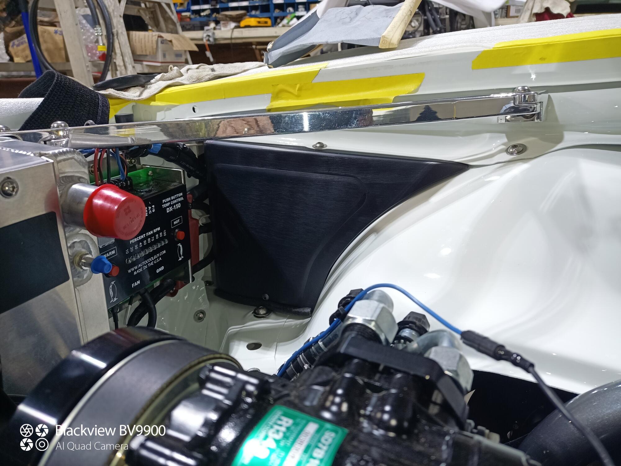

      I've got all circuits wired and tested including
      Crank, start, fans, fan controller, gauges, fan on when AC on, Vintage Air, trunk fuse panel hot, Trunk remote kill with key fob, all lighting wires tested.
      Still got to install all headlights, taillights, and dash indicator lights.
      Gauges and steering Column in.
      The White Lightning logo is the cars name and the top cap of the two piece valve covers LS version that cove Coils from Wegner Motorsports. When the Valve covers arrive I can wire up coils and test fire.

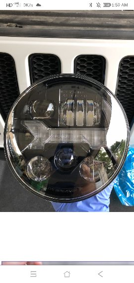

      So I want to do CRAZY and use JW Speaker Evo J3 headlights with blinker, DRL and high and low. Considering heated and non just for looks. I'm attaching both photos, guys help me pick. Remember before you say I'm nuts my entire build is base on an INDUSTRIAL look.
      JasonName:  1645243696977.jpg
Size:  36.0 KBName:  1645243696581.jpg

      I think the bottom one has a more industrial look with all the lines. Cars looking really good.
      Jan 2017
      Los Angeles
      38
      Yeah I like the bottom headlights, pretty unique design….reminds me of a circuit board or tron
      Sep 2017
      839
      Yeah I ordered them. They are JW Speakers designed for Jeep but hey who cares! I think it will look good in the the theme of the car.
      Thanks guys
