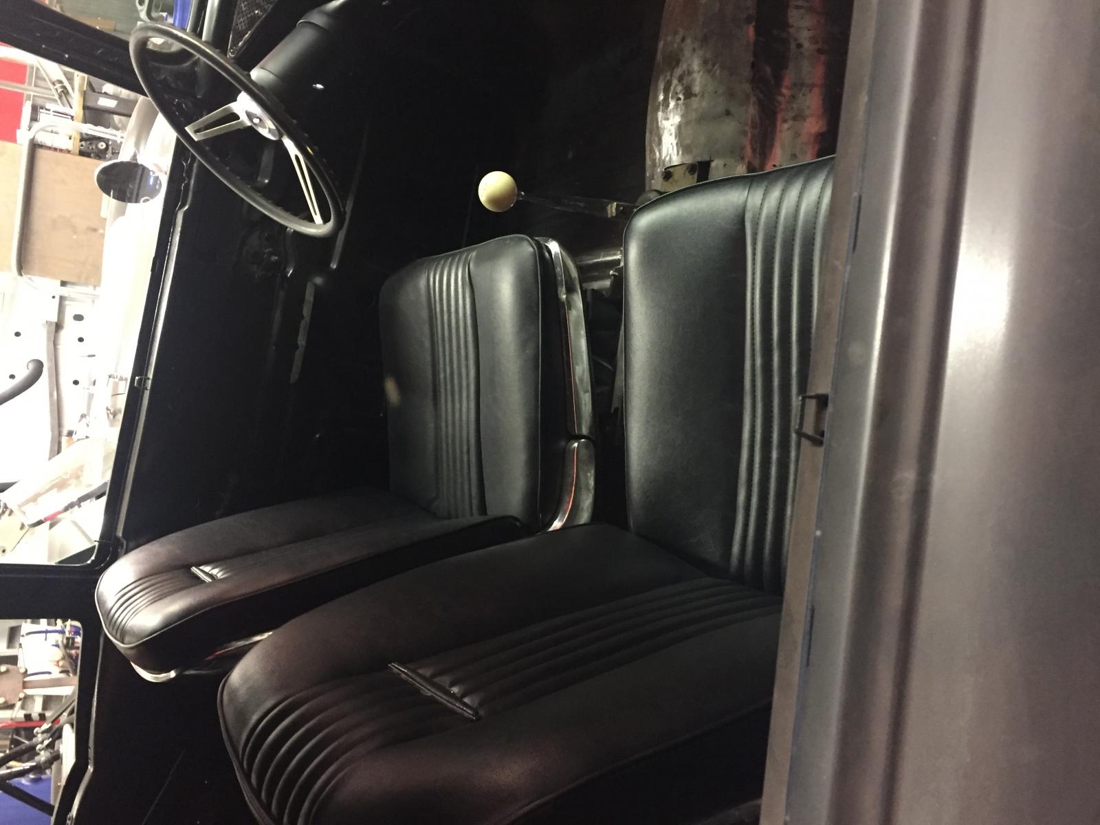

      Two seats are now in. Fabricating the second bracket was a piece of cake. Isn't it always easier the second time?
