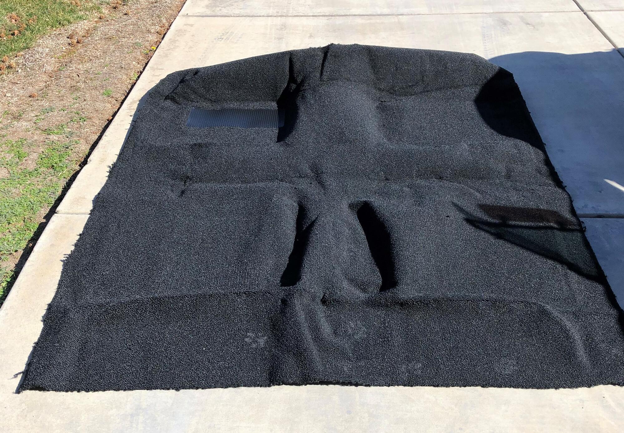

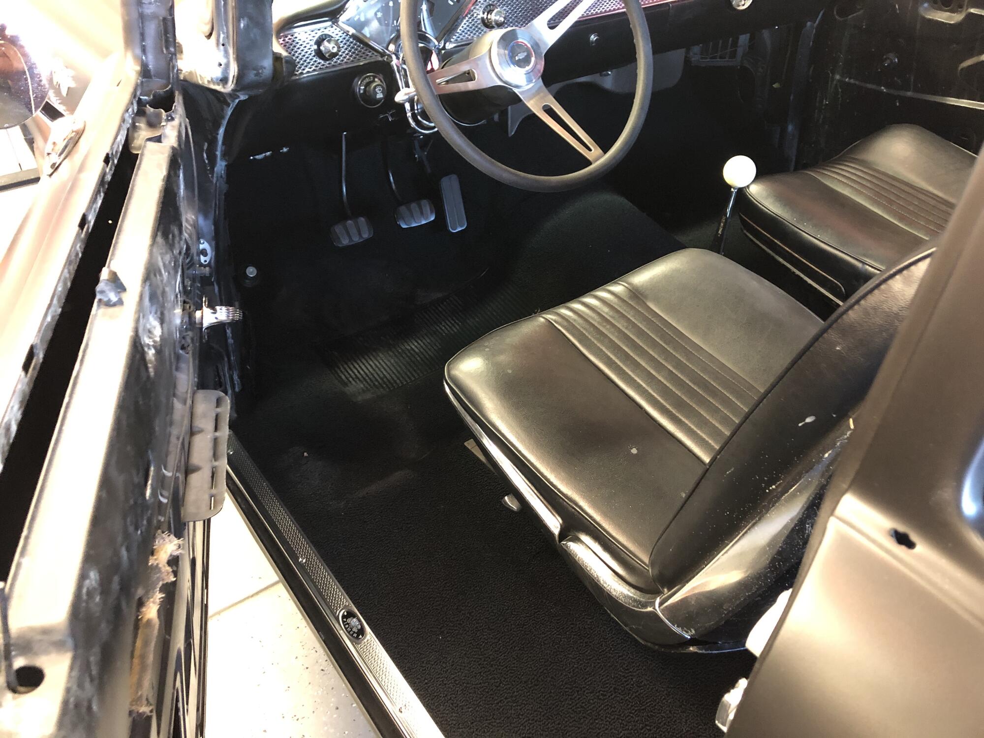

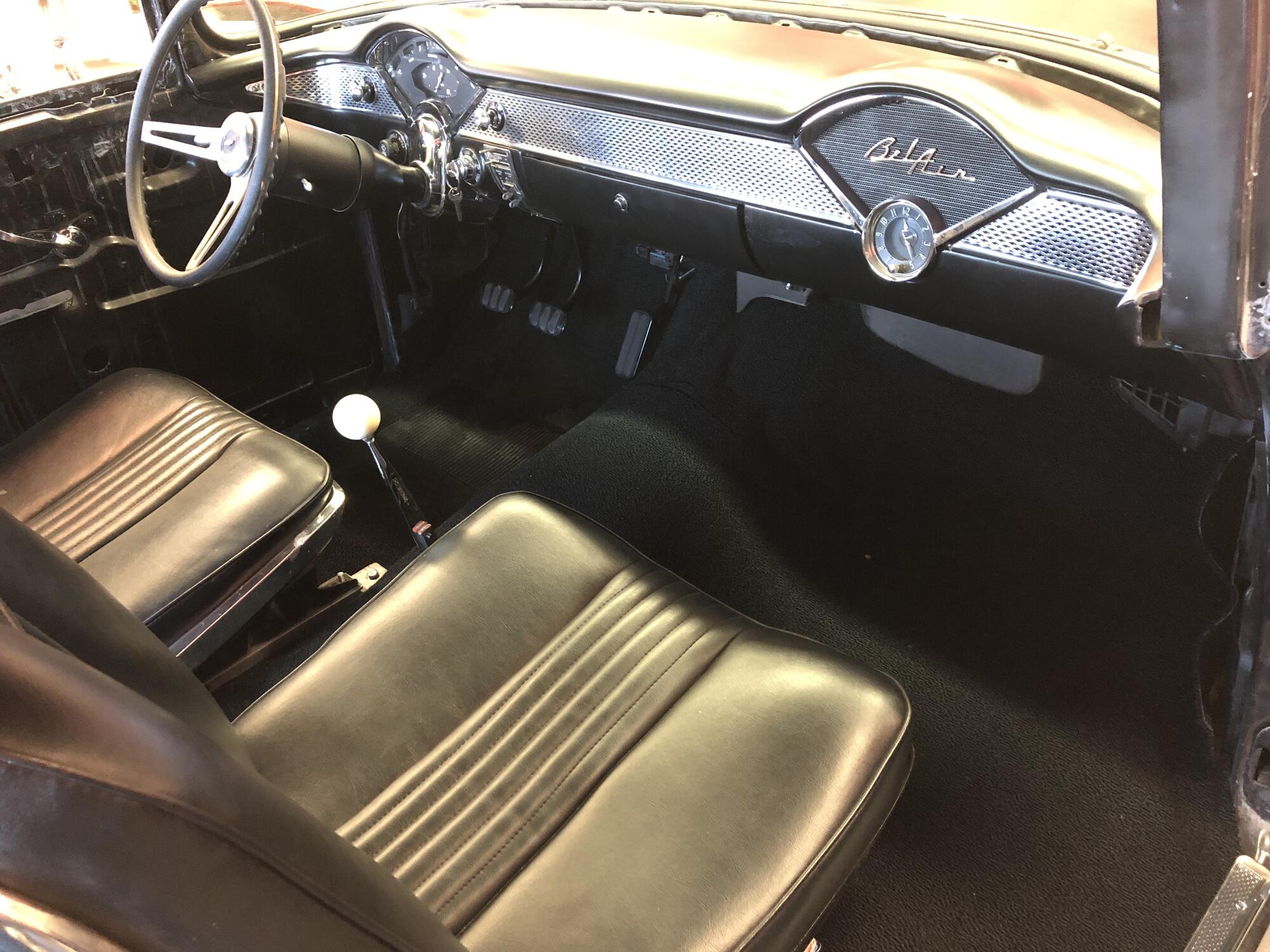

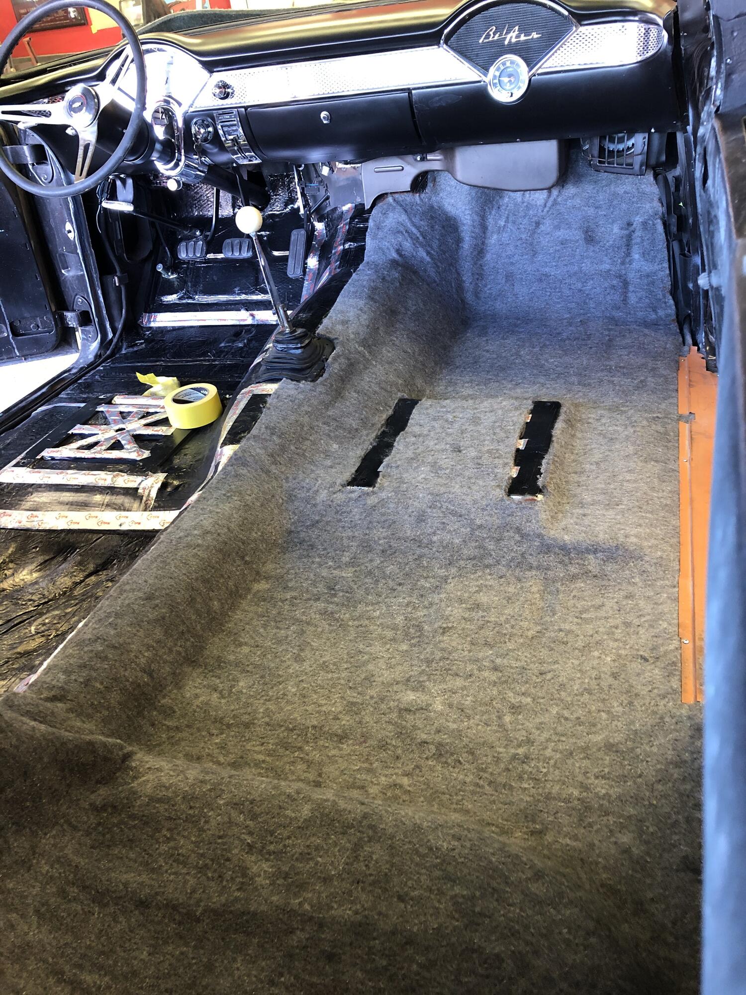

      Carpet Time!
      Started with some 3/8" thick underlayment which got fitted and glued to the floor. Yes, I did both sides...
      Name:  Carpet Insul 2.jpg
      That went so well, and it was nice and sunny and warm out so the ACC one-piece carpet came out of the box.
      Name:  Carpet 01-16-2021.jpg
      A few hours later it was in place, trimmed up, edged in nicely with the new sill plates and had the seats reinstalled hopefully for the last time. What a difference!
      Name:  Carpet 01-16-2021  02.jpg
Size:  353.7 KBName:  Carpet 01-16-2021  03.jpg
      It was a good Saturday! Sunday was back to the myriad of a million small projects and details.
      The side glass is sitting in the shipping box (still) so I guess that's the next big project.
      Jeff

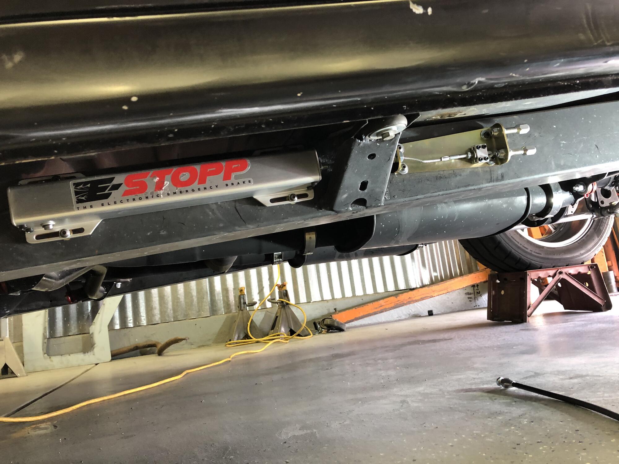

      There's been a bit of activity behind the scenes on the '55. My EStopp system finally showed up after a month or so on backorder. Not too terribly difficult to instal, mounted it on the outside driver's frame rail, installed the switch where the console latch used to be. Stealthy. Rear cables (not shown) came from Lokar and fit up nicely.
      Adjusted the GM rear calipers and need to do it again. System shows some real promise. Mid install pic before cables and a new clamp block with correct spacing for cables. Guess I'm better at the work than the documentation as of late.
      Also, now that I've been driving the car I got tired of sitting so high up in the cabin. Yanked the front seat brackets and whacked off a good inch and a half. Now my face is smack in the middle of the viewing window
      Next up is going to be fabbing up some mounting brackets for the front swaybar. And the side glass, yup, still sitting in its shipping box.
