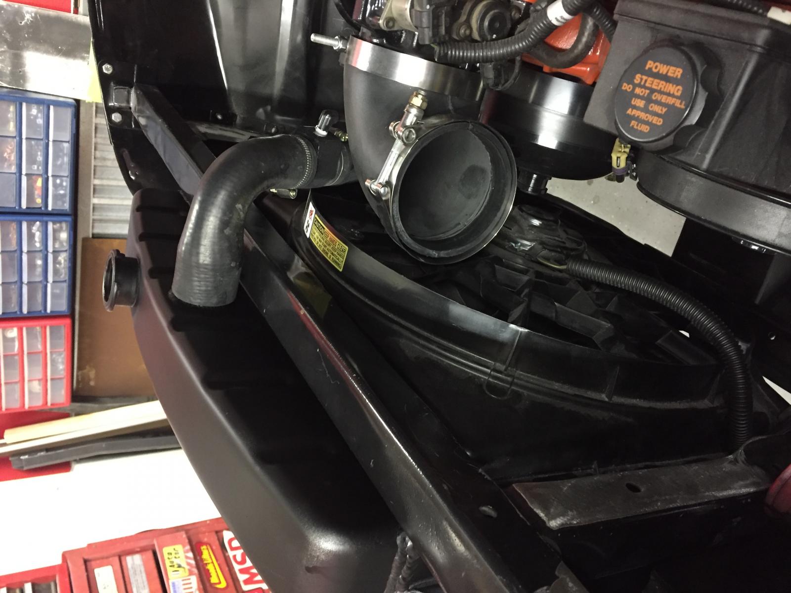

      Designed and burned a set of mounting brackets for the Taurus fan onto the original style '55 radiator. Got it all mocked up and installed for its test fit.
      Needed to trim the 90 degree elbow for the throttle body but it all fits in there and looks pretty good. This gets me oh so much closer.

      Radiator and fan installed for hopefully the last time.
      Time to finish up the air intake version 25 or so. Who knows what it will end up being now.
