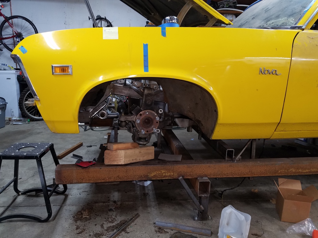

      Next step: Frame jigg. This thing is square to within 1/32 of an inch, and flat to within .005" per foot. I thought having the beams right under track width of the car would be a good idea. After building it, I realized this was not the case, since I can't install a wheel and tire on the rear-end without getting them caught in the wheel well. lesson for next time is to make it a bit narrower or wider.
