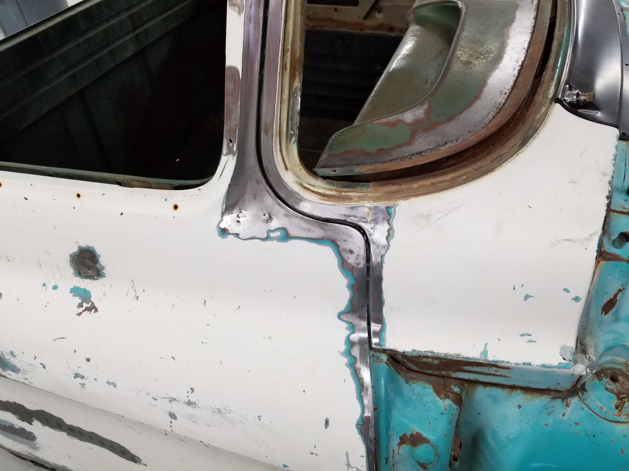

      Getting the door gapping done and rounding the front corner of the door.Name:  IMG_4730.JPG

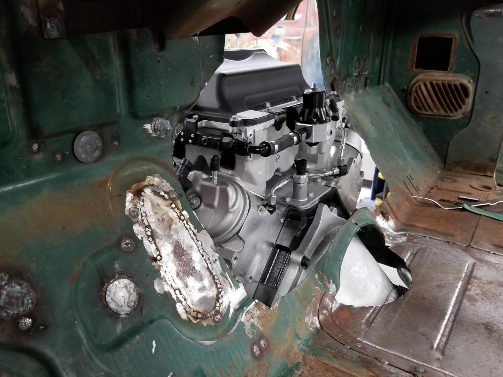

      Finally kissed the cab to the chassis. Time for firewall work. I cut out the small hump and will recess it about 3".Name:  20181029_182744.jpg

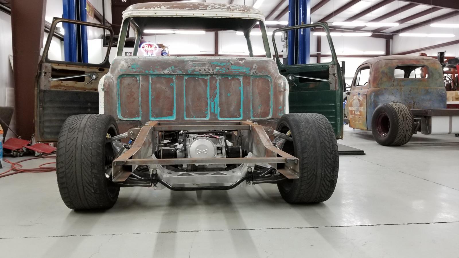

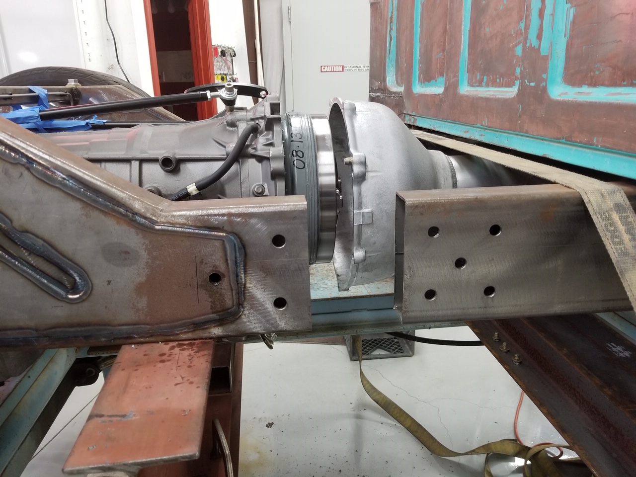

      Well, I am working with Bob at Progressive. They made an honest mistake and my wheelbase is 110", not 114". The step in the picture is pushed up to the cab. The fender and step still need to be moved rearward another 1".
      I had a good conversation with Bob and worked on putting everything on the front to make sure it all mounted together. Fit great. The side rails to the rear are just short 4". Extending the frame will be the easy part. It's the torque tube that will be the pain. It will take about a month with the turn around times on shipping to be back on pace.
      - - - Updated - - -
      Bob and I worked things out (great guy to deal with!)
      I have the chassis on the frame machine. The front was just a little off so we pulled it level and now adding in some cross members. Next, we are getting the frame set up for a little lengthening in the rear.

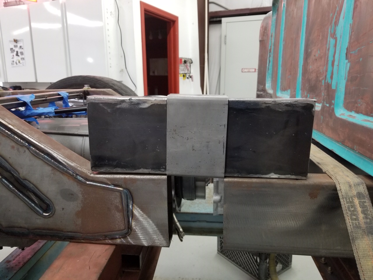

      Here we go. Bob(Progressive) sent me some matching 2"x6" frame rail so I could extend the chassis. Today we built the inner sleeves to make sure that the extension will probably be the strongest part of the frame. Tomorrow we should have this completed, then torque tube comes out to get lengthened at Gamel Street Rods.Name:  IMG_5252.JPG
Size:  336.2 KBName:  IMG_5251.JPG
Size:  363.9 KBName:  IMG_5250.JPG
